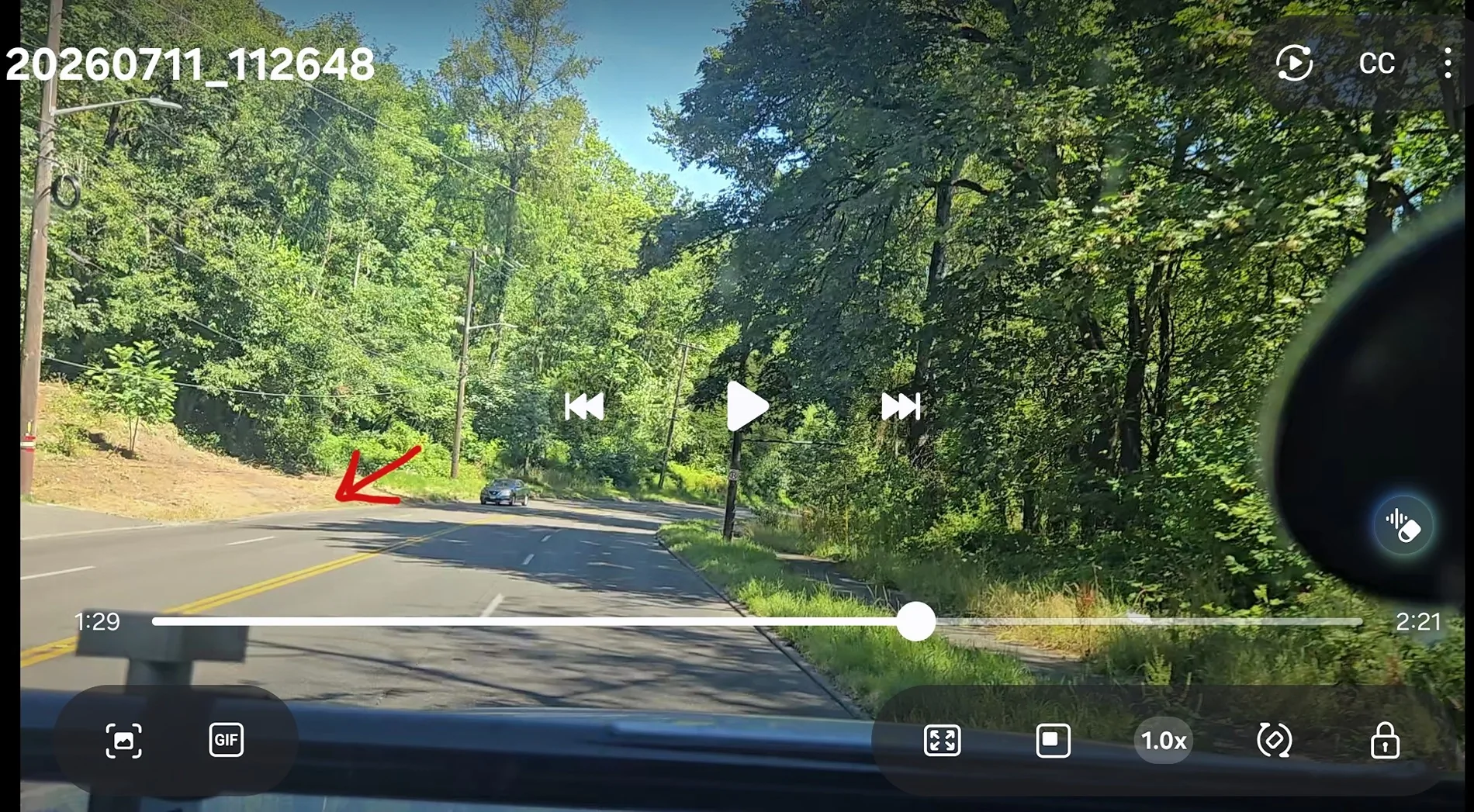

Guys, so I just did made this video. 2nd gear, 3,300 rpm and oil pressure at constant 80 psi. Oil temp got to 213 degrees eventually, just one brake application when I got to the bottom of the hill before the light. Used my Tazer to cool the oil to a nice 197 degrees afterwards.
This is steep, camera is not doing justice.
What do you think?
In that space yesterday morning a cop was standing with his speed gun while I was doing 20 mph in 2nd gear 😃👍

Guys did you watch my video? So you mean that's bad? ☹
I couldn't get past the fact that you were doing 20 in a 25 long enough to care about the engine braking.

I think you are fine in the video that you posted, as long as you are ok with driving that slow. I like to keep mine under about 3,500 RPM when engine braking; if I start to climb past that, I will tap on the brakes to slow it back down.
The issue with low speeds is that the lower gears of the 6MT are spaced very wide, which makes it difficult to find the right gear. I find that I have to choose between a gear that is too low and slowing me down (like your video), or one that is too high and I have to rely on brakes in addition to the engine braking.
Maybe try the same hill going down in 3rd gear. You will have to use brakes as well. It is not ideal, but in a situation like that, I would utilize engine braking only until I get too fast for comfort, at which point I will apply moderate brake pressure for a short period of time, hopefully enough to slow me back down. Then I release the brake pressure to give the brakes a chance to cool and go back to using engine braking only. Then the cycle just repeats itself.
The main thing you want to avoid if possible is riding the brakes down the entire way. You risk damaging your brakes if you ride them down all the way.
To summarize, you should use a combination of engine braking and regular braking, and try to keep your RPMs at a reasonable level.

3rd gear would have taken me to 35 mph which is still fine, cops look for 45 mph drivers. A combination of 3rd gear and some brake application would be the best strategy. I will make another video tomorrow 😄
