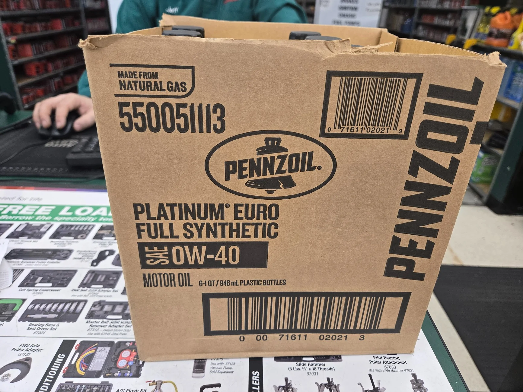

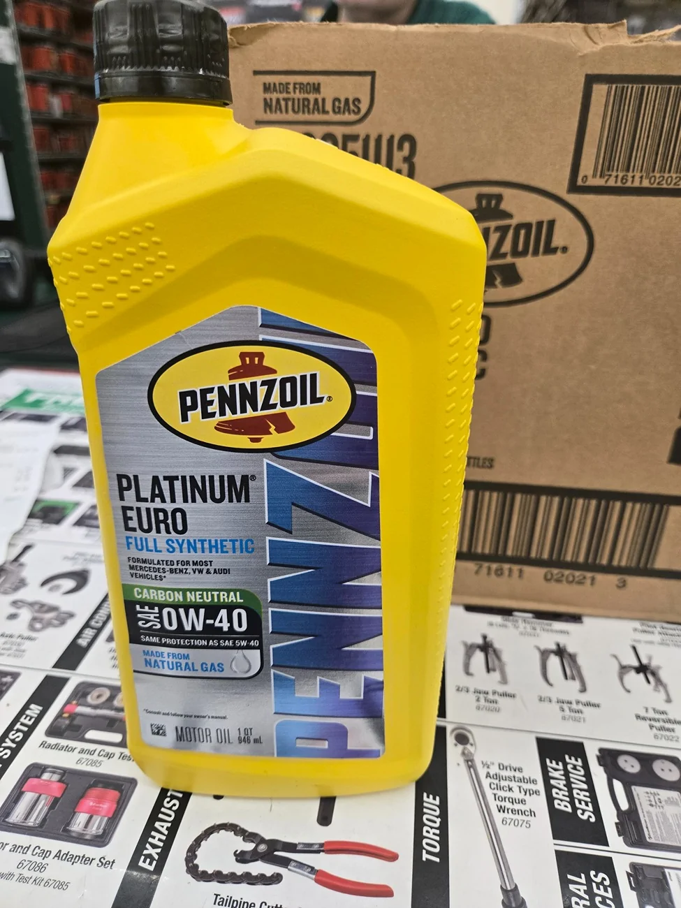

Thanks. I use Pennzoil Ultra Platinum on steriods AKA Pennzoil Platinum Euro 0w40 🤩
Jeep Wrangler JL Any harm in engine braking? 20251117_144833
Jeep Wrangler JL Any harm in engine braking? 20251117_144825
