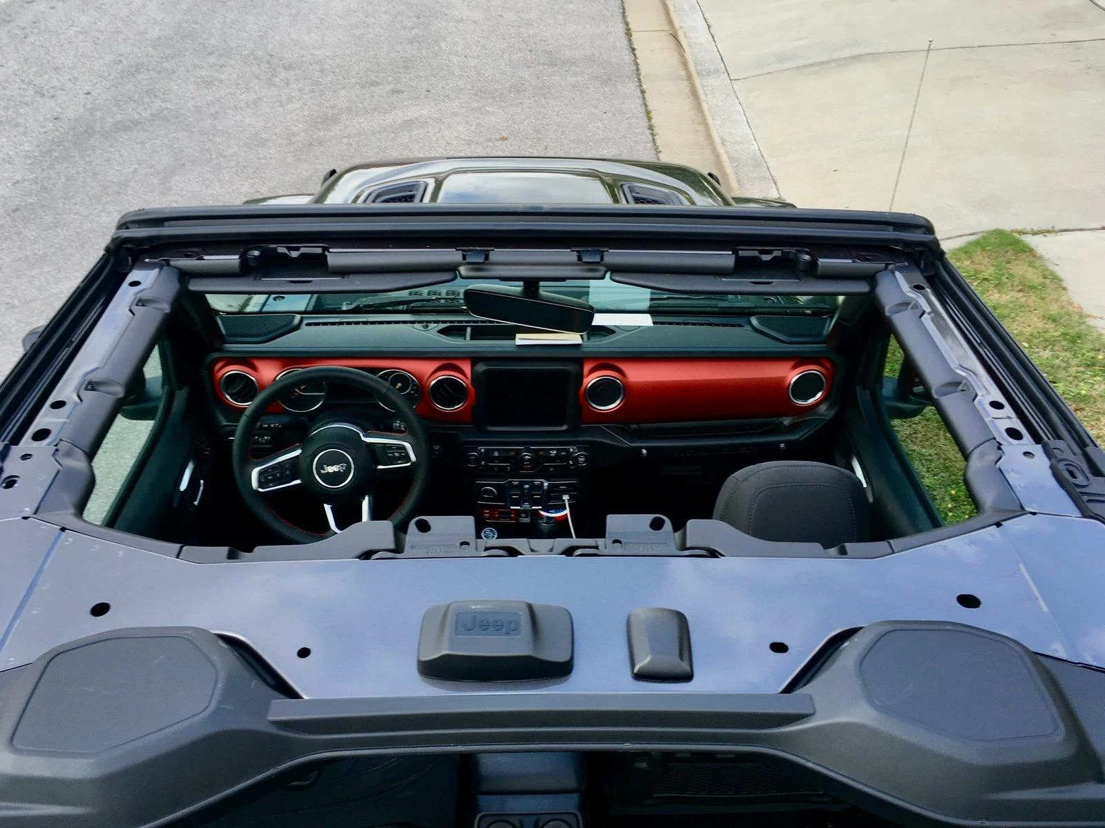

Your Sirius XM radio doesn't use the antenna that's on the passenger side near the front wheel. There's one on top of the roll bar for that.
I have the fender antenna but there’s nothing on the roll bar Which is in the interior.
The XM antenna pod is on the top of the roll bar.

As already said, Sirius XM antenna is on the roll bar. Anything on your roof (cross bars, RTT) can adversely affect Sirius XM reception. Is your kayak up there? Plenty of internet info for moving the antenna when roof accessories get in the way.
