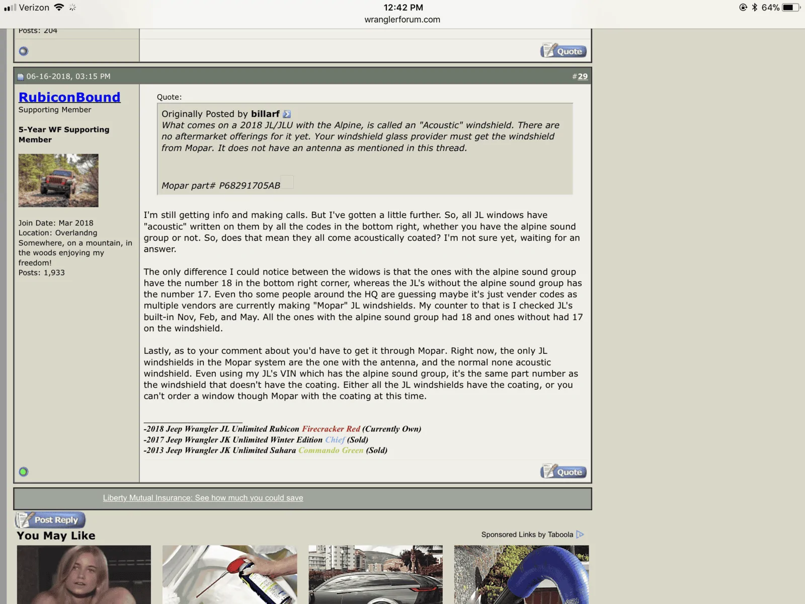

Over in WF, a new JL owner is having to replace his cracked windshield.
He is insisting that some JL's come with an antenna imbedded into the glass. Have any of you heard of this? If true, what is it for? The AM/FM antenna is on the passenger side front fender, and the satellite (GPS, Sirius) antenna is up in the speaker bar, no?

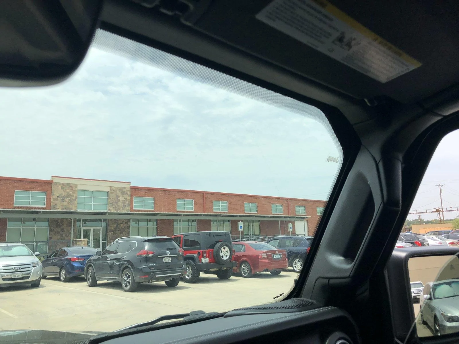

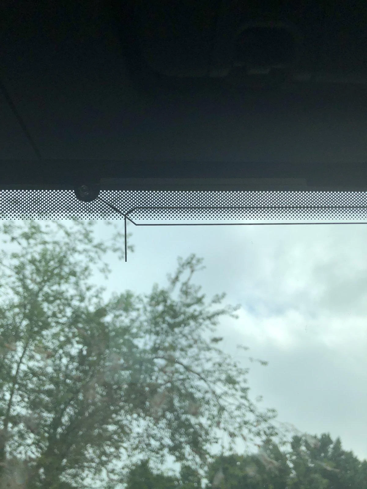

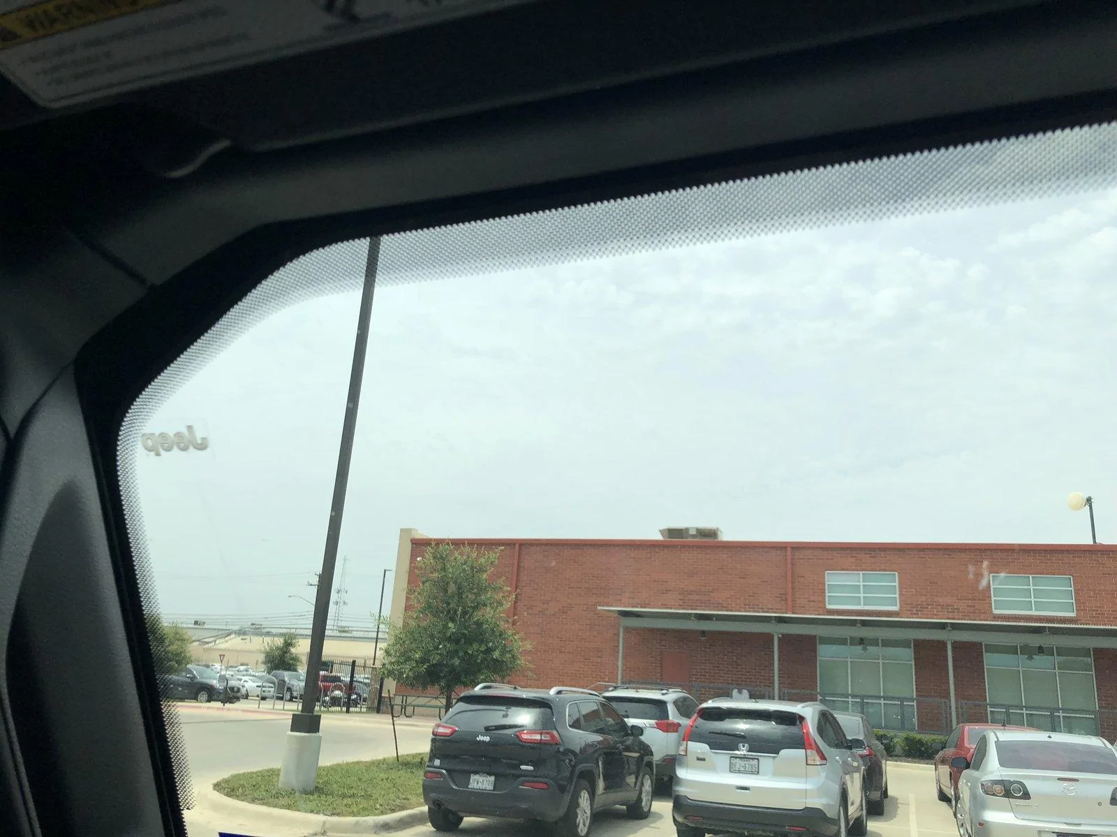

I just got a replacement windshield and it has something embedded on passenger top with a plug in! I don’t know what it is. I’ll post a pic
Seems like it would need to have a connection point at the bottom, to somehow allow for the windshield to fold, almost like the defroster on a hard top.
it has a button like connector that is very close to the rear view mirror. I assumed it was for some onstar like upgrade.

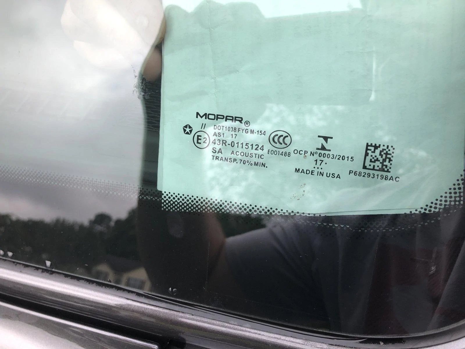

I just had mine replaced a few weeks ago and they brought the one with the built in wire and noticed immediately that it was not the same do to my cracked one did not have it
so they came back the next day with the correct one that had no built in wire
I have the OEM part number if anyone would like to have it

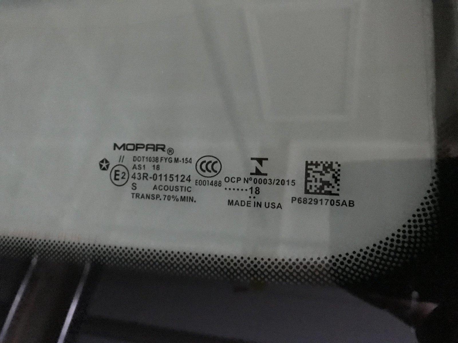

After reading thru 10 pages of this topic, curiosity got the better of me. My original part # is below & the windshield has no wires up near the frit or anywhere. Earlier in this thread, Bill showed an original part # of ~AB... what's yours?

Not to be rude, but to repeat, you have the WRONG windshield installed in your JLU. You don't want to believe it then don't. Not my Rubi so I could give a chitt.
Did you think to look at the part number on the windshield before you let them pull the damaged window? Daaaah..
