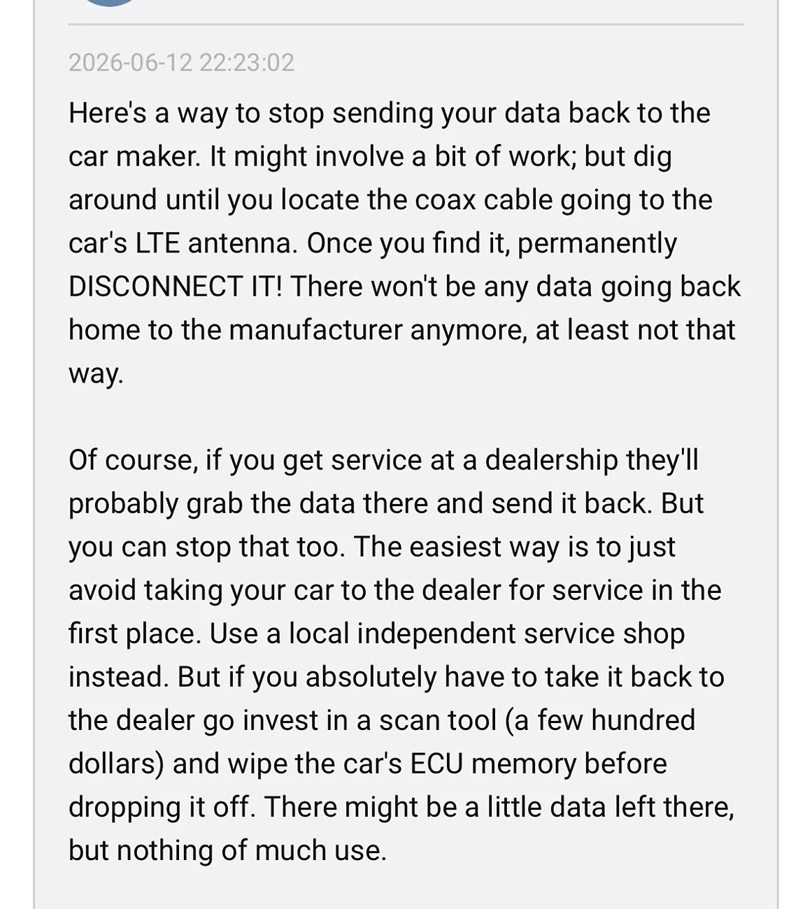

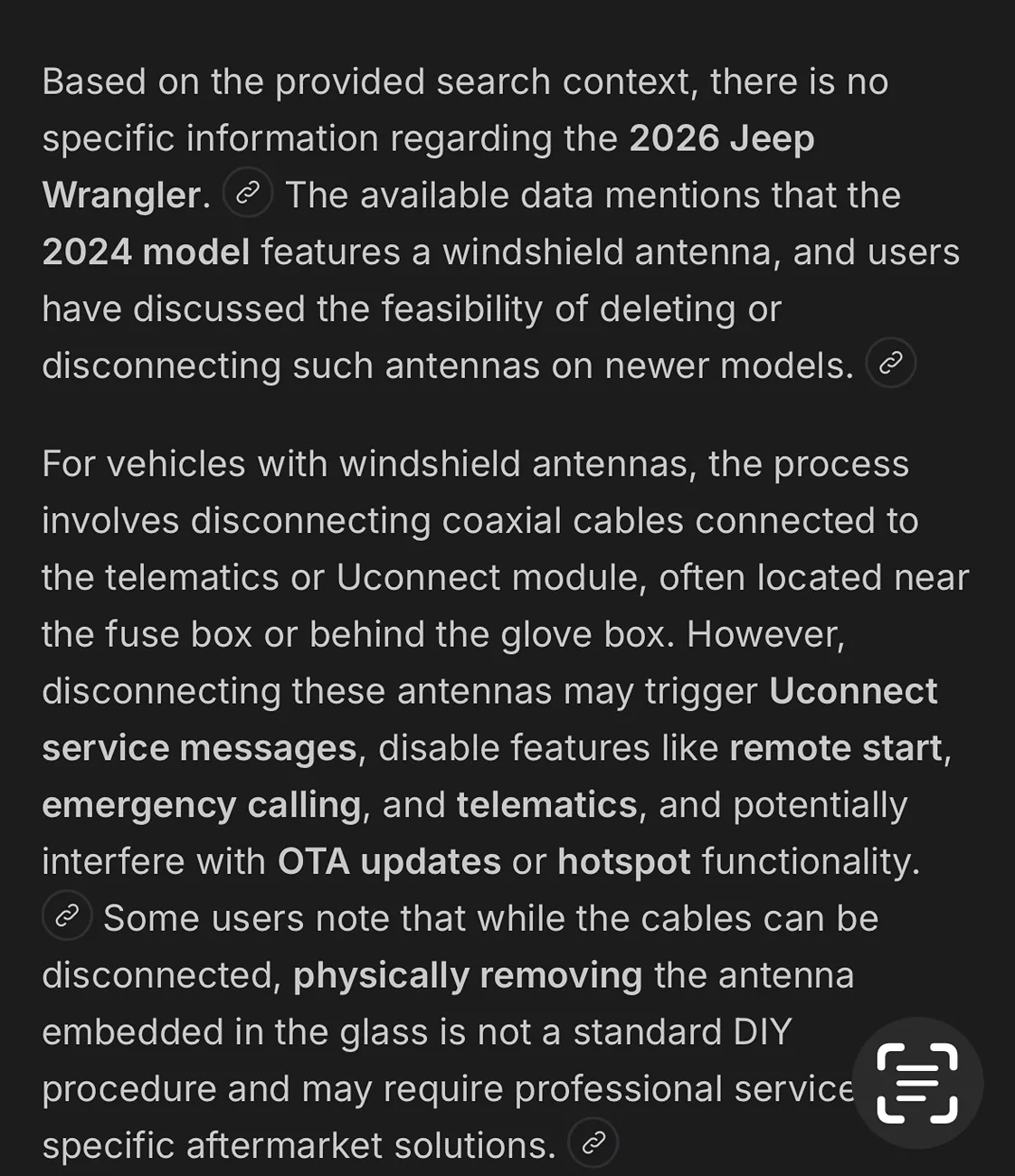

I just traded in my 2022 jeep wrangler for a 2026. I do not like being connected to technology as much as I can help it, and yes maybe a little paranoid of data collection. This jeep has a windshield antenna and I hear it’s possible to disconnect the coaxial cable. Has anyone tried this? Does it affect anything else? I don’t really use the radio and I do not use U connect and don’t have remote start. I want stay as disconnected as possible and wonder if I should look into this more. I attached a few screen shots of other comments I found. Thanks in advance!

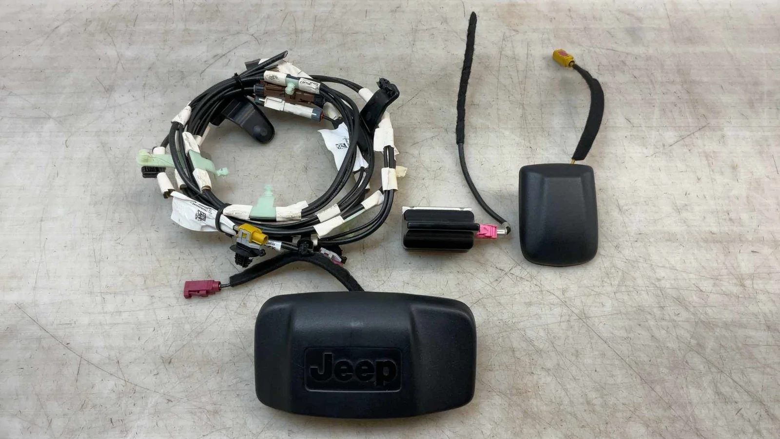

Then a dummy load with Fakra connector. That should trick Uconnect into thinking the antenna is still plugged in.
I love the idea but man these things with even minor corrosion at the fittings cause antenna open circuits like crazy. Super common issue on uconnect 5 vehicles
