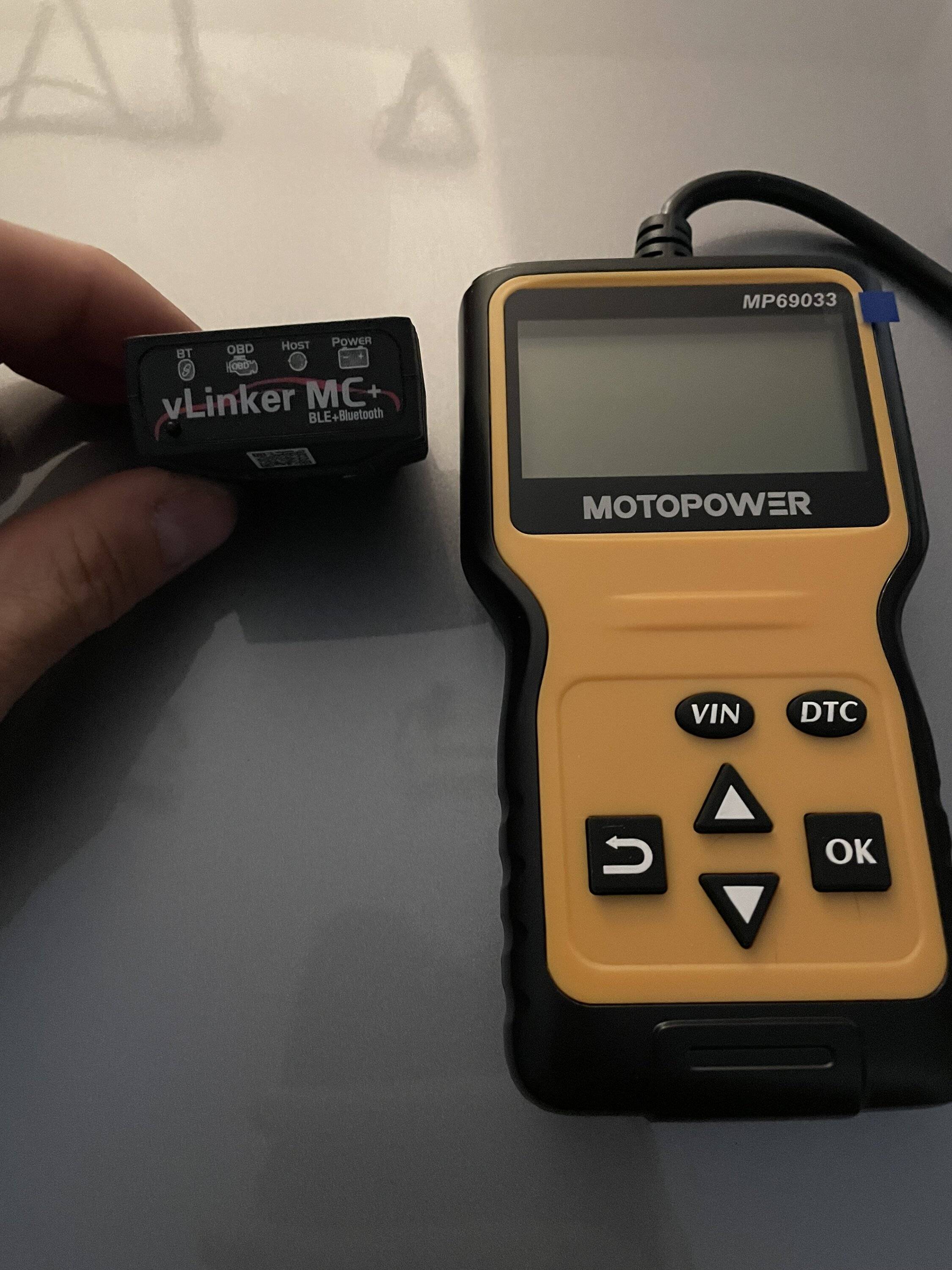

I tried a Bluetooth JScan and a regular ODB reader (see pic). Both showed no stored codes. ?
Hmm that's frustrating. The only other thought is that I was told the shift knobs can become loose and set off the sensor. Last time the guy from the shop got underneath the shifter and tightened something. I wasn't under there so I'm not sure exactly what he did but may be worth a look.

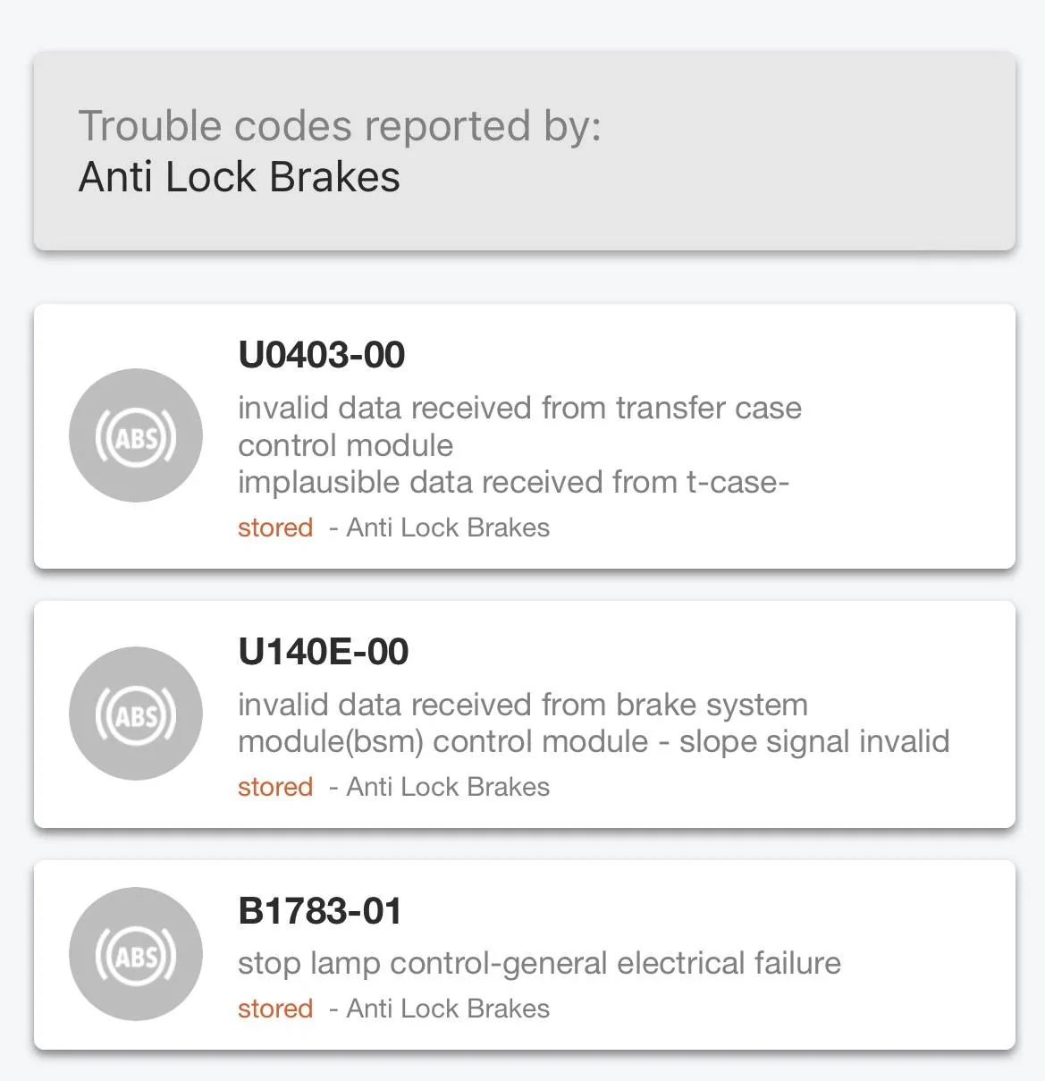

Update, I got codes (pic) noting transfer case errors. :(

My guess is whoever installed your gears, f'd up the wheel sensors. I ended up killing all nannies with a Tazer Mini. Your transfer case is still mechanical, but your FAD wont engage the front axle in 4H or 4L. Since you have an ARB locker, that will still work. You could hardwire your FAD to engage/disengage or go with an FAD eliminator sleeve. (That will case more issues)

Update: I figured out the shop that did the re-gear never programmed my jeep for the new axle ratio (3.45 to 4.88). So I updated it with my jscan, cleared the codes and so far so good. Mindful that I only drove a few hundred yards in 4low, no light….yet. ?
Thanks to everyone for the help and ideas!

I wonder what the code about the brakes were about. Hopefully the re-program is your fix.

It doesn't have to be a gear install. I haven't done anything to mine other than change the TC lube oil and I got the Serv 4WD warning light. Funny thing is it's sporadic, it will come on then when I shut the Jeep off and restart it's gone. I did run my JScan on it and took screen shots of the codes it was throwing, pretty much the same as those posted above. Made an appointment at the dealership to get it taken care of while I'm still under warranty. I'll let you know what they find....if they find anything.
