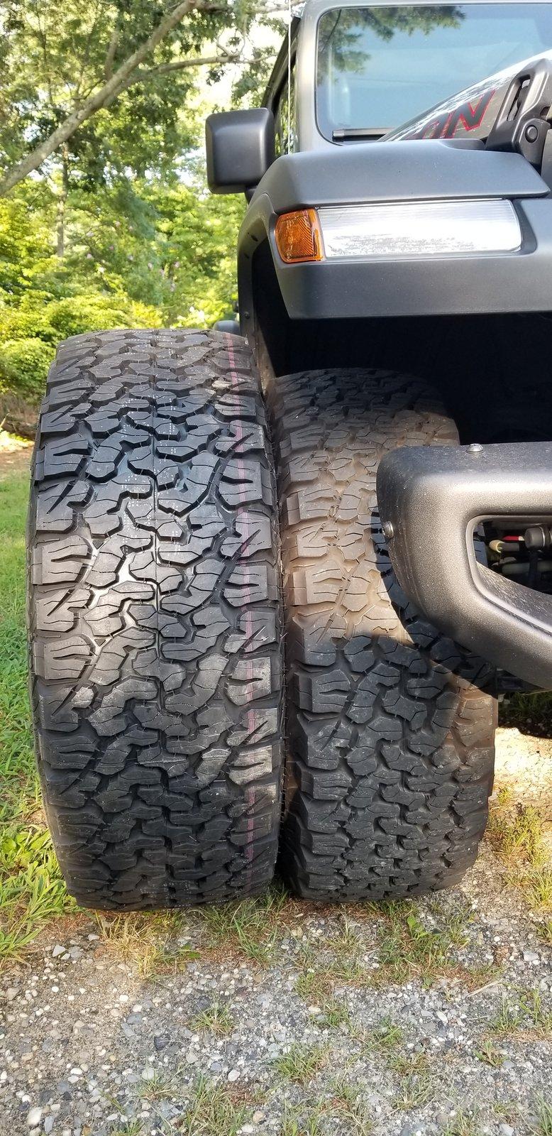

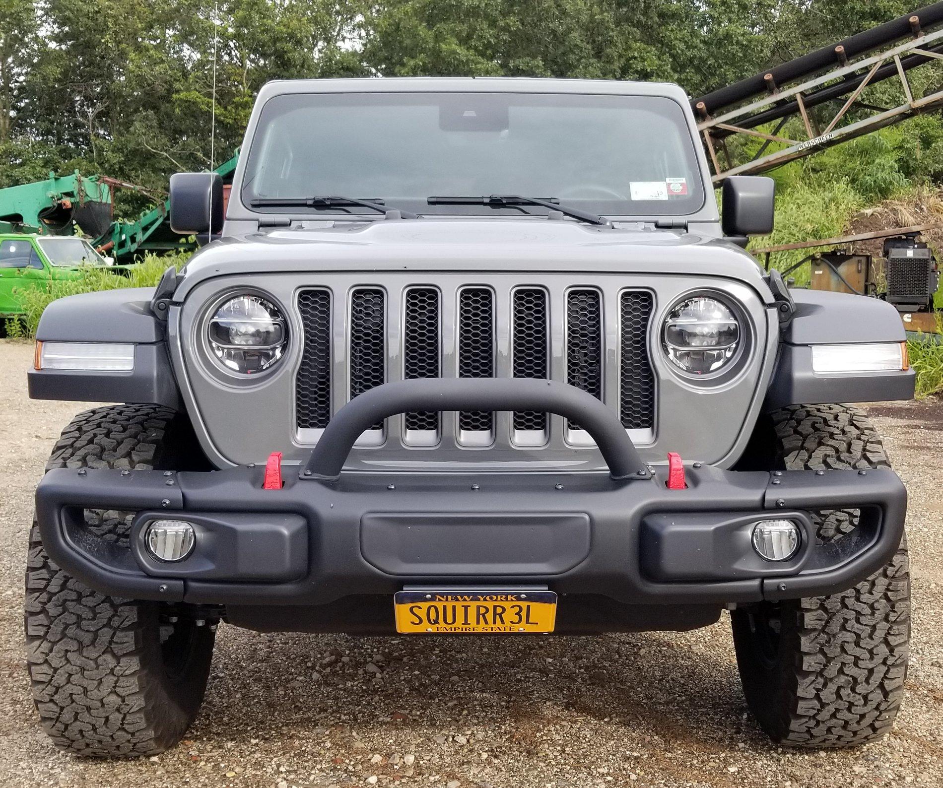

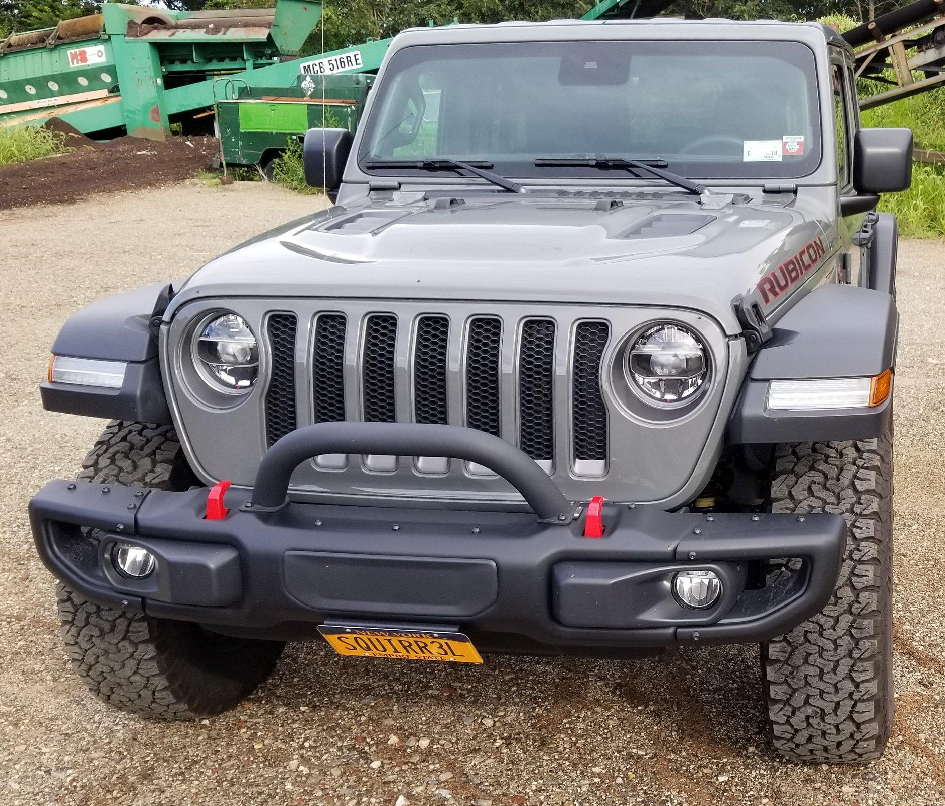

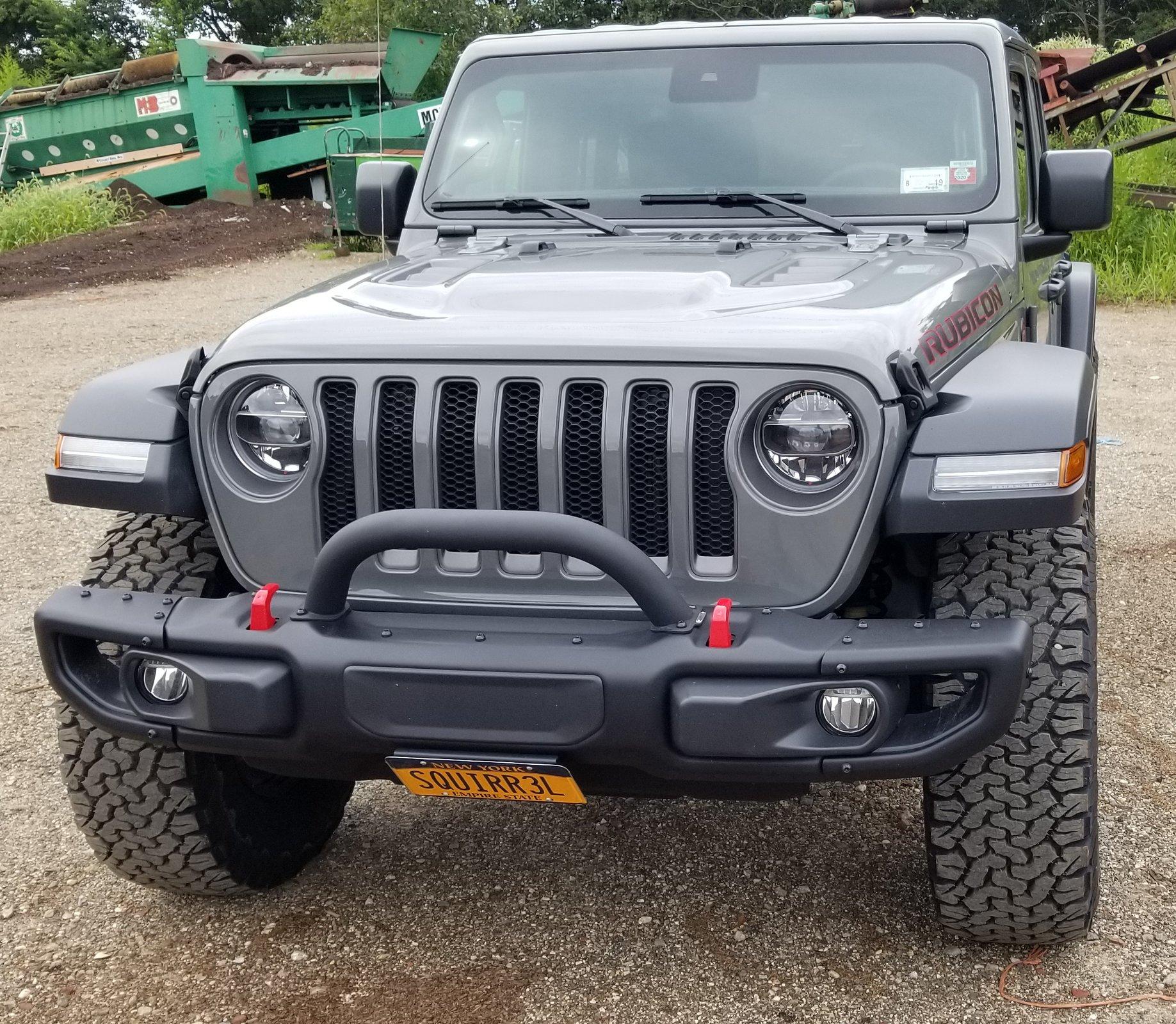

Here's some pics of both 285/70-17 and 315/70-17 BFG KO2's on factory Rubicon 17x7.5 +44 offset wheels. No wheel spacers. No lift.
Awesome! Just what I’ve been looking for, appreciate it. Looks so good with the 315s.
So from the photos it looks like on the stock rims with the 315s there’s still no tyre outside the wheel arch?
edit; looking again maybe just a little bit with the 315s.

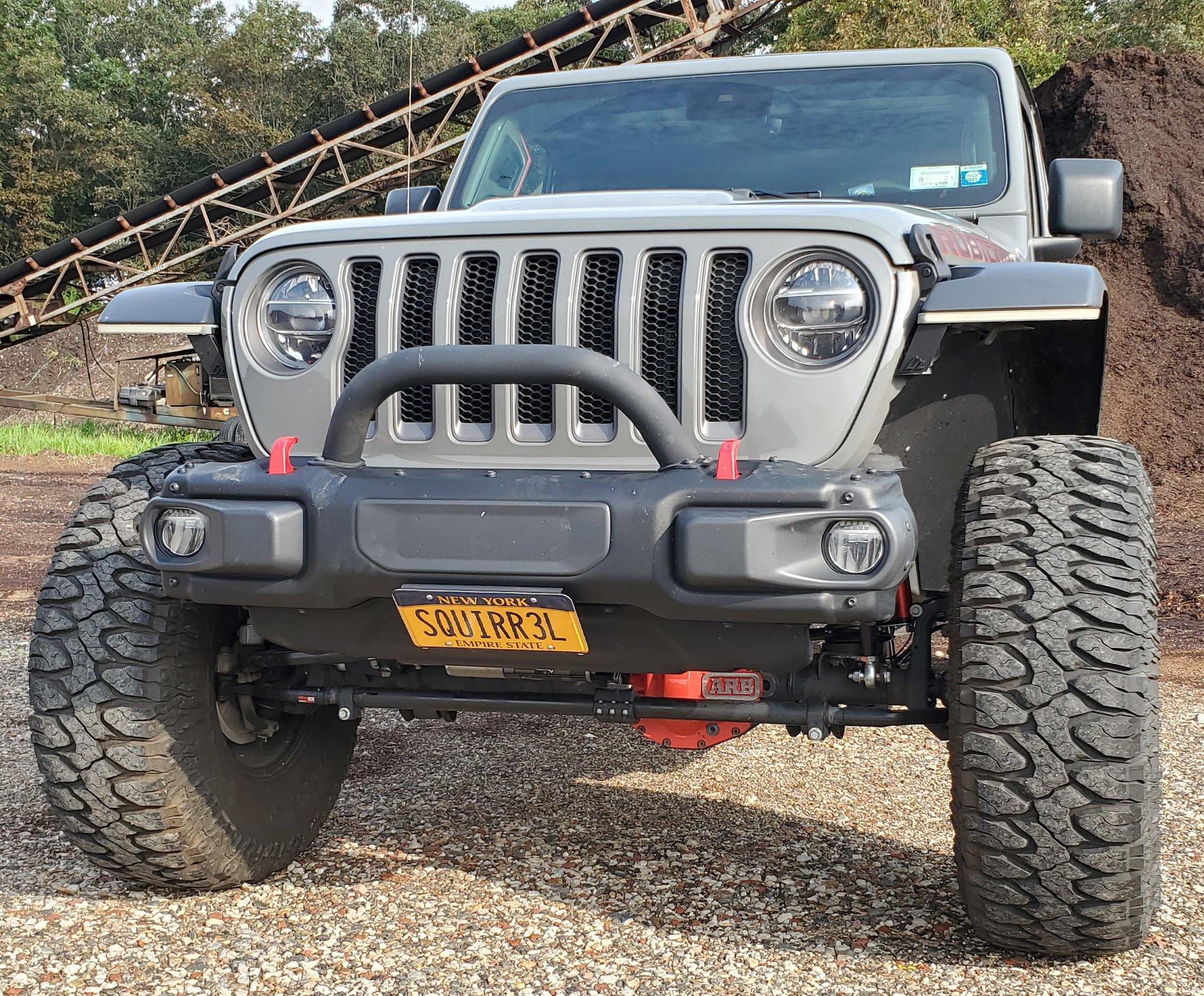

No poke with the 315's. Almost perfectly flush. Here's a pic of the same wheel and tire, but with the front fender chopped and a 2" lift
Jeep Wrangler JL Another offset/tyre question 20200423_092656_resized
. About a 1/2-5/8" poke.
so how come there’s poke in this pic? Is that just from chopping the fender? The lift alone wouldn’t cause them to stick out further would it?
ah just had another look and noticed you chopped the side bit of the fender! Makes sense now. Thanks for your help mate, your rig is a proper beast with the new setup. Wish we could get away with that here.
I got rid of the bottom half of the fenders, which included a bit of mounding on the side edge.
