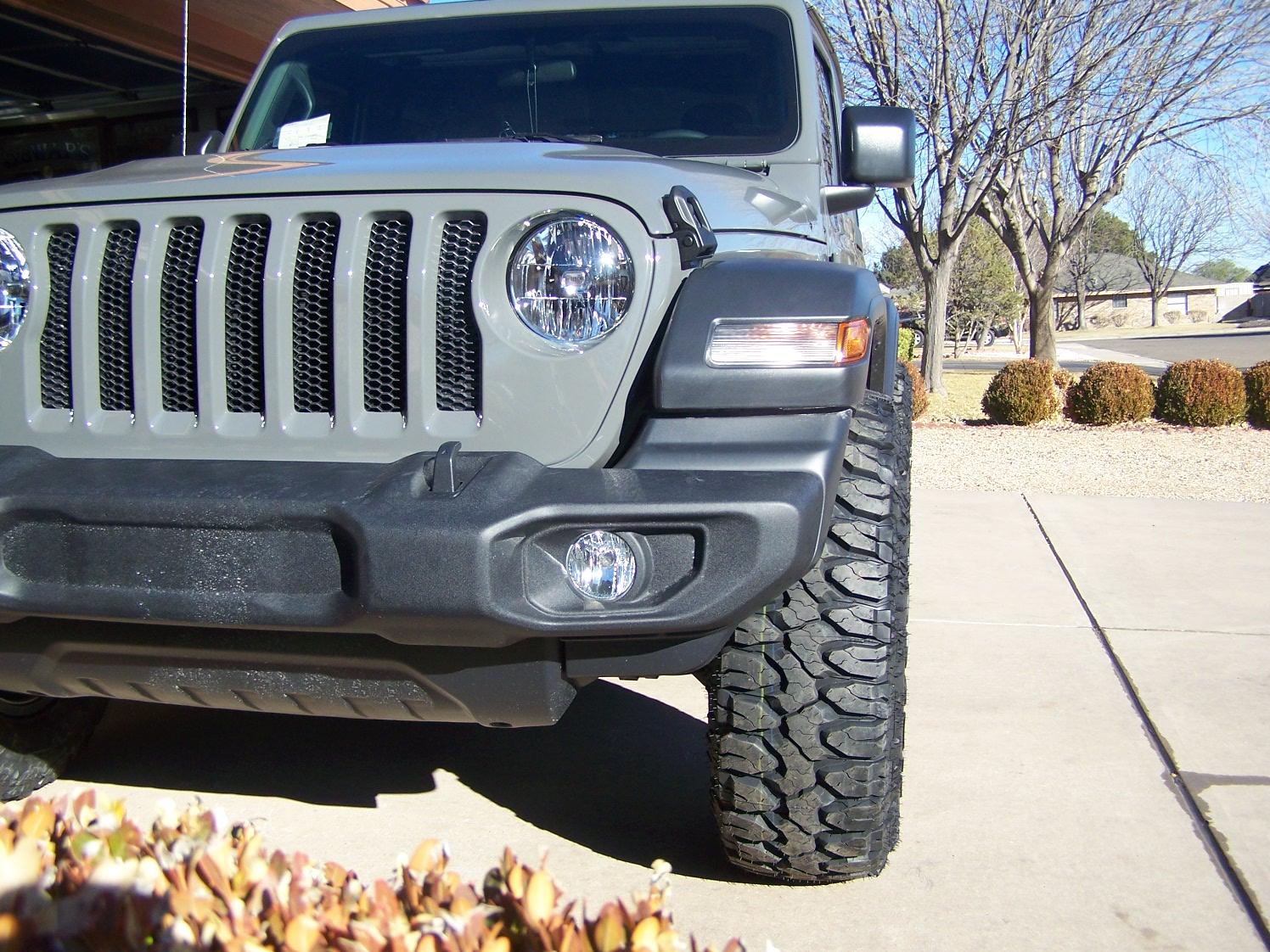

Here's my 295/70/17s on 8.5 +10 offset
Jeep Wrangler JL And another offset question 100_4025

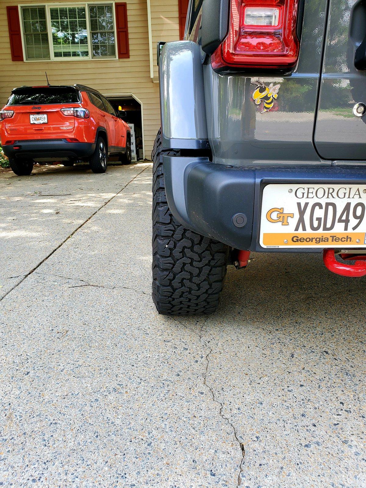

This is 17x8.5 wheeks with +25 offset. AEV Borah. 285/70R17 BFG KO2 original Rubicon tires. On my JLUR
Jeep Wrangler JL And another offset question 20200701_140528
Jeep Wrangler JL And another offset question 20200701_140541

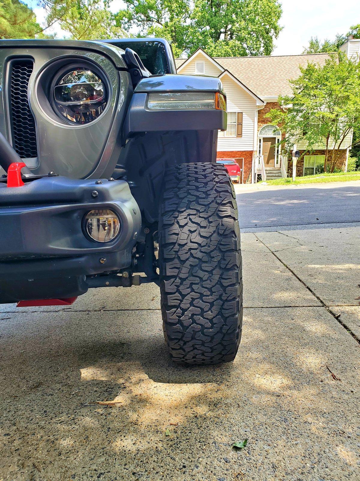

This is my JL Sport. Tires are 285/70R17. Wheels are 17 x 9, +1 offset. Stock suspension in this picture.
Jeep Wrangler JL And another offset question jl4
