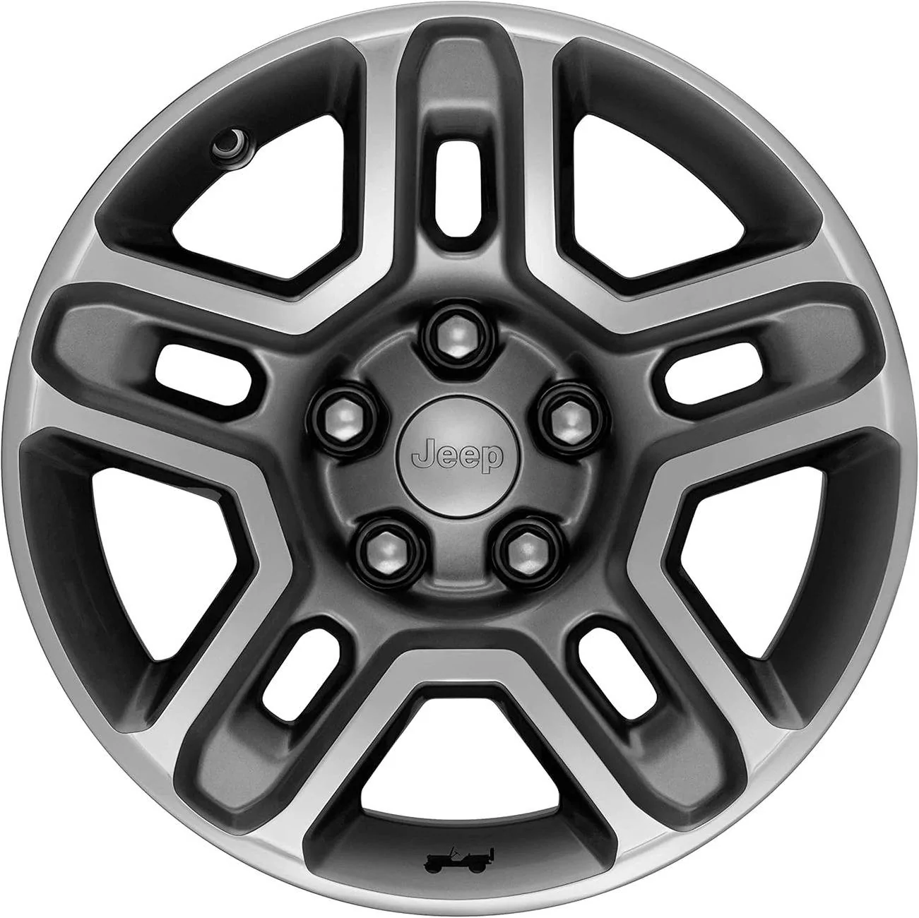

fyi this is the wheel im thinking of going with

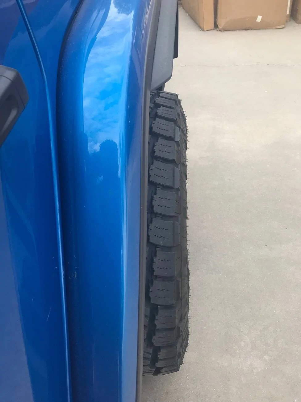

Stock 7.5” 44mm- 35/12.50

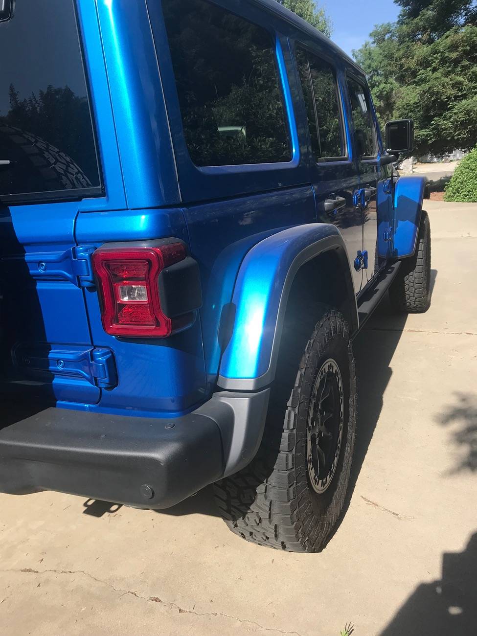

8.5” -1 mm

Hope that helps - 1” is 25mm, if narrow axles adjust accordingly you could get a little more negative offset to be even.

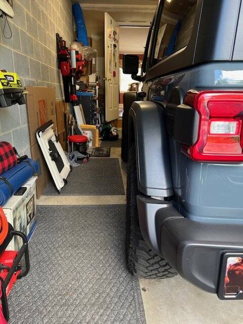

this is the stock willys offest trying to stay with this similar look with new wheels and tires. basically not a big poke fan and want to avoid that look.

ok so if im undertanding you correctly the wheel in this pic is a 17x8.5 and a positive 25mm offset and its a rubi with wider axles than a 24 willys ? so if i go with a 12mm positive offset and its the same 8.5 width it should have less poke than in your pick?
