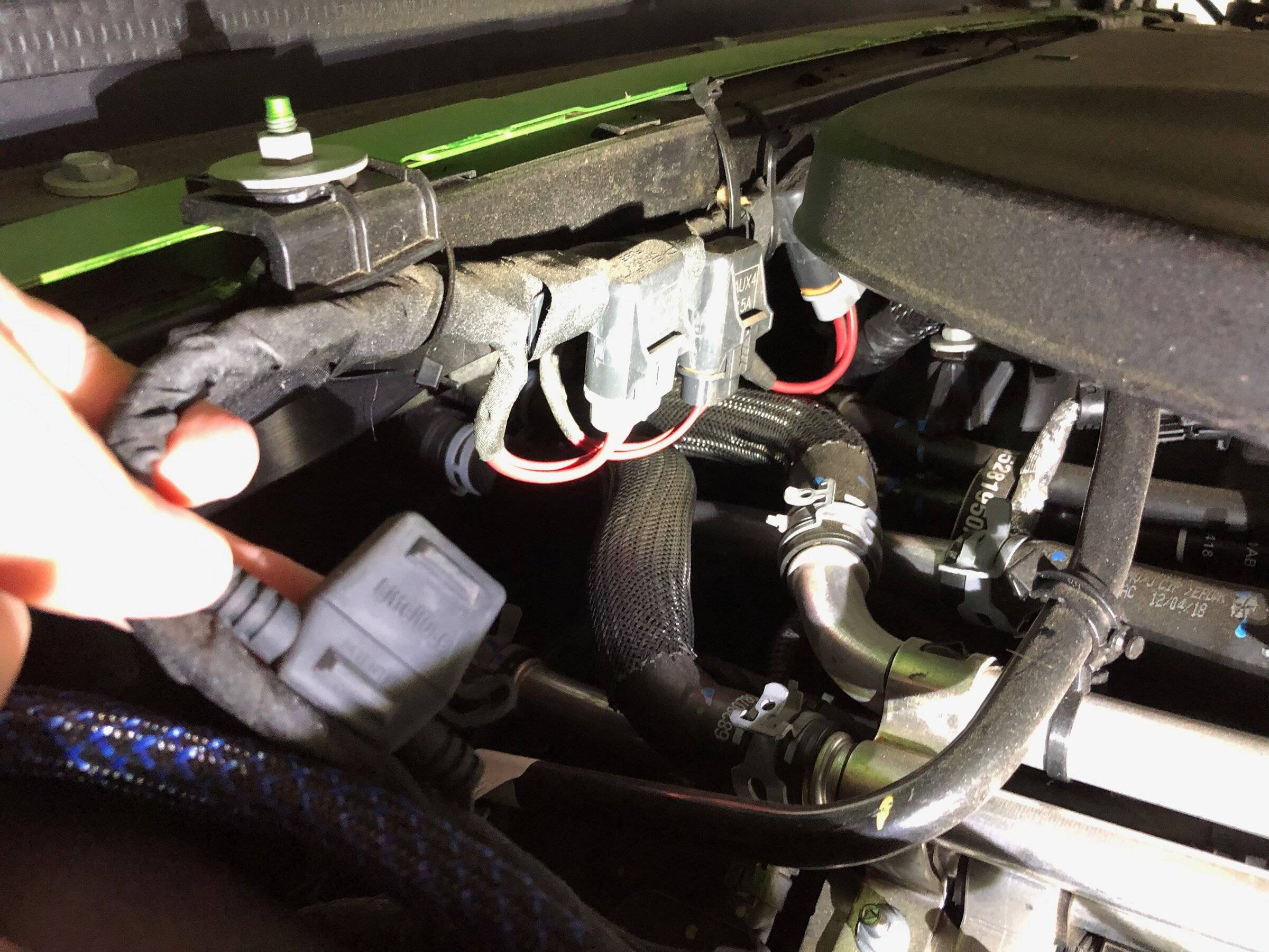

There are five fuses in the wiring harness. Four are in the switch circuit and one is in the power line. I think it was a fifteen amp fuse. If the Jeep was here I would take a picture. It won’t be home until Tuesday.
Where is this 5th fuse at again? The dealer installed my AUX switches (Rubicon), i'm having a little bit of a conundrum, wondering if they only put i a 5 amp fuse in the 15 amp as well...

I believe the 5th fuse is on the red power line. (1 for each aux buttonx4 + 1 for power).
Edit: If the dealer installed it via the instructions, all of the fuses should be along the firewall and zip tied along the top. I'll need to take a look but I believe the power line fuse is further along and closer to the battery.

Does anyone have a picture of the mystery 5th fuse? A picture would be very helpuful please:)
If this is the installation of self installed Aux buttons, below is a picture of the fuse but it should be easy to locate. Find the power lines (should be 2 bundled together) coming from the battery that head to the relays on the drivers side. About 6"-12" from the battery, you should find the fuse case for power. Further along after the wire bundles come together, you'll find the 4 Aux button fuses. You can see those in the picture further back.
