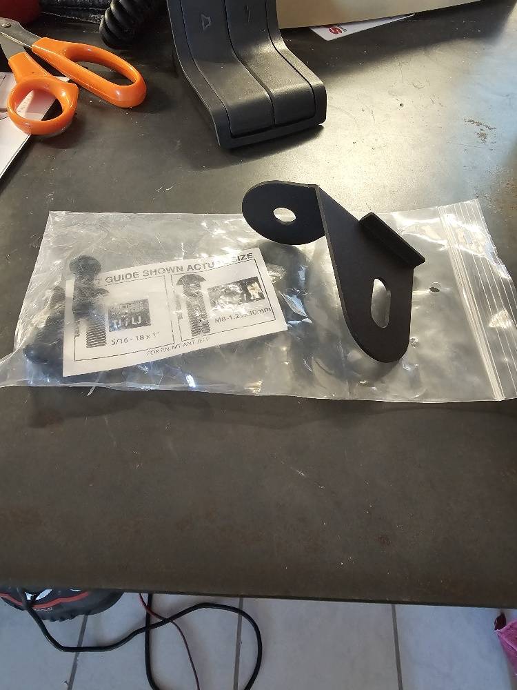

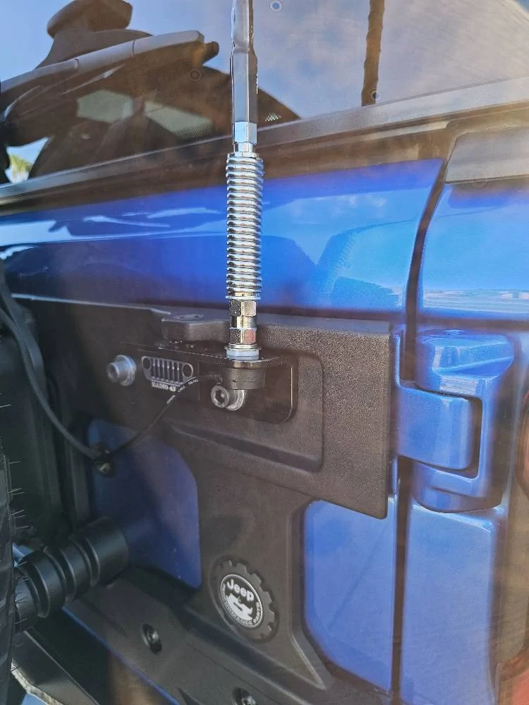

I had to resort back to using an aftermarket CB Antenna Mounting Bracket. I was using an antenna mounting provision that the Mopar Heavy Duty Spare Tire Mounting Support provides but unfortunately, the Mounting area is too thick/deep with material and can not accommodate the Firestik mounting hardware. The thick mounting area will not allow for significant thread engagement with the antenna cable stud and the antenna mast lug.
I knew this could be a problem and sure enough, I lost my 5 Foot Firestik II antenna, Quick Disconnect, Spring, and Lug, somewhere in the Red Creek Wash near Bloody Basin yesterday on a Jeep group run because of the low hanging tree branches in the wash. I was fortunate that I had spare parts available at home from previous installs to get me back on the air whild I order replacement parts for spares.
In the attached picture you can see the support bracket antenna mounting provision just to the left of the Girestik assembly.

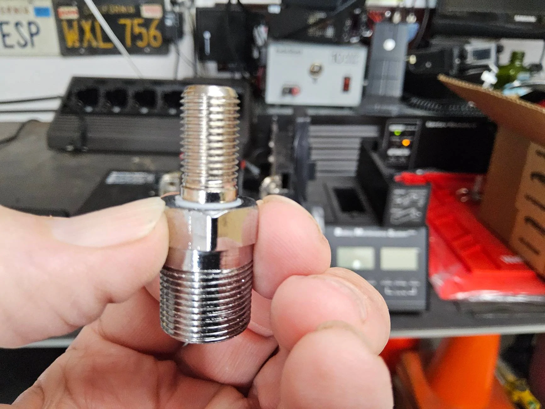

I'm not a CB radio guy, but I do have a firestik antenna on my Mopar Heavy Duty bracket for my flag. They make a longer antenna stud, Model K-4A would that help you?

You mean this Firestik K4A doo hickey?
Not really, the stud is two threads shorter than the Walcott Radio cable stud that I am currently using. I'll be sticking to using the after-market for now.

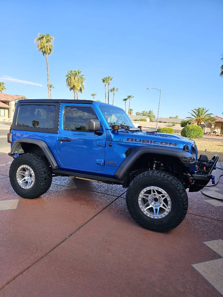

My Jeep is clean now and more presentable. I just washed it after the two Jeep Trail runs from last Tuesday and Friday.
Yes, obviously I have considered those two since I do have them. Went with the bracket as shown since it had a graphic of a Jeep as opposed to the Teraflex logo.

The mo dirt the mo better.
I totally agree with you as long it is not the day after but in my case it was two days after the last Jeep Trail run.
I should have taken some pictures from the Red Creek Wash run on Friday but I didn't get back home until about 8PM. Very long days. The next day I washed the underneath and after that chore it rain, then the sun came out and then it rain again and then it was way too hot to wash it. I waited until sunrise today and washed the rest of it.
