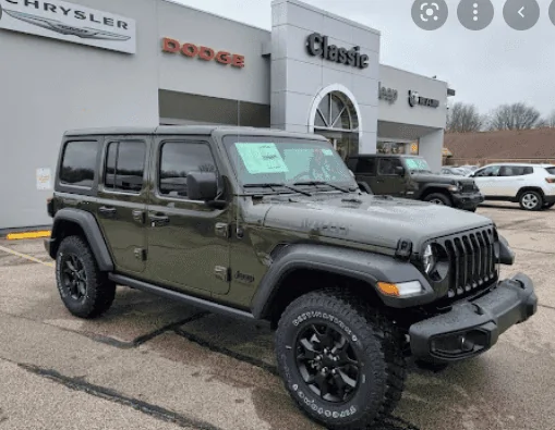

Hi guys, I'm new to the forum and new to Jeeps in general. I recently bought a 2021 JL Willys in sarge green which I really love so far, aside from some seat height issues, being as I'm a taller/bigger guy...
I was interested in raising the Jeep a couple inches, so that it rides a little higher. Nothing crazy, just something to put me up a little bit, and raise the ground clearance as well.
I'm seeing a wide range of products online that claim to do this, from simple spacers for <$100, to suspension lifts for $1500+. I've been reading about the difference between body lifts and suspension lifts, but I wanted to also ask here to see what you guys would recommend. I'm not a hardcore off-roader, but wouldn't rule it out for the future. I currently have 33" Firestone mud tires. Let me know what you'd recommend for a case like this. Thanks!

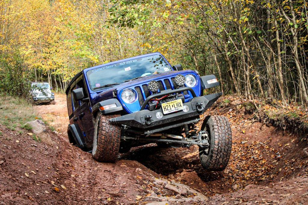

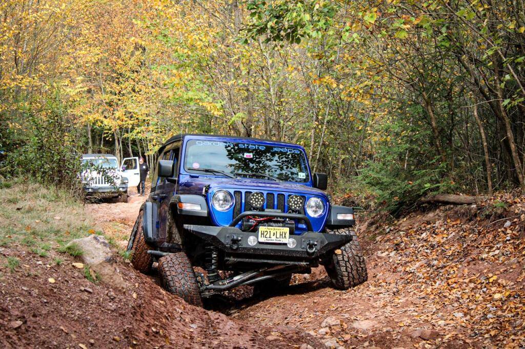

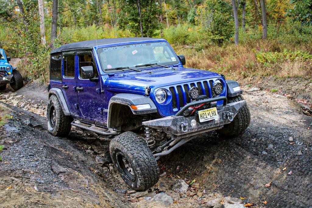

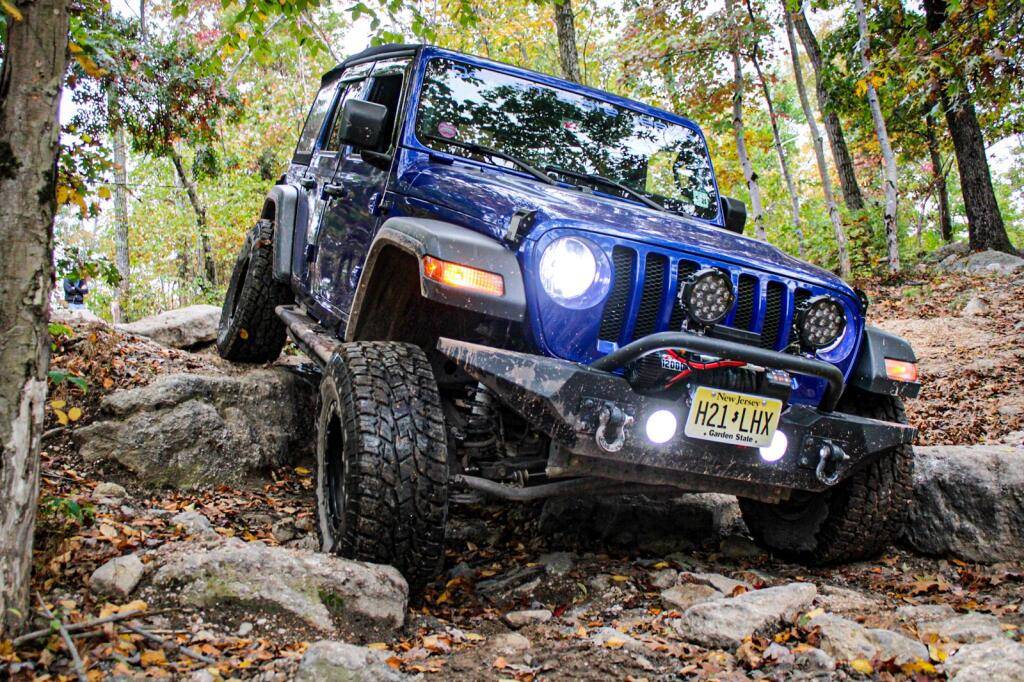

It all depends what you want to do long term. I put on a 2.5” budget lift(spacer) and 35”s and am content with what I am capable of. I don’t think I’d want to try anything more than what I do now which are blue rated trails. I run Raush creek and AOAA which is all rocks and do fine with my setup. Being my daily I don’t want to beat up body panels nor do I want a full fledged trail rig.
