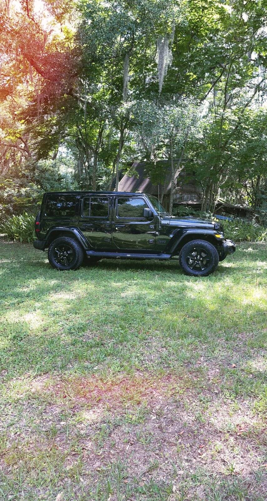

I just got back in the Jeep life and I am excited to start a new build. I bought a 2021 JLU Sahara I am torn between doing a 6 inch long arm lift or a 3.5 inch lift. Goal is 37 inch tires and a 12 wide rim, I don't want it to rub or have any issues. Any suggestions. Thank you

What are your on road/off road goals? Daily driver along with over landing and easy trails or rock crawling? Budget?

Doing a little bit of off-roading and some rockclimbing maybe. Mostly a daily. Budget isn't a concern.

Welcome back...... if budget is no concern, then I would definitely recommend long arms. I wouldn’t go as high as 6ā€ though, a 3.5ā€ lift will clear 37s. If I had it to do again , I would’ve gone long arm from the jump.
Problem was in 2018 when I got mine, the lift companies weren’t quite ready to release their lifts for the JL platform, so it was either a spacer lift or the Mopar lift. I’ve been on the 3.5ā€ RK Xfactor for the last couple years, and I finally have my long arm kit ordered. I recommend Rock Krawler. Your choices are fairly limited for long arms. Less options than with the mid arm kits.
Good luck with your build.
