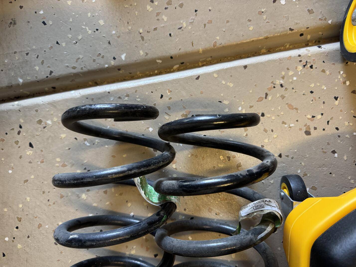

The expected lift that you expect from swapping Rubicon springs onto a Sport is not a thing with the diesels. I got my springs from a donor with the same specs as my Sport (same engine, hard top, tow package, etc) so other than one being a Rubicon, things should mostly be apples-to-apples. Here's a picture of the two front springs together (Rubicon on the left, Stock on the right):
Jeep Wrangler JL Lessons Learned from Lifting a 2021 JLUD frontsprings
I didn't realize there was so little difference until after I had already done the rear, so I sadly don't have a picture of the rears together, but I suspect much of the same. I measured the fronts to be less than 3/16" difference in length when not compressed.
