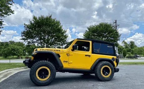

Here goes unpopular opinion. I have AEV spacer lift and longer control arms from mopar lift. It drives great, and its amazing off road. I did pretty hard trails like Trifecta in Moab and had no problems. Only thing limiting my articulation are my stock Rubicon JT shocks (same size as JL) and with current set up I can still add couple of inches longer shocks.

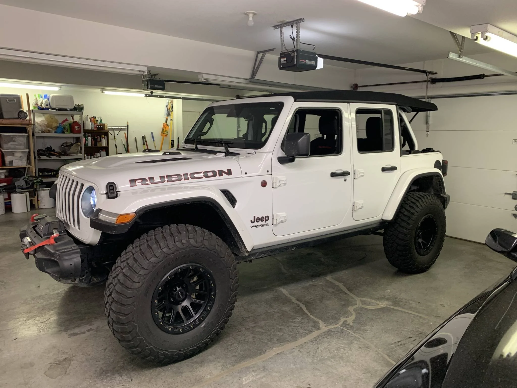

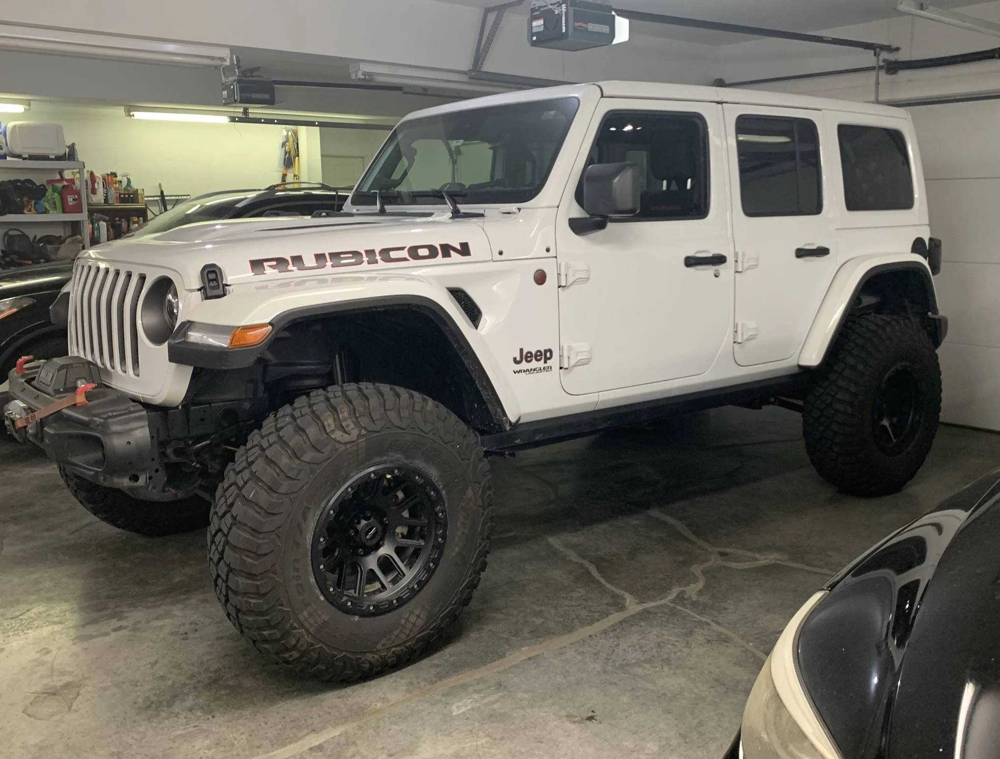

Mc lift:
Jeep Wrangler JL Lifting a Jeep in steps? Is it possible? ED1E0778-070B-4735-AF0F-E9CA60C23B6A
Spacer lift
Jeep Wrangler JL Lifting a Jeep in steps? Is it possible? D221BF33-2FD9-4A1E-8BE1-23C77A2D8A95

Sorry, I meant ride wise or off-road capability. Was there a notable difference?
Offroad capability…Way more flex. The ride for me has gotten worse as I have lifted it. Stock was the best for me. Ik some people have different experiences though!
