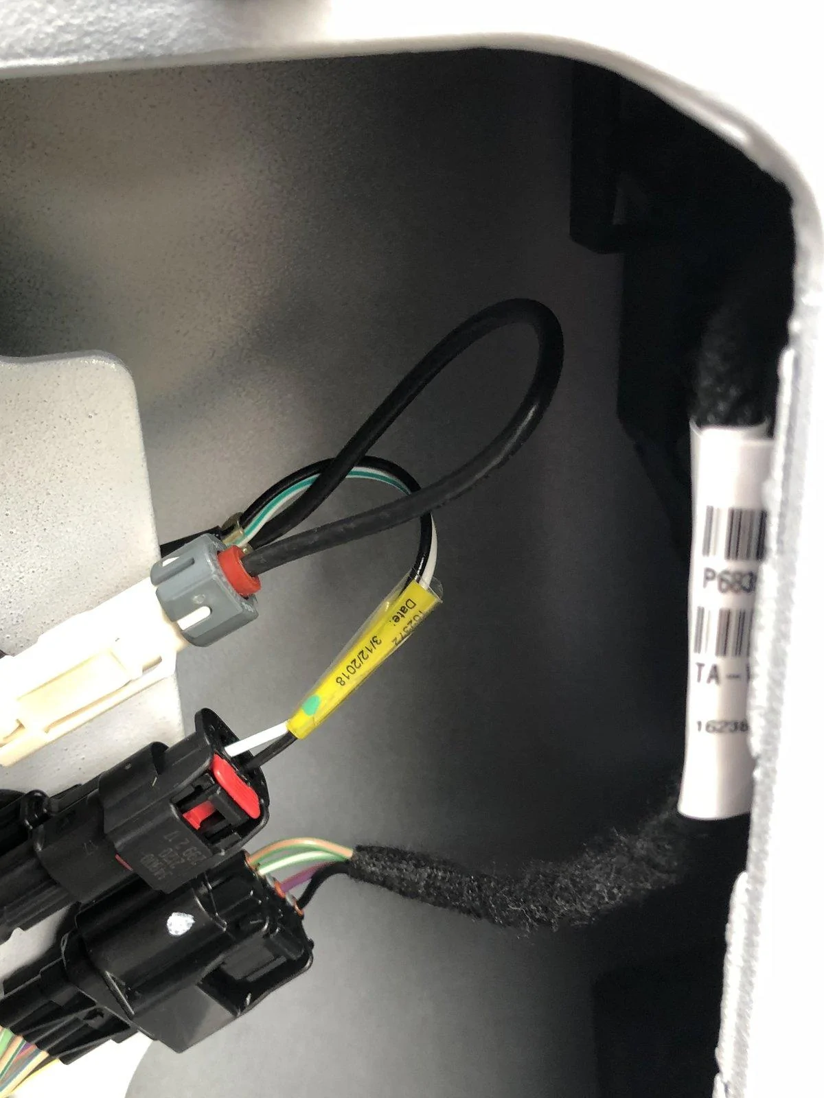

1. Jumper is correct plugs right in
2. Power lock needs to be unplugged (jumper feeds off this). You might be able to reach if you have small hands. Is the prez around? I had to unbolt lock. Took a few more minutes for that.

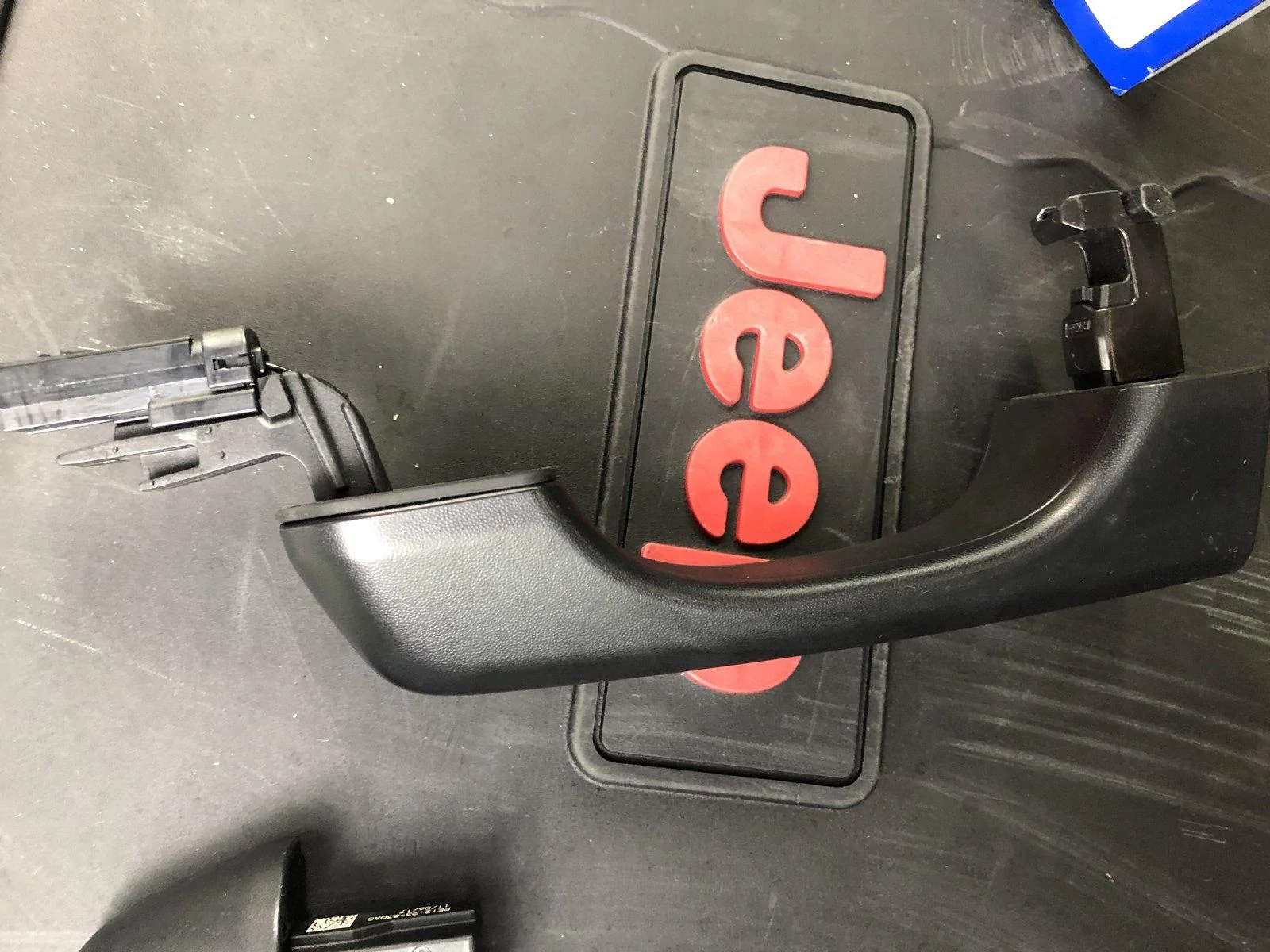

Handle - plug is on left
Jeep Wrangler JL Adding proximity locks retroactively? AAF374A4-A682-4E5E-8072-B775B7F698F1

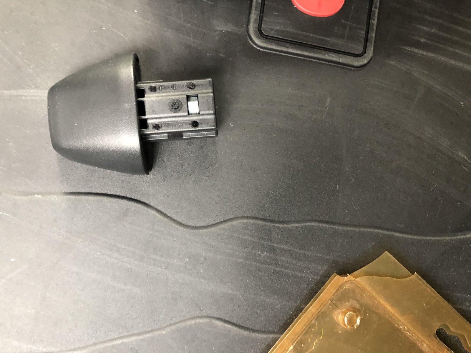

Cap
Jeep Wrangler JL Adding proximity locks retroactively? D70CAEA9-7A2C-4F7A-82E1-072577031E80

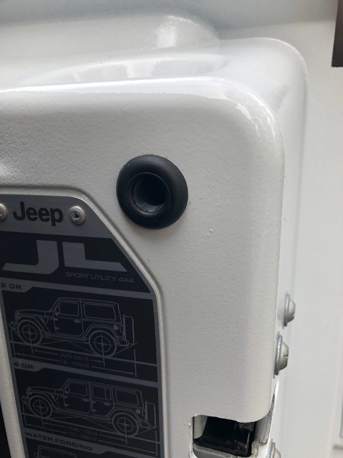

Remove this plug to access torx screw to loosen handle. T20
DO NOT remove screw. Loosen, pull cap, continue until cap comes out.
Jeep Wrangler JL Adding proximity locks retroactively? 0D832C18-5906-4F8A-A326-847A9E8BABD4
harness. Lowest plug feeds power lock. Other end of this is power locks, Jumper replaces this.
