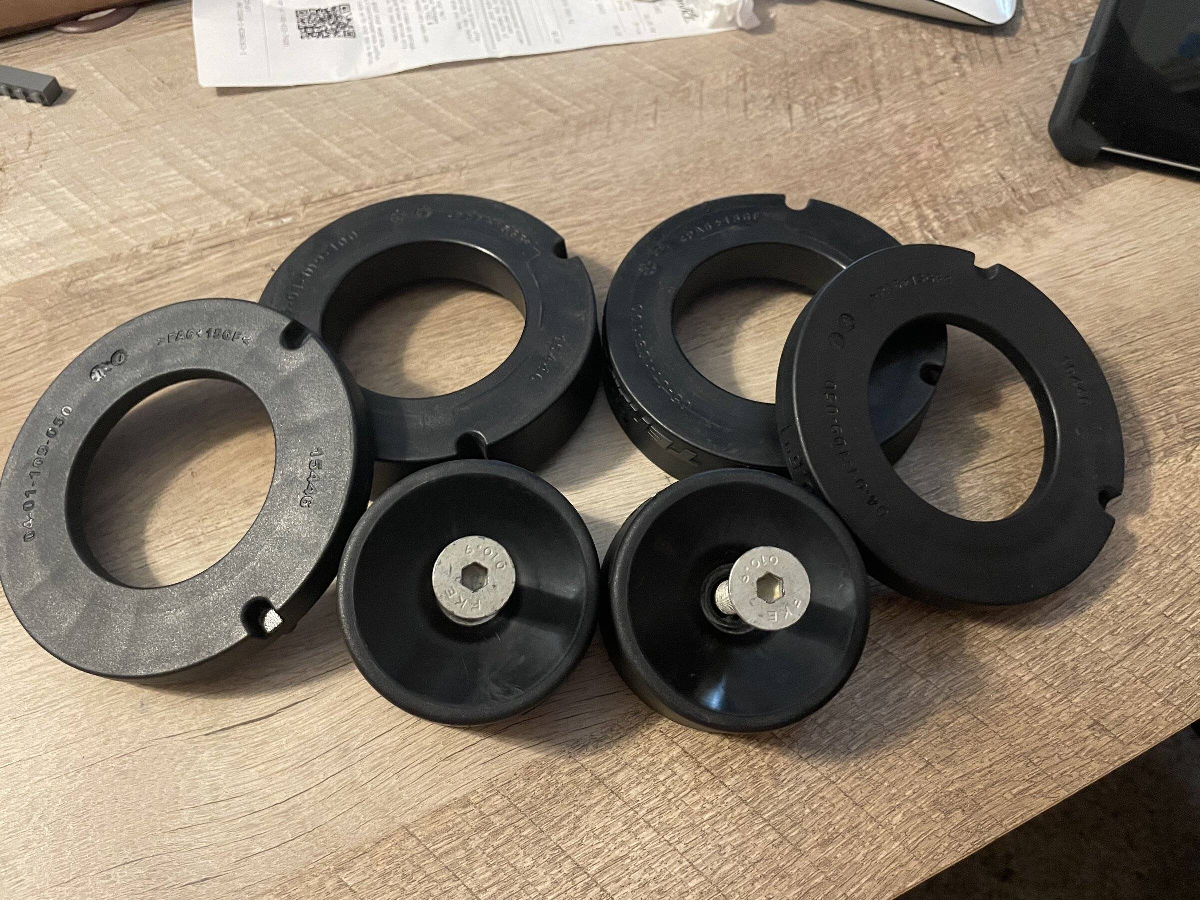

It will act like a bumpstop in some ways, your uptravel will be limited. Based on your tires that might be fine. I think Teraflex rises to the level of quality you don’t have to worry about overcompression degrading the springs.
If money’s no object you might benefit from longer shocks, but I didn’t look up the fox shock max travel.

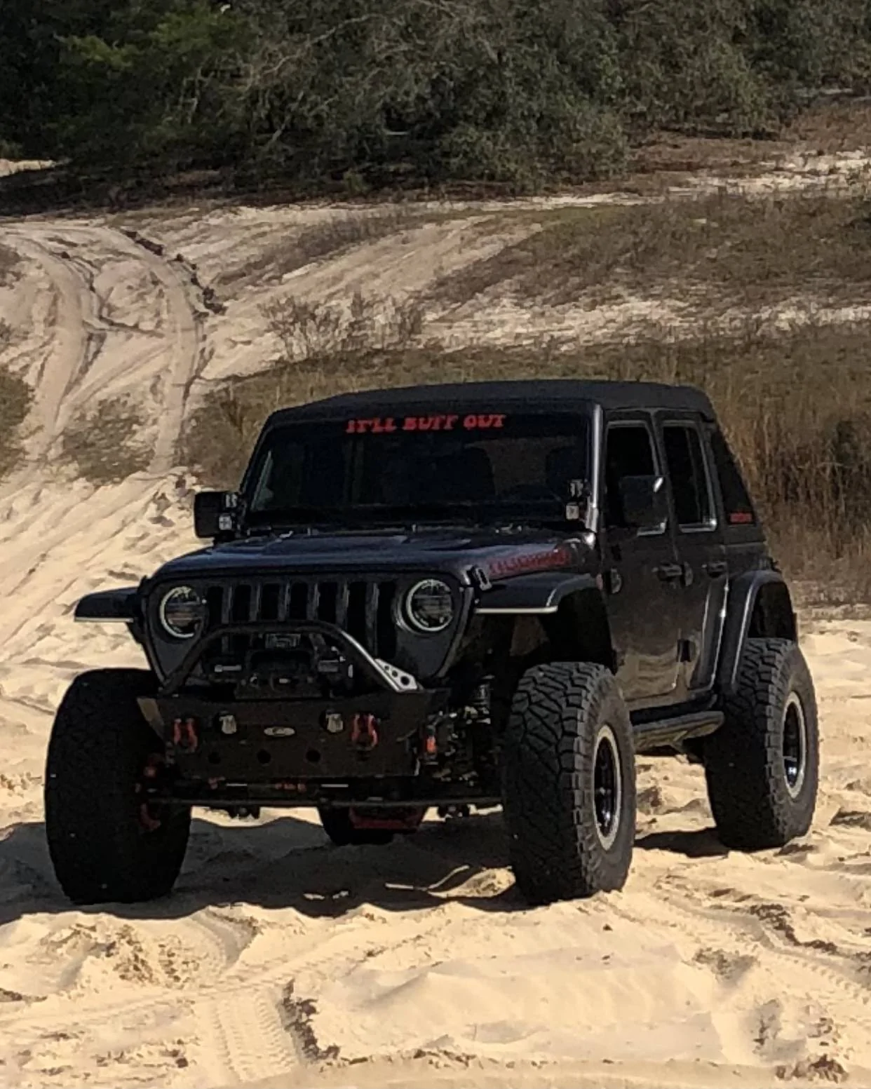

Getting some 37 inch BFG KO2’s to replace my 35 inch nitto ridge grapplers. I currently have a 2.5 inch teraflex basic suspension lift with Fox 2.0 shocks that are good for 2.5-3in lift. I want to add some half inch spacers to my lift to gain that extra space back between the fender and tire. I also have a teraflex geometry corrector. Is there anything else I should consider getting to maximize ride quality? Anybody have experience adding spacers to a coil lift? Thanks

Been running 1/2” spacer in the front on 3.5” RK springs to compensate for LoD steel bumper/winch, near 3 years no issue……

Because we kind of modded ours in different stages and we already had the track bars, steering, and front adjustable lcas to support more lift, and we liked the ride of the icon front springs, we added a 3/4" front spacer when we swapped to rock krawler 4.5" rear springs. With the heavy 37" spare, tools, compressor, and recovery gear that are always in the back, it sits pretty level and ended up at approximately 4" of lift front and rear.

I have used 1/2 spacers to adjust for added weight or adjust height many times with no issues. Make sure and check caster of course. With 1/2 you shouldn’t need anything else.

I've done it. I did 3/4 spacers all around on the molar 2". I added the geo correction brackets and it was good to go.
