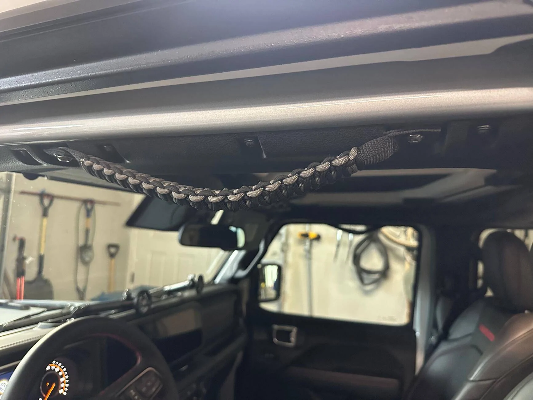

imagine having someone have the grab handle tear out and the person falling and hitting the back of their head and dying.....I also have not seen it advertised for light use or having a weight limit disclaimer...I have bartact handles on my 2024 and shortened them so they fit pretty tight against the roll bar instead of hanging down...makes for a much better pull up...
Jeep Wrangler JL A-Pillar Grab Handle Bending tempImage4z0FDz
