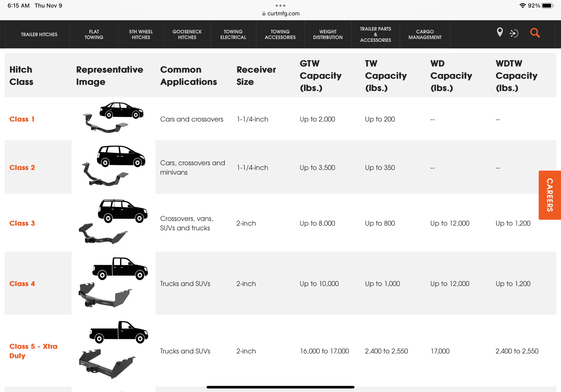

Rough country doesn't list specs, but does classify their hitch as class 3. By industry standard class 3 hitches are supposed to be rated up to 8klbs. Has anyone seen the hitch installed on the European and Australian models? They've always had a 5500lb rating so I'm guessing they don't put the class 2 hitch on them?

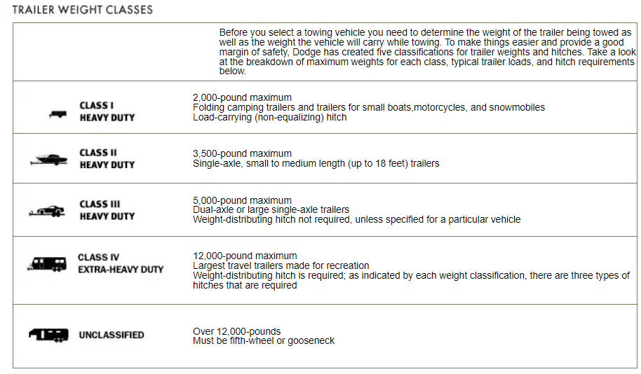

I remember it also being difficult to identify actual hitch ratings on my Ram. It's identified as a Class IV on the window sticker, but the only thing I was ever able to find was a max tongue weight listed on the tow guide.
I cant find a wrangler tow guide, There is a crappy tow info link I was able to find on Jeep's site that has some info:

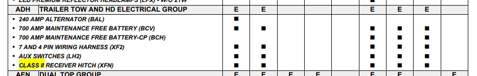

Which we know is erroneous. Nobody has seen one with a Class III hitch.
I still want to see what hitch they put on European models. It can't be the class 2 with 3500ln rating and then they all just tow 5500lbs.

class two hitches are 1 1/4”. Jeep is 2”.
Its a 2” class 2. Listed as class 2 on all the Jeep info.
