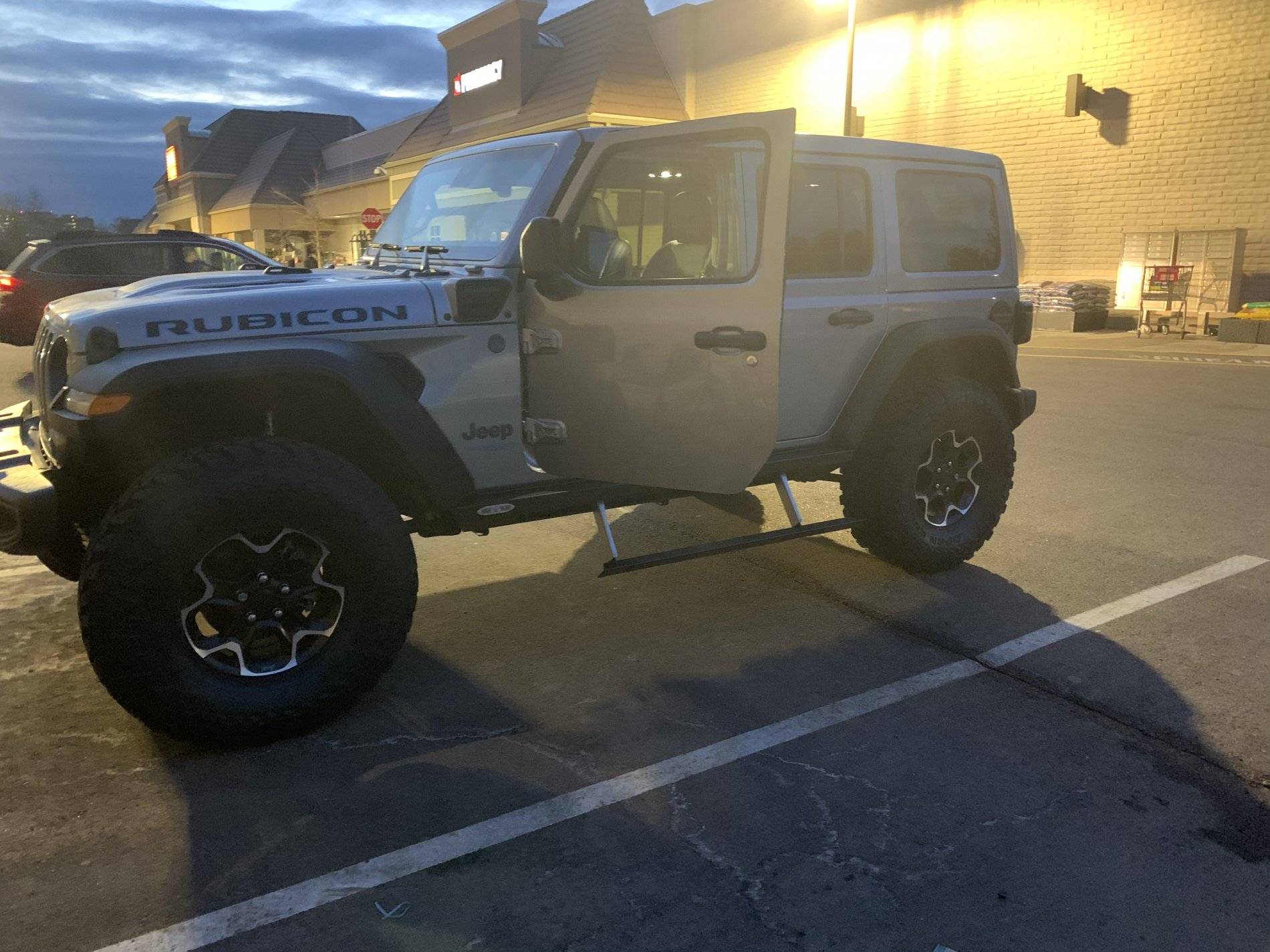

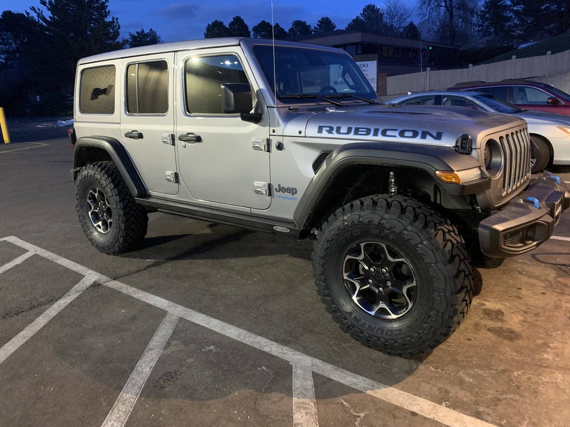

So it turned out they actually used a TeraFlex 3.5 inch lift because the Mopar one actually didn’t fit.
This is interesting. So did you order the Mopar and then when it didn't fit they switched to TeraFlex? And why didn't the Mopar work? Whats so different from the JLUR and 4xe?
Actually, since it looks like you're the first person with a 4xe lift, you post in here so we can talk about the lift specifically
