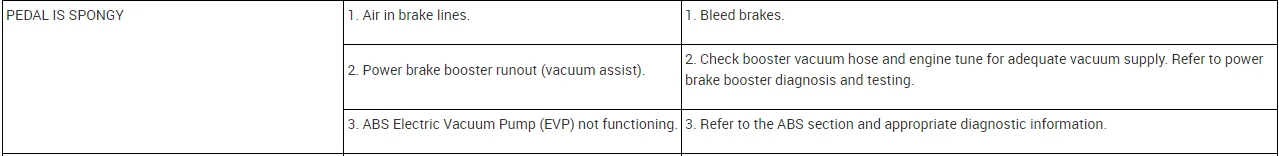

So I hate my brakes when off-roading in 4LO. Pedal goes all the way to the floor and on steep declines barely holding on.
I had some brake fade last year after a long day on the Rubicon but this is different, I have bled all the fluid and upgraded to a higher temp fluid.
It almost feels like the brakes are going on and off when in 4LO. I can hear the rotor grab screech at times.
Anyone experience this!
I had a similar problem and what it turned out to be is air in the ABS system.
A normal brake bleed WILL NOT remove the air trapped in the ABS.
You will need to do a ABS bleed to remove the air.
Here is a video that explains and why.
One note. Do not buy the autel scanner. There is a yearly subscription you have to buy for it to work.
five9dak
Feb 26, 2021
1,008
1,762
PA
Bikini '20 JL Freedom, '99 Dakota R/T, '11 Boxster
While it is normal to require high brake force in 4low, and torque converter automatics can sometimes overdrive their brakes depending on axle gearing and toque converter stall speed, your description of the pedal going to the floor is alarming.
I have had spongy brake issues that could not be solved until I got an ABS bleed at the dealership. I would recommend you do the same. My service writer only charged me half an hour of labor for this.
