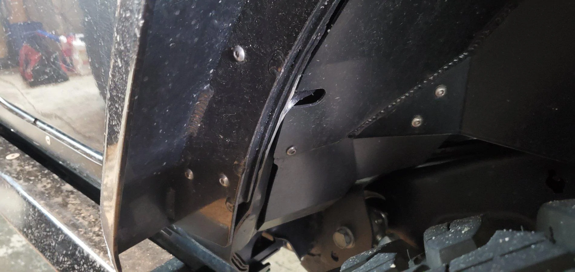

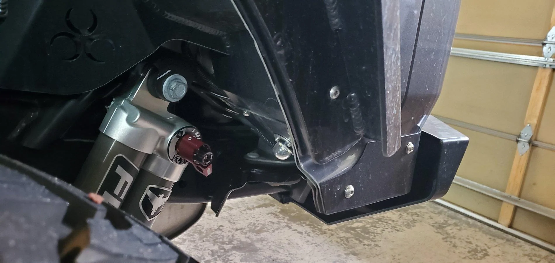

I'm running RK4.5 coils but I think they net 3.5" over stock height because of the way the spring pads are so close to the axle tube on my axles.
The rockers are made by Nemesis. They are frame mounted.

Lowers are set right at 24” right now
If the axle is fairly centered under the bump stop tower I'd say you either need more lift or you need to do some trimming.
Can you take pics of the bump stop tower in the coil?

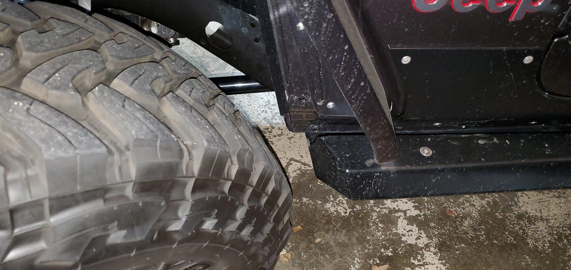

I’m running stock width axles with the KM229 Machete Crawl wheels with 3.5 backspacing.

You can kinda see how my tire would get into the stock fender but I'm running 72.5" wide axles with 4.5" backspacing.
Thanks for your help man! Really appreciate it!

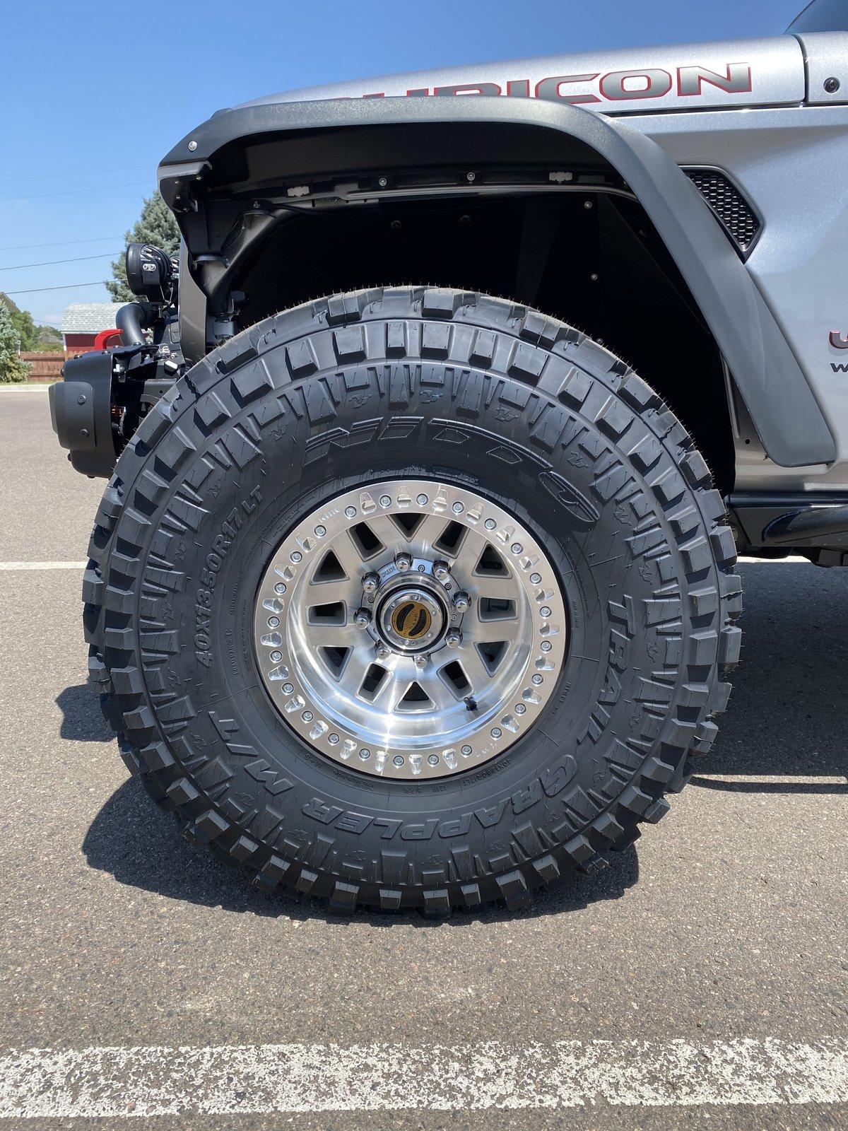

UD60’s and 40” Nitto’s installed. still have some tweaks to iron out this week. Absolutely love how it’s coming together.
