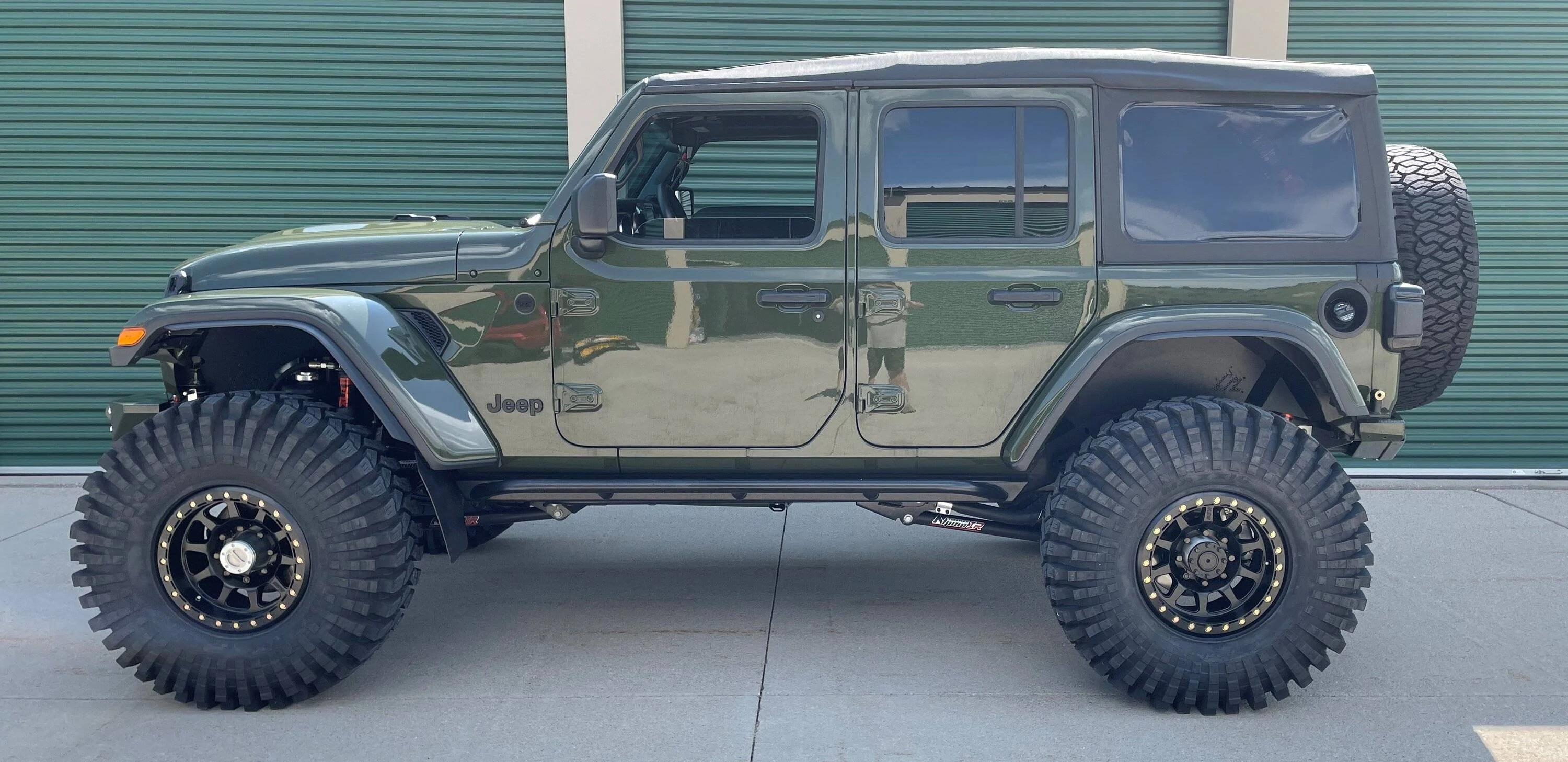

This thread has been a lot of help, especially with the trimming.
The pile of parts in the garage include:
Front RVC - Fad delete
Reid Knuckles
Dynatrack Ball Joints
4:88 gears
Dana 44 Advantek Rear axels
Artec F & R truss with c gussets & lower skids
Apex steering boost
MetalCloak Sector shaft brace & Track bar bracket
Steering box upgrade
40x13.5R17 Yokohama Geolander MT 003
17in Machined Bead Lock wheels
Figured that this build up on the 44's will be enough to drive 99% of the trails I want to, still drive home and be used as the wifes daily daily. Anything more extreme and I'll take the crawler out.
We go on vacation at the end of the month and that's when it'll all be installed.
I'll wait till I get back before I do the trimming.
