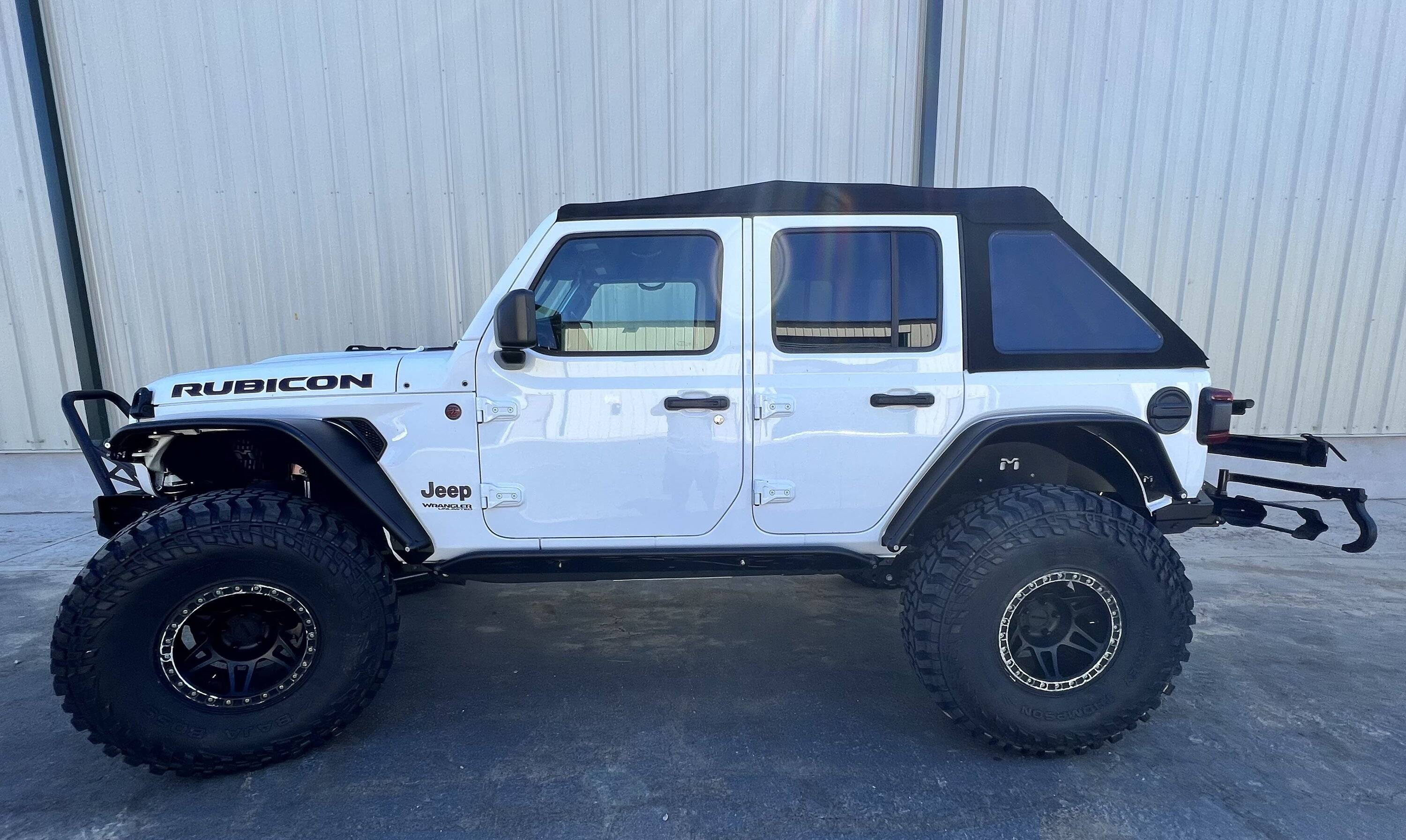

Hey guys, new to jeeps, jeeping. I have a 2021 JLUR. It's currently on 40x13.5x17 Mickey Thompson Baja Boss MT mounted to 17x9 -44/3.5" backspace Method 106 beadlocks. MetaCloak 3.5" GameChanger lift. Stock D44 axels, RCV 300M front and rear (FAD deleted), 5:13 gearing, Reid Knuckles, Dynatrac ball joints. 4, 1" MetaCloak bump stops in each corner.
I'm having pretty good amount of rubbing on the rear pinch seam, and bumper. Bumper wraps around and line up with lunch seams.
I'm planning on doing the MetaCloak 4.5 inch lift soon. Will I still need to trim? Or go bigger then 4.5", or get a different wheel setup with different back spacing. Add more bump stops.
Sorry for all the questions. Just looking for some help other then go buy 1 tons.
Yes I am aware I should get 1 ton axels. But, I'm interested in running the stock D44's at least another year. I do plan on trussing them asap.
The way the rear axle travels up and to the rear, you will most likely need to trim you rear pinch seams. I trimmed about an 1-1/2 on mine with almost the identical set up. No more rubbing, and I only run 2" of bump stop.
Side note, a lot of people will tell you that you NEED one-tone axles. Ask them what their real world experience is before taking much stock in what they say. Plenty of people are running built 44s with 40s very successfully. Ive been through the Rubicon several times now with 40s on 44s and not had an issue. Is there week a point? yes. Is it the pinion? yes. Pick good lines, dont spin and bounce, and have fun.
Nice Rig.
Thanks for the response. Will I need to cut 1.5" off the entire pinch seam circumpolar or just the rear lower portion?
Should just be rear lower section that’s where I made my cut too.

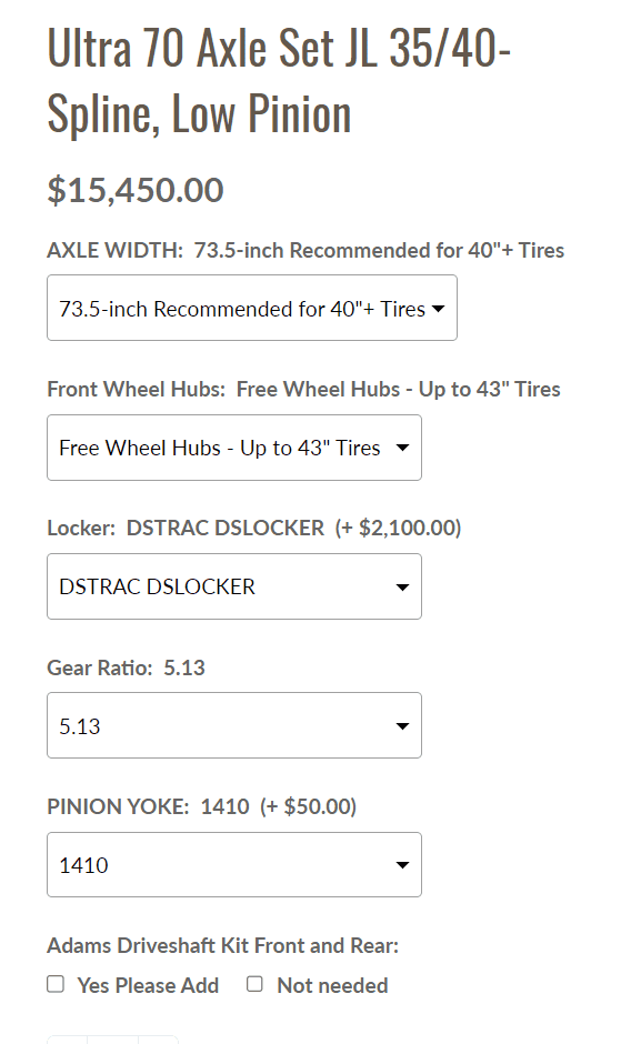

That's 10K into stock, give you can easily sell your stock D44's for $4K. You can get a set of DSTRAC 70's for $15.5K, and they'll install for free. With the coupon code, $15K. You're still $5K ahead .
The dstrac axles are a great deal at their price for sure. 5k is a much more palatable price than the extra 10k+ of the other options.

Go 4.5 springs and trim 1.5" off the pinch, should be good to go. I've ran this set up 4yrs no issues, wheeled Moab, Sandhollow, Windrock, more times than I count and always run hard lines.
