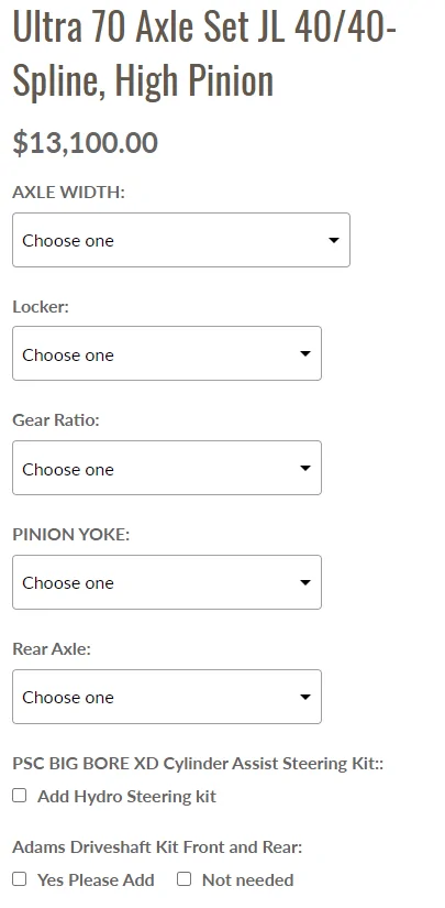

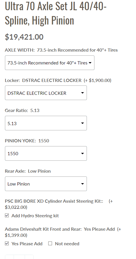

DSTRAC are cheaper and you get 70's rather than 60. I'm going DSTRAC HP front, LP rear. And they're the size of 60's.
Hey Joe,
Interesting approach to choose DSTRAC... the kit even comes with 2.5 Ton Aluminum Steering kit! ...
Would you mind elaborating why you went with High Pinion front, Low Pinion rear... also.. I wonder if you can elaborate on the options on the DSTRAC website ... Thanks!

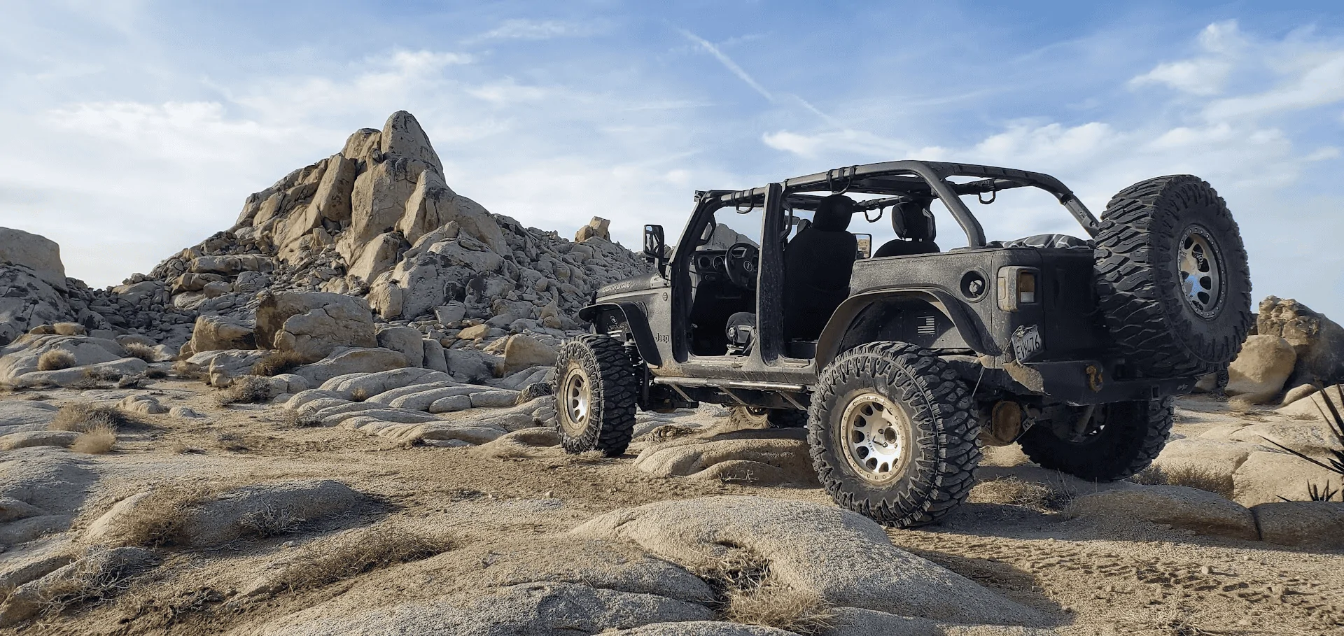

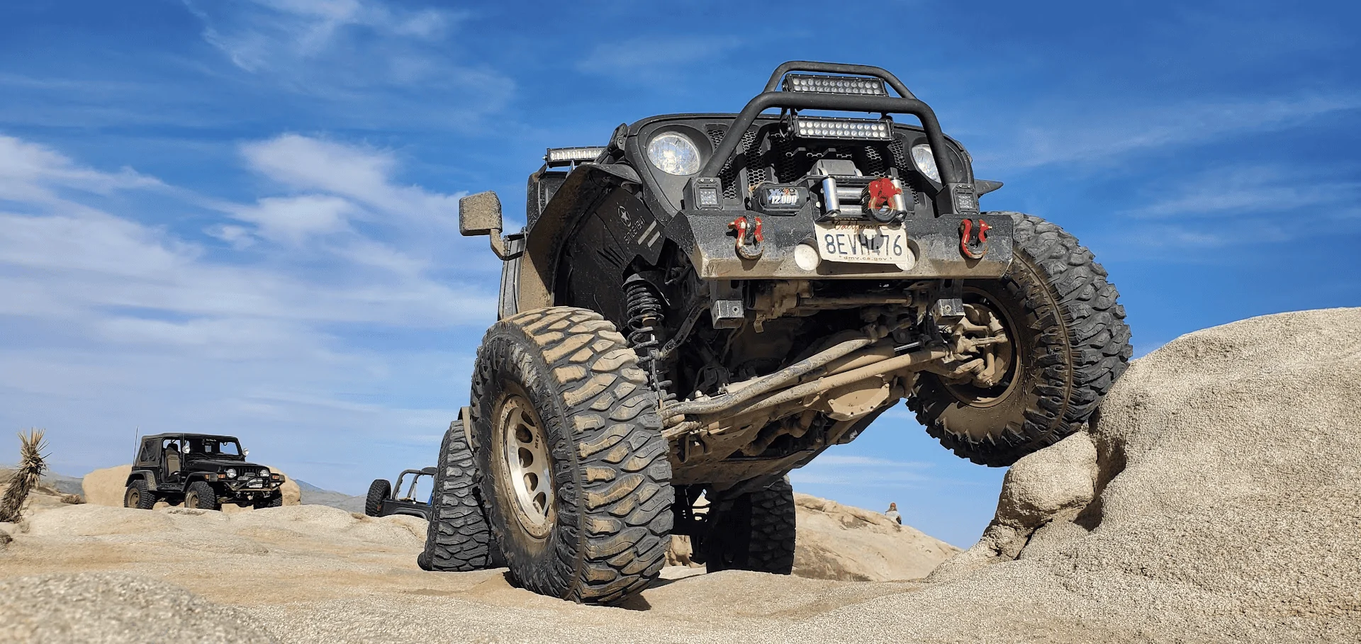

and BTW.. I also run 40s on stock axles (and I mean stock.. the only difference is that I welded Artec trusses to the front ) .. MC 3.5 Gamechanger springs.. Method Beadlocks with 4.5 backspace
Here I am at Cougar Buttes ni Califonia.. there are some tough trails there... I need PSC HydroAssist! LOL
Jeep Wrangler JL 40'S on your JL 1646356935798
Jeep Wrangler JL 40'S on your JL 1646356986487

Hey Joe,
You want high pinion in the front for a couple of reasons. First is strength over low pinion. High pinion reverse cut gears up front will be stronger over low pinion because of how the pinion teeth push the ring gear. Opposite of that is strength in low pinion gears in how the push the gears in the rear.
High pinion up front gets the drive shaft up away from the ground better. Usually leads to better drive shaft protection and better joint angles.
Options are pretty self explanatory, did you have any specific quesitons?
Not sure if it's true, but I've been told the ring gear/pinion is strongest closest to 5:1
The Ruby 4:1 xfer case and automatic transmission gives me plenty of crawling torque.

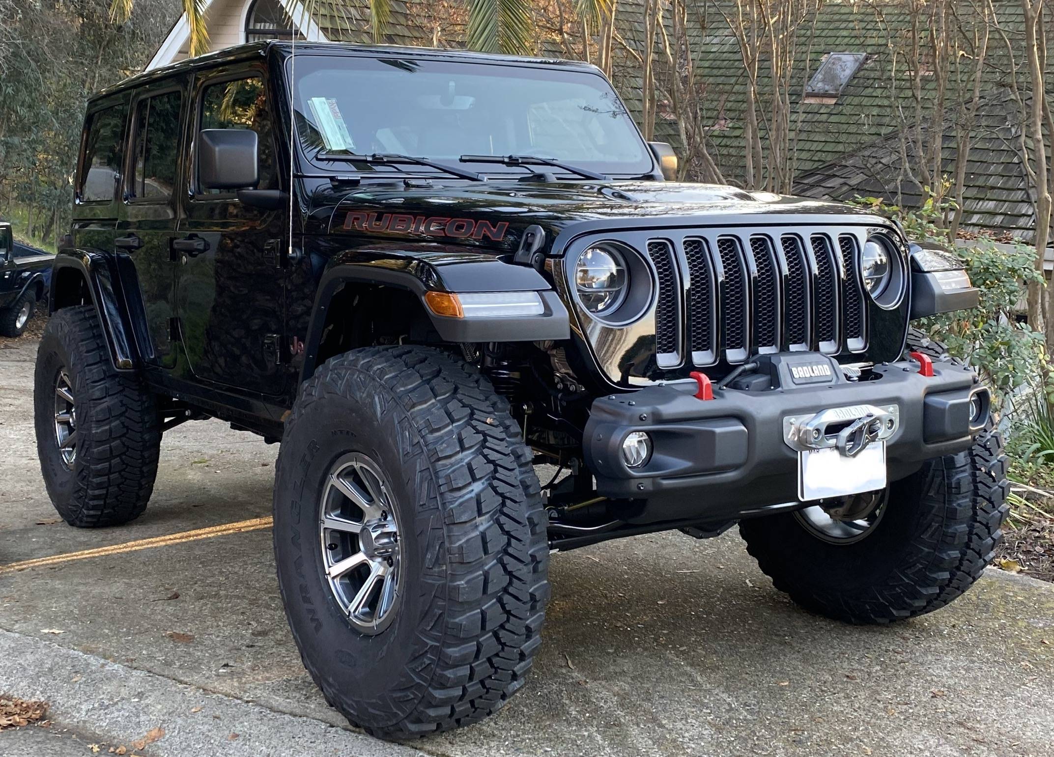

My XR with a spacer lift and 12" travel shocks. 18k miles on 40s no issues. I may go to a 1 ton setup soon. Depends on a few factors.
Jeep Wrangler JL 40'S on your JL IMG_20220625_144026_146
Jeep Wrangler JL 40'S on your JL IMG_20220625_144110_802
