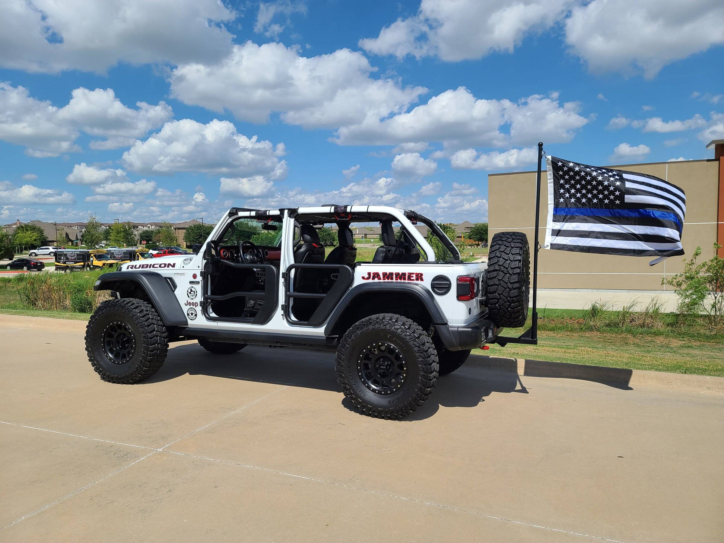

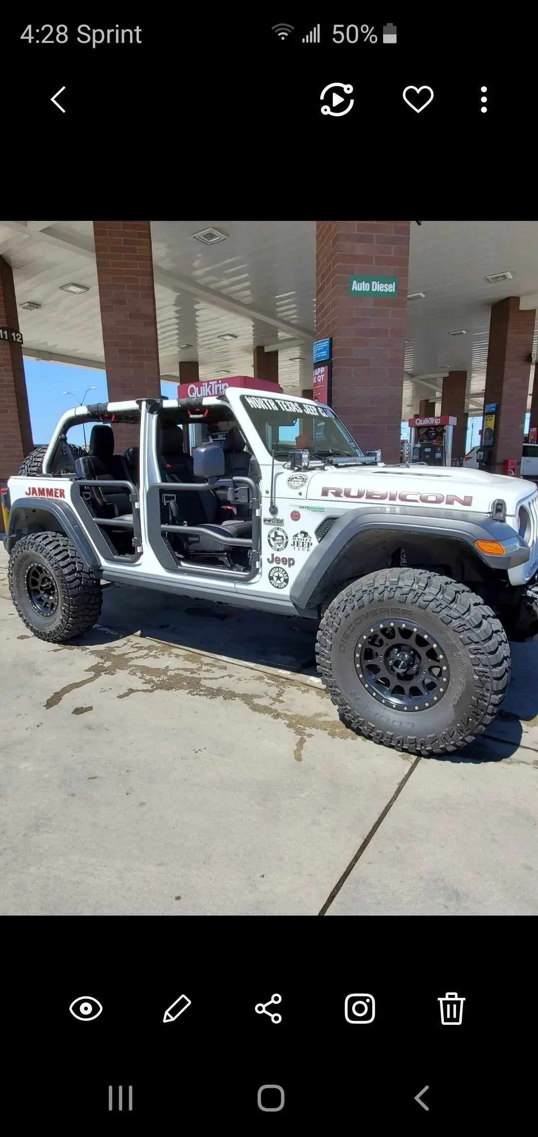

$20k for tons NO THANK YOU. I don't need them that bad my 37s can do just about everything the 40s do because a lot of it is driving and the driver. And I will spend my $20k on something else that can excite me a whole hell of lot more then just going 3 inch's on tires and and the extra weight with it. Hell I could before the chip shortage find me a used older Jeep and fix it it up before I spend my $20k for 3 inch's on tires lol. I know several people that have done it just for looks how sad $20k more for looks and bragging rights. Hey look at me I've got 40s lol How sad !
