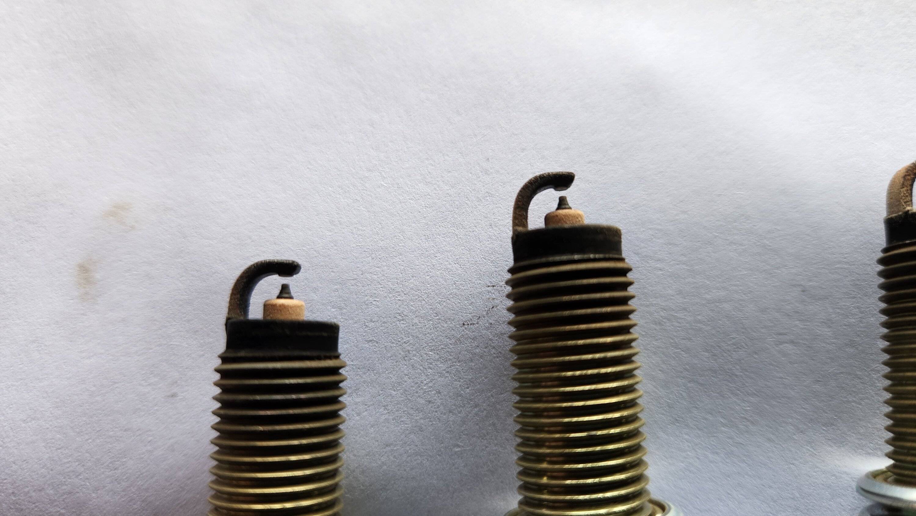

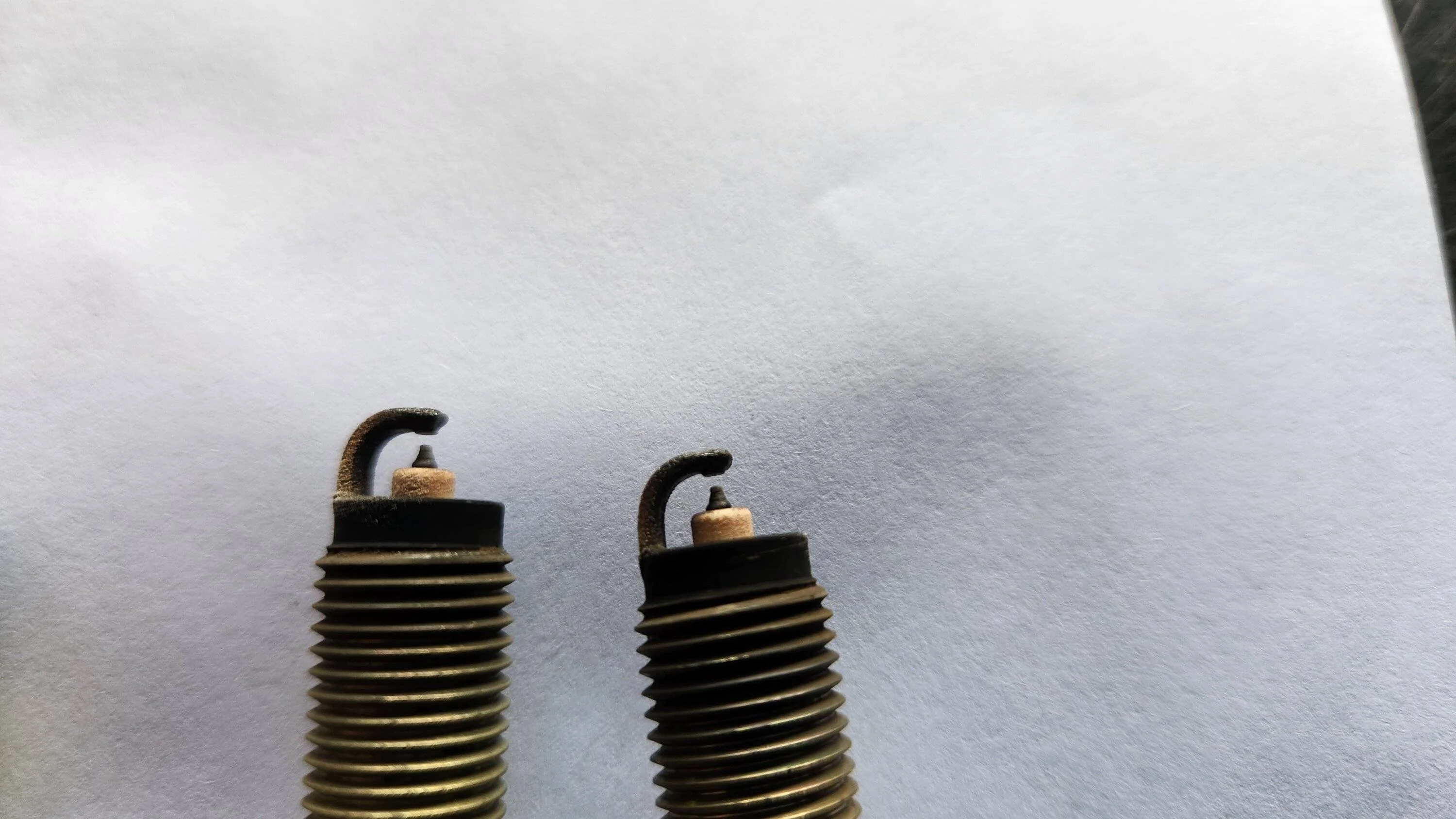

you can’t tell the difference between picture one and picture two ? Light and dark. NGK made the chart. Contact them and say you see no difference in the spark plugs lol You better stick to letting a mechanic do your work for you.
Blown up to 3-4 times the original size, these plugs all have different characteristics. Have they quit teaching how to read in CA too now?
LOL Since you obviously believe these are the actual sizes of a spark plug, LOL you better stick to LOL letting a mechanic do your LOL work for you! LOL LOL BRO Contact your wife who has a penis and have him check things out for you. You obviously believe that ALL of these pictures are EXACTLY what a spark plug will look like, the size and detail are 100% accurate to EVERY scenario.
You're VERY sexist and coming from a CA person, that's UNACCEPTABLE! I'm a girl!

I wonder what is eating away at the top of the insulator?
mwilk012
Mar 10, 2018
11,062
11,428
Oklahoma
2018 Ocean Blue JLU Rubicon
Service
That is Mopar brand dielectric grease.
There is absolutely nothing unusual about these plugs and they would have gone another 60k just fine.

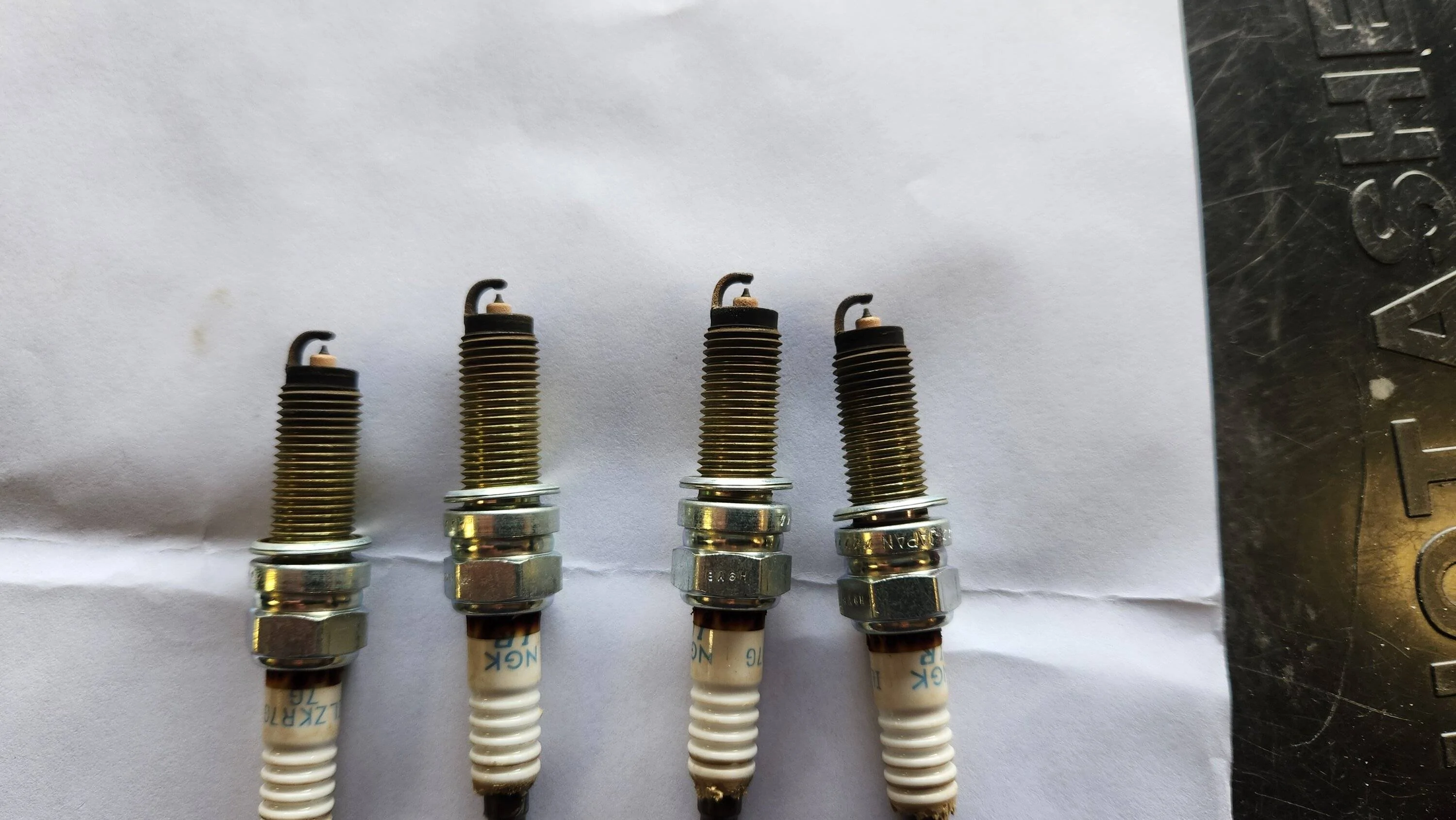

Finally got around to doing mine. Ment to get it done @ 60k, but life shit kept me tied up until this weekend.
Here's what 70k mile plugs look like:
Jeep Wrangler JL 40k Spark Plug Change - 2.0T 20240310_094841
Jeep Wrangler JL 40k Spark Plug Change - 2.0T 20240310_094846
Jeep Wrangler JL 40k Spark Plug Change - 2.0T 20240310_094850
No error codes or miss-fires, still was running strong. Oil test from Blackstone came back perfect.
Visually they look really good for the mileage. Not much carbon and looks like the mixture has been darn near perfect.
But I think I got to it just in time as those electrodes are about done.
Replaced with NGK's.
They're Iridium plugs. The electrodes will look tiny from new. Provided the new plugs were the same as the originals, their electrodes should appear identical.
Yeah, I thought they looked degraded using mark one eyeballs. But when I looked at the pictures zoomed in I realized that, except for the color, they looked the same as new.
