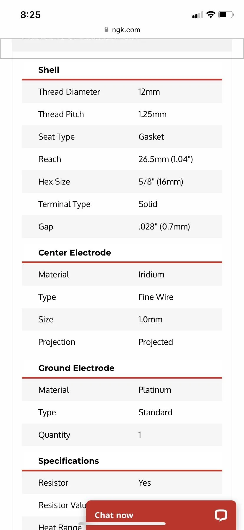

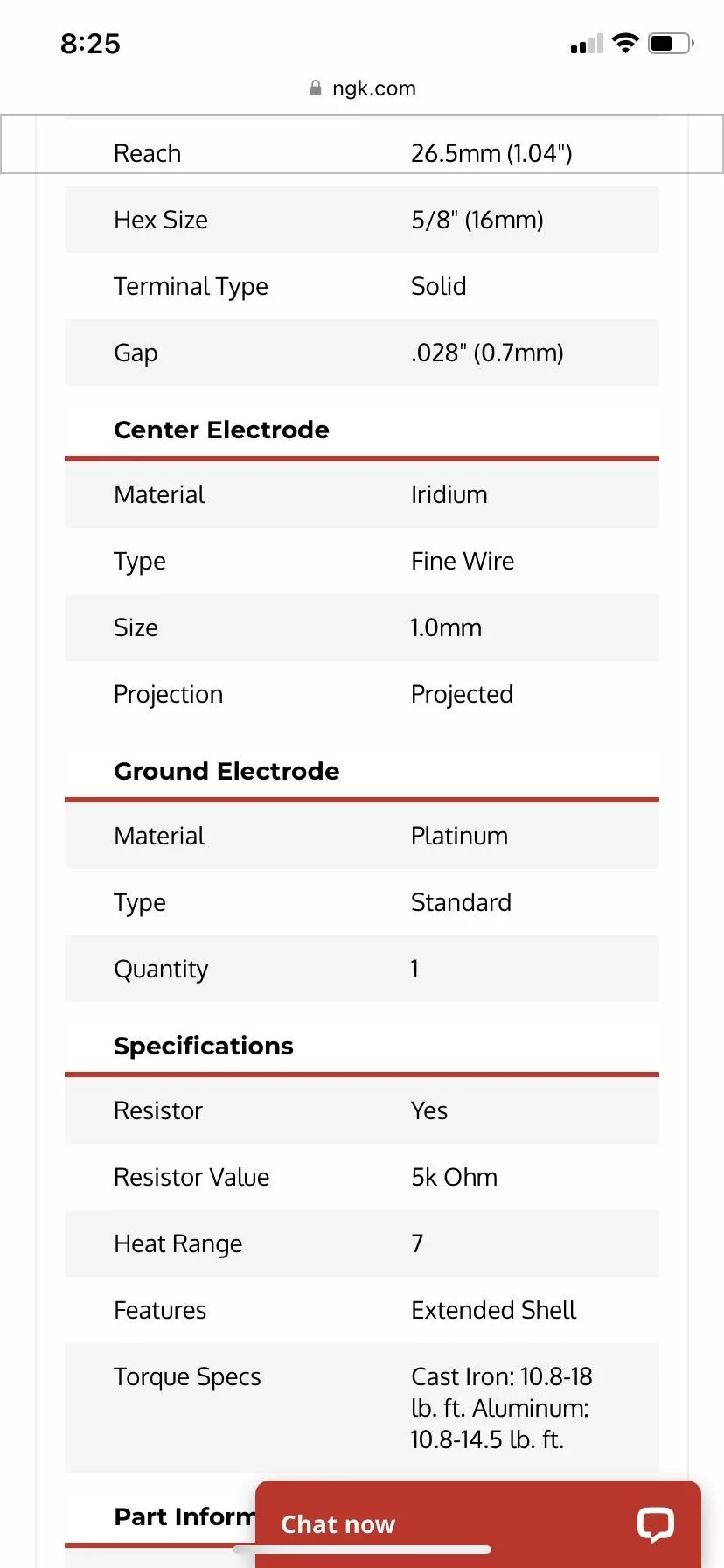

What’s the 2.0 plug torque spec? Thanks
The spec sheet is from NGK for this part number. The torque spec is at the bottom of the 2nd screen shot. The second screen shot is from over on the Alfa Giulia 2.0 forum, (different cyl head but same plug) an Alfa tech based in Italy. He says 168 in lbs/14 lb ft.
