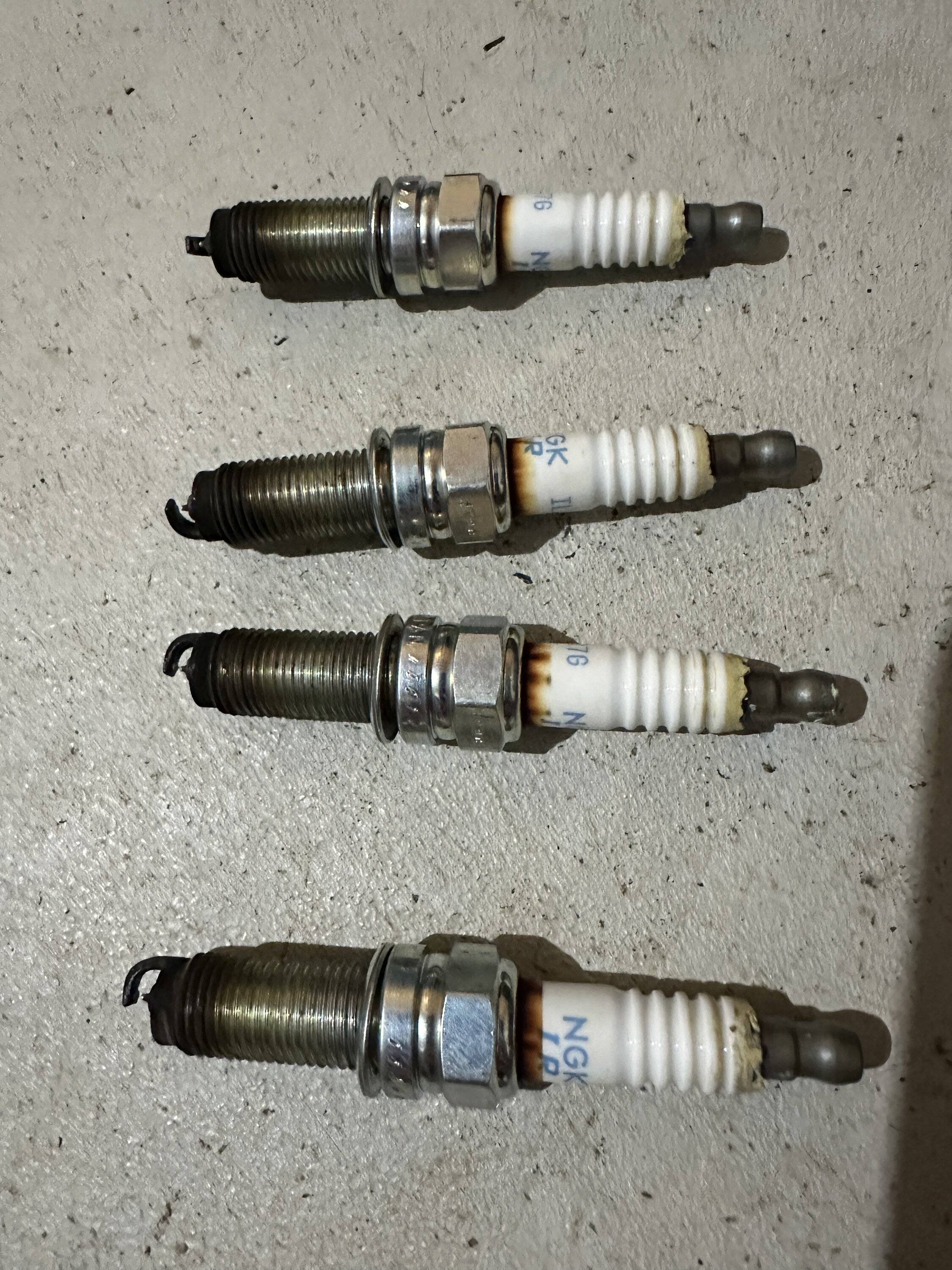

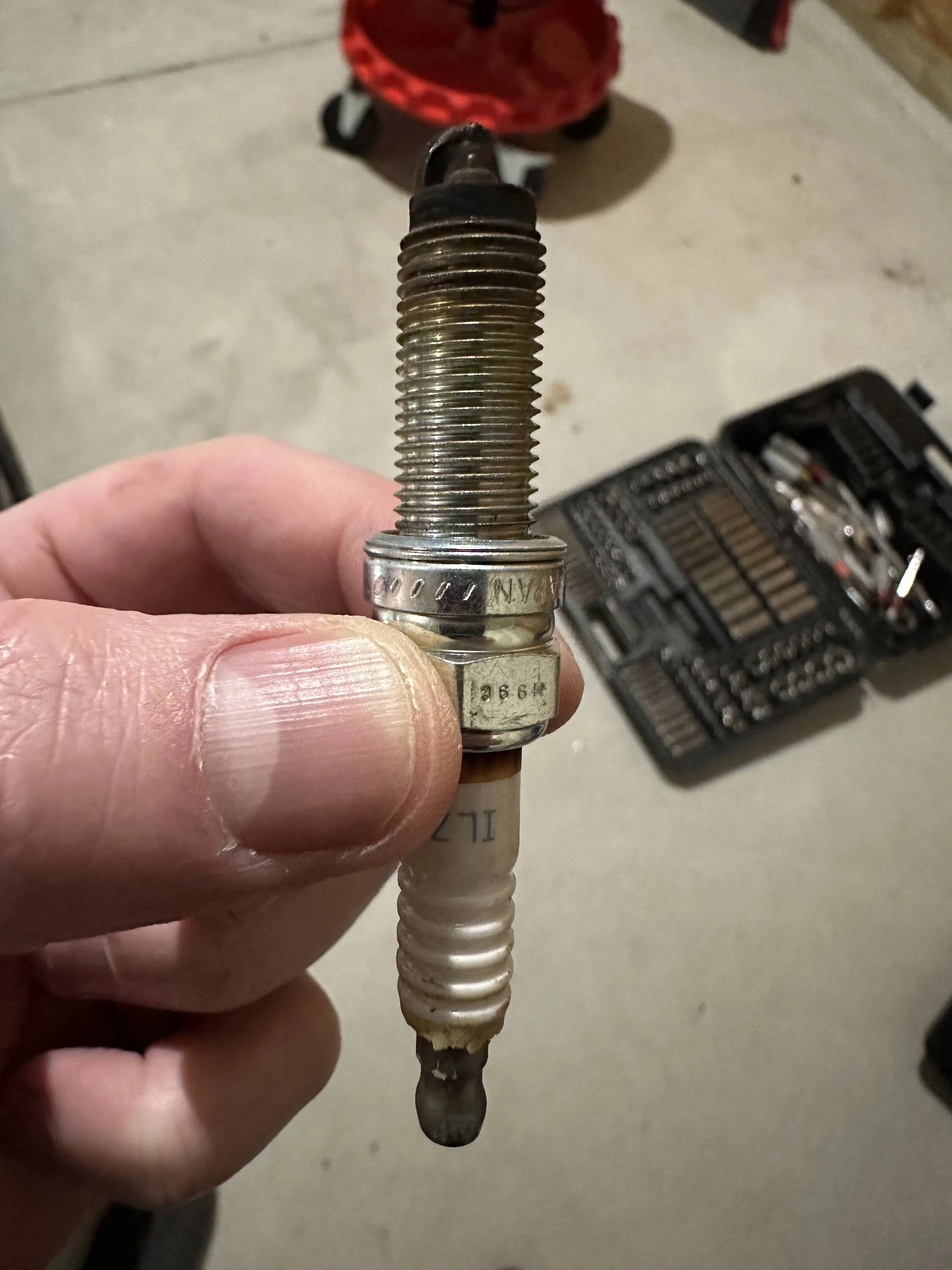

Decided to be a little proactive and swap out my plugs on my 2.0T since I just hit 40k.
Wanted the forum’s opinion on how these old plugs look.
The insulator material by the terminal is busted up and the plugs themselves look crispy.
If this is normal for a 40k mile 2020 daily driver and I’m being overly anal then I’ll just shut up ?.
On a positive note the Jeep now runs smooooth!
Thanks for your time!

I don't necessarily know about "normal for a 40k mile 2020 daily driver" but they're very normal for a turbocharged high compression direct fuel injected engine at 40k.

I did mine last year about 10K miles sooner than you did and I like my skinny pedal more than most, but they looked pretty clean in comparison.

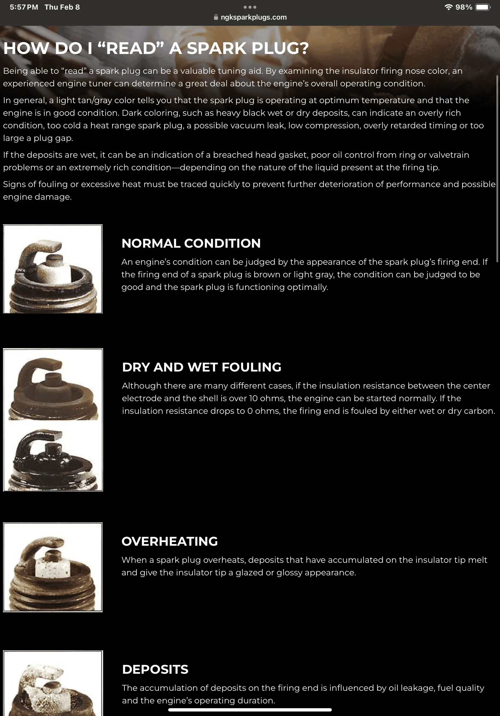

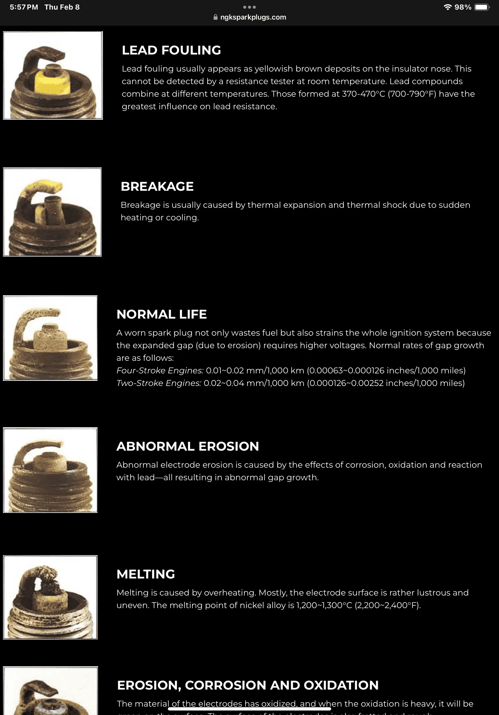

Blown up to 3-4 times the original size, these plugs all have different characteristics. I would not be able to differentiate between any of these (except maybe melting) on plugs I pulled out of my Jeep, they'd all look the same.
you can’t tell the difference between picture one and picture two ? Light and dark. NGK made the chart. Contact them and say you see no difference in the spark plugs lol You better stick to letting a mechanic do your work for you.
