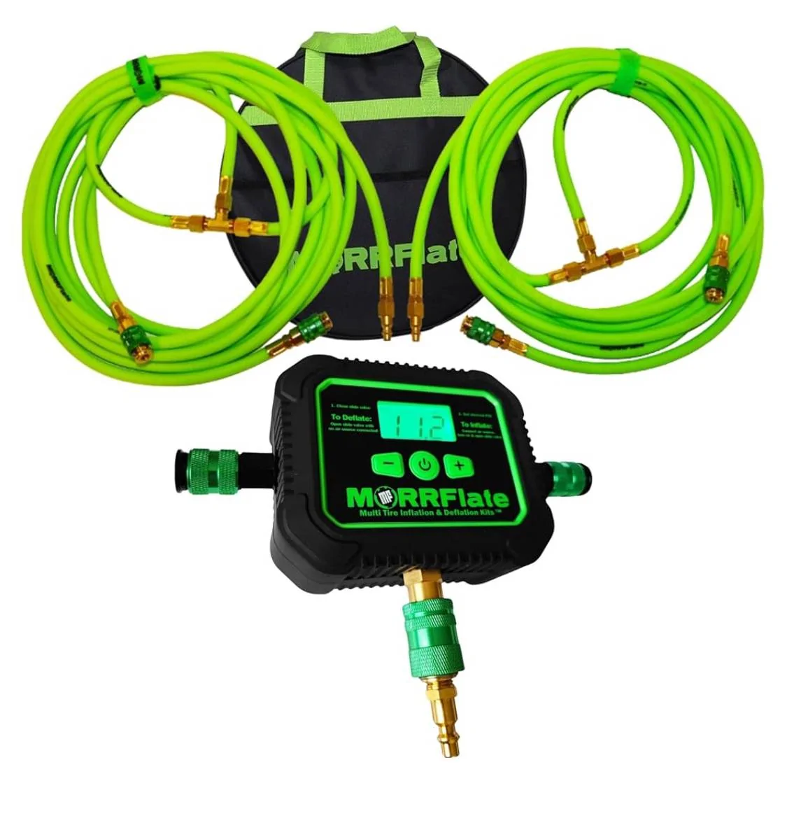

I have two friends with the Morrflate and I have a Viair 400P and the Morrflate inflates 4 37's faster than I can air up two 35's. They are nice.

Happy Morrflate 4way airhose customer, I just installed my own analog dial. Any 4way is a great way to air up and down. We originally used it with a SmittyBuilt until it imploded. Now using the Morrflate compressor without auto off and everything is much faster.

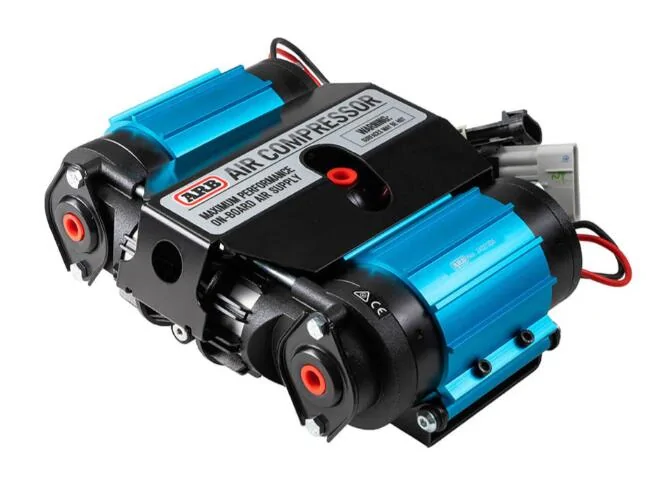

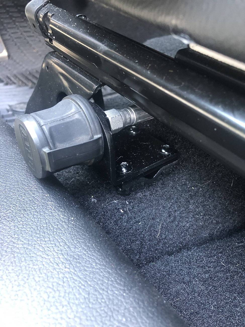

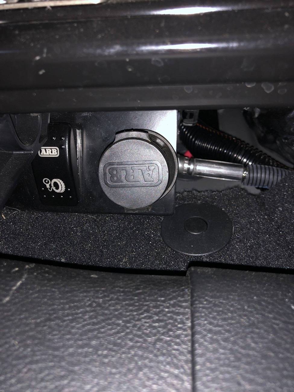

ARB Twin with the ARB under seat mount on the passenger side. I added a T fitting and a short length of braided stainless hose to the drivers side. Used a piece of flat aluminum stock to make a cheap mount on the drivers side. I use two of the Morrflate duo hose kits that I shortened the hoses on

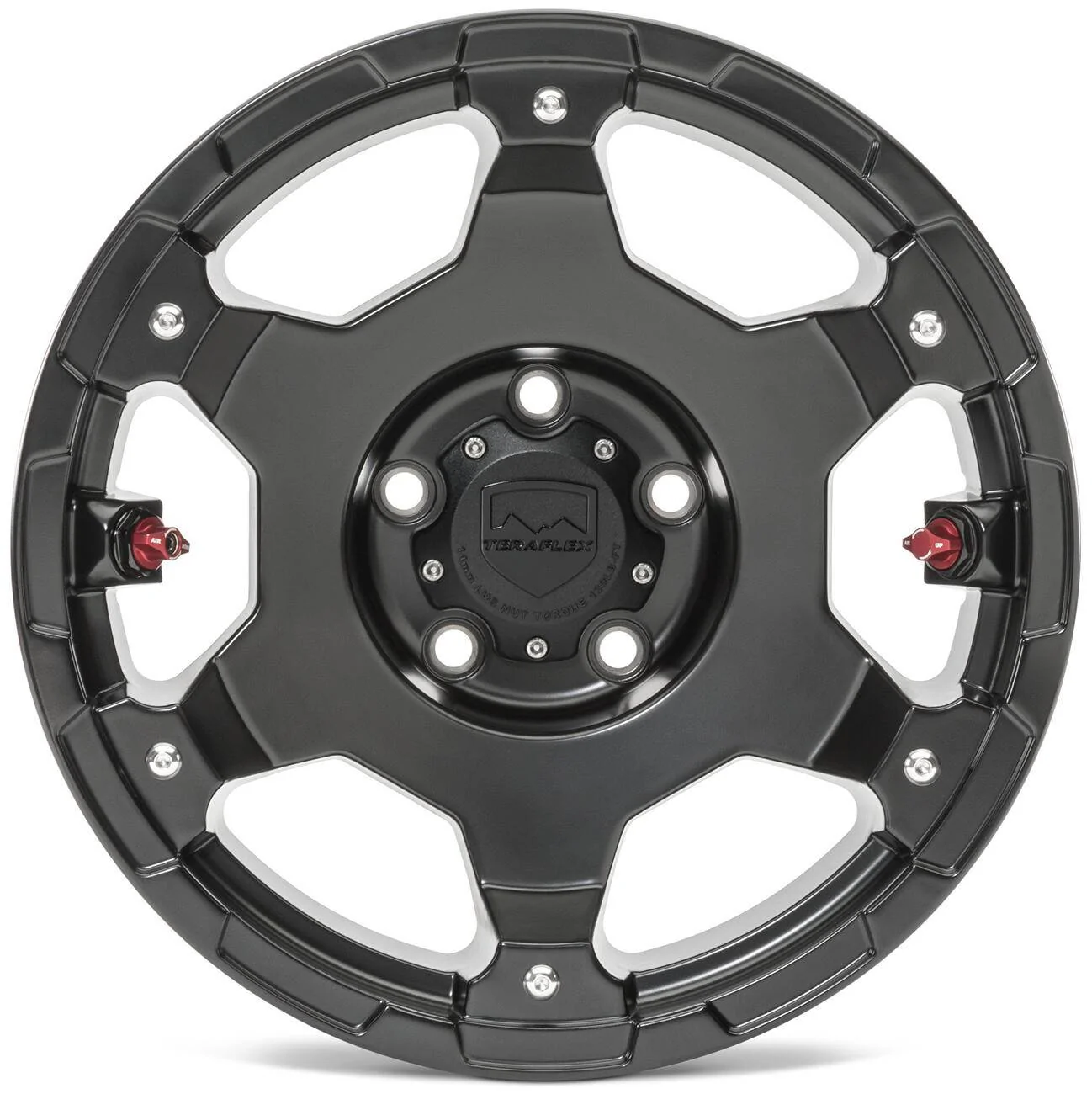

TeraFlex Nomad rapid deflate wheels

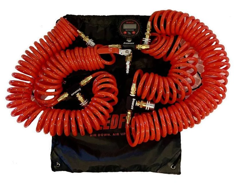

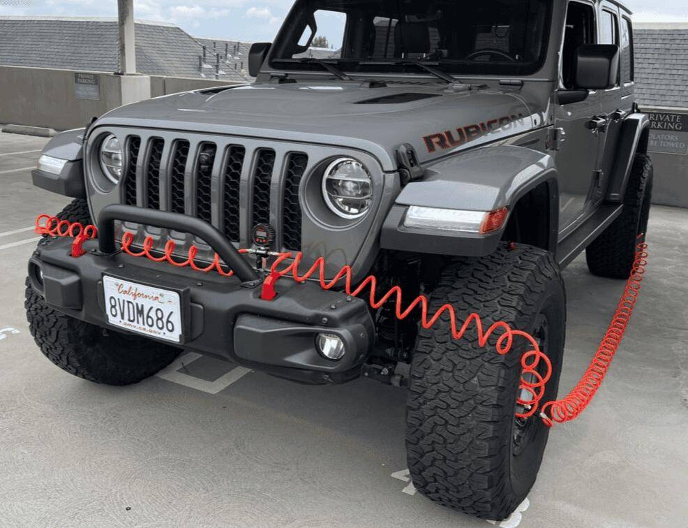

ARB twin, 1 gal air tank, and Speedflate 4x

I'm not where I want to be yet. But I have Apex Designs RPV rapid deflators. I couldn't be happier with those. I can air down my 37s in about 10 seconds each, not counting screwing the cap on and off.

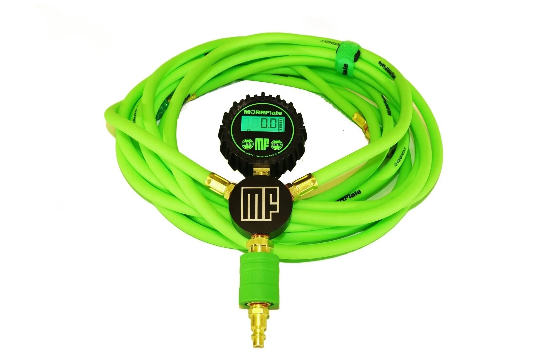

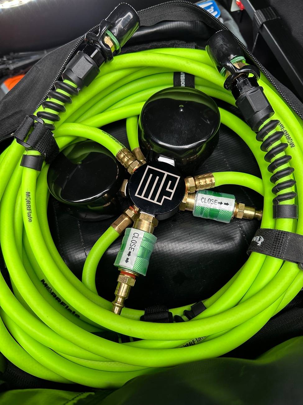

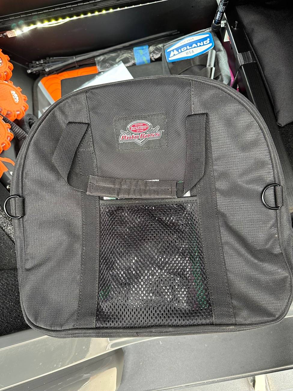

I shortened my hoses using Flexzilla fittings. The hoses are only a foot longer than the farthest the valve stem could be on each tire. Not the cheapest setup but I’m not dragging the hoses through mud and dirt. I store them in a Bucket Boss jumper cable bag
https://www.amazon.com/gp/product/B009TCDKXY/ref=ppx_yo_dt_b_search_asin_title?ie=UTF8&psc=1
https://www.amazon.com/gp/product/B0146WQP3I/ref=ppx_yo_dt_b_search_asin_title?ie=UTF8&psc=1
I usually throw the hoses in the back of the Jeep after airing up and deal with them in an OCD manner after I get home.

I bought a couple of these hoses that I use now. I haven't even trimmed them yet. But I like the hose material itself. After a couple years, it's holding up well. I think I'll make up more convenient lengths and install the compressor under the seat and put in the QDs on both sides like you did.
