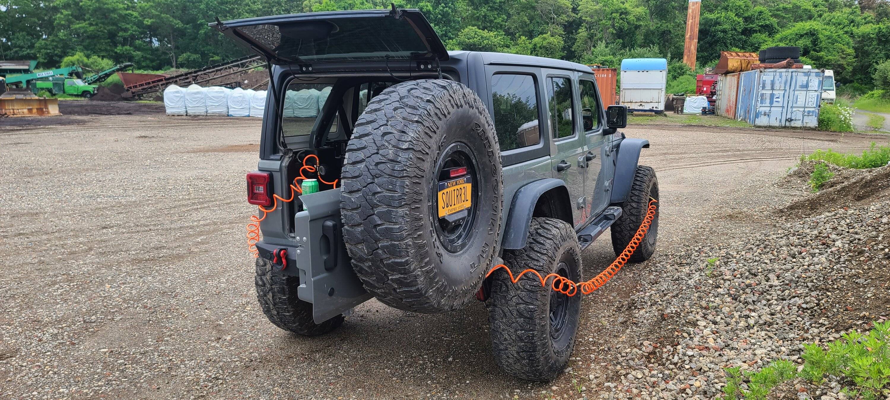

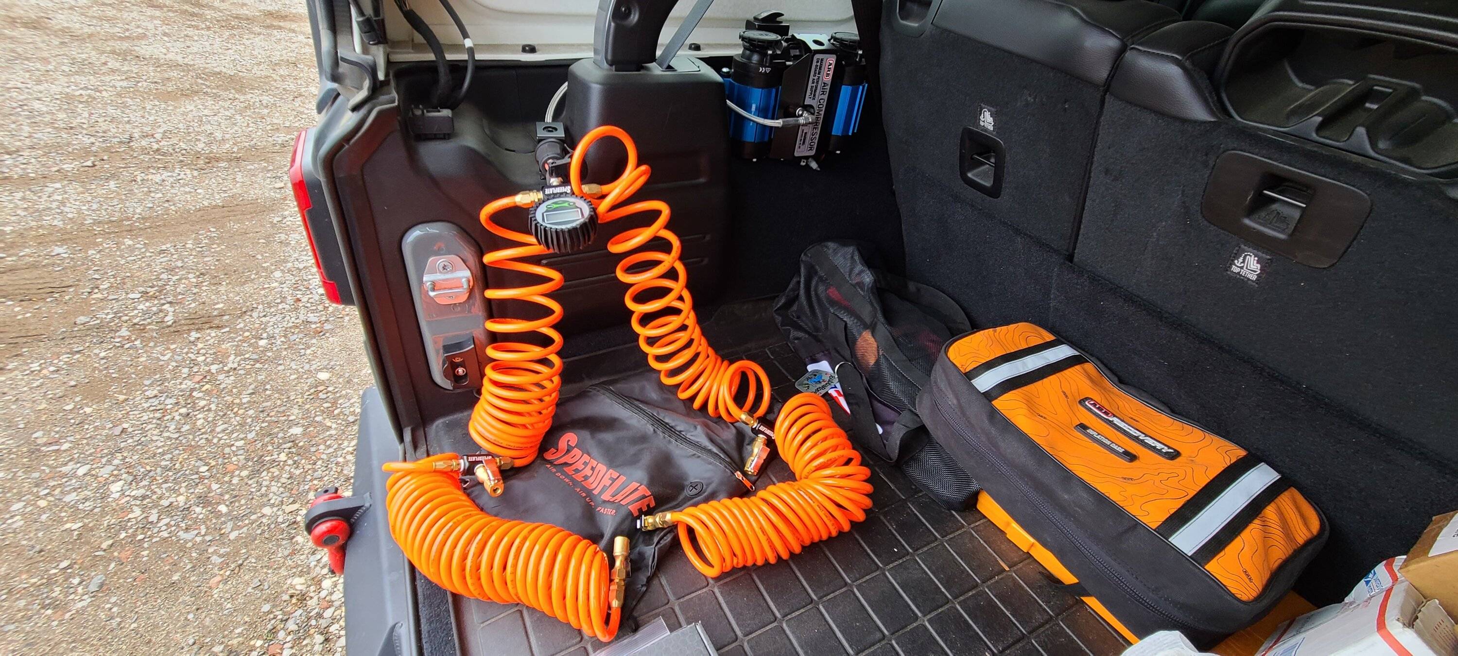

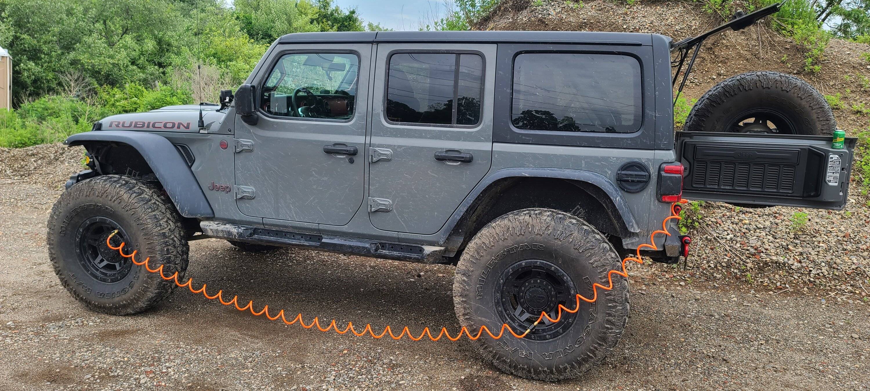

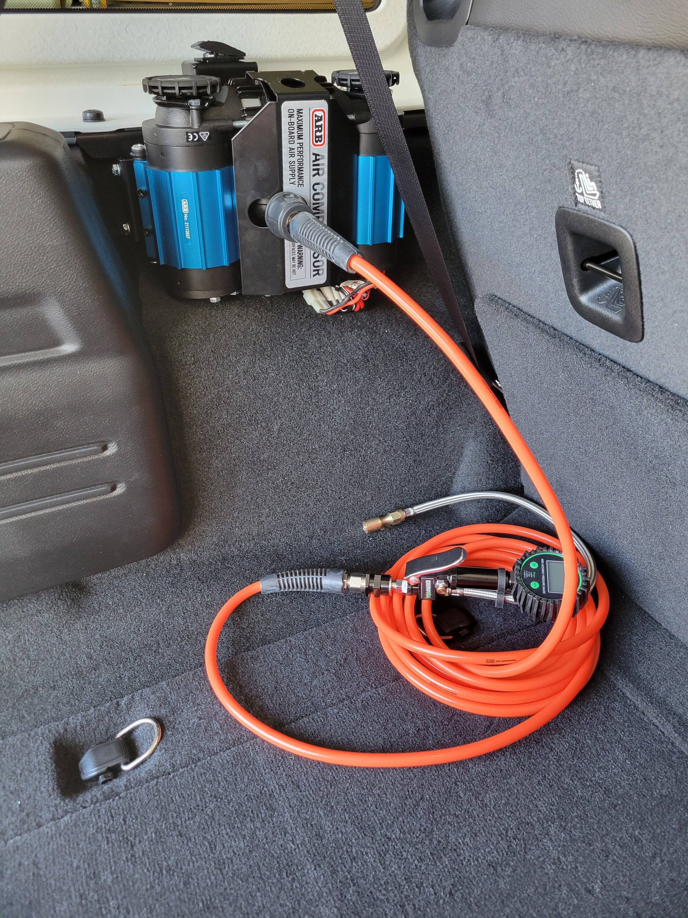

The ARB twin compressor can definitely handle all 4 tires at once. I also have the same mount. Only difference between our setups, is I added a .5 meter long stainless braided Teflon air line and an ARB remote mount for the chuck. The purpose is two-fold. Not only does it move the chuck closer to the tailgate for easy access, it also gives the hot compressed air a chance to shed a bit of heat. This results in the fittings or 4-tire manifold from getting pistol hot.
Here's a couple pics that include my Speedflate 4-tire inflate/deflate setup hooked up to my 40's. And courtesy of the ARB twins 100% duty cycle, I've been able to use it several times over this winter to reinflate the slow leaking payloader tire back up to 70psi.
