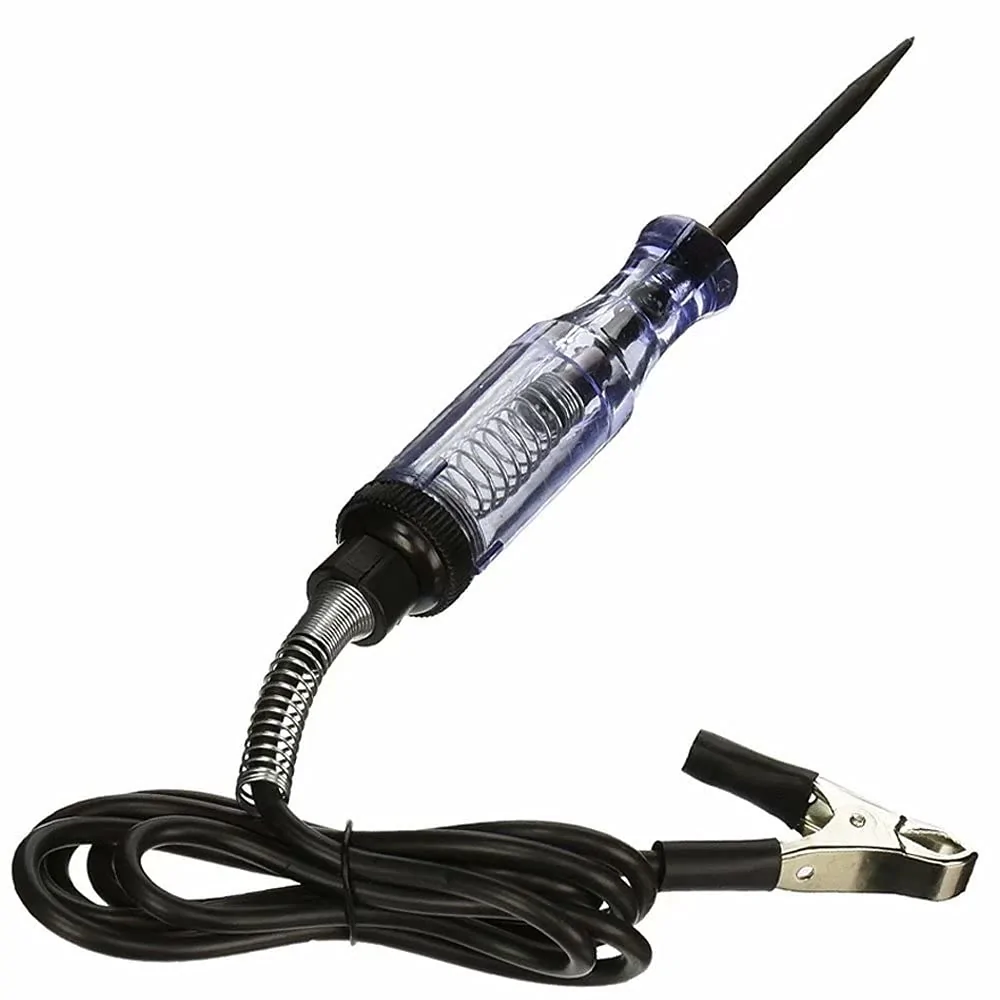

This is the tool I use; I would start from the 3rd brake light and work my way back. Find out where that wire has lost power. Also look to see if you can find the ground for the 3rd brake light.
