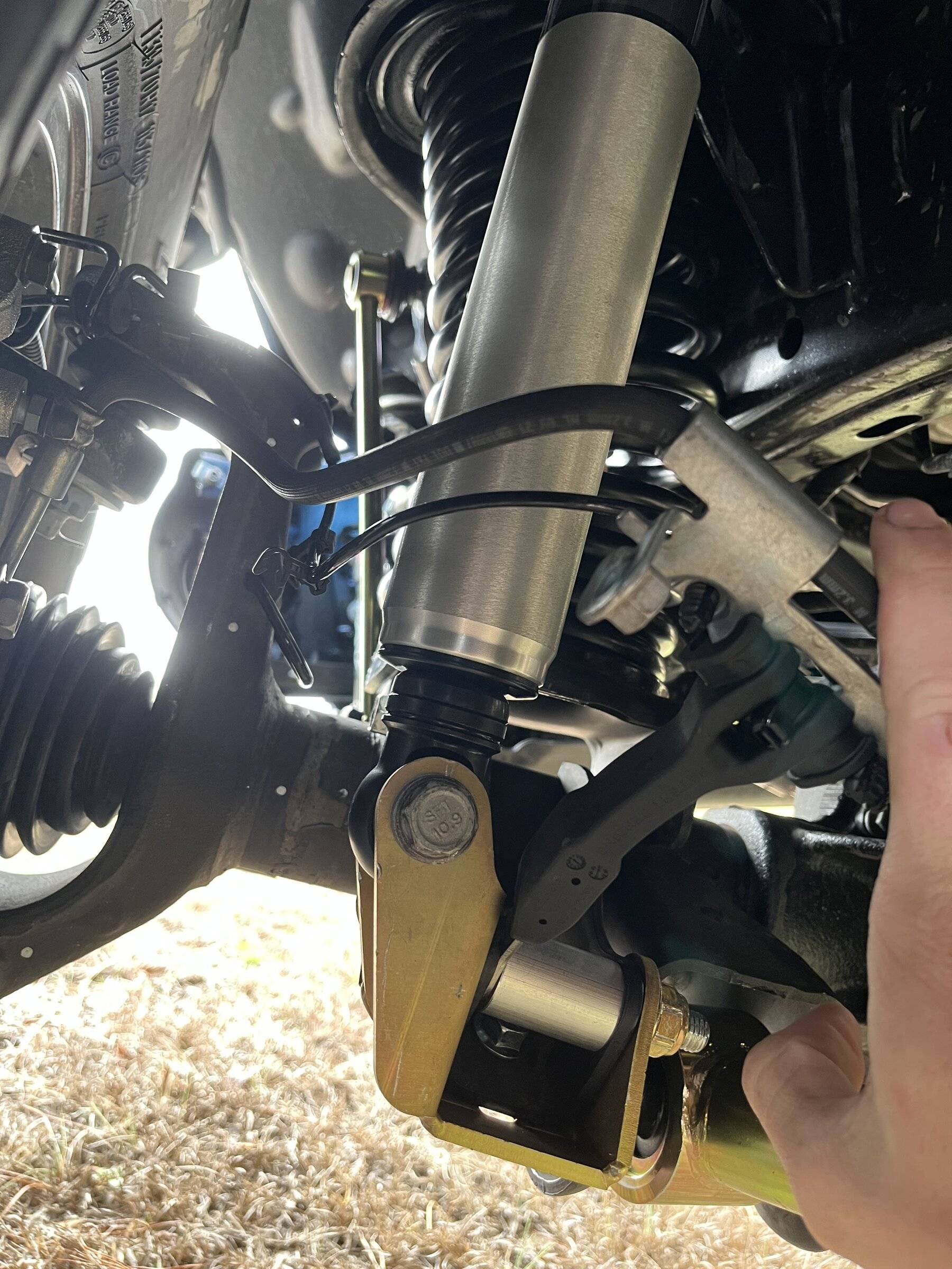

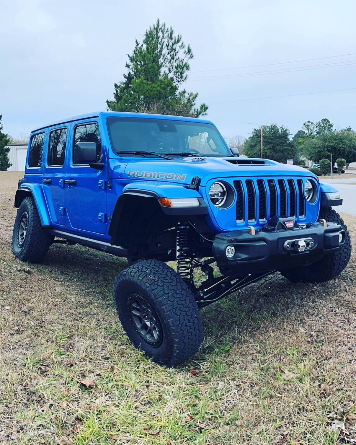

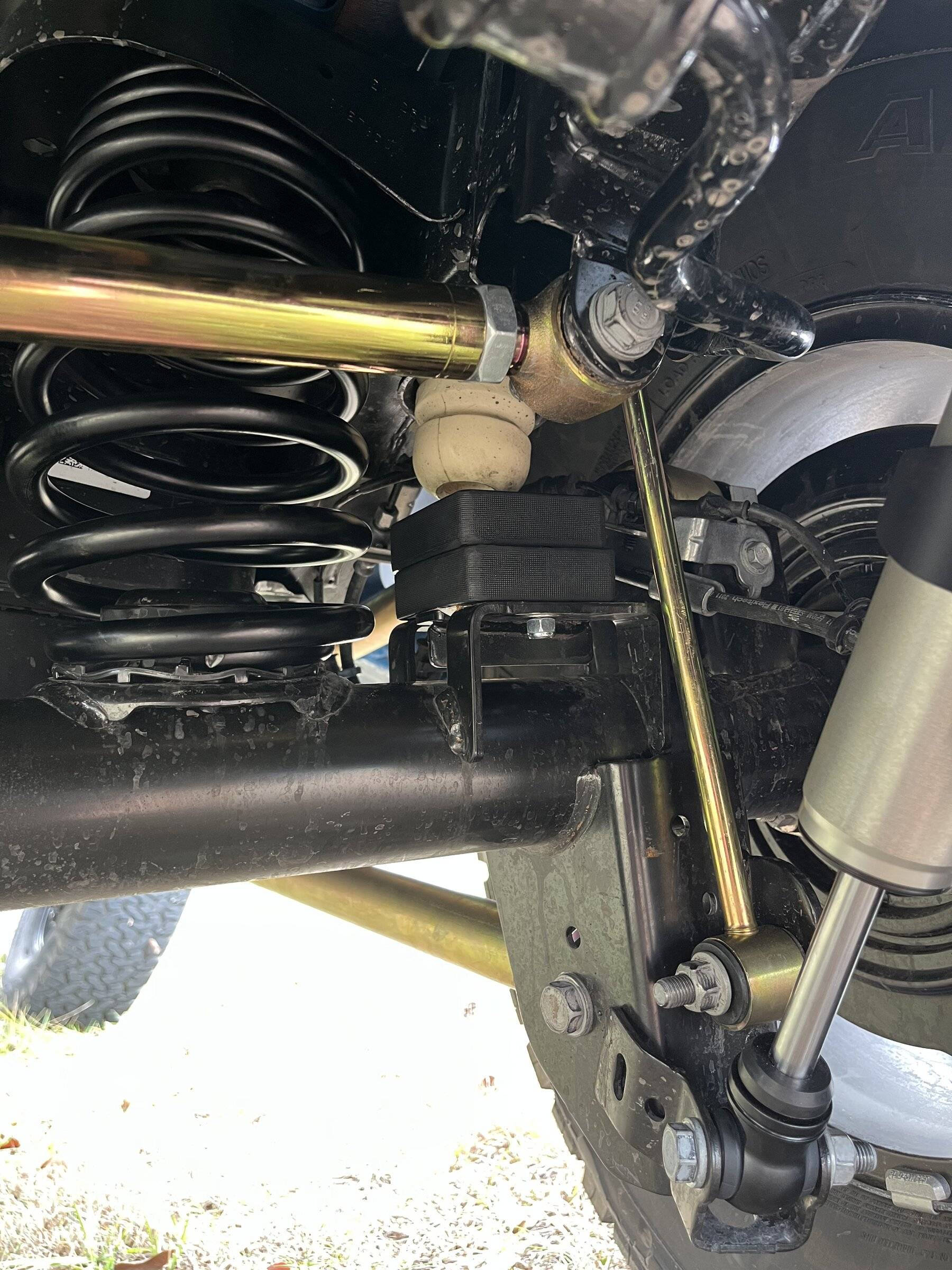

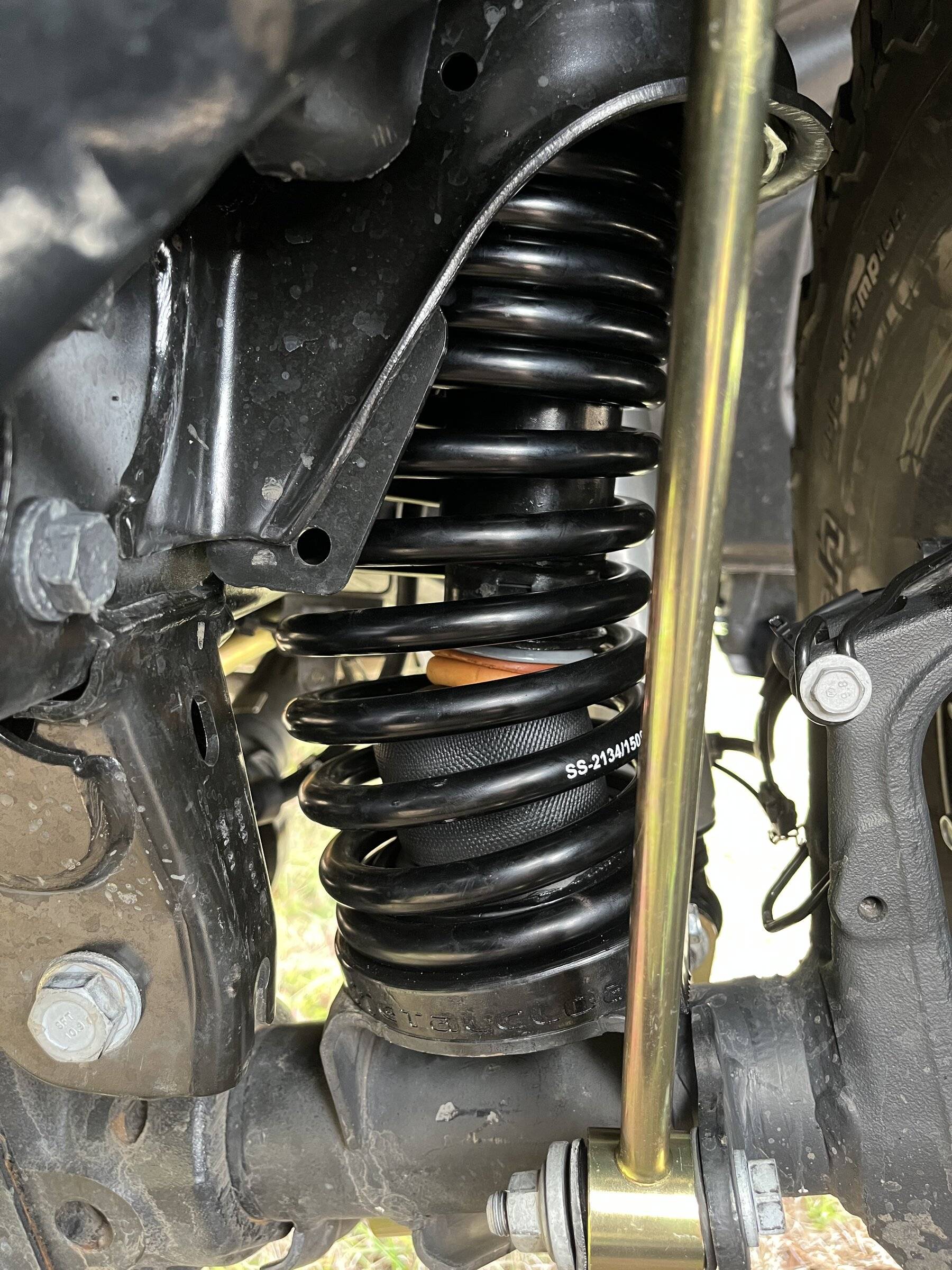

Just left town for a hunting trip but I’m running Fox 2.0 4.5-6” lift front shocks and 3-4” rear shocks on my 3.5” GC lift. I think the shock length is perfect. I did research and crossed my fingers that it would all work and so far it is. I’m at 2 bumps up front currently, which is perfect for my front shocks. Going to fine tune the rear next week with 37s. May end up removing 1 bump out back. I’m running my front shocks in MCs shock relocation brackets. 2.0s have different lengths than 2.5s so keep that in mind. As close to ~18” compressed/30” extended the better.
Poser flex pic to check initial clearances:
Jeep Wrangler JL 392 Specific Lift Kits AB2367FE-99F1-4A0F-84AB-26EB4A854FCD
Front shock at full bump stop compression:
Jeep Wrangler JL 392 Specific Lift Kits 97BE3814-A8E9-4F13-8A6B-B0F0273CD136
Still have 1/2” before I compress the rubber jounce bumper on the shock. It’s lightly touching here at full stuff, IE perfect.
Jeep Wrangler JL 392 Specific Lift Kits 7F80767E-87C3-4303-BC89-8164A0C30F8D
Rear shock from same flex pic, wasn’t touching the bump stops yet. Getting it on a fork lift to fine tune with 37s next week:
Jeep Wrangler JL 392 Specific Lift Kits 58913052-C175-4655-925A-73271CCBBF94

Awesome, looks good. Just saw your other post about Windrock as well. Curious what your actual shock shafts are at ride height eye to eye.
I'll probably go with the 2.0's (what they're recommending). How long did it take for your shocks to arrive? They are up to 3 months right now on some stuff, hoping mine don't fall into that range or I'll literally miss Moab (or well, be forced to run the rock shocks I guess which I suppose isn't the end of the world).
I'm probably going to run 39's eventually, but sticking with 37's for now since I can't even get 39" tires right now in KM3s.
