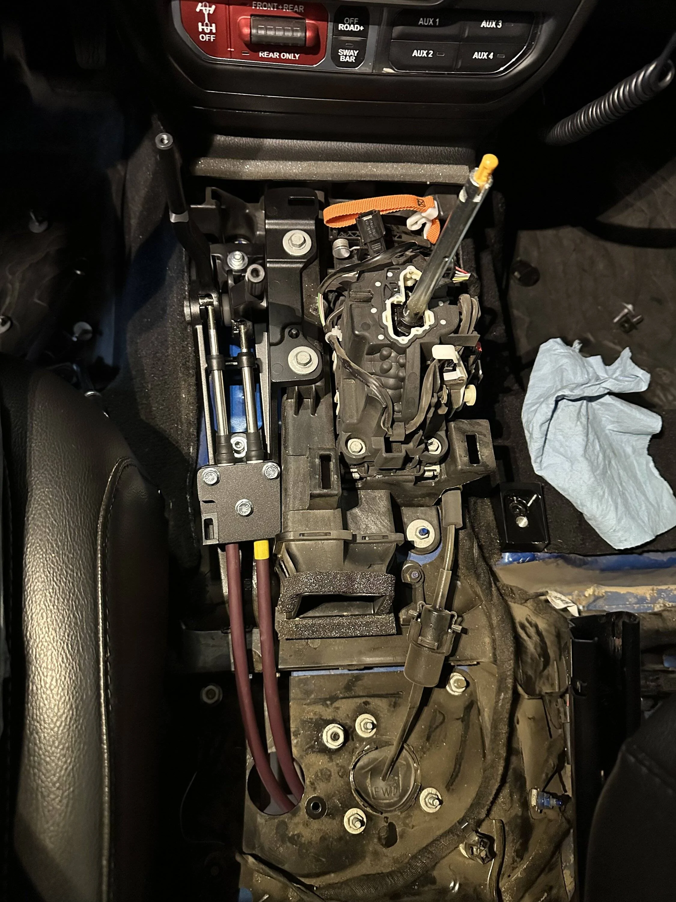

Did a fair amount today, still a fair bit to do (and redo ?). Advance came through and had the new factory mount here as promised.
Shifters in place inside. Grommet not yet reinstalled in this pic.

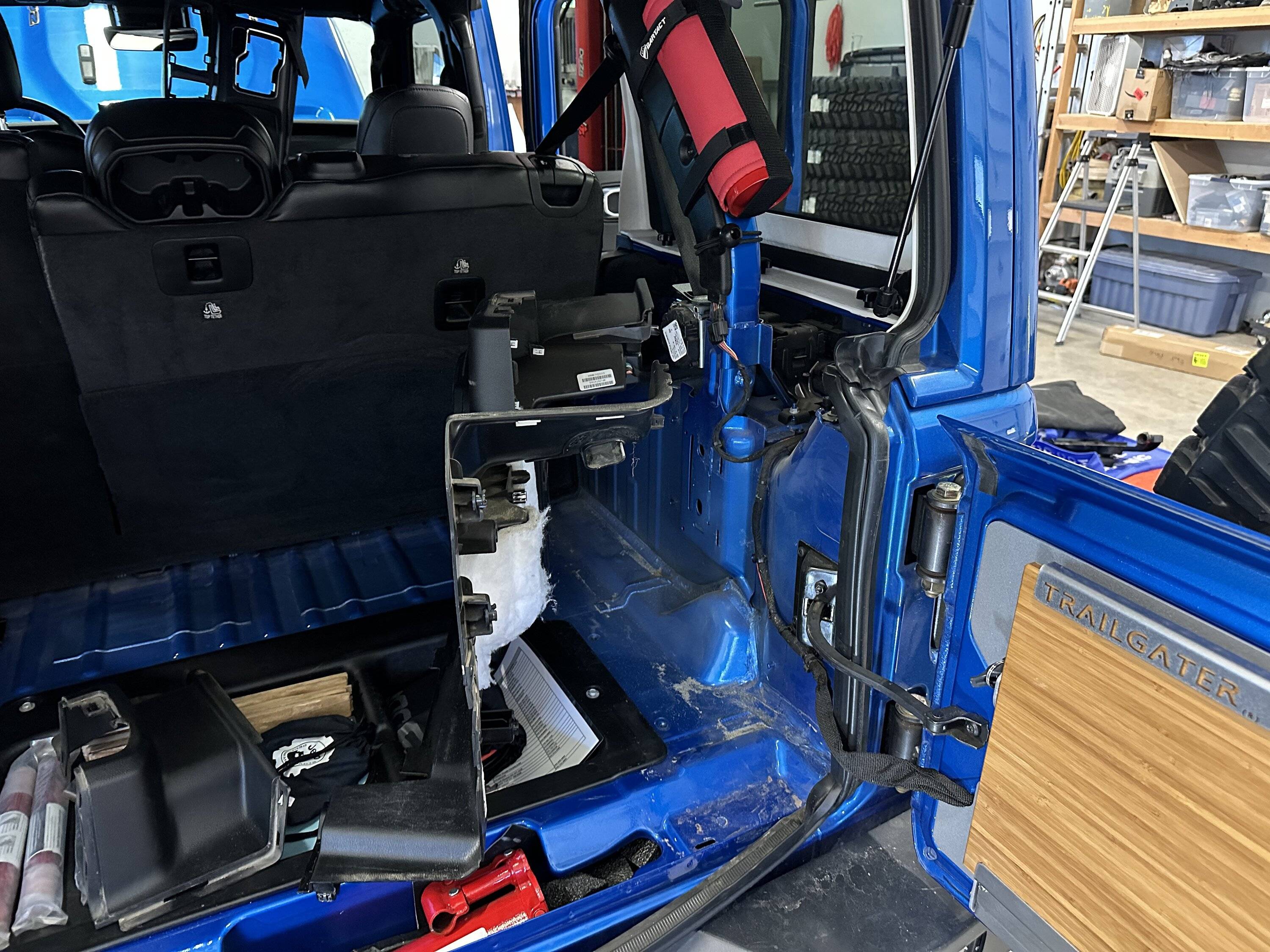

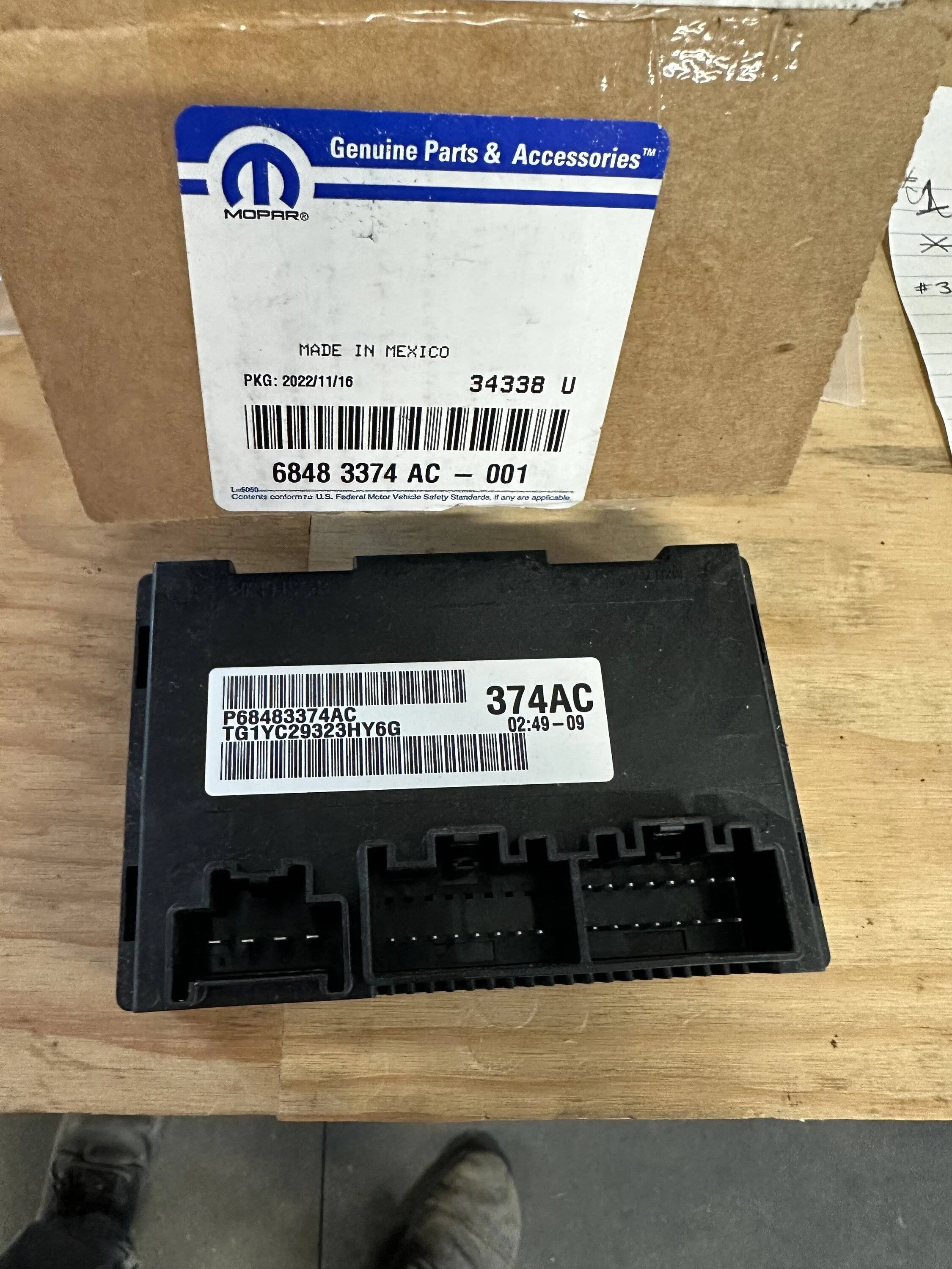

Advance doesn’t address this, but in order for the computer to not get cranky over not having a transfer case clutch to manage, you have to swap out the Transfer Case Control Module (DTCM). This is somewhat of an unknown, but Tyler of Rock Solid Fab and Scott Blum of Jeep have both told me that it is needed. It may be possible to just completely turn off the DTCM with the Tazer (that’s what Dixie 4x4 has been doing), or leave it plugged in and hang the clutch motor somewhere to make it think it’s working properly (what Off Road Evolution/EVO is trying). Both of them have been experimenting with mating a sport case with a 392 case to remove the clutches. Anyway, I ordered a new DTCM (model year specific) for a non-392 2021 Rubicon.
Jeep Wrangler JL 392 Atlas transfer case install 395FD1CC-24D9-4FD7-856D-703841683EEC

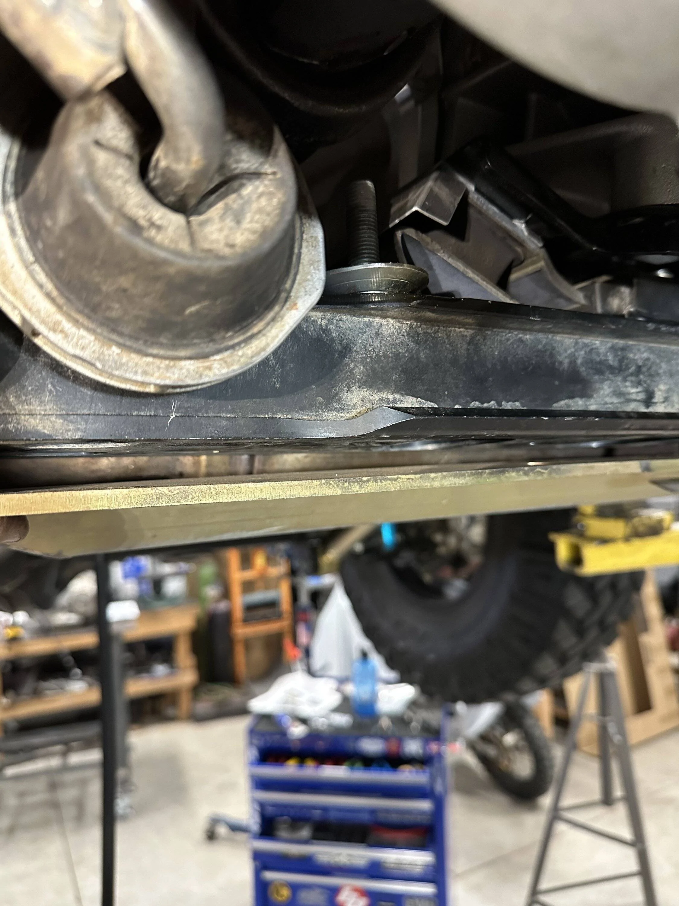

Advance even included some personalized instructions with the new mount. That was kinda nice ?
Jeep Wrangler JL 392 Atlas transfer case install C8D0E072-A483-4DE8-9311-3645C10C267B

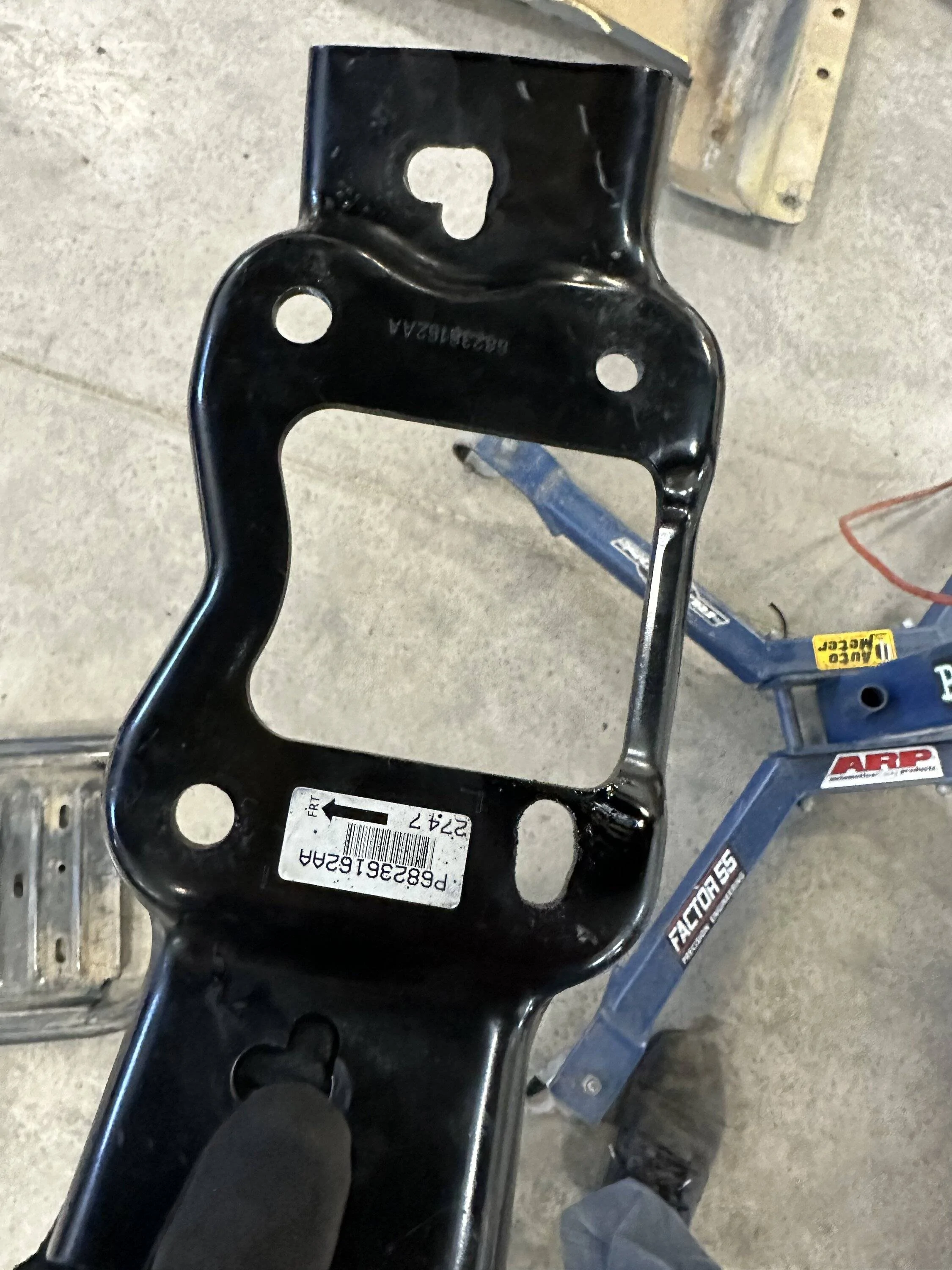

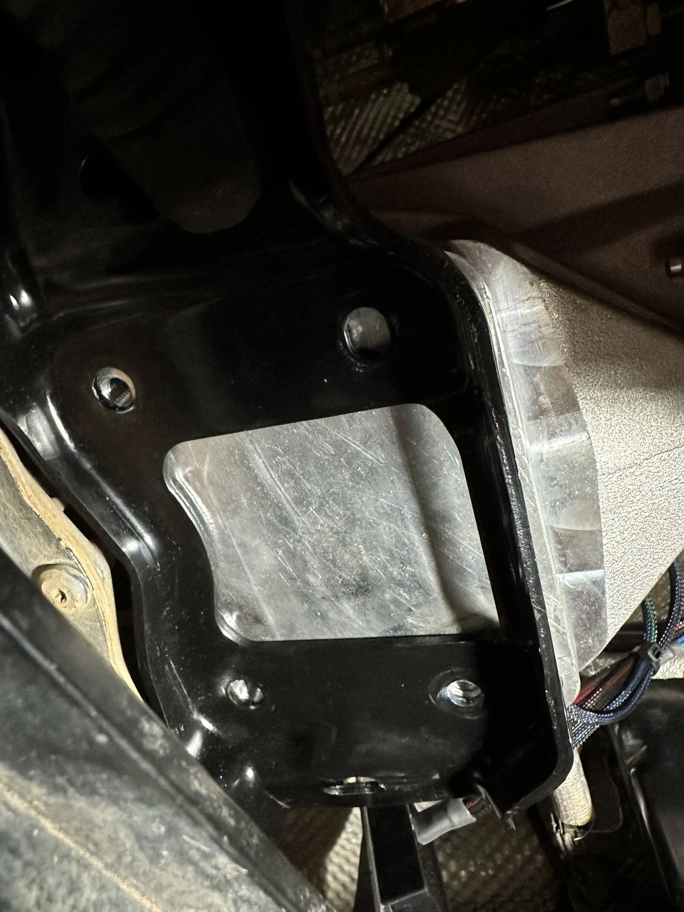

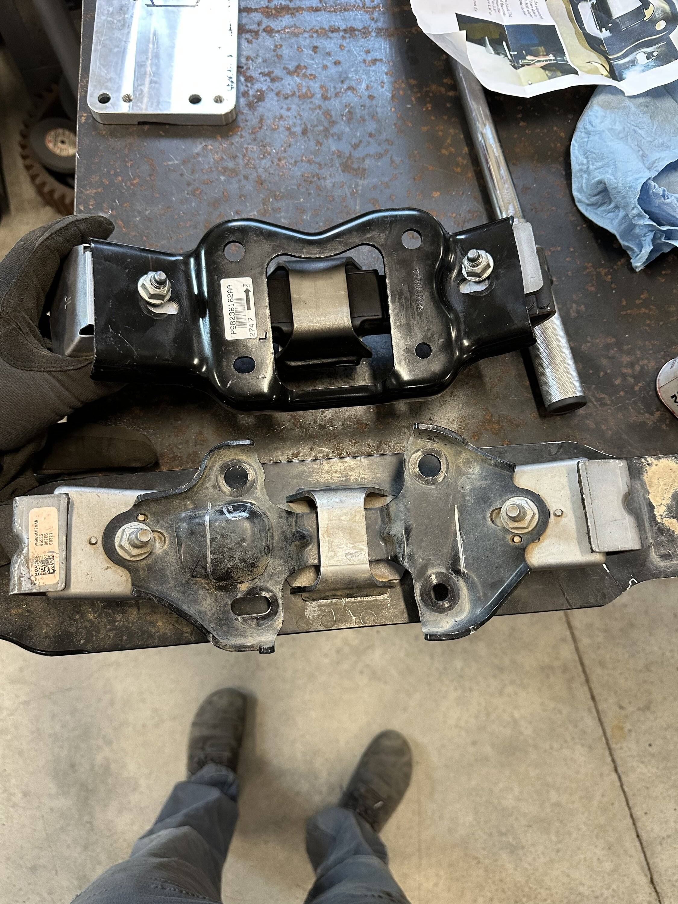

The two mounts together, differences are pretty obvious. As the instructions stated, the mount is taller, so I left out the 1/2” adapter (more on that later…)
Jeep Wrangler JL 392 Atlas transfer case install A2FAA5AC-2A5A-4F61-AC55-BFB5E26E7043

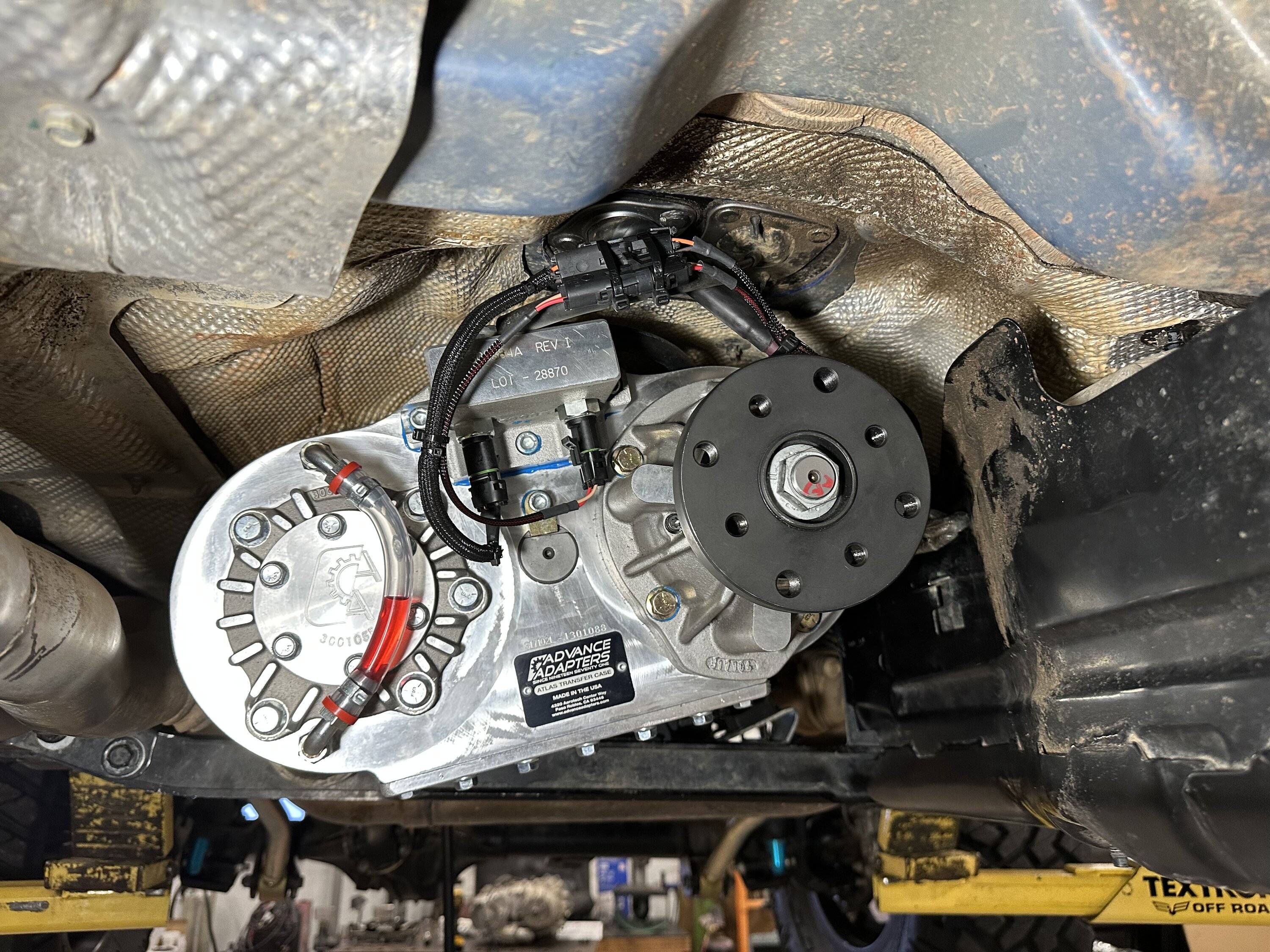

Everything all mostly in place. Just waiting on my driveline to return from Tom Woods. You can also see that I moved the site tube to the other side to get it further away from the exhaust heat.

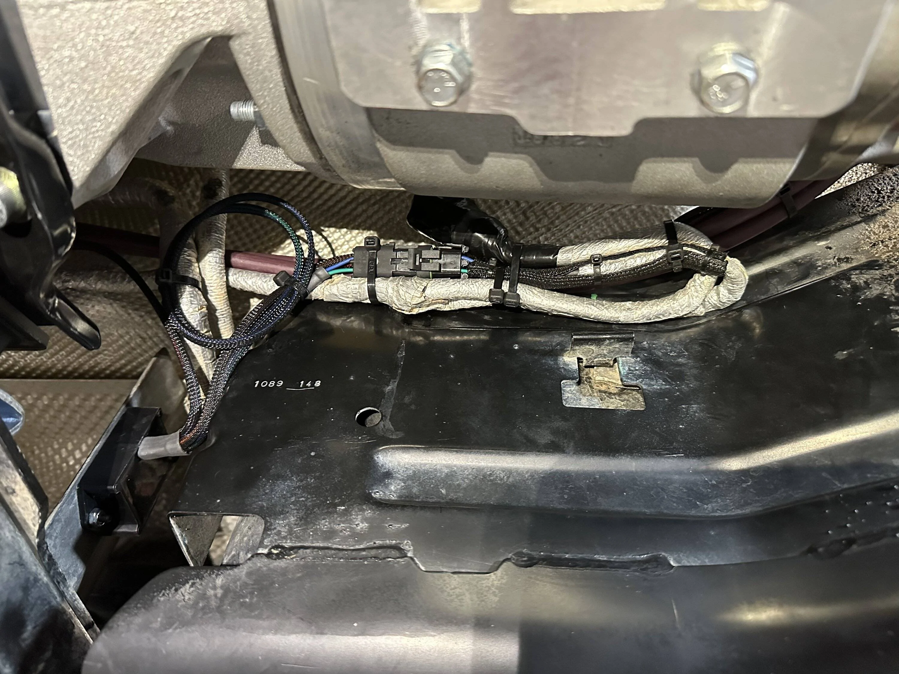

New and extra wiring tucked up. Near the bottom left of the photo, you can see I mounted the Atlas module to the factory roost shield in front of the fuel tank.
Jeep Wrangler JL 392 Atlas transfer case install E932E862-C987-42A2-937A-7B1E41EBA841

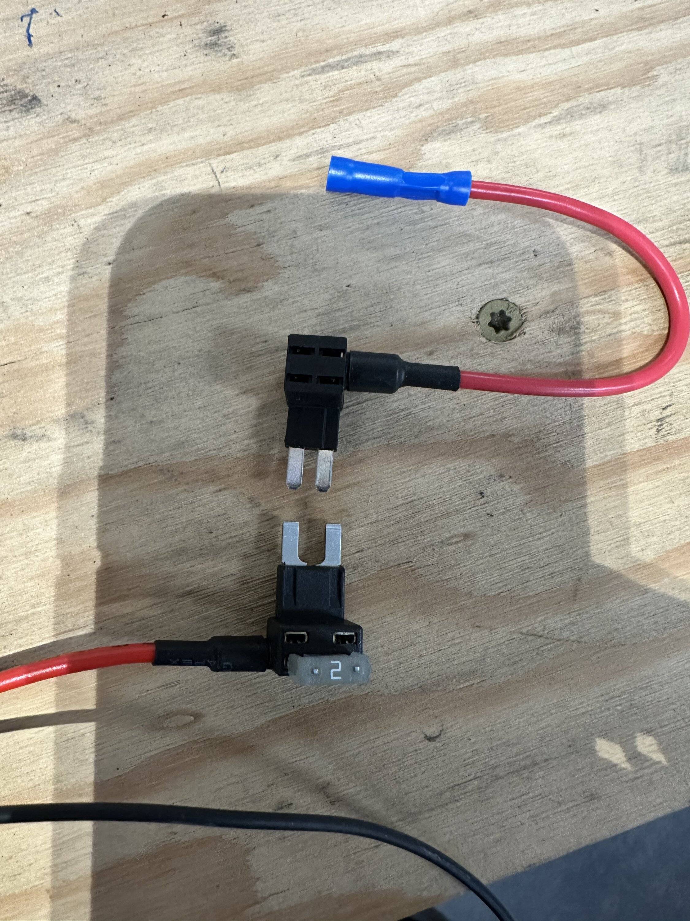

The module wiring needs power from the fuse box. Advance includes the fuse tap at bottom. It’s clearly the wrong size for JL fuses, so I picked up a proper one.
Jeep Wrangler JL 392 Atlas transfer case install 60144EDA-93D6-4A62-A5A9-D02F17F1A08C

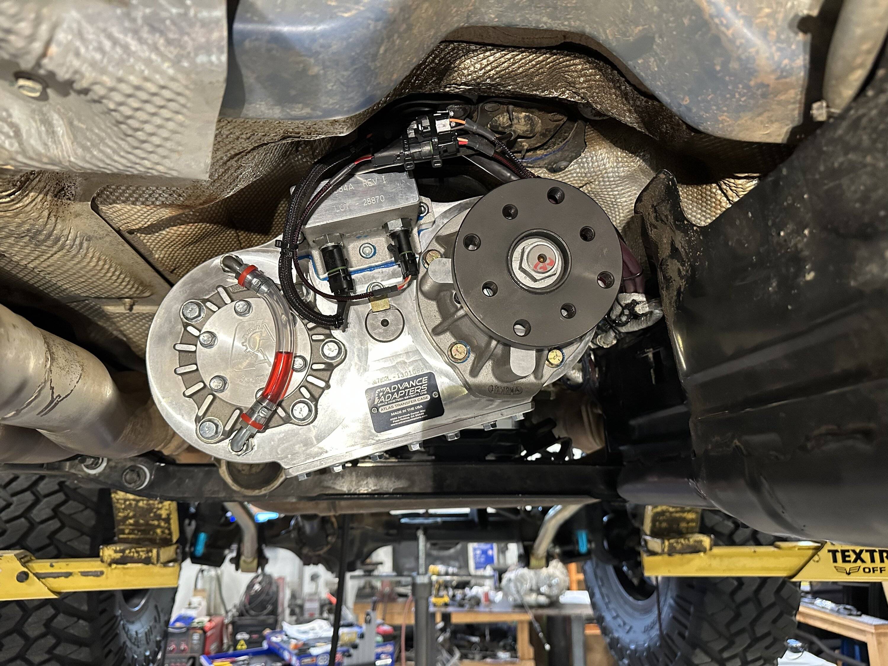

Got the adapter in this morning. I had to notch one of the holes in the factory mount to match the tapped hole in the Atlas adapter. I’m sure Advance will modify their design of these once they get my updates. Skid plate now clears the crossover pipe like it should. ;)

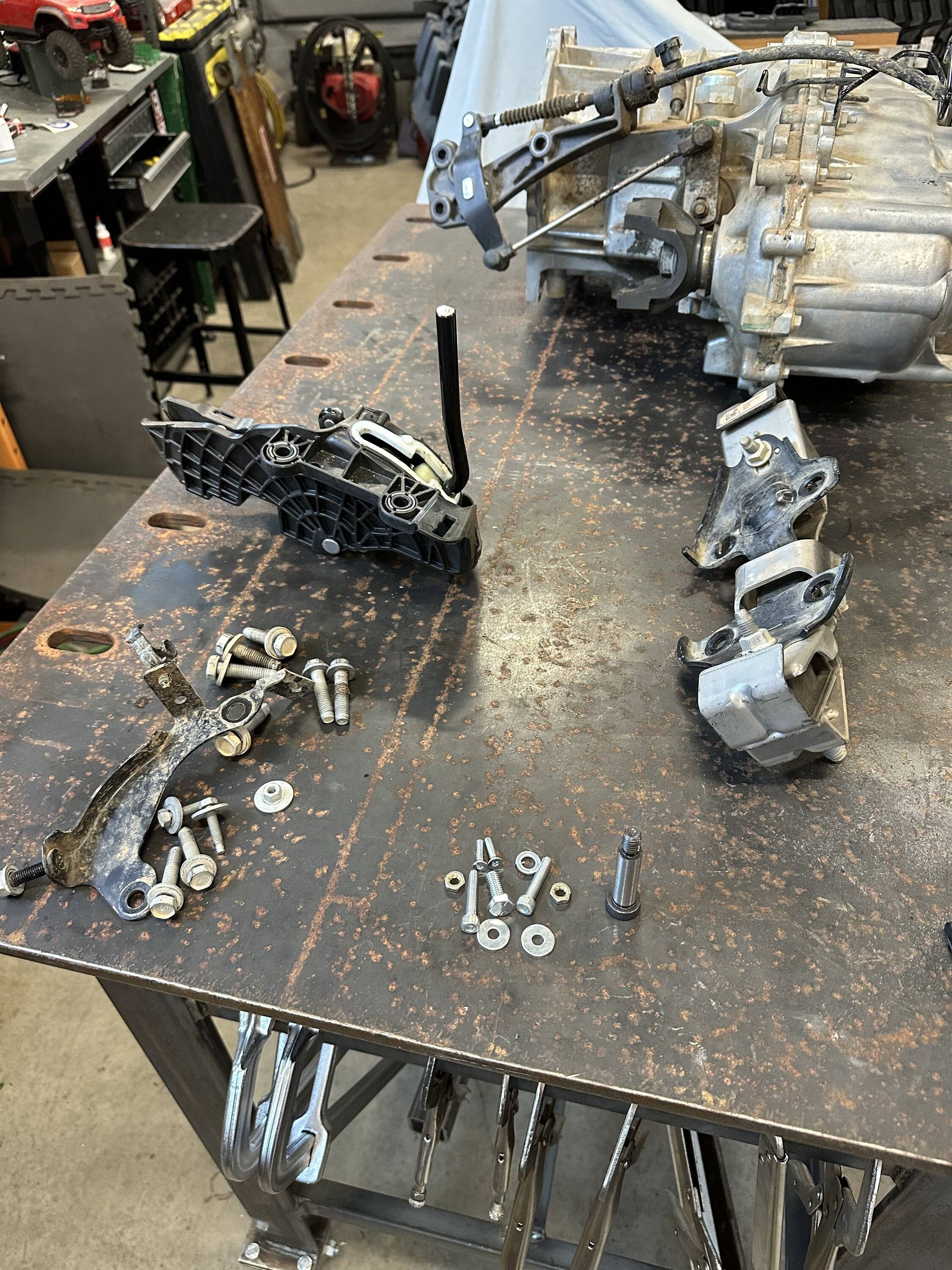

Here’s the pile of now unused factory parts, and the Atlas pieces that I didn’t use (except the 2 little tapered head screws are for the shift knobs).
Jeep Wrangler JL 392 Atlas transfer case install 9B620F1C-E3C9-45DB-829B-6EBB979AB84C

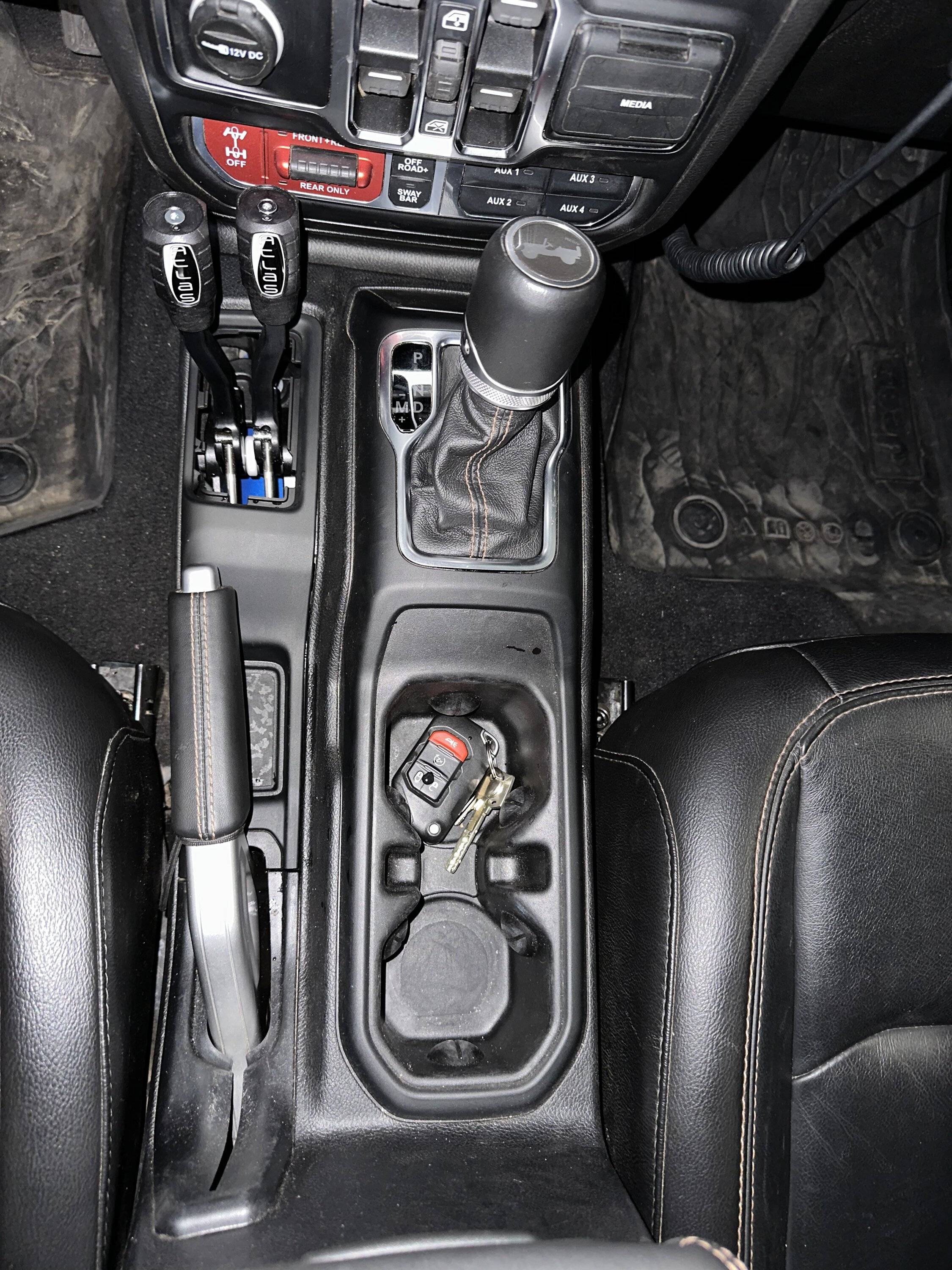

I also finished up the wiring, ran the vent tube, and put the console back in. Nothing really picture worthy. One note on the vent tube that my buddy Ryan figured out- It is an easy way to fill the Atlas in the future! There is no fill plug on these, you have to remove the upper site tube plug and pump it in. (They even tell you to fill it from the drain plug before the initial install). Therefore I ran the vent tube to an easily reached spot in the engine bay. And I plan to install a filter on the top to keep it clean. When filling this way, it’s still best to crack the upper site tube plug to allow air to vent out. I also plan to cut a hole in my factory transfer case skid directly below the new drain plug.
My daughter had a soccer game, so the day was cut short. Tomorrow I hope to finish up some unrelated wiring and get the computer programmed for the new DTCM with the AlphaOBD software. Then I plan a small test drive on my property (in front wheel drive only since I don’t have a rear driveline yet)

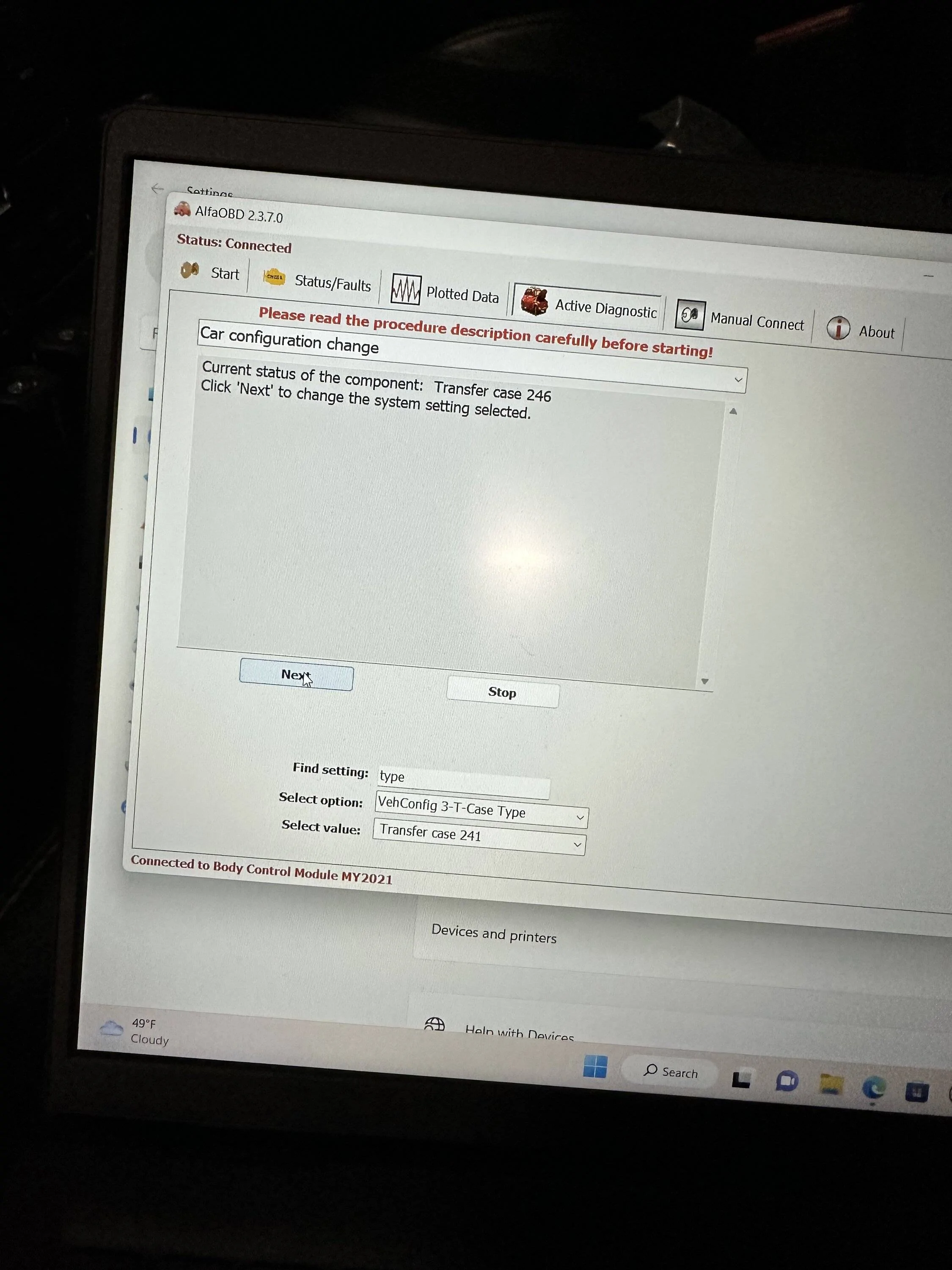

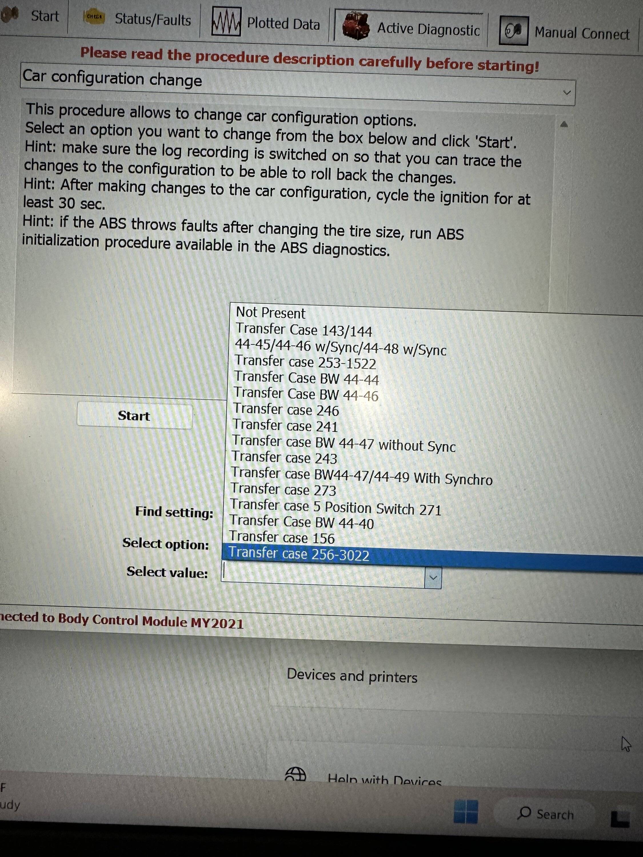

I did the computer stuff today. And things appear to be working well. I’ve never dealt with the AlphaOBD software and I had no idea what I was doing. I used a Vgate vLinker with cables to plug it into the SGW ports (same place the Tazer plugs in) and connected to that via bluetooth with my Windows laptop. First I unmarried the Tazer (I have no idea if that was needed, but it’s what I did). Once I got the AlphaOBD software to connect to the Jeep, I spent close to 30 minutes fiddling around with the software to try and figure out what I was doing.
Under the “Active Diagnostic” tab, I then selected “Car Configuration Change” and then searched for Transfer Case. That brought up this list of options. I chose 241 (it was set for 246), and just clicked next.
Jeep Wrangler JL 392 Atlas transfer case install 034FDA90-E512-434C-AEAC-BEC08DD45E63
Jeep Wrangler JL 392 Atlas transfer case install BCCDC7B6-F65B-46FB-91E0-D733F584B768

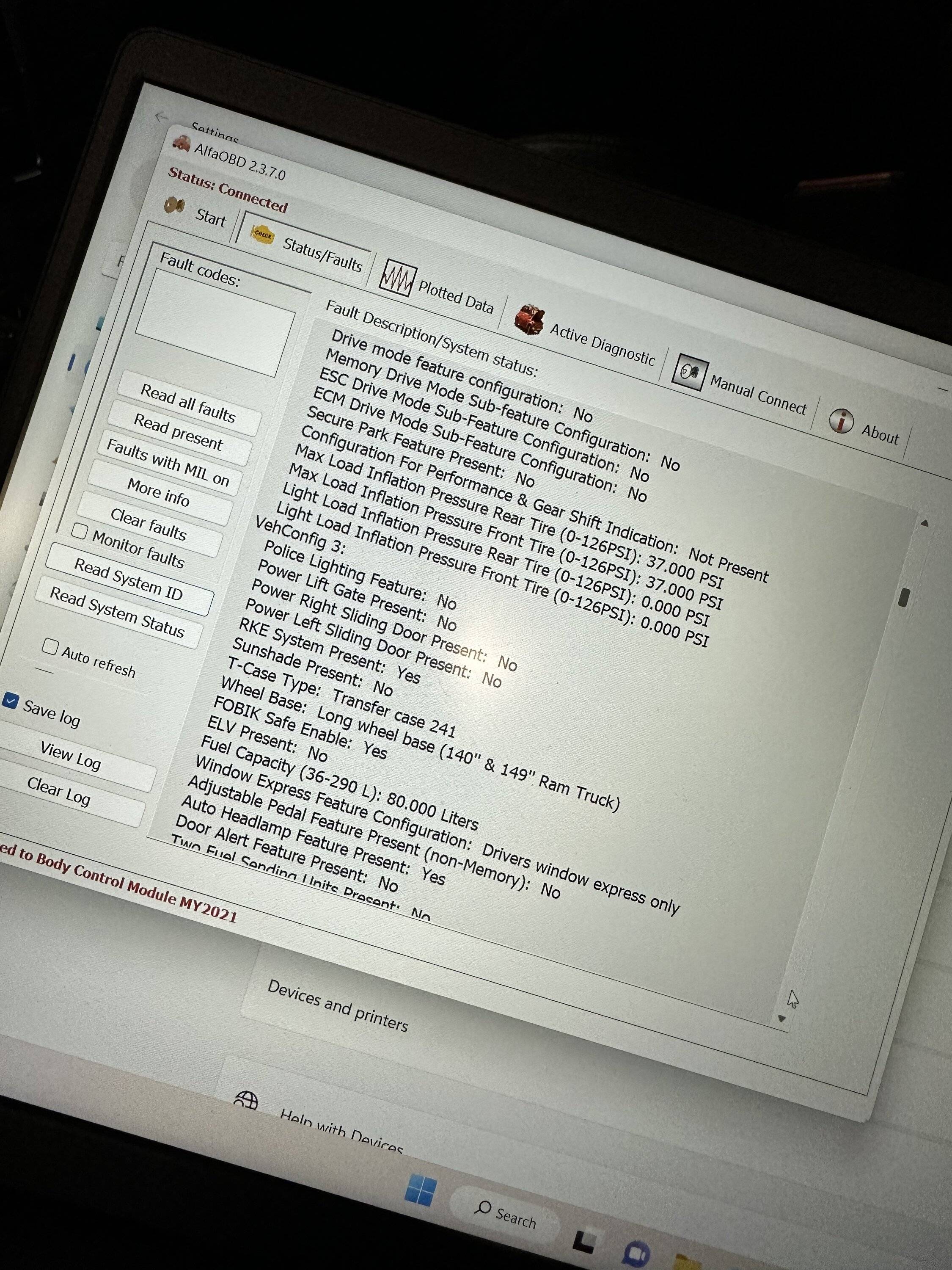

Once I was done, under the main menu, I read the system status (or ID, I can’t remember) again and scrolled down and can see that is shows correctly in there now as well (it showed 246 before)-
Jeep Wrangler JL 392 Atlas transfer case install CE4945CF-F64D-4D52-B354-235988E6E59F
Once that was complete, I cycled the ignition and then remarried the Tazer and reconfirmed all my settings there as well as changing the Tcase ratio to 3.030 as directed for the Atlas. I had to clear the fault codes twice and do the two Tazer sleep cycles.
Then I did a short test drive at my house in front wheel drive (I still don’t have a rear driveline). Everything appears to work as designed and there where no weird dash lights when I put it back in the shop ??

Very nice write up. Glad the Dtcm is working and hoping it works in the long run. I believe it’s the best solution. Even for folks that want to use the guts of a regular jeep part time trans case stuff them into the 392 trans case.
1996cc
1996cc
Aug 19, 2019
900
1,175
Oregon
22 JLUR 392
Yes, any transfer case option that removes the factory clutches will have to do this.
