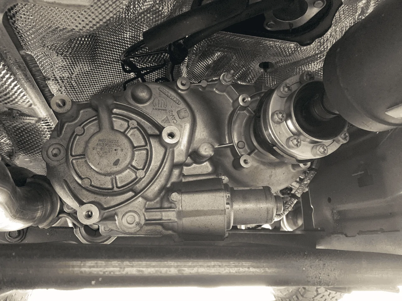

Just received an updated timeline on the proper Atlas adapter for our 392s.
Jeep Wrangler JL 392 Transfer case D2371A91-D9CD-412A-8E62-06623F6DC75E

I thought I read it also uses abs sensors etc to adjust the torque as required for max traction via the variable clutch etc.
It surely uses both. Sending power to the front based on throttle position is the only one I’ve seen confirmed with data.
