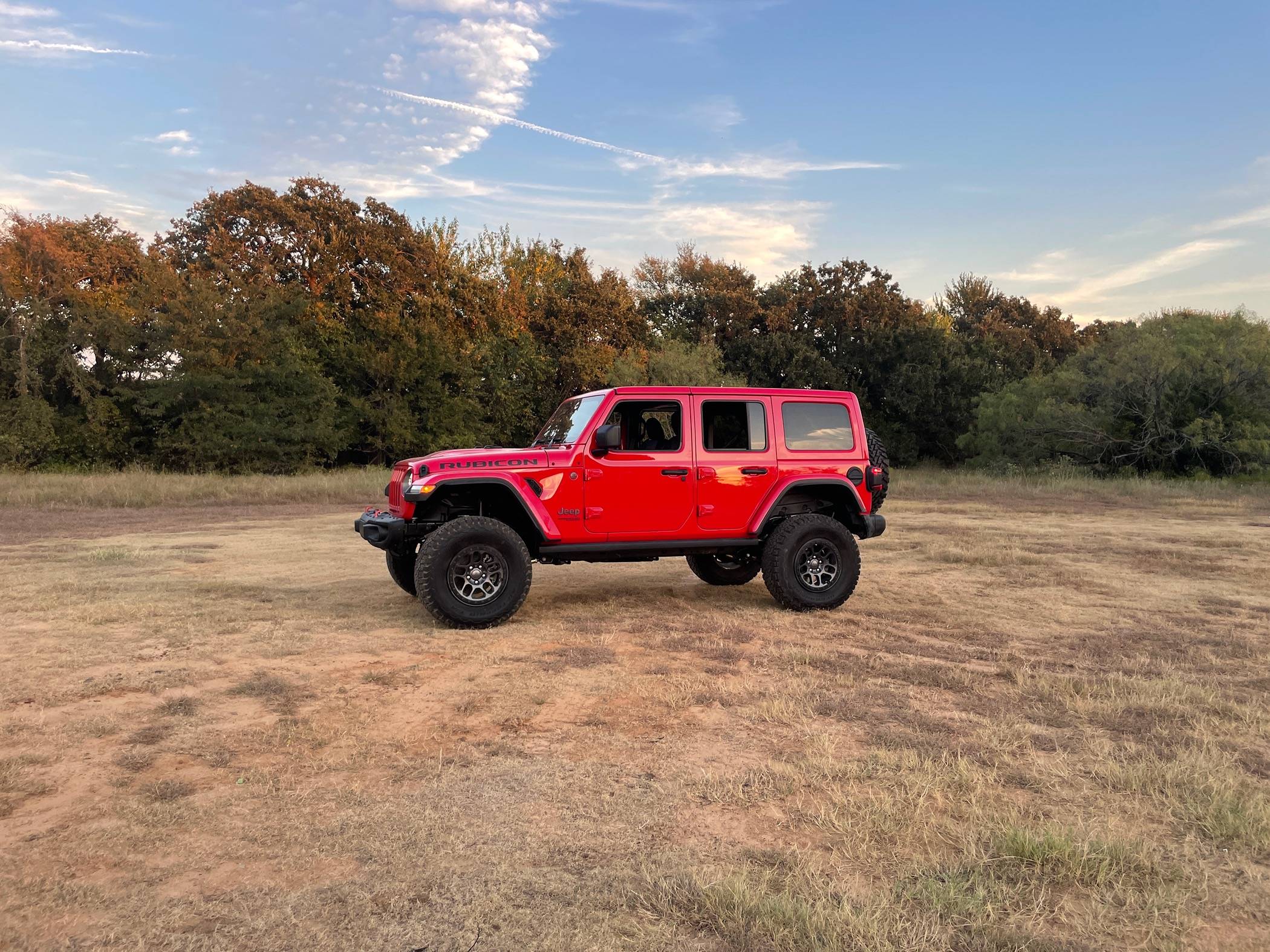

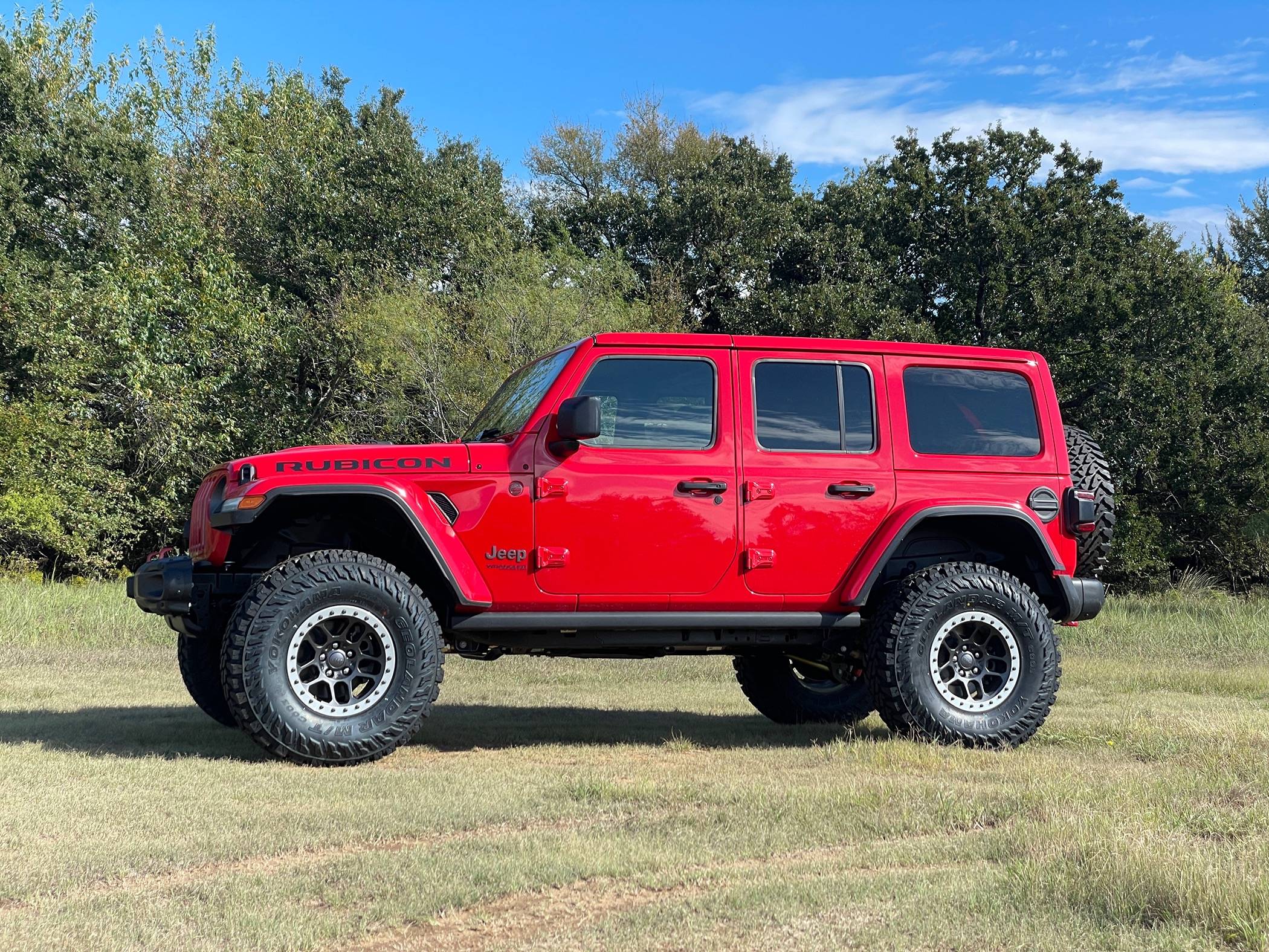

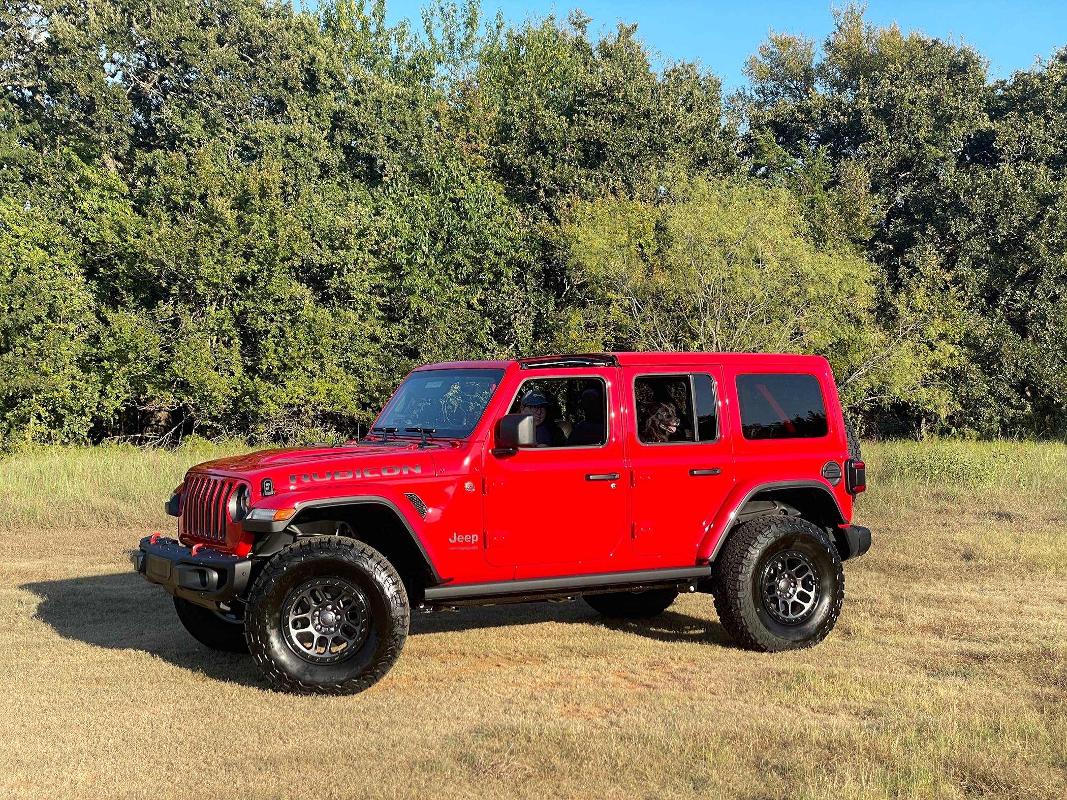

I ran a pretty standard 2” lift for 35s, and 3.5” lift for 37s. This puts my skids 2.5” higher than my rig with 35s. I’ve had no issues with factory skids ?‍♂ I’ve run what I feel the need to run in Moab, elephant hill, metal masher, hells revenge, poison spider, etc. I have zero desire to drag my rig through Pritchett Canyon, I would rather buy a cheap jeep and give it hell in something I could comfortably afford to roll. The factory skid rarely hits by comparison to my 35” rig, even though I’ve got a longer wheelbase, the bumpers rarely hit by comparison as well. The skids seem to do a good enough job for me. I’m far more concerned with rolling my rig, and I’m almost never concerned about turtling on an obstacle, and even then, the factory skid is there to save the day. The skids I could see being more useful to me would be diff skids and rear shock skids. Not to say that full belly skids have no place, they’re definitely better than nothing or factory skids, but, I don’t see them as a “must have”. I would go as far as to say I would probably pick 3.5” lift and 37s over 35s, skids, and steel bumpers. I find the enhanced break over, approach, and departure angles to be far more useful off road. 2.5” of extra clearance has done well for me. If you like the look 35s and 3.5” of lift would equate to just 1” less overall lift. In this case 35s would be similarly capable, and skids would play a bigger role in capability. I’m just comparing how rigs are generally built, and it’s usually not with the same suspension lift for both sizes.

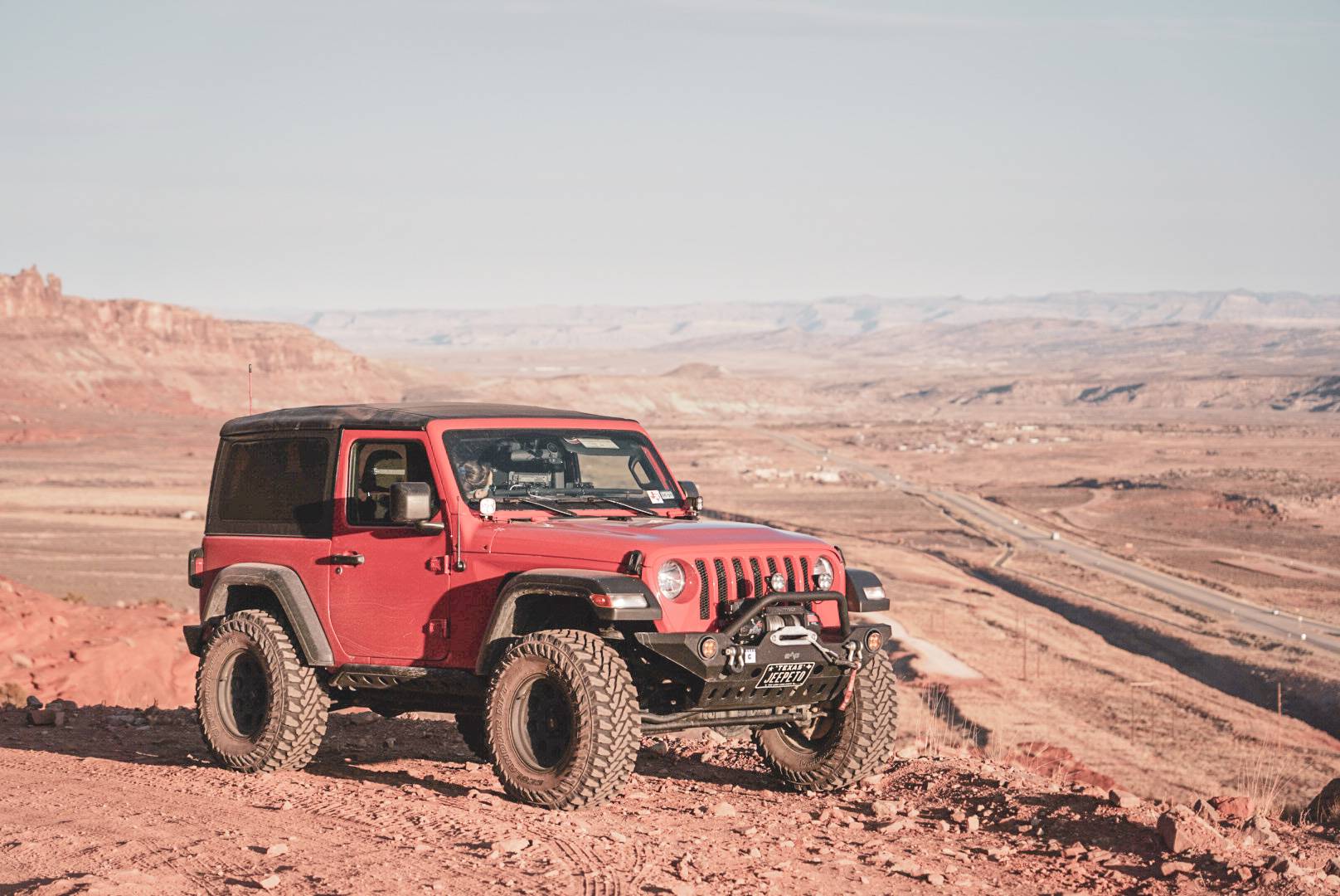

FWIW, my little sport on 35s and 2” lift did all the same trails on factory skids as well. It was more abusive on factory skids but she did fine and survived 7-8 week long trips out to Moab before we “upgraded”
Jeep Wrangler JL 35's with skids or 37's without 20201123_151700000_iOS
Last rig on 2” lift and 35s
Jeep Wrangler JL 35's with skids or 37's without IMG_1344
35” tires on XR factory lift
Jeep Wrangler JL 35's with skids or 37's without IMG_1486
35s on 3.5” lift
Jeep Wrangler JL 35's with skids or 37's without IMG_1507
37s on 3.5” lift (a full 3” taller than 35” XR from factory)
