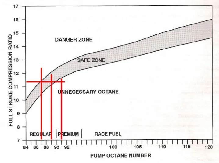

11.3:1 in the JL 3.6L is quite a bit higher than the JK 3.6L at 10.2:1 compression ratio, so I've been running 89 instead of the cheaper 87. Engine feels quite a bit smoother and is noticeably quieter overall. Could be my imagination, but the added expense seems relatively minor compared to most maintenance and repairs (at least around here, which is usually 20 to 50¢ extra). If I could find 88 unleaded, I'd run that instead, but all of our stations jump from 87 to 89 to 91 (up to 93) for some reason.
