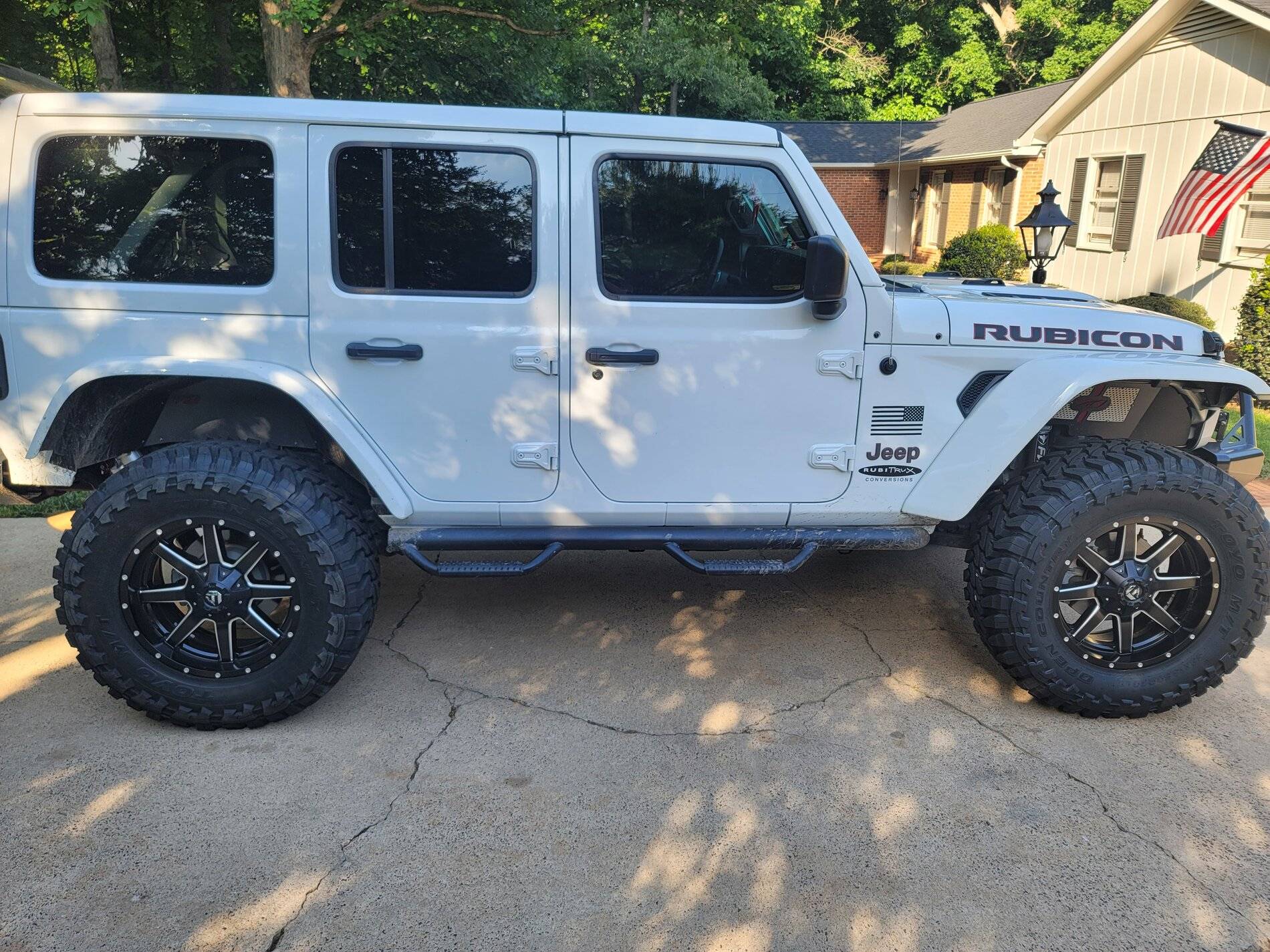

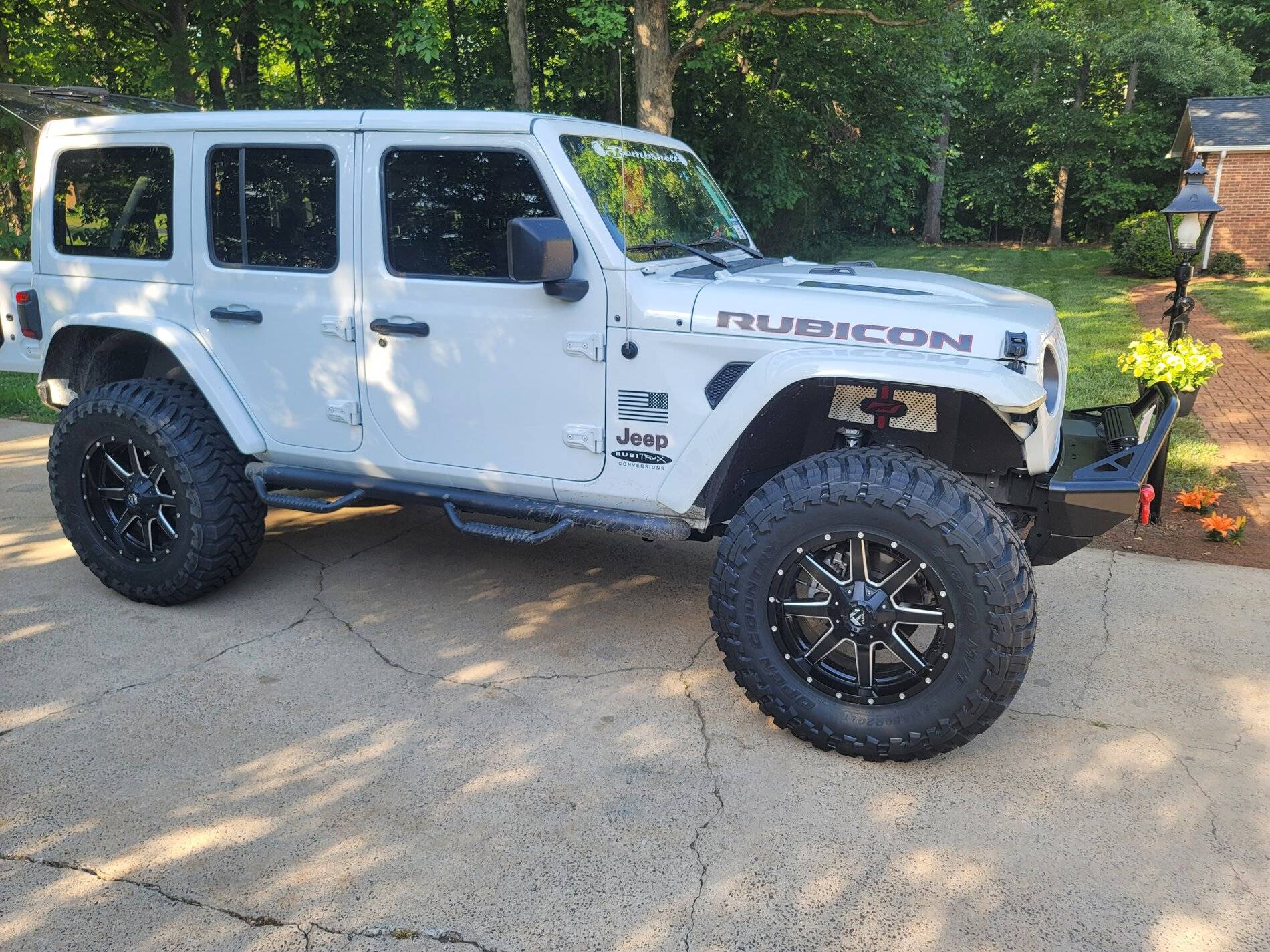

Lol yeah! Ok so I feel better about a 3.5" lift clearing good now its just which exact RK or other suggestion lift to pick that will for the most part do well on the road now that I don't need the control arm brackets Also since I'm posting nudes and all here is a picture of my baby. I'm actually putting 2.5 re springs on this weekend to pick it up a bit more.

Here is a few pictures
Looks nice, with the fenders gutted. Looks like it already has a lift. Just noticed your front bumper, nice choice.
Lol yeah it has a 2" mopar. Now it's out of warranty I'm ready for a good 3.5" lift and to play a little with it. Yeah I love the PS bumper!

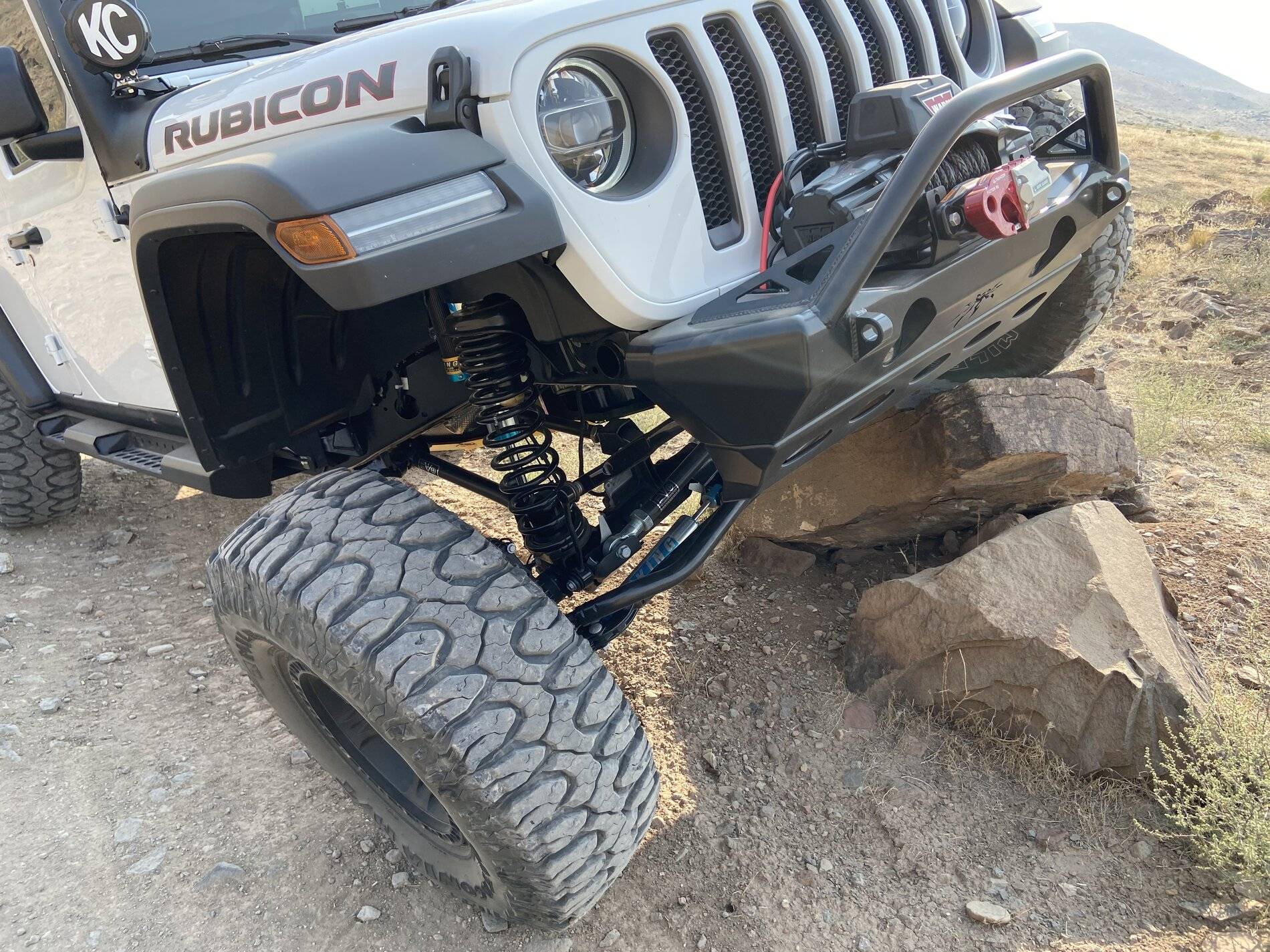

What you see there is 3.5 rock krawler springs with kings 2.5 shocks.

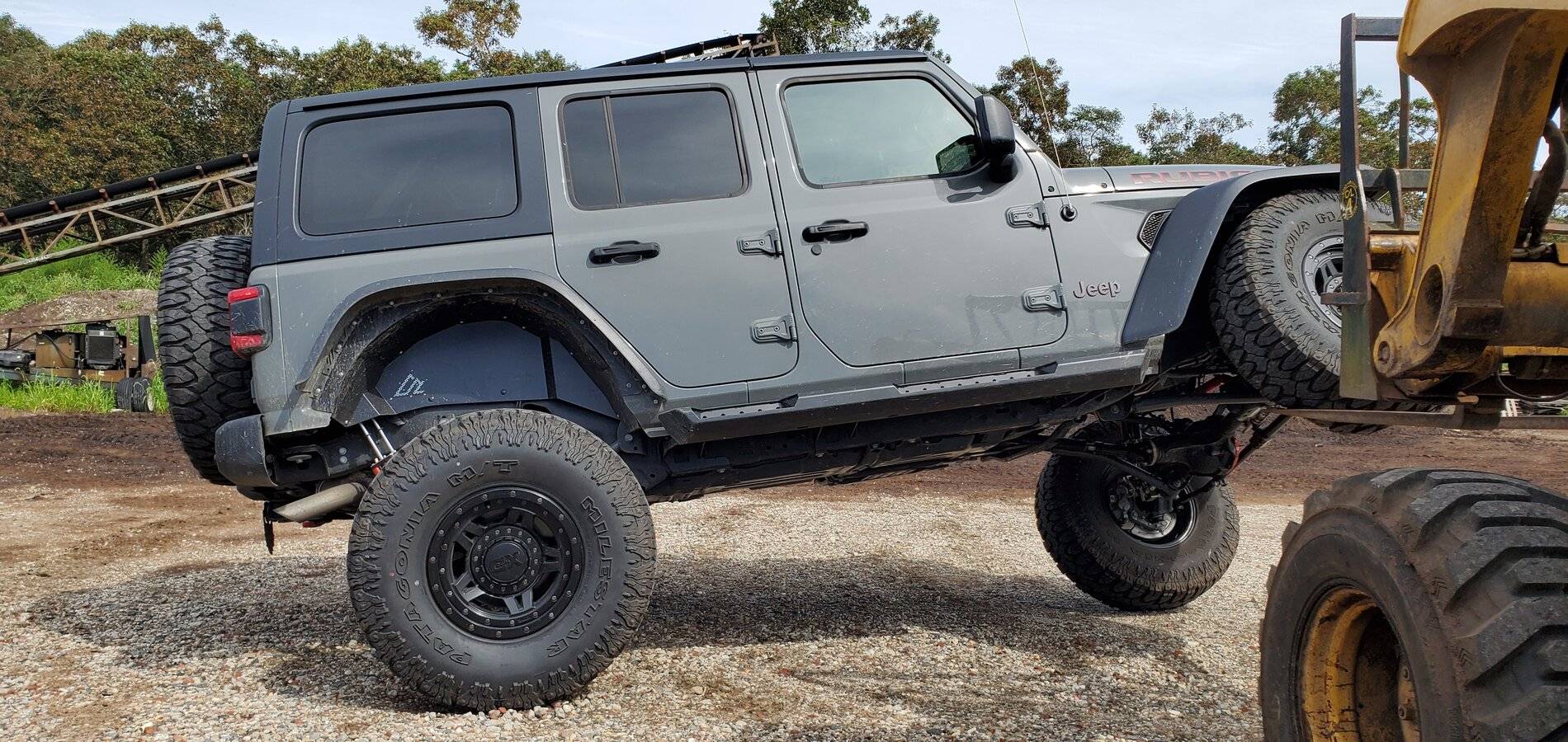

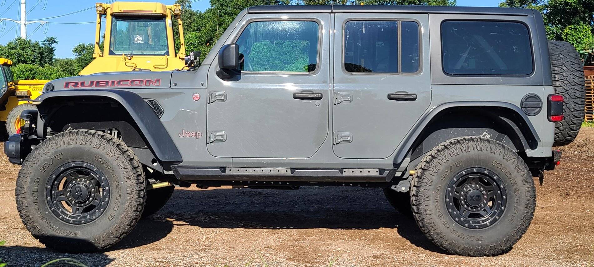

I’m running the XFactor No Limits for over two years now, and it’s been an awesome kit on and off road. I’ve paired it with some Fox 2.5s for great on road ride and some pretty sweet flex......some pics in here.

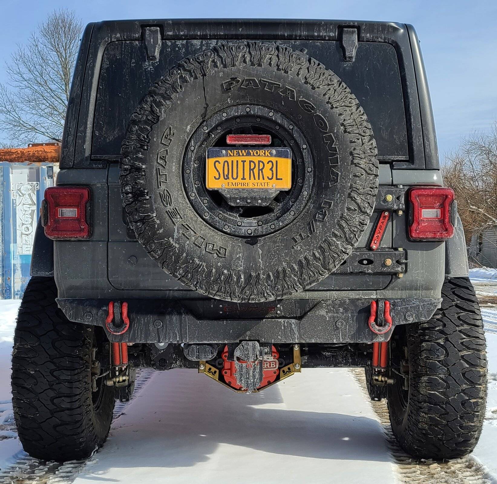

I've got the 3.5" Metalcloak Gamechanger and currently have 38x13.5 Milestar Patagonias wrapped around 17x9 wheels with -12mm offset and 4.53" of backspace.
I see that you've already chopped all fenders and removed the rear fender to bumper filler panels. You'll have to do some rear pinch seam trimming to fully stuff the rear tires, or lose some up travel with an added amount of bump stop spacers. Heresba couple of pics taken last summer. I've made some other adjustments and upgrades to increase articulation, but I still haven't trimmed my pinch seam because I also have to artfully modify the AAL rear liners and mounting plates.
These were taken at 35psi Street pressure.
