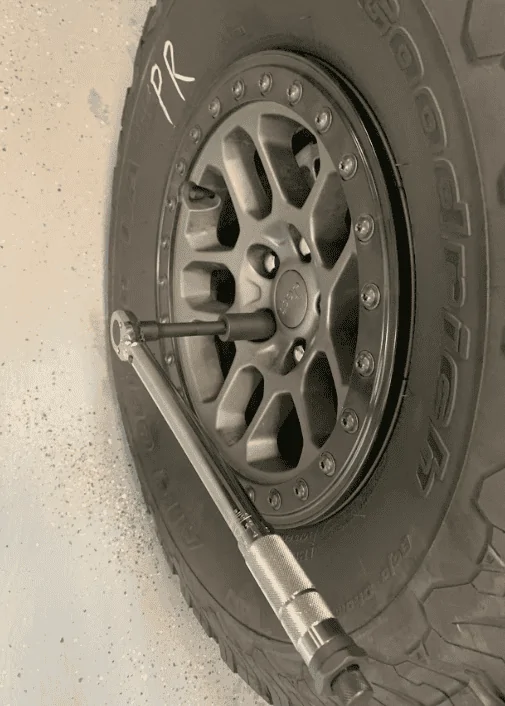

Definitely get the 22mm 6 point deep socket. You may also need socket extension which I did in my case to get more room for the torque wrench. Otherwise the torque wrench touches the tire. A 25" breaker bar will also be very helpful to unscrew.
Jeep Wrangler JL 22mm or 7/8 1669403840853
I always leave the breaker bar in my rig along with the 22mm socket for any emergency.
The spec says 130 ft-lb, I went with the cheap Harbor Freight torque wrench, so I did 125 ft-lb just in case the calibration is not accurate. I double checked the torque for couple times after driving a while. It's been over 3 months since my rotation and no issues.
