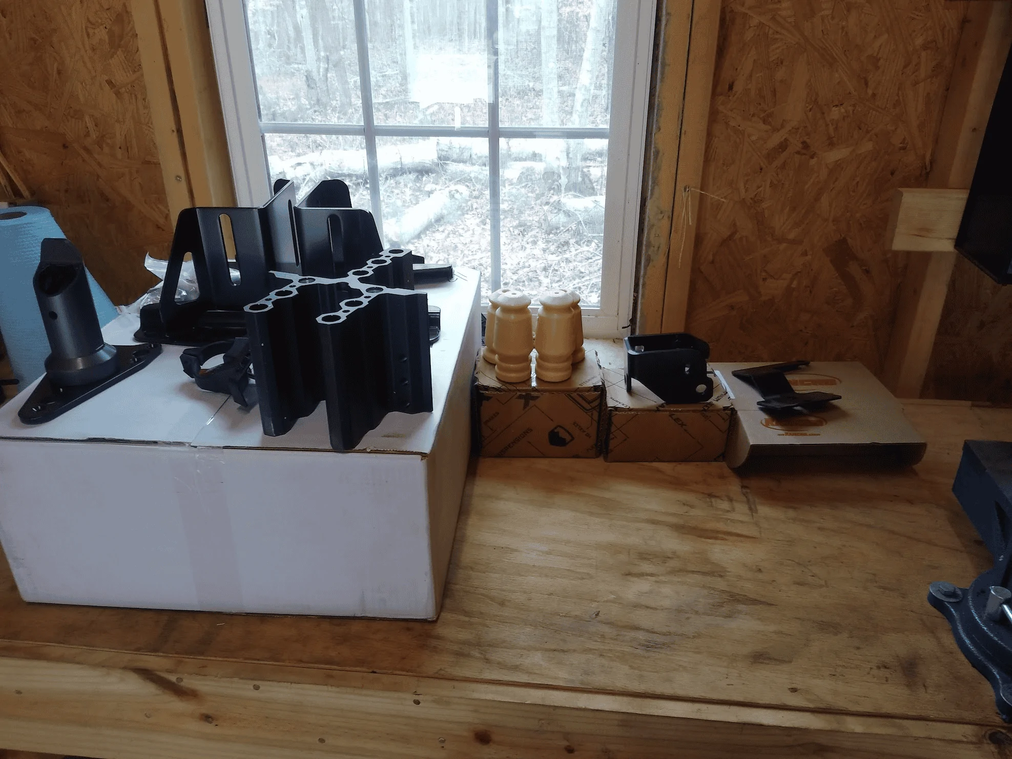

For other curious about the install of the Shrockworks sliders, got these instructions (they're not posted online anywhere I could find, so did some digging and found them).

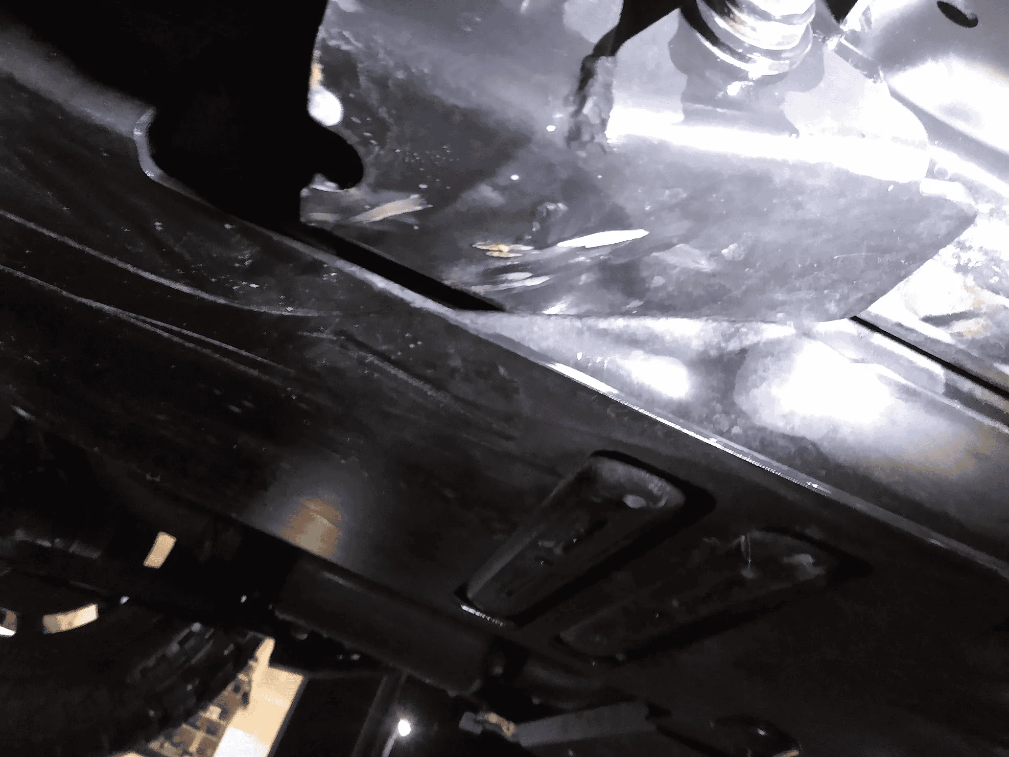

Yep, Rusty's frame-side rear LCA skid. Stout piece, but haven't touched it yet lol. I whacked that spot on the JK a fair number of times, but haven't touched it on the JL at all yet. Either it's due to the slightly different lines I've been running/obstacles I've been avoiding due to stockliness or it's some difference in location/wheelbase/etc between the JK and JL. Stout piece though, looked and felt high quality.
Just some extra backup on skidding the LCA uppers (which I installed after seeing them here), your probably fine stock from a direct hit from below, but my passenger Upper mount got hit from the side, I would assume from my rear tire sliding off a rock, and significantly bent both ears toward the center of the Jeep.
Good find. Those are the instructions that come in the box from Shrockworks.
...I might consider drilling a hole in the front passenger mount and seeing if I can get a bolt or self-tapping screw in there that isn't holding the mount via a slotted hole.
I was thinking the same thing as I got a good look at it posting the photo.

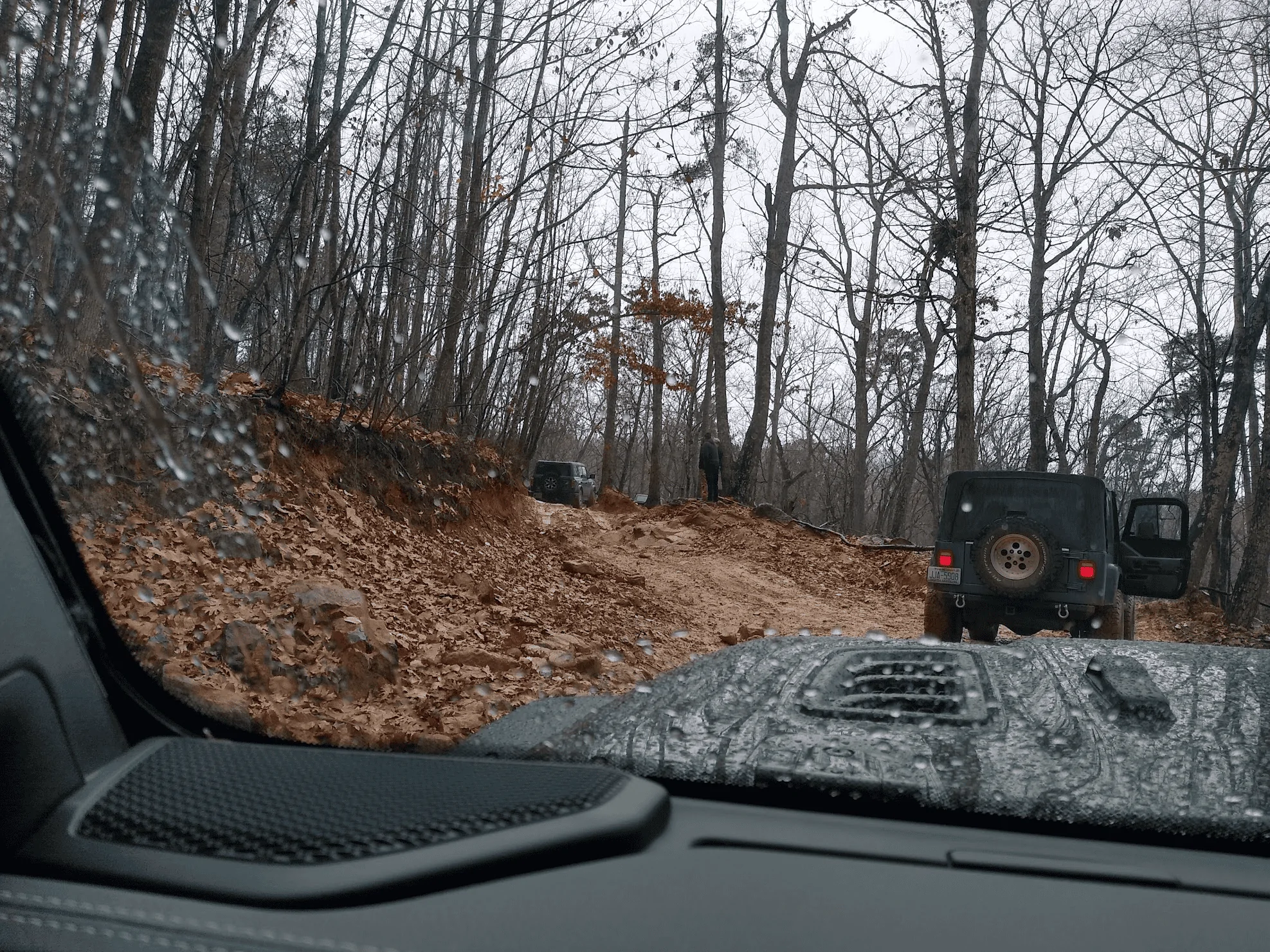

Well, last trip of the season is in the books. Rained the whole drive there, and the whole time we were on the trails, but of course cleared up for the drive home. That being said, very few photos or videos due to not wanting to be out in the wet. We ran Dutch John > Slab Pile > Rocky Mountain Loop > Sawmill > Wolf's Den > Falls Dam > Dickey Bell. Rocky Mountain Loop and Dickey Bell were quite slick and chewed up, with very limited traction.
Might be a little low res, but this video shot by my wheeling buddy on Rocky Mountain Loop shows the kind of slick we're talking about, lots of sliding sideways whenever you'd try and climb a rock because there's simply no traction to be had.
This spot on RML was a good traffic jam. Two Broncos on KO2s were struggling to get up this section and kept sliding sideways towards a tree (narrower Jeeps FTW).
Jeep Wrangler JL '22 JLR 2.0T build progress/wheeling thread 1670249971485
The TJ in front of me there was on 31" KOs and it was this guy's second time ever being off road and watching these Broncos struggle with lockers and bigger tires, he thought there was no way in hell he was going to make it and I could tell he was super nervous. This trail is well within the capabilities of his Jeep, RML isn't hard, but the sloppiness and intimidation factor were getting to him. It was a good opportunity to give him some advice on how to handle his Jeep on this kind of wet trail day. Felt good to pay it forward and help him build confidence, everyone was new at some point and hopefully he'll do the same in the future. Great reminder to lend a helping hand if you can.

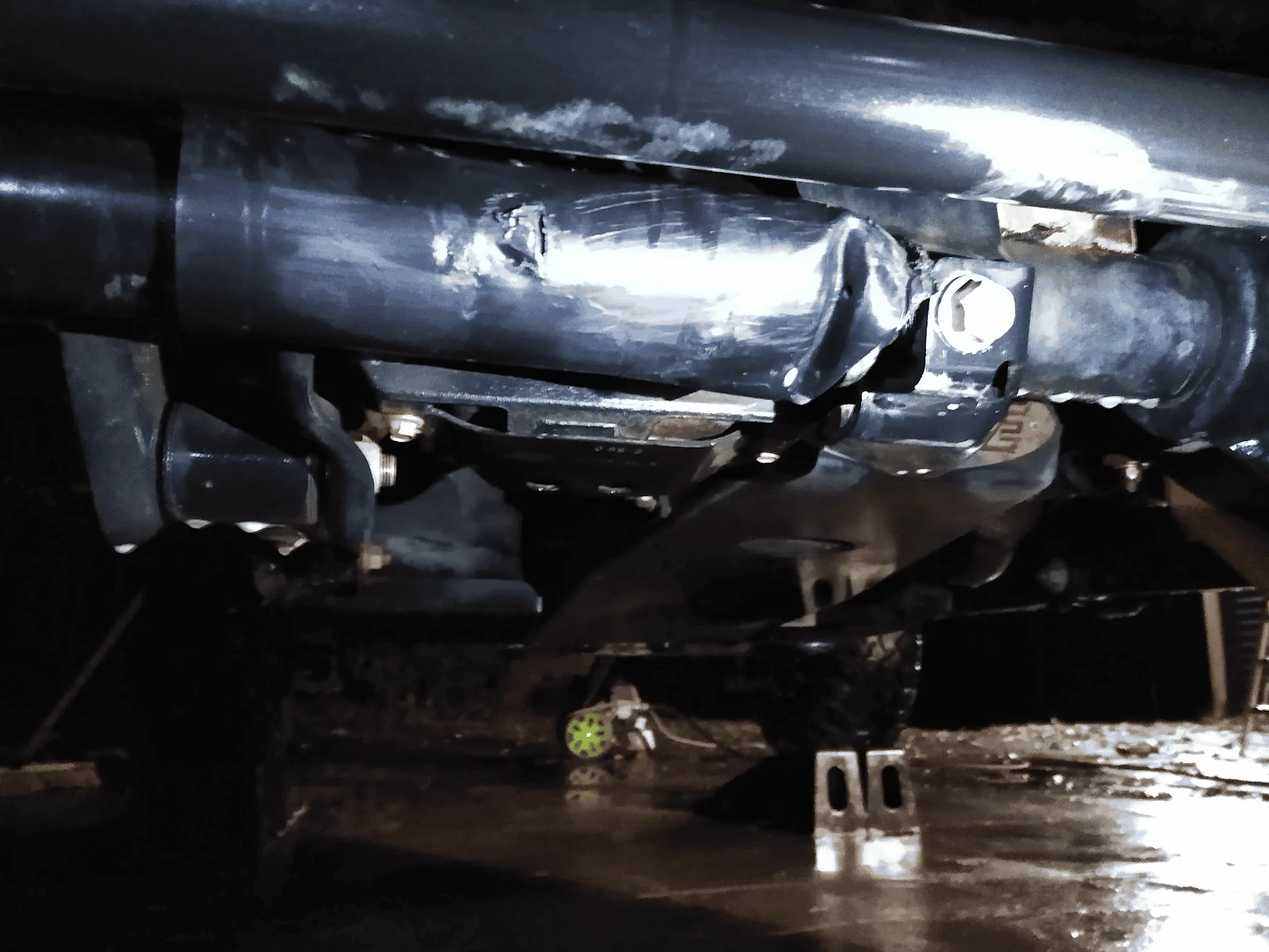

Finally got the steering stabilizer! Looks like tie rod is fine, was a glancing blow, but will be keeping an eye on it. Also, finally got the frame-side rear LCA skids, was starting to wonder if I'd actually needed them, and yes, I was very glad to hit them. The bottom picture is a little shitty, but one of those hits put a divot in that 1/4" plate between a 16th and an 8th deep. It would have been very unkind to the thin stock bracket.

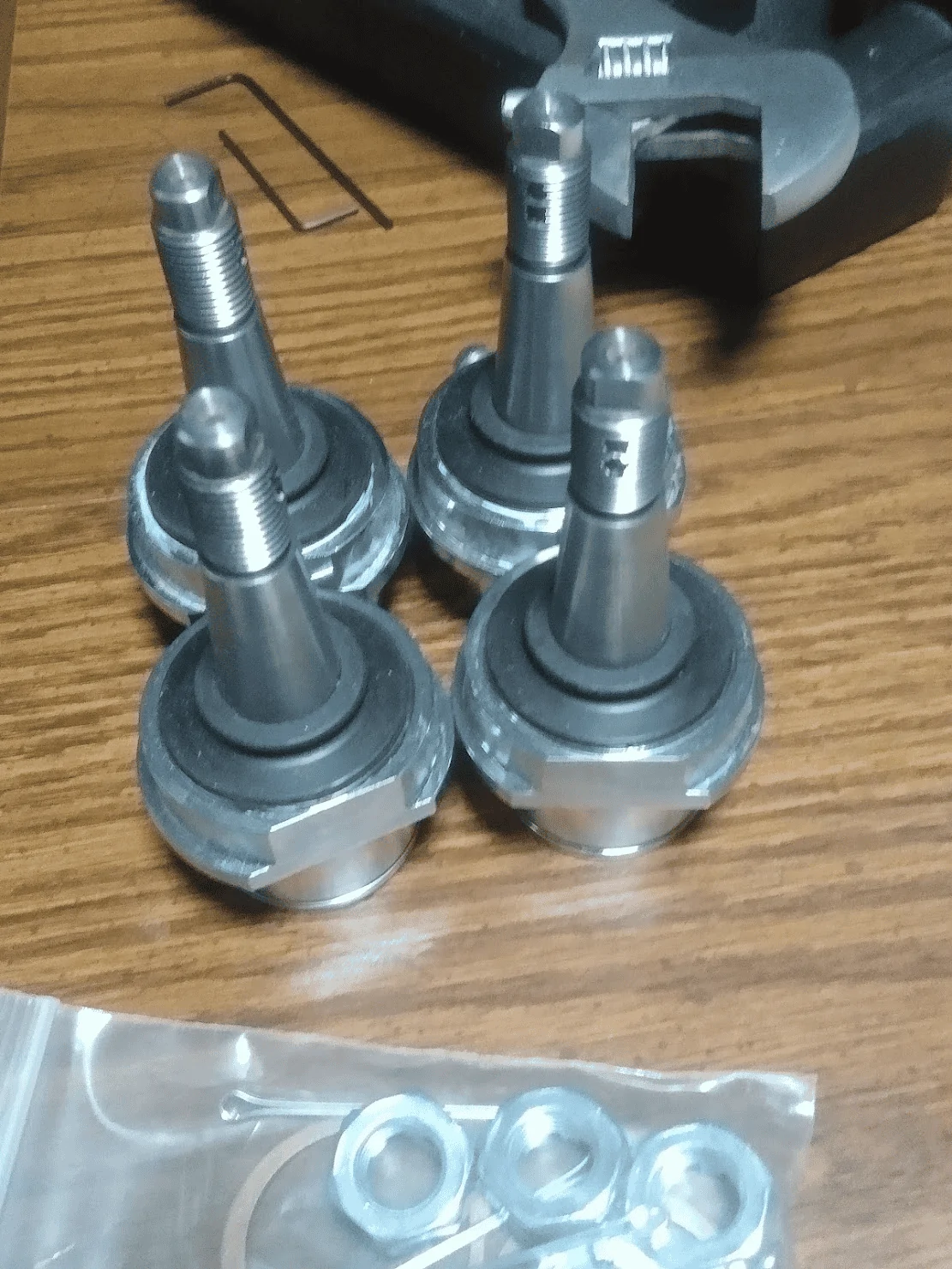

Ball joints showed up!
Jeep Wrangler JL '22 JLR 2.0T build progress/wheeling thread 1670429648200
Dynatrac's ball joints were one of the best things I ever put into my JK build and they're one thing I knew I absolutely would be putting into the JL build. With the JK, I went through 3 or 4 different sets of ball joints in roughly 30k miles. The Dynatrac set went in and lasted over 70k miles without needing rebuilt and completely solved my steering shimmies. Once the Mopar steel knuckles show up, these alongside the knuckles and tire carrier will go on the planning board for install days.

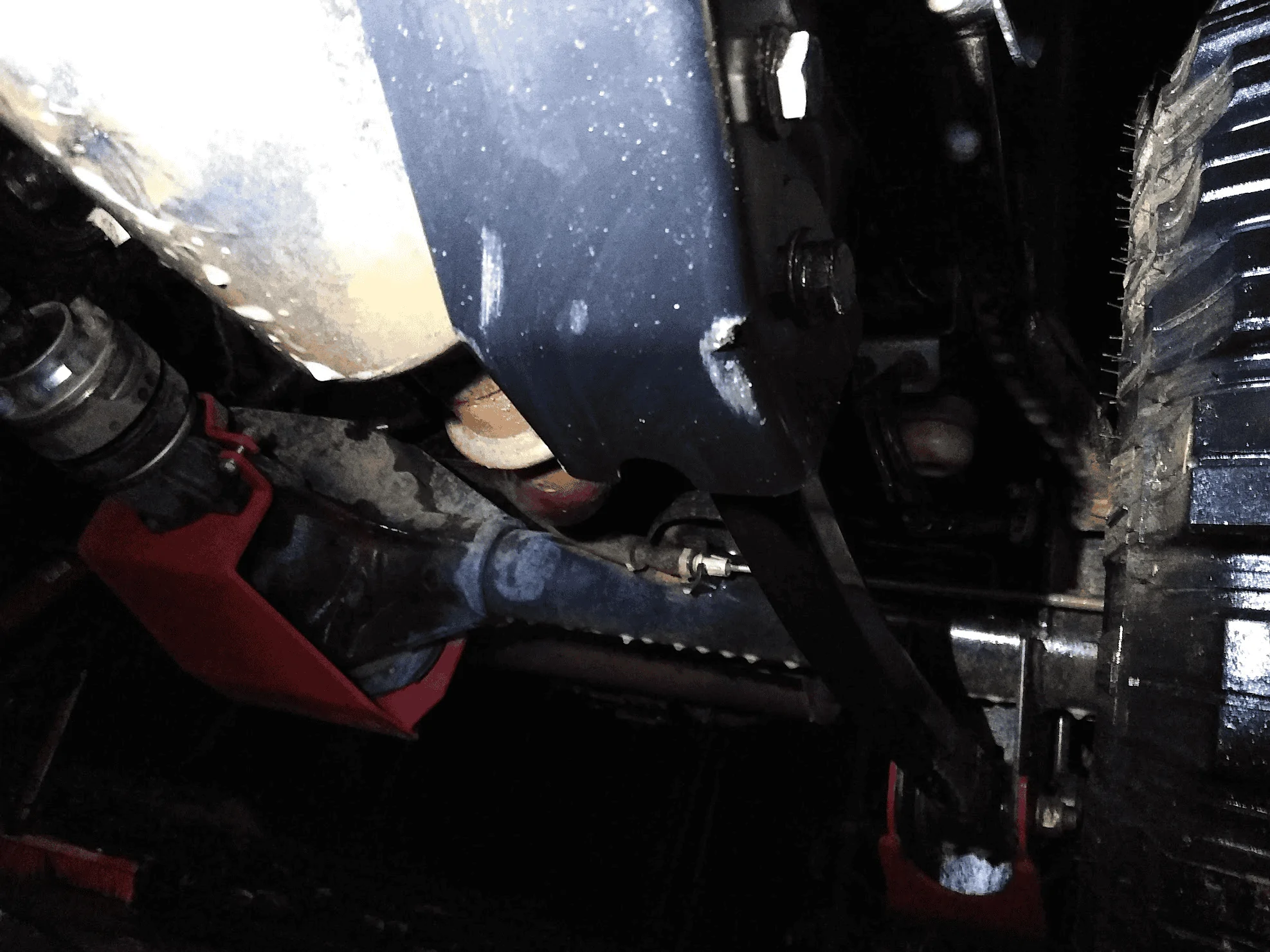

Things I hit most that aren't covered by a factory skid are, in order from most often to least often, the rear diff skid, front diff skid, engine skid, axle-side LCA/shock skid. With the stock 285/70/17 tires, the diffs are really low, and the engine/trans pans are pretty exposed at stock suspension height. The diffs and engine skids are the most important, for the lines I'm taking anyway.
Stock skids do okay for the most part, but they leave out the oil pan. What I hit the most are the rear lower control arm/shock brackets so I recommend skids for those at a minimum.
Doesn’t hurt to cover differentials either.
Interesting, I hit those way less than my diff skids lol.
Maybe it’s driving style or the types of rocks we’re in?
I hit my rear LCA mounts so often in Arkansas that the first thing I did when I got back was order the Artec skids. I would barely scratch my diffs here and there, but not anything to be too concerned about. I still haven’t gotten a skid for the oil pan, but I’ve been saving for the Artec full belly.
I’m not in too much of a hurry for more armor now that I’m in Michigan, though. It’s almost all sand here.
That'd be my thought too - I know I hit different parts of the JK when I did Rausch Creek with a buddy up north than I hit here in NC. And Moab was a whole different game compared to either NC or PA wheeling.

That'd be my thought too - I know I hit different parts of the Jeep when I did Rausch Creek with a buddy up north than I hit here in NC. And Moab was a whole different game compared to either NC or PA wheeling.
I guess it’s safe to say ā€œjust armor everythingā€ and you’ll be good. ?
Moab scraped the rear diff skid a bit, but nothing else. I even sent a few bigger rocks down the middle to tap on the full belly skid. Nothing.
Got my rear shock mount on a rock here in Colorado, but it was the only hit. Even in and around a bunch of bigger rocks. It really is more about the line and how fast you are going to allow your Jeep to bounce or dip low into the rocks.
Keep it slow and tip toe through those rough sections, and you will do fine.
My biggest want would be a skid to protect that oil pain.
