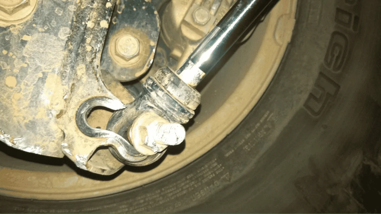

Yup, or lift high enough to make skids less necessary lol. Will say, one benefit of the LCA/shock skids is that something like this won't happen as easily. Happened on my JK when I goofed and left the shock bolt hanging out to the inside of the axle and slipped off a rock funny:
Jeep Wrangler JL '22 JLR 2.0T build progress/wheeling thread 1670510658143
The reinforcement from some of those LCA/shock skids may have prevented that.

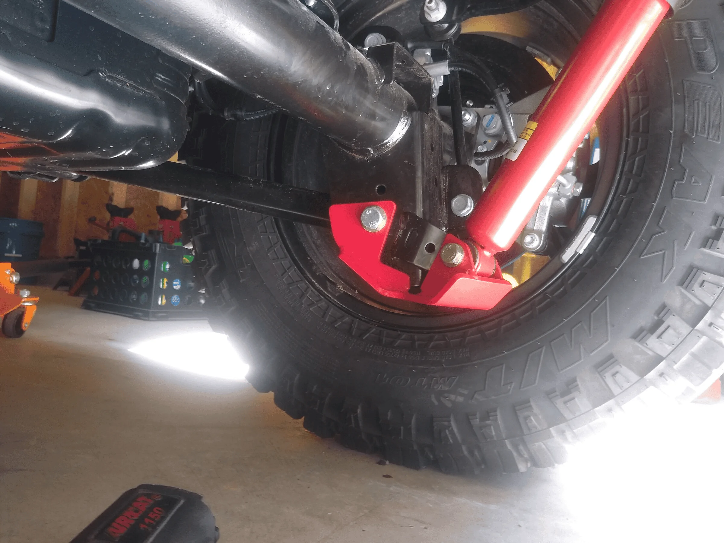

I know you are running the Rancho diff and shock skids @Remorseless is there a specific reason why or something I should look for?
For the diff skids, my buddy had been running the Rancho skid in the rear of his JKU for some time and it did well by him, so I decided to give it a try. Also liked that I didn't have to run anything other than the factory diff cover, made it easy. For the shock skids, I liked the way they were shaped at the rear of the skid:
Jeep Wrangler JL '22 JLR 2.0T build progress/wheeling thread 1670511958213
Kind of encapsulates the shock and lets the skid slide down an obstacle without losing protection. There are definitely other skids of the same variety with this design, and I'm sure it'd be fine to run any of them, but I went with the Ranchos because I trusted them for the diff sliders so why not the LCA/shock skids?
