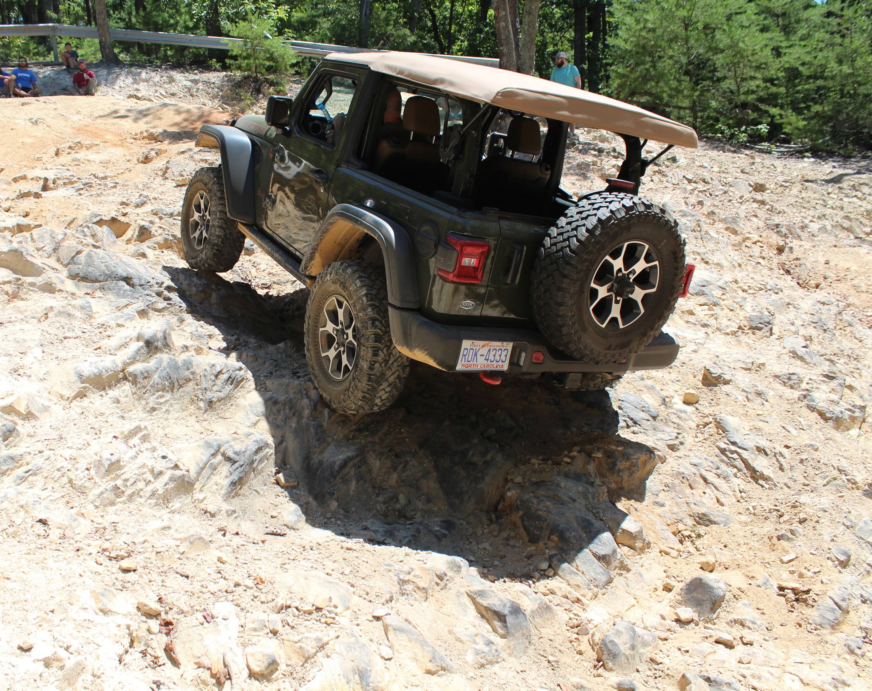

Finally, a wheeling update. Got to go to Uwharrie this past Saturday and ran trails in the following order: Wolf's Den > Falls Dam > Dickey Bell, lunch at the Outpost, and then Rocky Mountain Loop > back side of Daniel. The JLR did great, better than expected actually. Before Saturday the smallest tire I'd run there was a set of 35" KM2s (small for a 35, admittedly, but bigger than the stock JLR tires) and on a 3"-ish lift. I was expecting to have to take a good number of bypasses or to be scraping bottom constantly, but thankfully that wasn't the case. Don't get me wrong, we used the skid plates a good amount (a "carnage" post will be following this one), but nowhere near as much as expected.
My wheeling buddy runs a JKUS on a 4" Mopar lift, with 35" Toyo AT IIIs. I'll have a few pics of him in the following as well, it's a fun point of comparison. The weather was perfect (sunny, low/mid-80s, and only roughly 50% humidity - a rarity this summer for NC). Only thing I wish was that the rain we've been having would have kept the dust at bay. It was an extraordinarily dusty day.
Dickey Bell:
Jeep Wrangler JL '22 JLR 2.0T build progress/wheeling thread IMG_5898.JPG
My buddy's Jeep makes this look easy, but as can be seen below, it's not an insignificant climb for a stock Jeep on this line.
Jeep Wrangler JL '22 JLR 2.0T build progress/wheeling thread IMG_5914

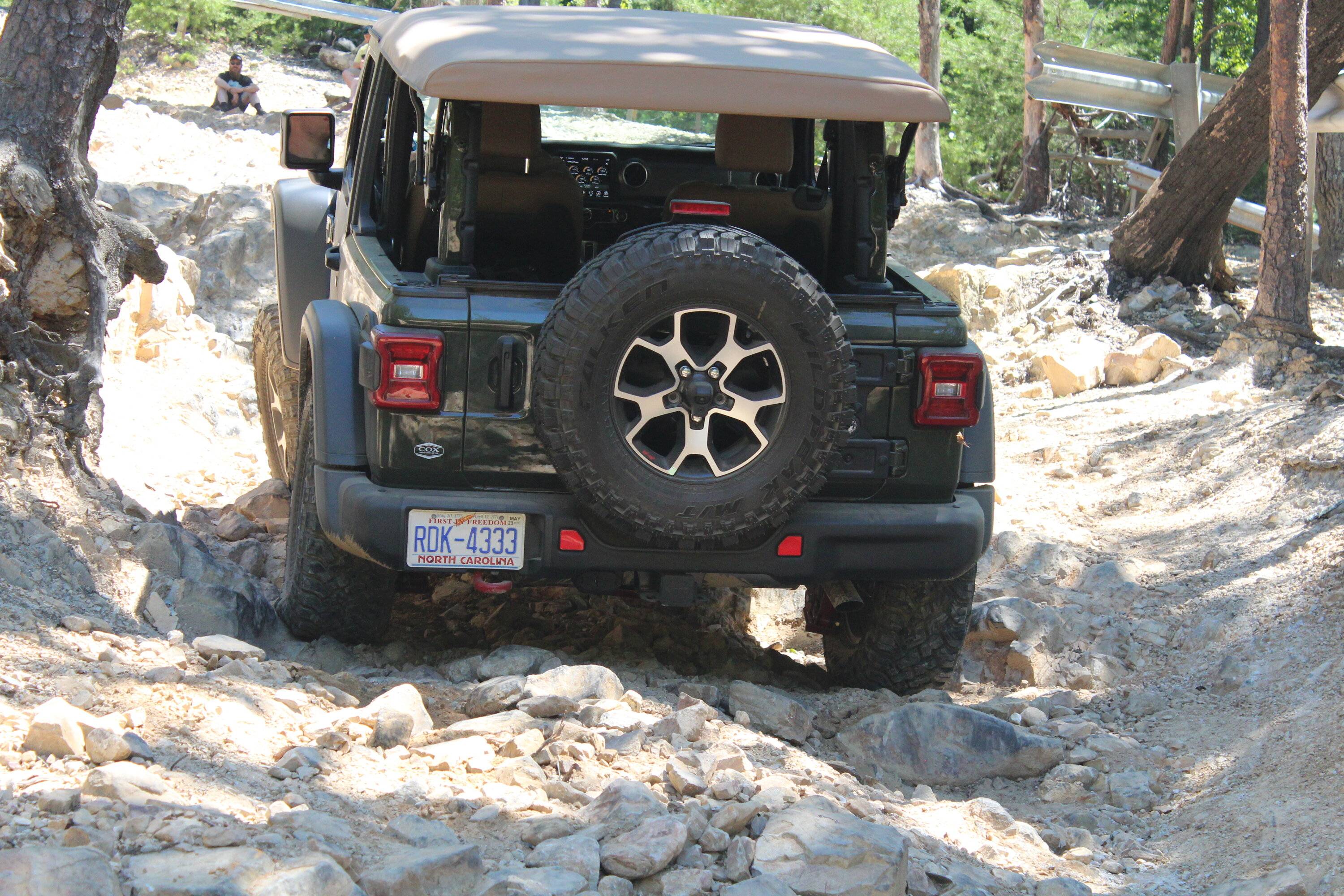

From a clearance perspective, the top section is relatively easy for a lifted Jeep. However, being open/open does introduce more challenge given the verticality of the trail (hard to see in pictures, but it's really hard to walk up/down, super steep) and the general lack of consistent traction on our rocks.
Jeep Wrangler JL '22 JLR 2.0T build progress/wheeling thread IMG_5905.JPG
Jeep Wrangler JL '22 JLR 2.0T build progress/wheeling thread IMG_5907.JPG
Lockers definitely helped the JLR pull itself up.
Jeep Wrangler JL '22 JLR 2.0T build progress/wheeling thread IMG_5922.JPG
Jeep Wrangler JL '22 JLR 2.0T build progress/wheeling thread IMG_5925.JPG
Jeep Wrangler JL '22 JLR 2.0T build progress/wheeling thread IMG_5927.JPG
Jeep Wrangler JL '22 JLR 2.0T build progress/wheeling thread IMG_5933.JPG
Jeep Wrangler JL '22 JLR 2.0T build progress/wheeling thread IMG_5938.JPG
Rocky Mountain Loop:
Jeep Wrangler JL '22 JLR 2.0T build progress/wheeling thread IMG_5944.JPG

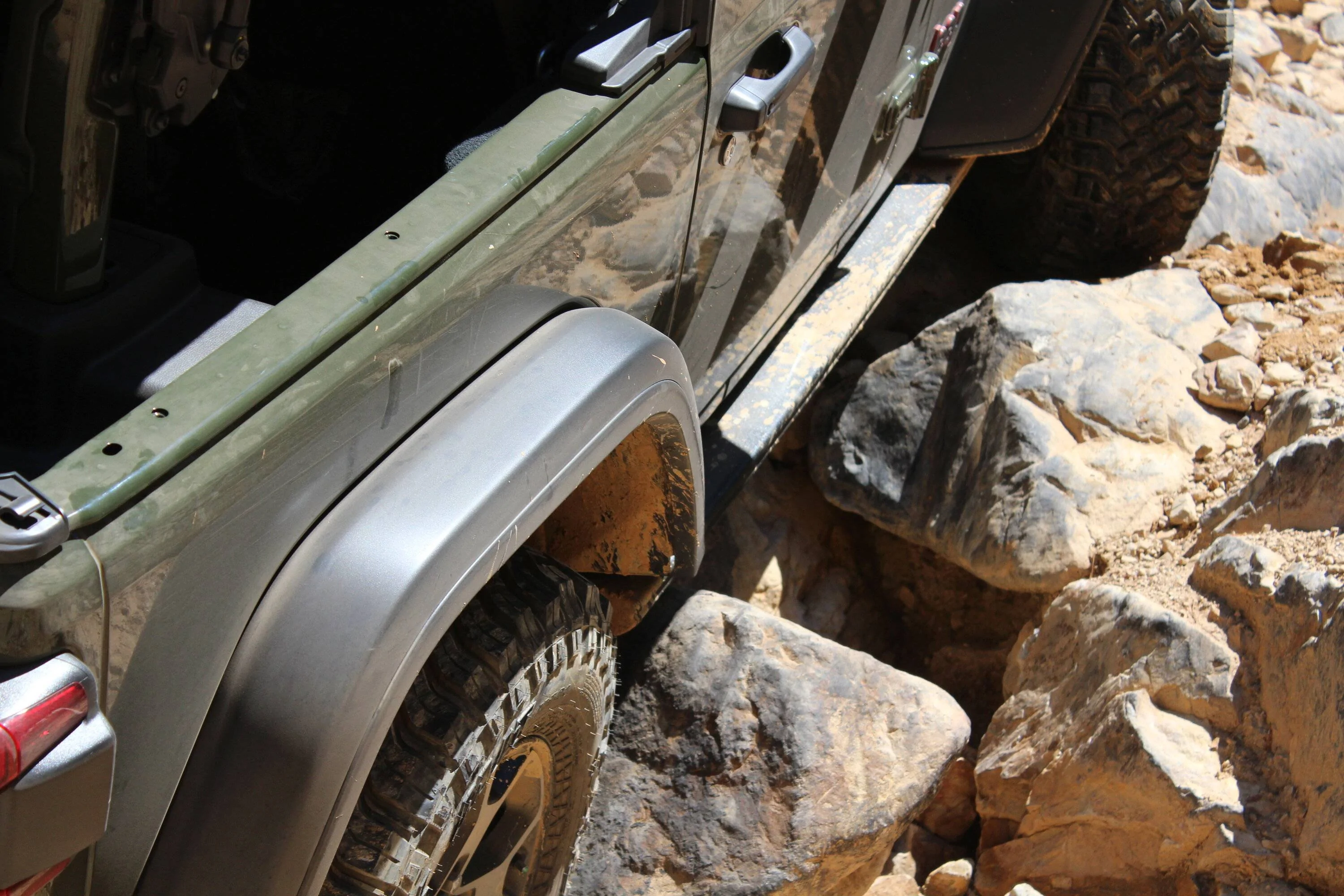

These two shots really show the differences in clearance between a lifted and unlifted Jeep. Even with the longer wheelbase, my buddy's Jeep has no issues clearing this rock, while the short wheelbase two door just kisses the LCA skid.
Jeep Wrangler JL '22 JLR 2.0T build progress/wheeling thread IMG_5958.JPG
Daniel (top):
We usually don't run the front of Daniel due to it getting super rutted out and always being a traffic jam. However, the top is a nice place to sit and get a nice view of the hills. The other nice thing about the back side of Daniel is the plethora of lines you can take. Everything from stock truck friendly to fun, short-but-challenging obstacles. No pictures of this, but on the way down we got adventurous with the lines and found a few spots that pushed the limits of the stock JLR, used the skids a fair amount, and even the rock rails.
Jeep Wrangler JL '22 JLR 2.0T build progress/wheeling thread IMG_5970.JPG
Jeep Wrangler JL '22 JLR 2.0T build progress/wheeling thread IMG_5962.JPG
Overall a great day on the trail!

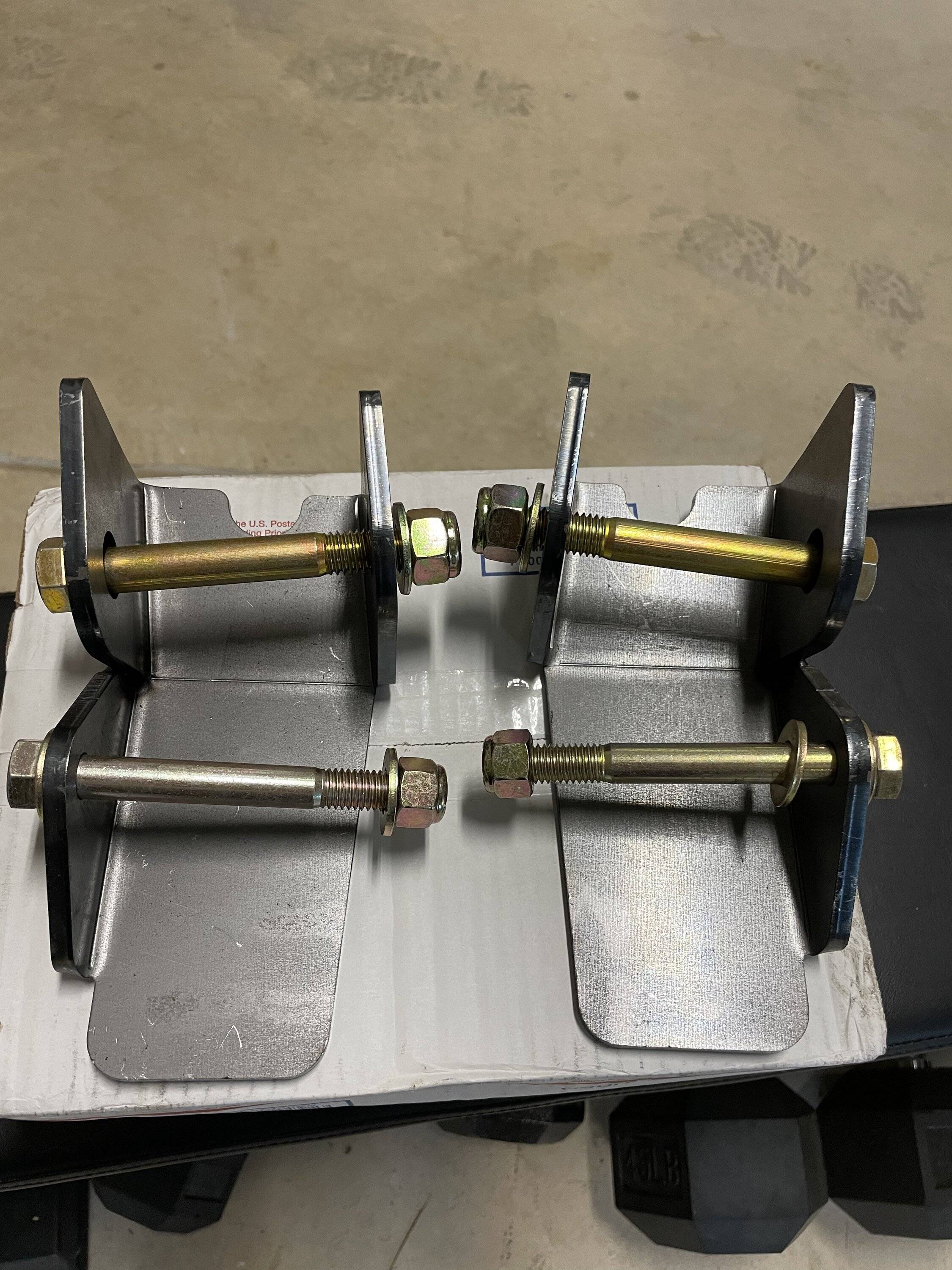

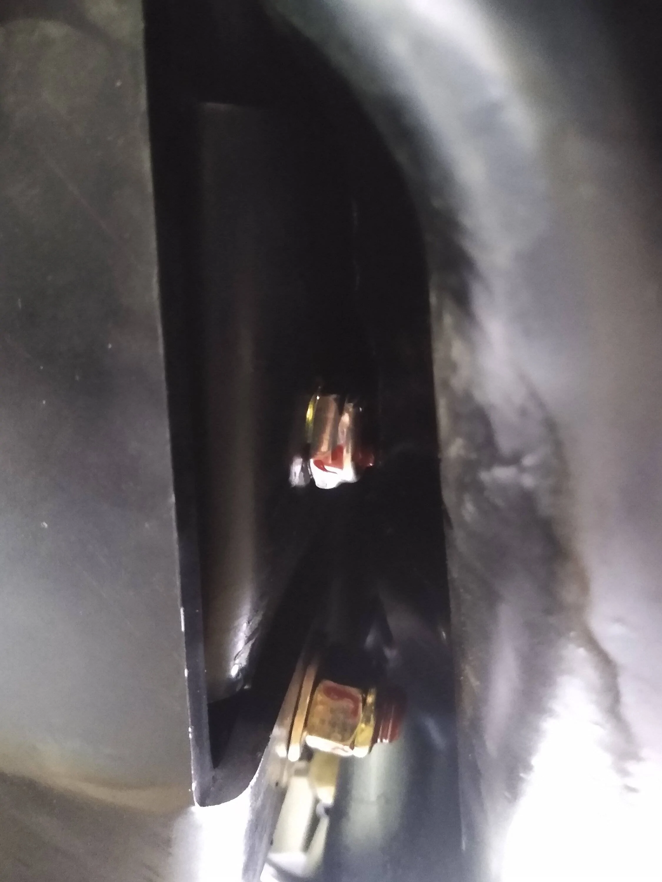

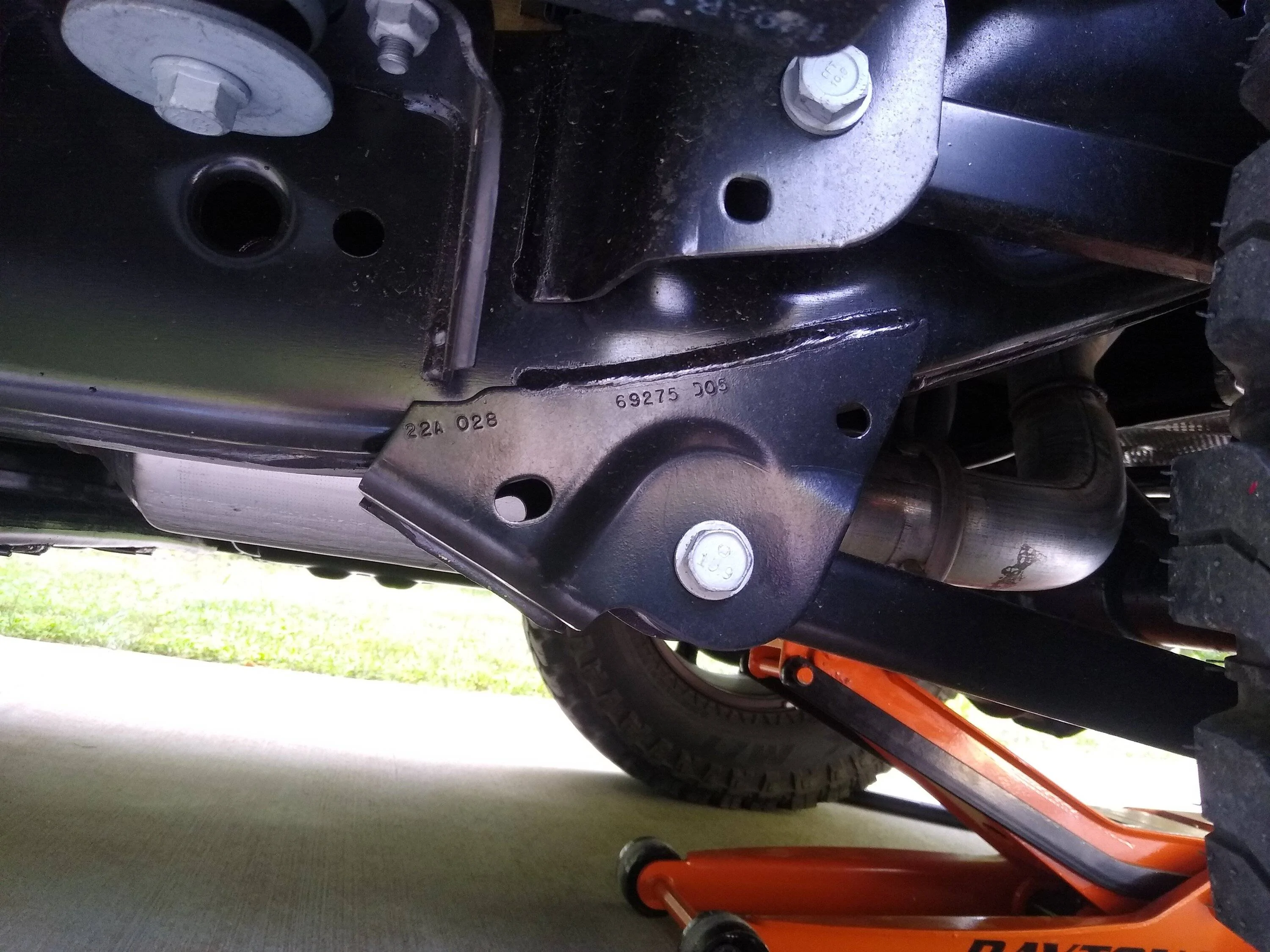

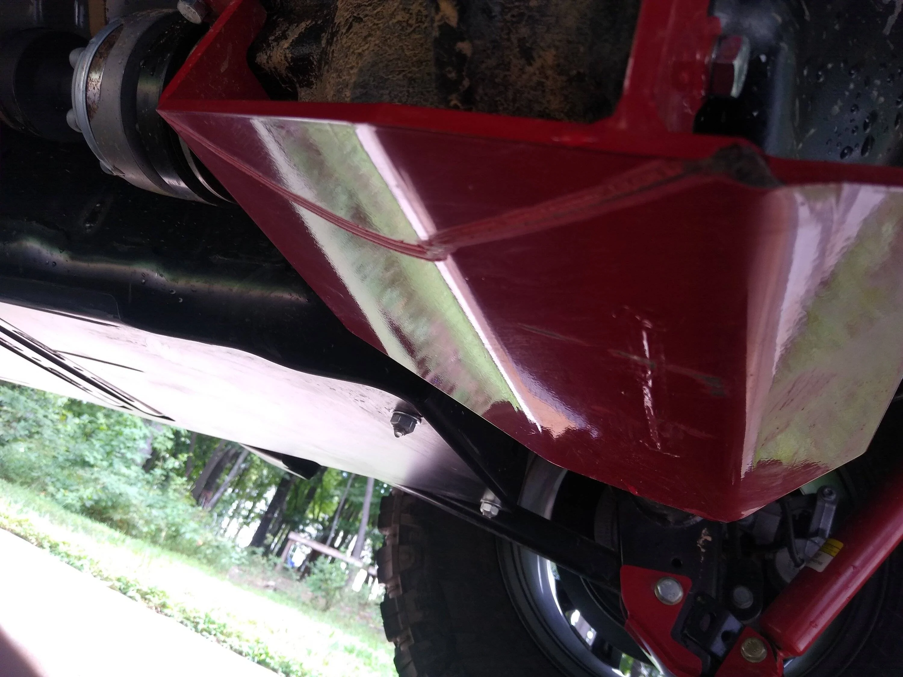

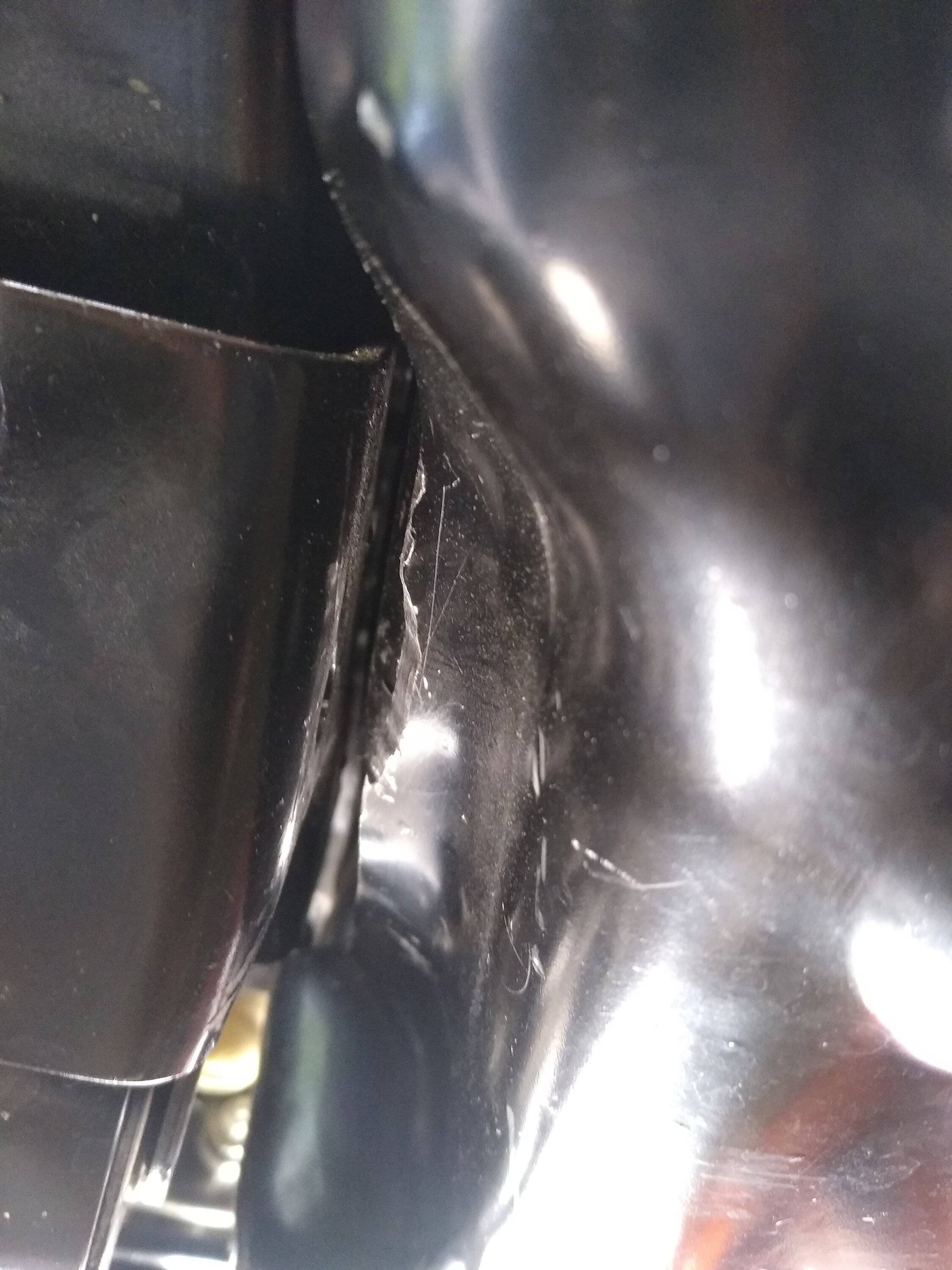

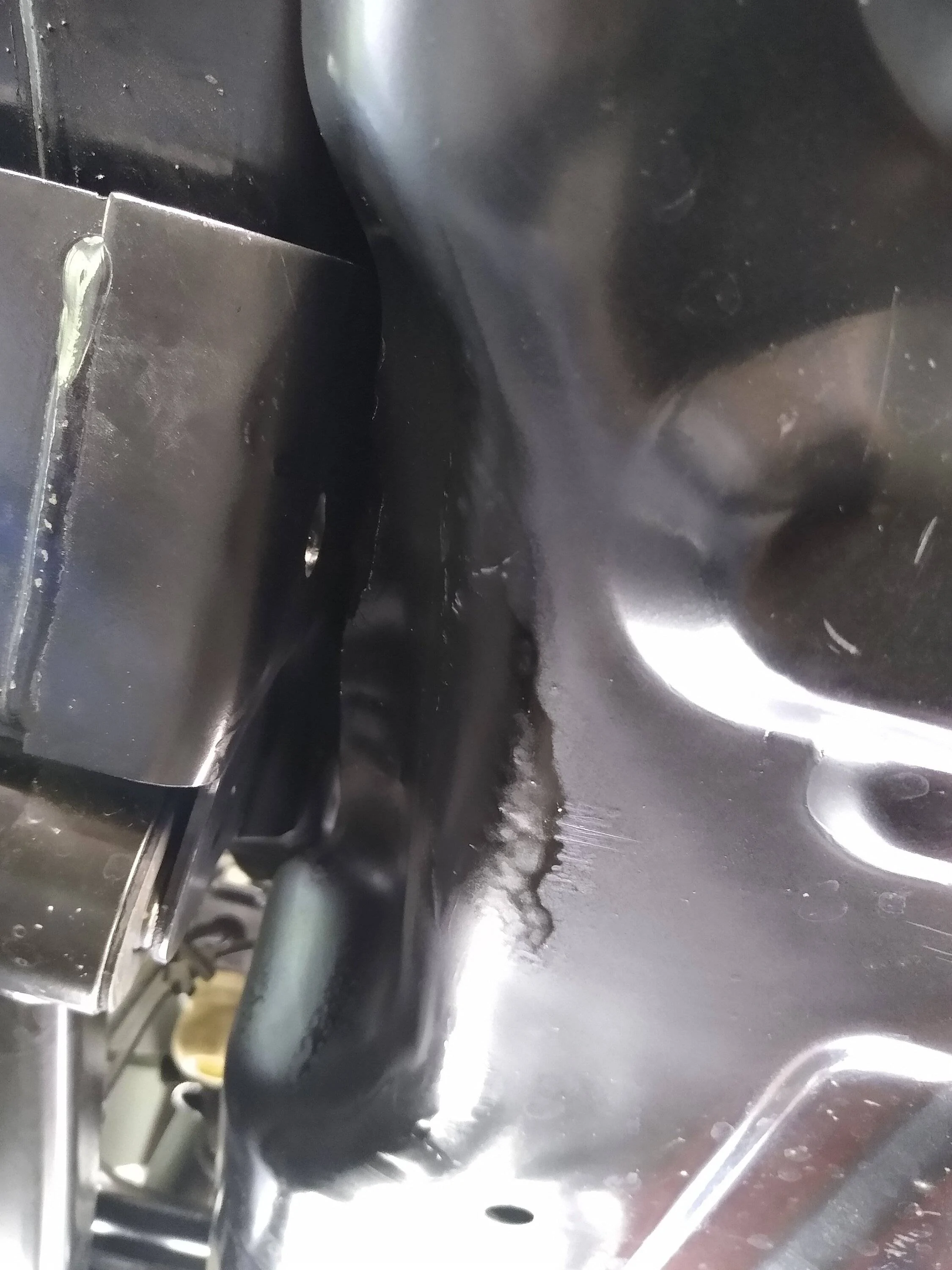

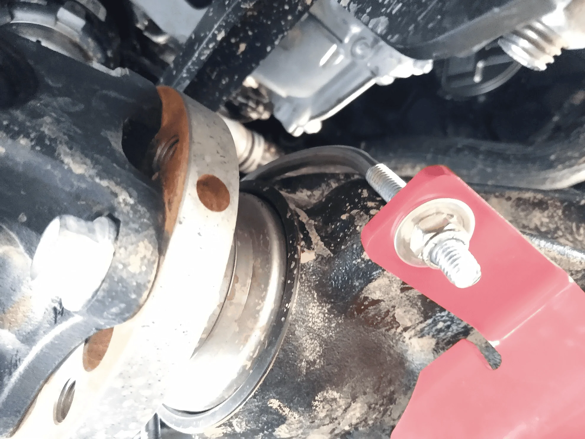

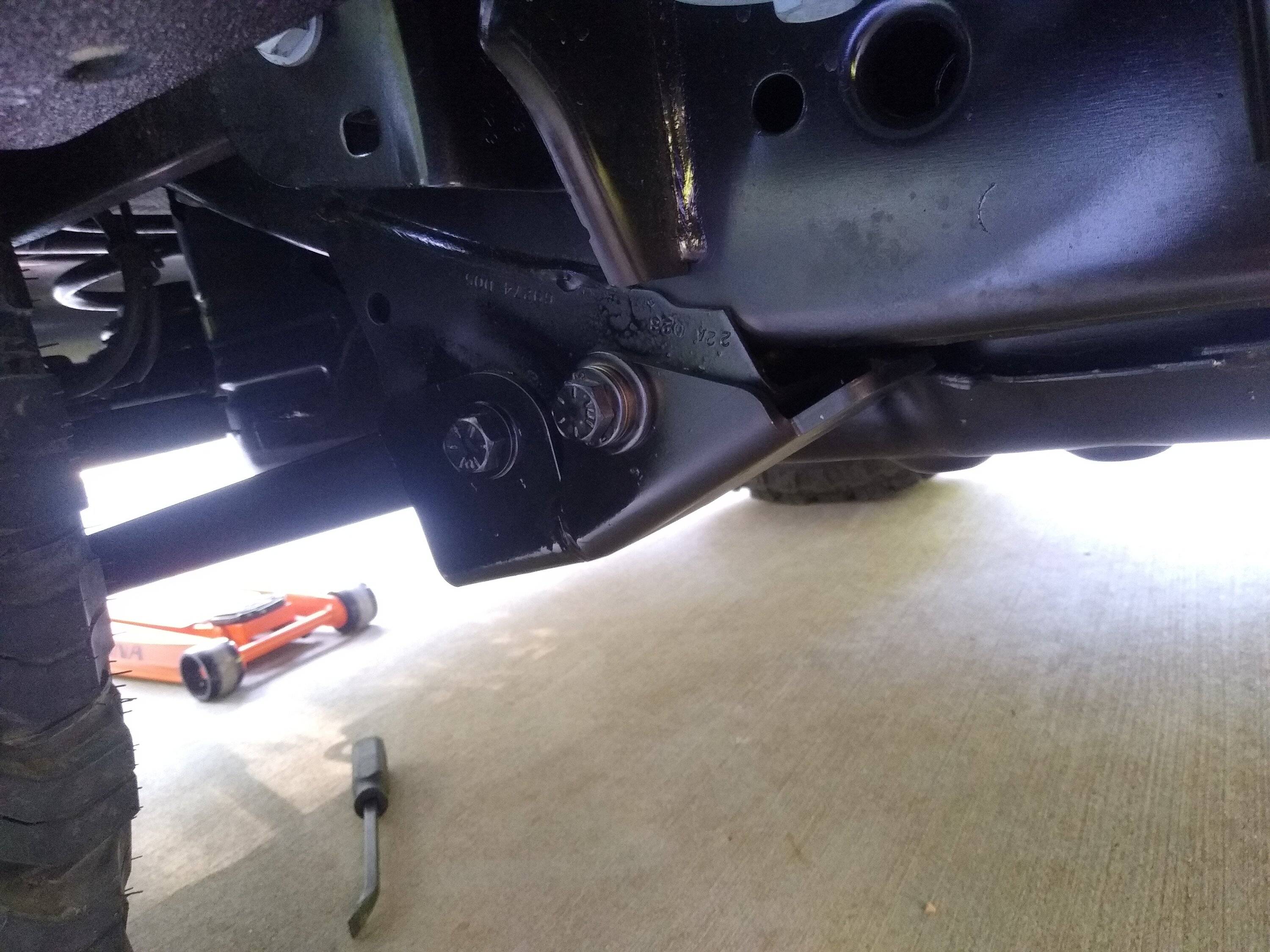

Well, got the Rusty's frame-side LCA skids put on this past weekend. Passenger side definitely needed a little grinding and is a little jankier than I'm happy with, but will have to do for now.
The supplied hardware is nice enough - all grade 8 stuff, nylon lock nuts.
Again, keeping the axle from moving too much with the jack to keep the LCA from being too misaligned with the bolt hole on the frame side. Stock bracket is fairly light duty.
Driver's side goes on stupid easy. Yes, I did rattle can the bolt heads - washers pulled up paint off the skid while torquing down, didn't want the bare steel to corrode/rust. Just easier to rattle can over them than it is to be uber precise with it. Skid lines up well and should do good to protect that bracket from getting mangled.

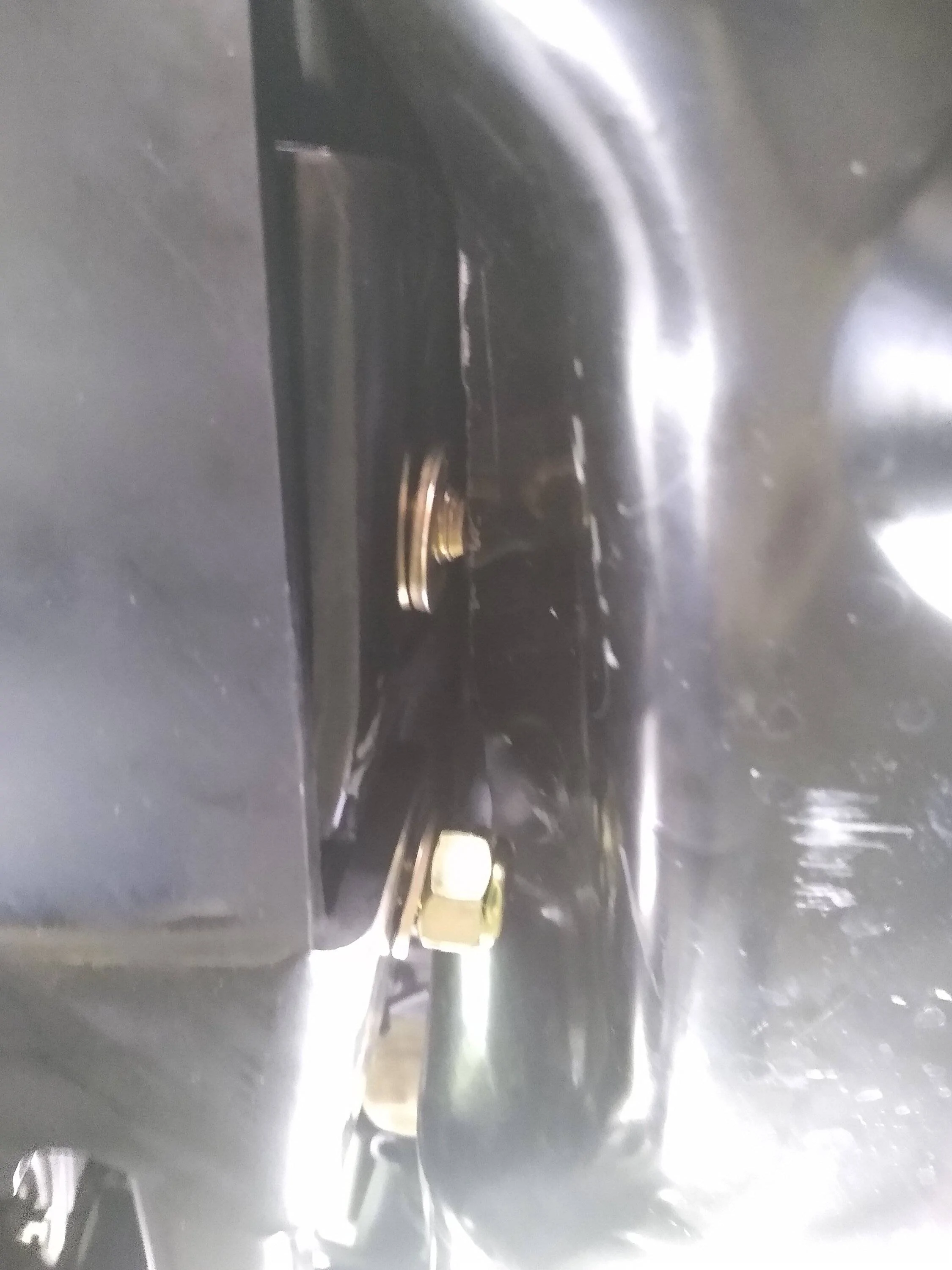

The passenger side, above, is where the dilemma can be seen - the forward-most bolt used to locate the skid on the bracket and to keep it from rotating around has less than 1/4" clearance between the stock bracket and the gas tank skid.
Solution was to Dremel back the lip of the gas tank skid to clear a low-profile 1/2-13 nylon lock nut. Gas tank is close enough to the skid I wanted to clearance as little as possible, even though a nut with no washer is less than ideal - fortunately all this bolt does is locate the skid and prevent it from flopping around. That skid may be thin, but it's hard steel. Chewed through 3 Dremel grinding bits - although they did have to be narrow bits in order to fit in the space.
Cleaned it up with a bit of rattle can to cover the bare steel.
Nut now barely clears the skid, just a few thousandths really - but clearance is clearance and she fit. Packed it full of thread locker, should hold.
The other part of the workaround is to stack washers beneath the bolt head for this bolt - it's an odd sized bolt, like 4-3/4", and if you're hitting this issue you really need like a 4-1/4" bolt. Nobody carries a 4-1/4" 1/2-13 grade 8 bolt in your standard hardware stores. So, stack washers we do to shorten it up so it holds tight. You can order a 4-1/4" bolt and I might do so if this gets hung up on stuff or bothers me too much, but for now it's in and holding tight.
Another option may be starting with a stubby 1" or 1-1/2" bolt inserted from the inside of the bracket and through the outside hole with the nut on the outside instead of the inside, or a stubby bolt threaded into a flag nut where the flag sticks out the front of the bracket.
Probably going to send this info to Rusty's - either the clearances between the bracket and skid are different on a 4 door (everyone seems to be oriented towards 4 doors these days), or this is one of those rolling changes Jeep has made with the 21's/22's, or it's just a Jeep-to-Jeep variation in clearance. Either way, skids are on, but something's up with passenger side clearance.
Damn, not sure how I missed these being available. I've done some damage to the passenger side already. Thanks for posting this!

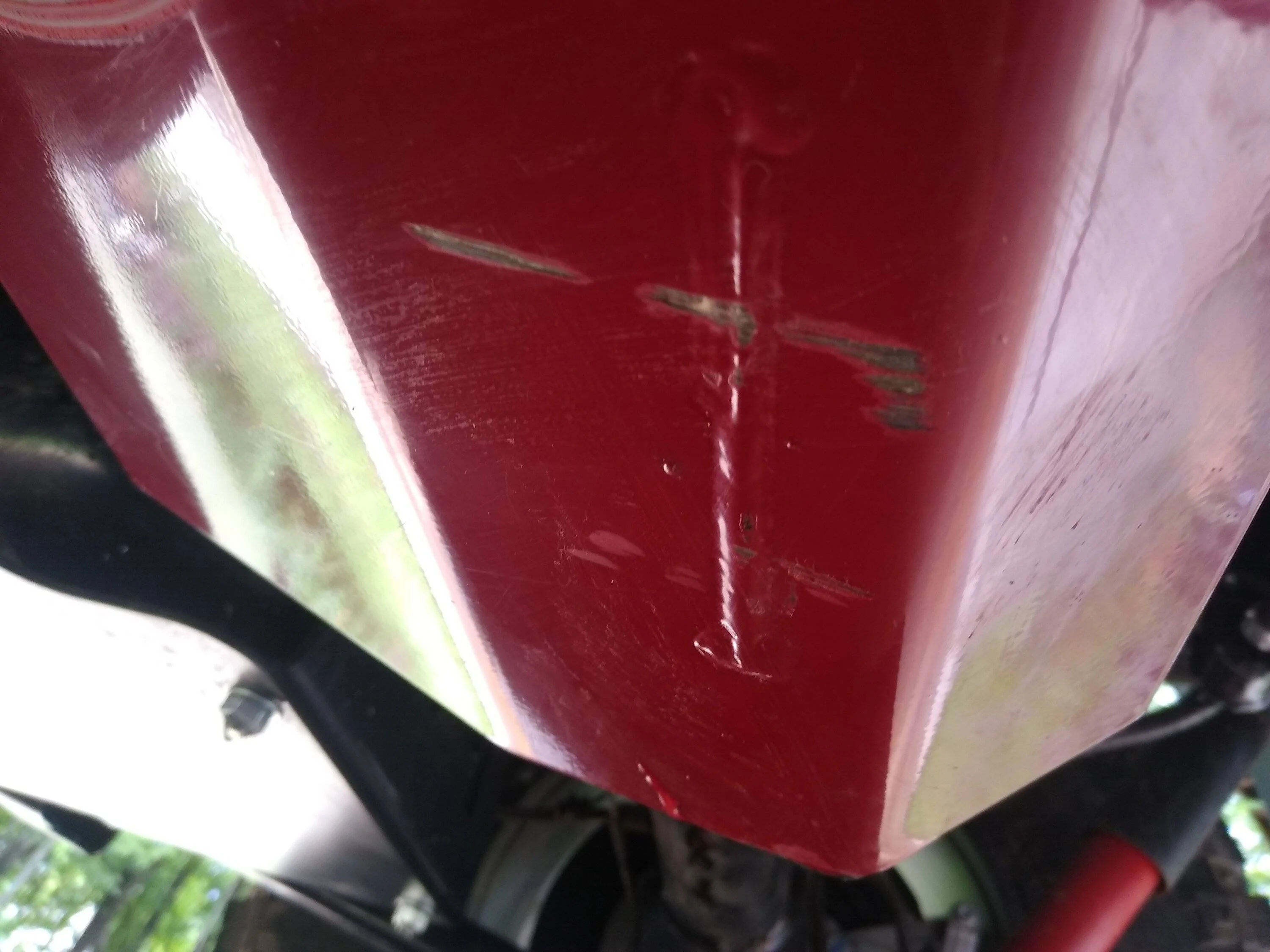

Rear diff skid took a decent hit or two, got through the powder coat in a few places:
Jeep Wrangler JL '22 JLR 2.0T build progress/wheeling thread IMG_20220814_141250785
Jeep Wrangler JL '22 JLR 2.0T build progress/wheeling thread IMG_20220814_141236983

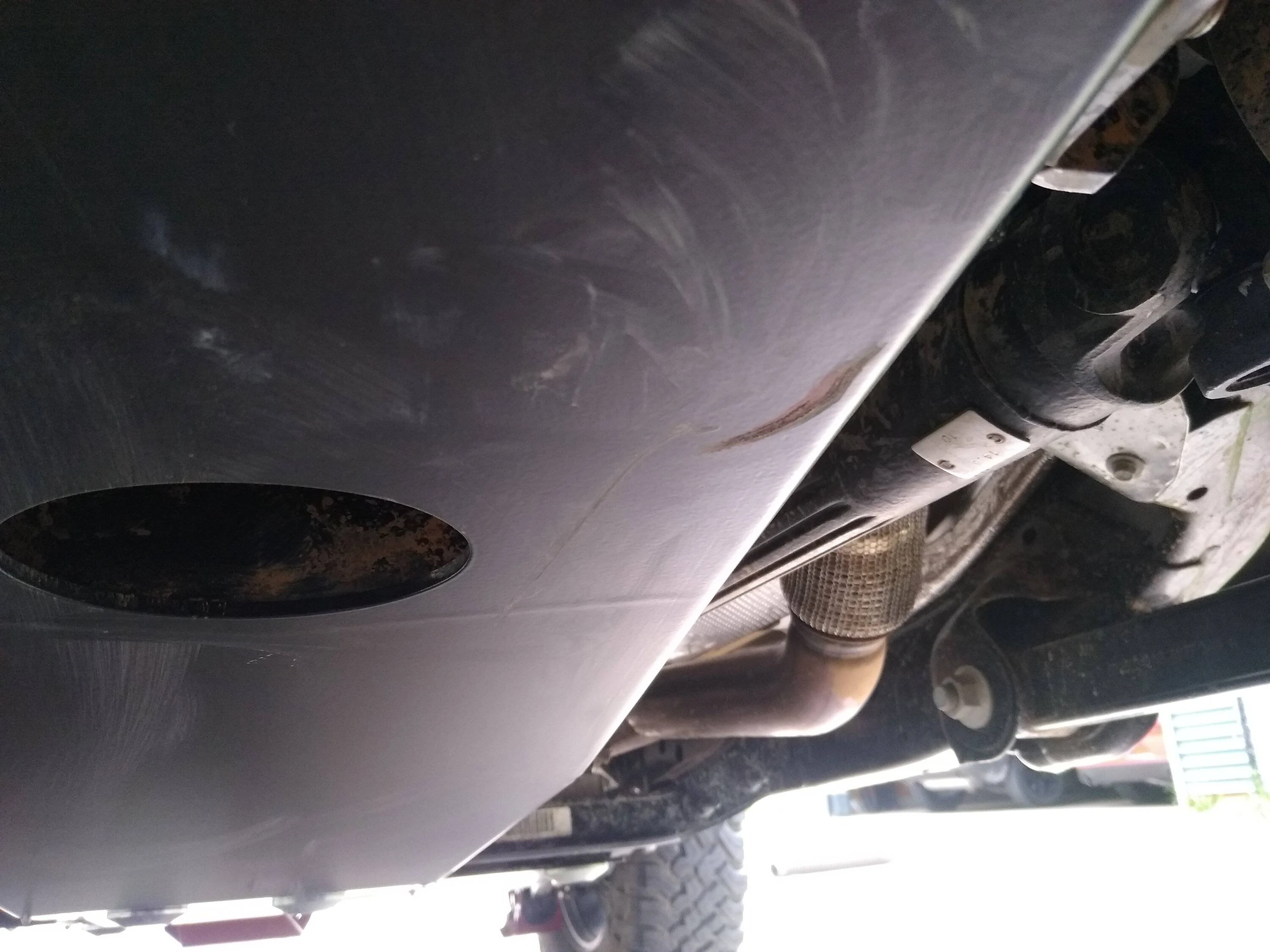

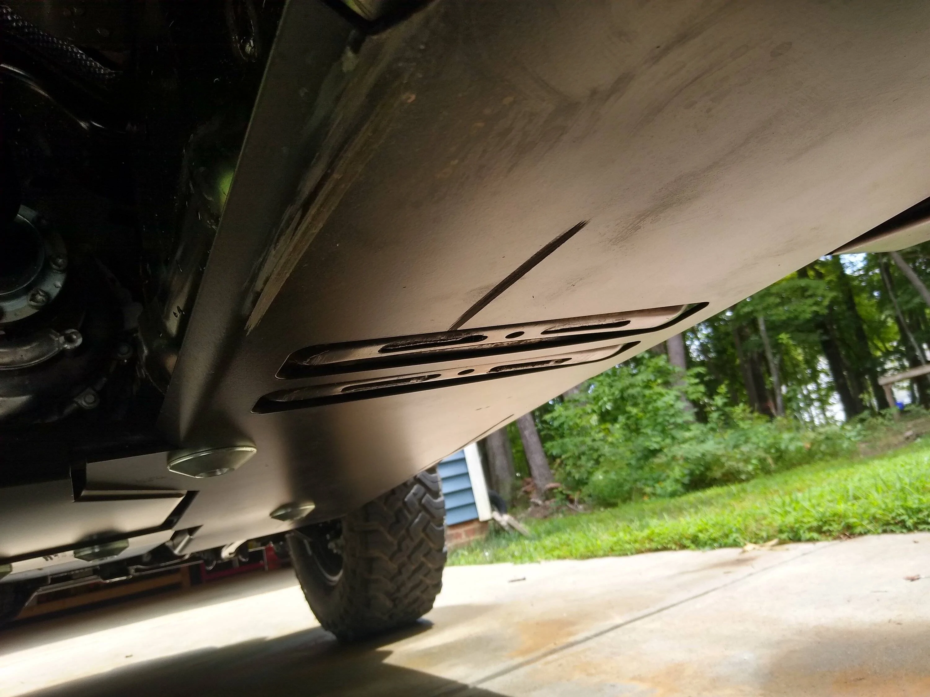

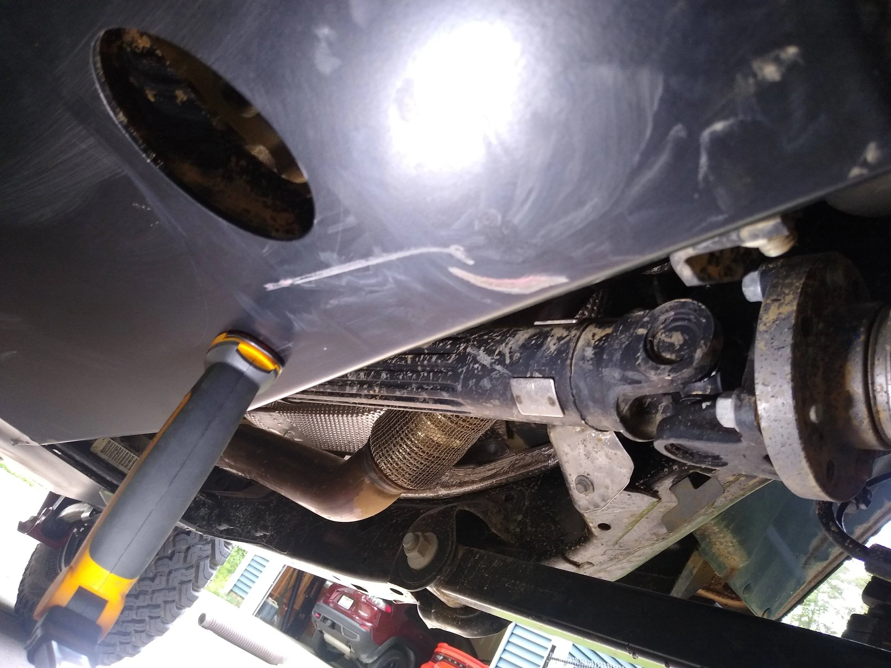

M.O.R.E. Engine Skid:
This skid is the one I would deem the most critical if you're going to do fun stuff in a stock Wrangler. Took a couple of hits near the oil drain port and near the trans crossmember that would have been uncomfortably close to the oil pans. There's always the question of whether or not the hit was because of the lowered clearance from the skid or if it would've actually been dangerous to stock components. Either way, was happy to have it.
Jeep Wrangler JL '22 JLR 2.0T build progress/wheeling thread IMG_20220814_164457335
Jeep Wrangler JL '22 JLR 2.0T build progress/wheeling thread IMG_20220814_164416741
Jeep Wrangler JL '22 JLR 2.0T build progress/wheeling thread IMG_20220814_141421634_HDR

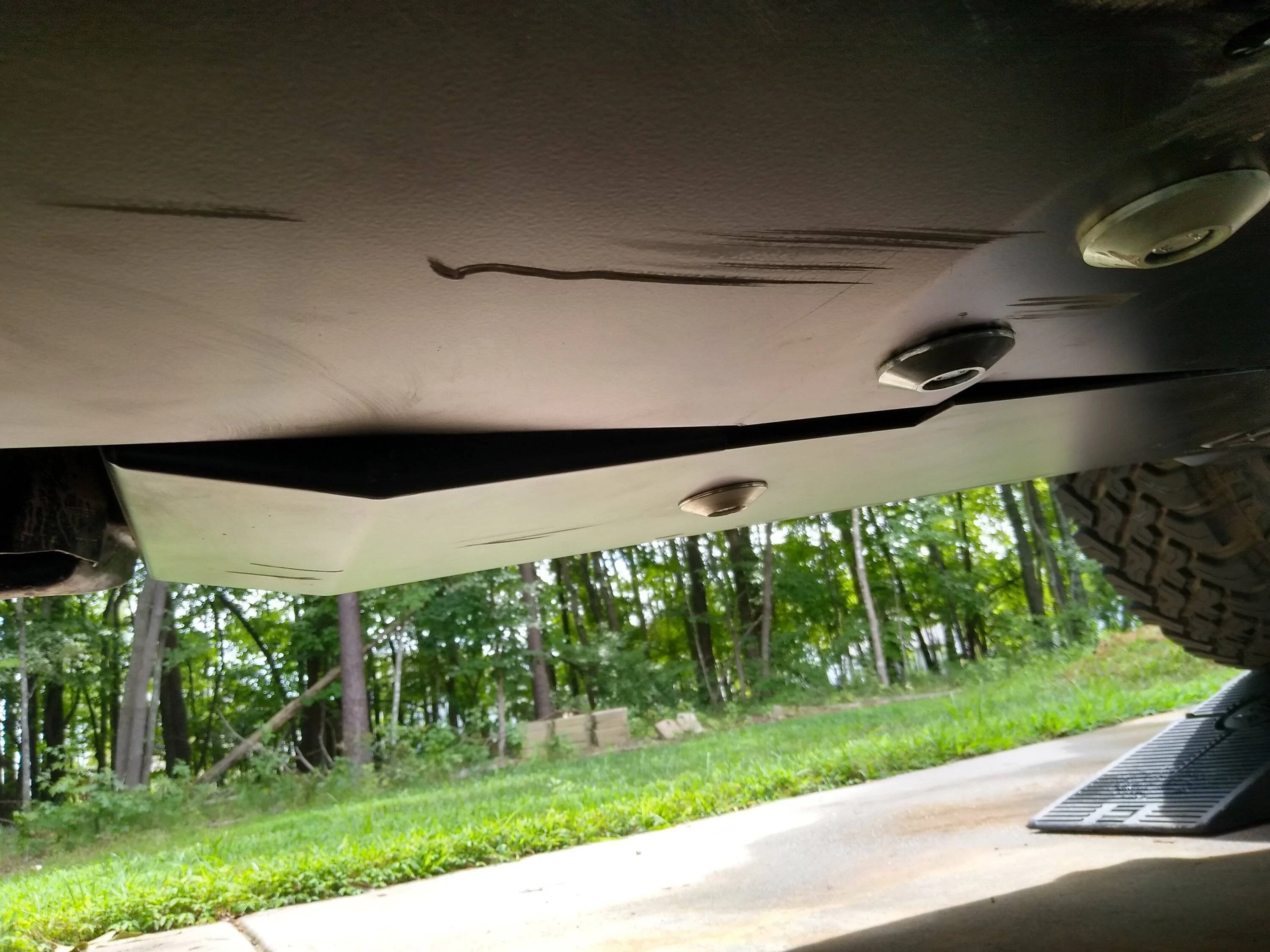

M.O.R.E. Gas Tank Skid:

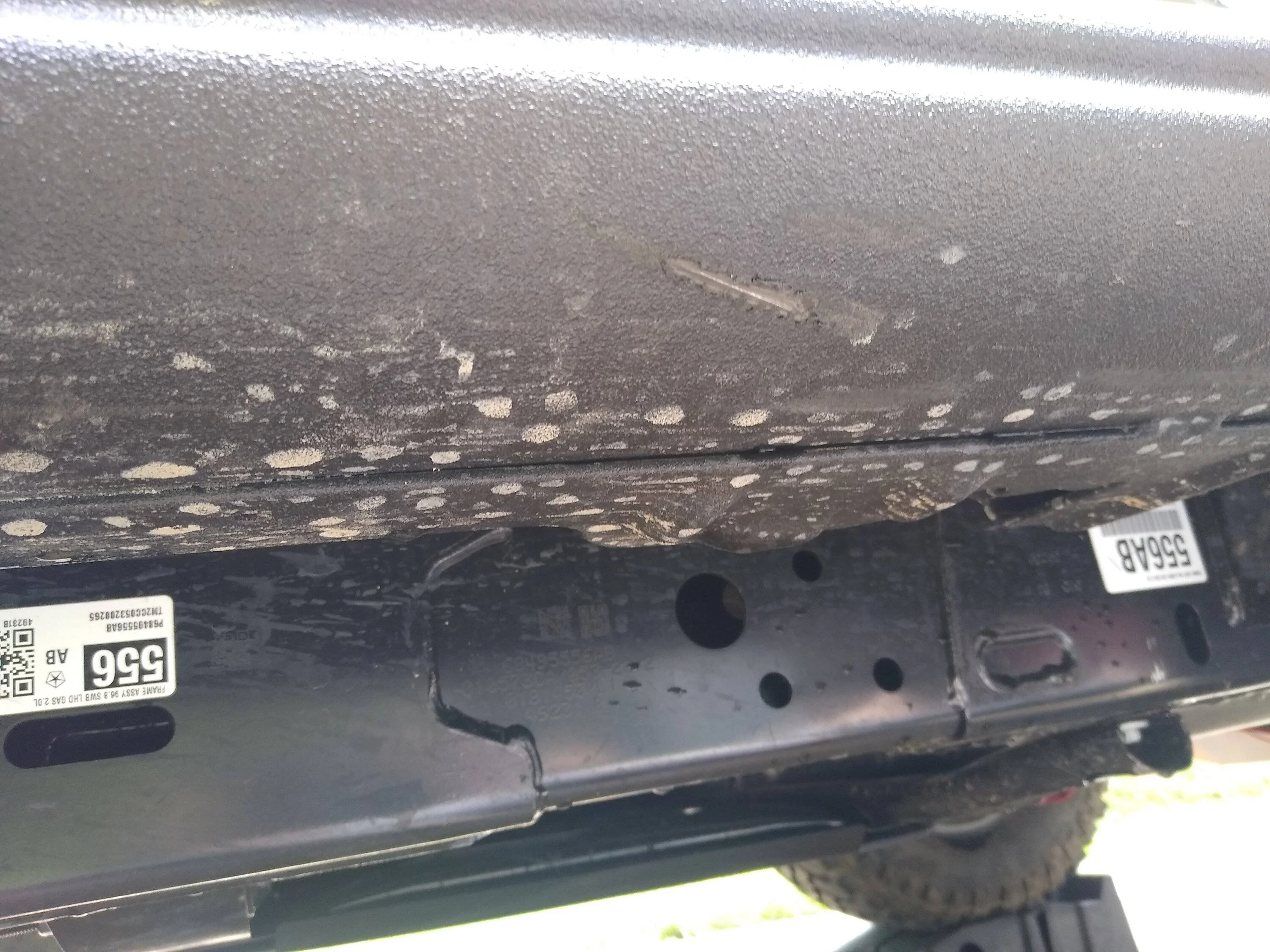

Not going to dwell on this one too much, the gas tank skids on newer Jeeps always get beat up due to location and length. The M.O.R.E. skid held up well.
Jeep Wrangler JL '22 JLR 2.0T build progress/wheeling thread IMG_20220814_141331219_HDR

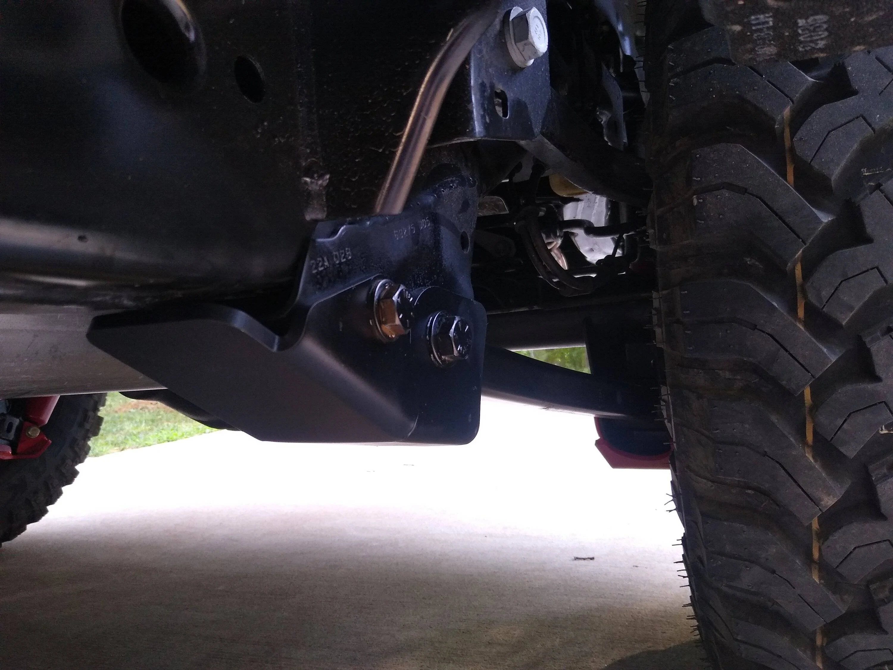

Rusty's LCA Skid:
This took just a kiss. Nothing bad.
Jeep Wrangler JL '22 JLR 2.0T build progress/wheeling thread IMG_20220814_141513039_HDR

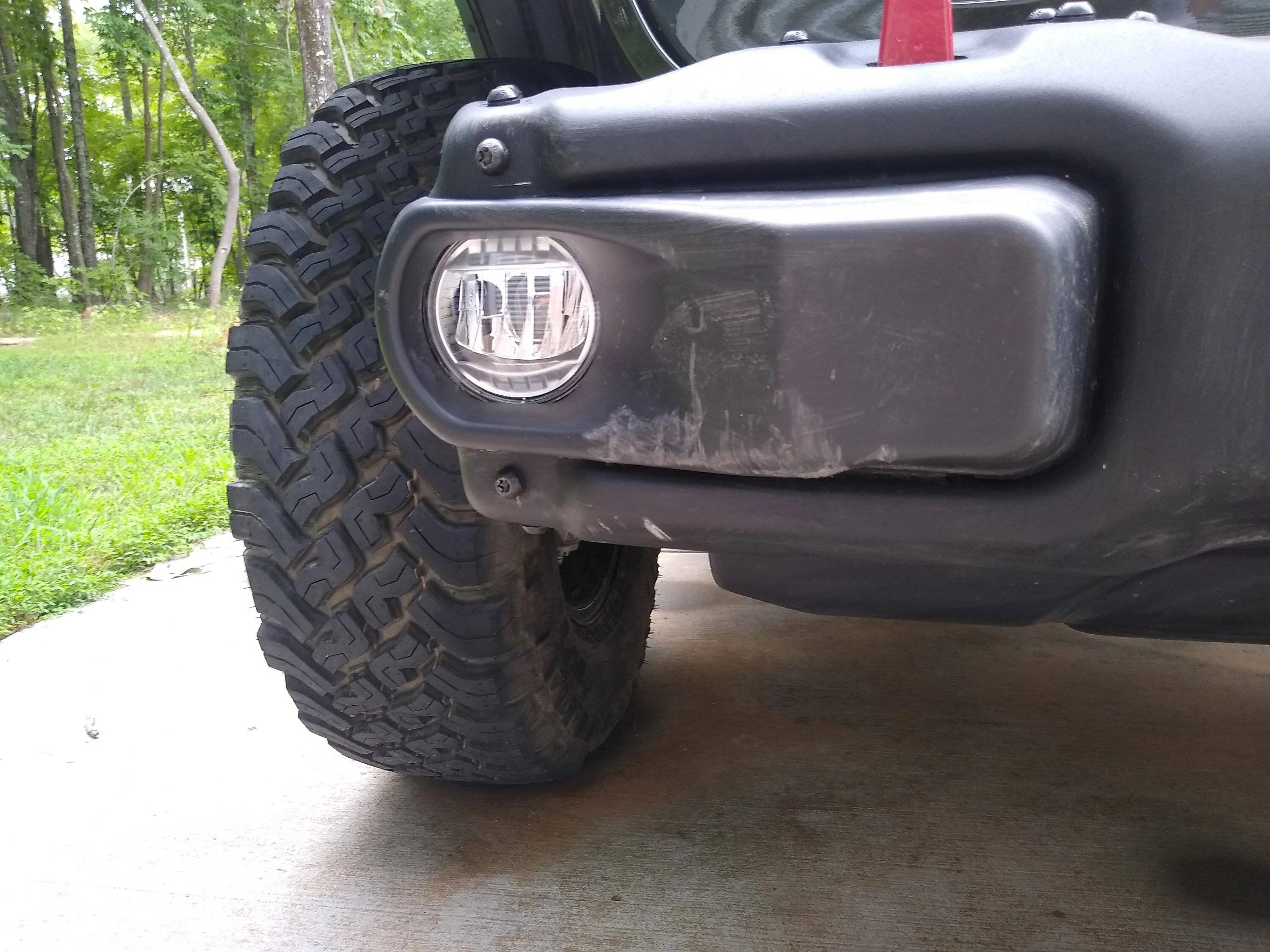

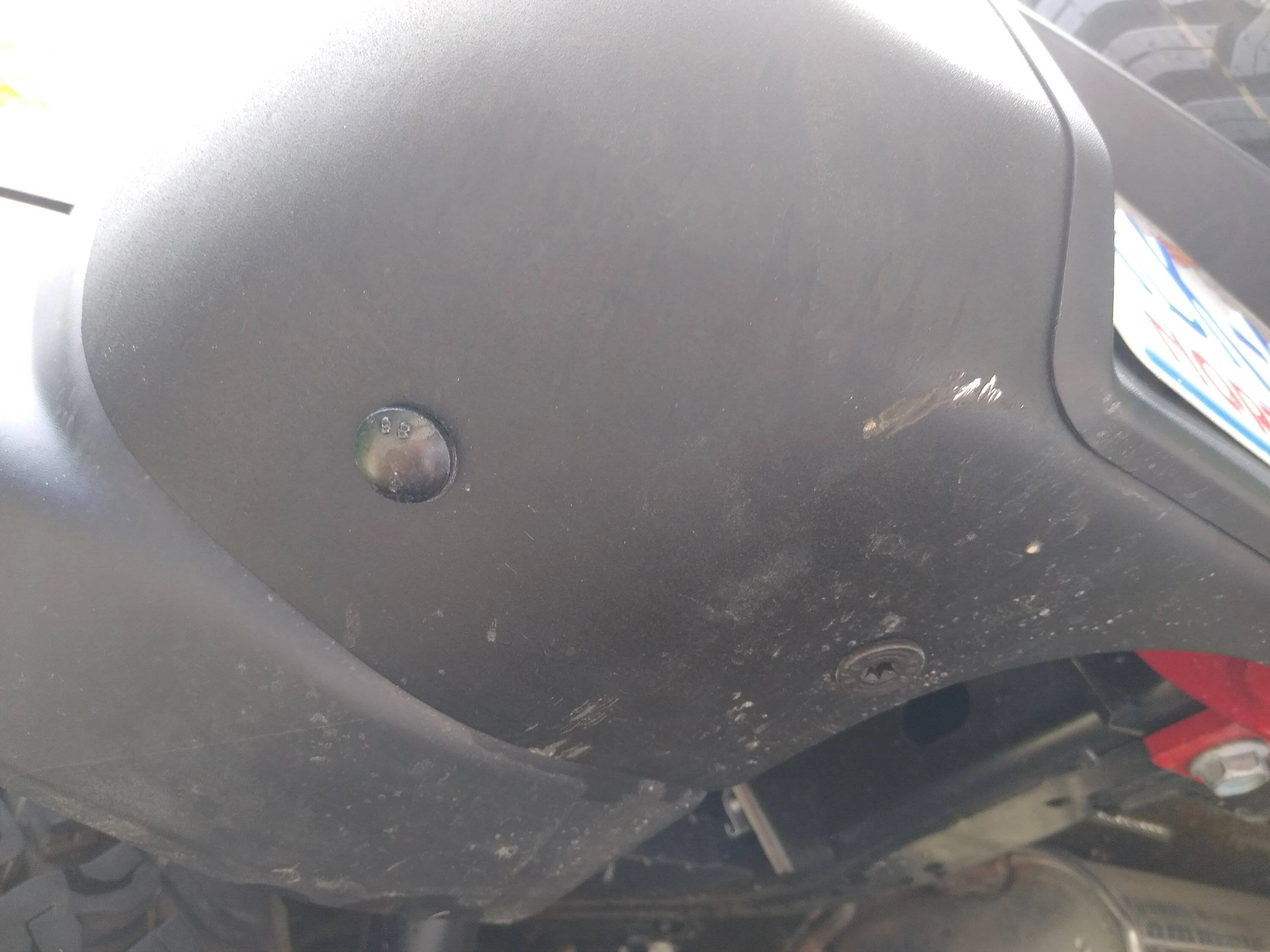

Managed to punch the passenger side fog light/crush can bezel right into a rock on Dickey Bell on the front bumper, and caught the rear coming down a ledge playing around on the back of Daniel. Both held up OK, not much to worry about. Rear did not deflect much - it was a glancing blow.
Jeep Wrangler JL '22 JLR 2.0T build progress/wheeling thread IMG_20220814_161457707
Jeep Wrangler JL '22 JLR 2.0T build progress/wheeling thread IMG_20220814_141225207
Overall, she held up pretty good I think considering that she's stock and what I asked her to do. The powder coat on the M.O.R.E. skids is definitely the best of the bunch, and held up really well. Only one or two of those hits may have gotten through the powder coat, with all the dirt in them it's hard to tell, but they were definitely shallower than the others. The Rancho diff skid held up pretty good too, I knew when I hit it that the line I took was risky (watched my buddy drag his Rancho skid over the same rock I hit, was just hoping that my shorter wheelbase would've let me turn a little tighter, but alas not). The Rusty's skids didn't really get pushed, so not much of a review there.
The factory equipment held up fine - there's just more plastic than I'd prefer. The front bumper sticks out further than I'm used to, which coupled with the lower ground clearance, leads to mistakes. Jury's still out on the factory Mopar "performance" rock rails - pretty lukewarm on them. The wife likes having something, ANYTHING, to help her in and out of the Jeep on the trail, but I think the aftermarket provides a better product.

Got a little done on the Jeep this weekend. Replaced all the lug nuts with the black Gorilla single piece units. Hopefully they won't deform as bad as the OEM ones when I inevitably ram a wheel into a rock again.
Jeep Wrangler JL '22 JLR 2.0T build progress/wheeling thread 1663592179028

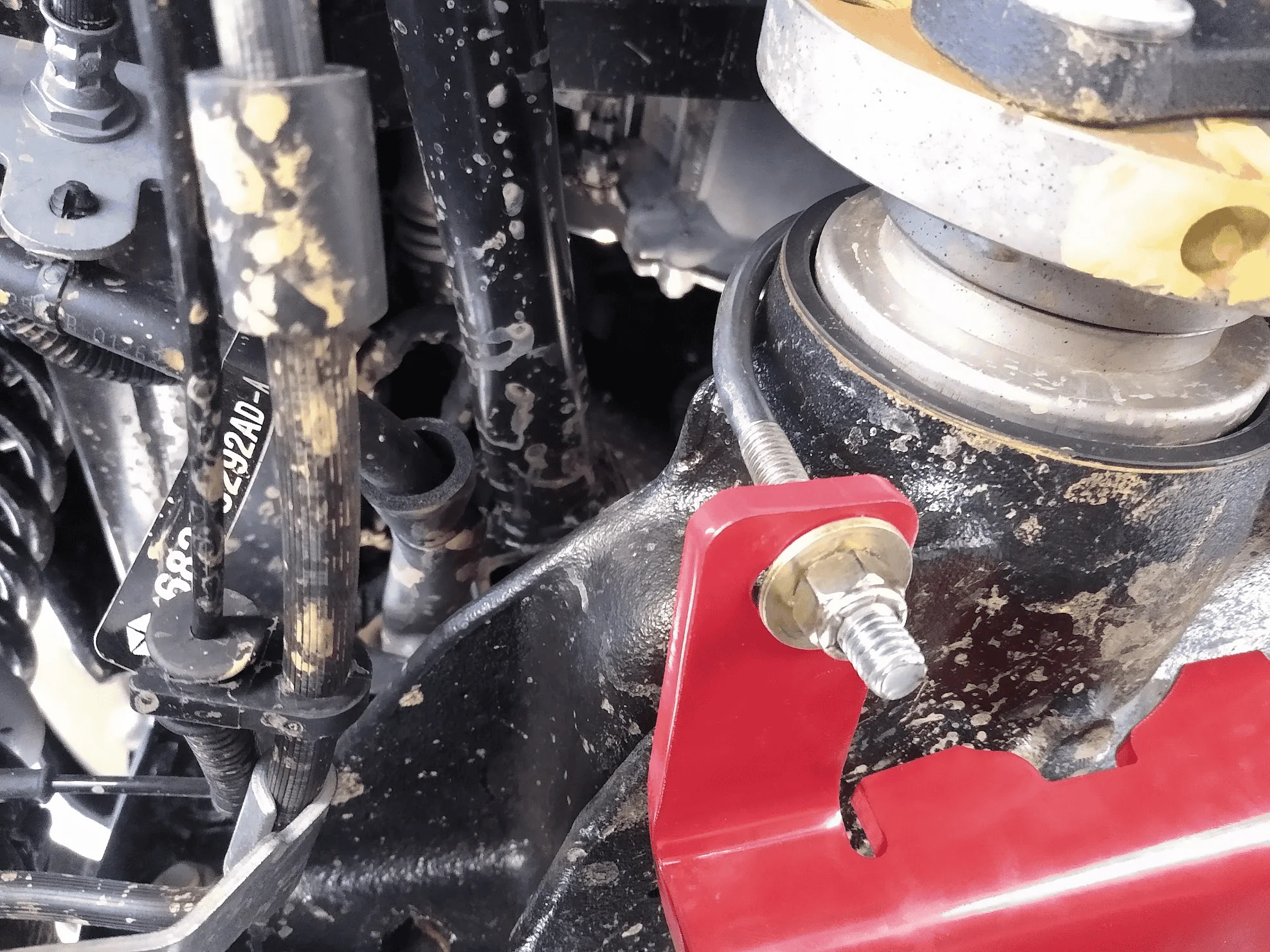

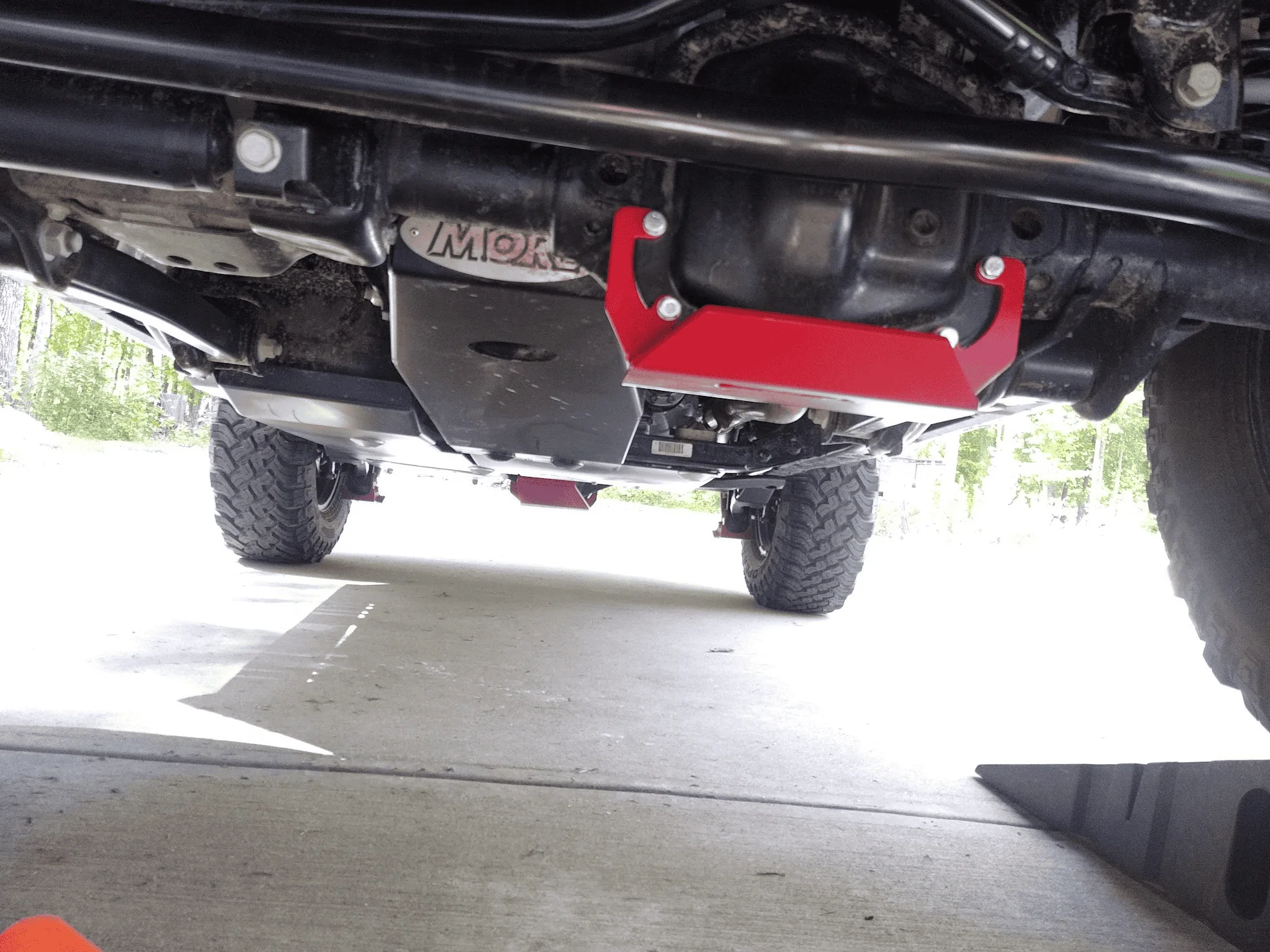

However, more importantly, I also got the Rancho front diff skid installed. Install was smooth, hardest part was juggling the u-bolt at the back of the axle casting while getting both nuts started. Definitely pay attention to the instructions and start the u-bolt nuts when you've only got the first two diff cover bolts in so you've got some wiggle room with the skid. Straight forward install as usual with these things, hardware was all present, and everything fit nicely.
