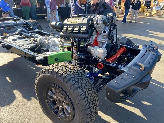

I got a 26 Moab and it has the older single bracket on the passenger side. Weird they are all different.

It just depends on when yours was built. It was a running change at the very begining of the 2026 MY. I think anything built from December on has the new style brackets and, some November builds are mixed.

The welded frame nuts for the brackets are 24 mm. One of mine broke loose and luckily I was able to get a wrench on it.

The brackets are *NOT* retrofittable to earlier frames. There are a lot of changes to the frame with extra holes with captured nuts inside, hanger pins, etc. It is really a frame redesign.
