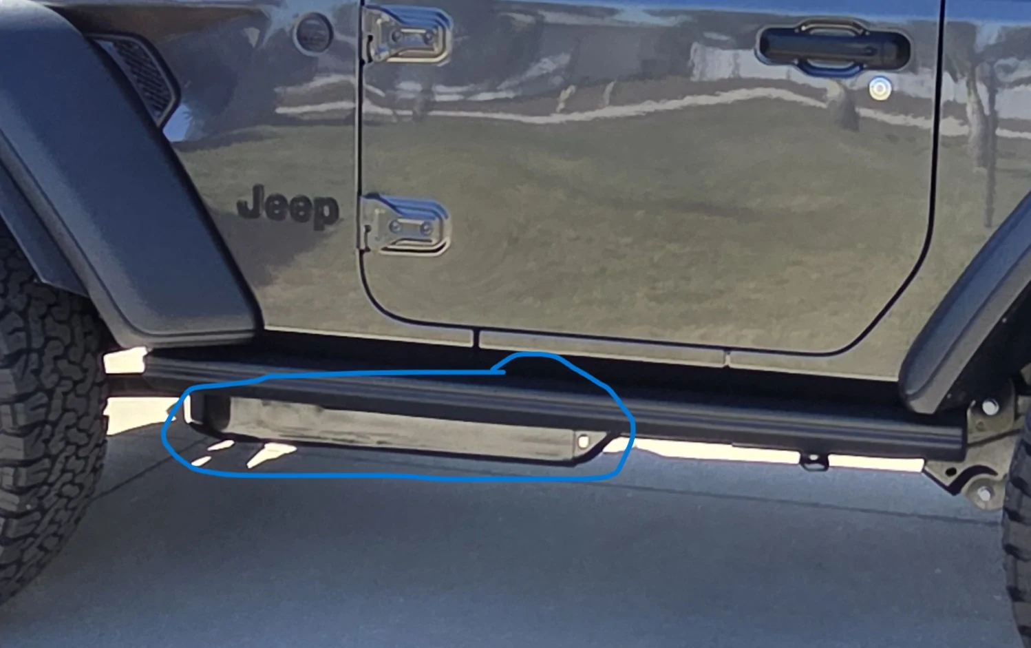

Noticed this on our new '26 two door (XR pkg). Also noticed how much tighter the steering is. No play in the steering wheel making it MUCH more stable on the interstate. Maybe as a side effect, it helps to stiffen the frame area where the steering box is mounted?

The changes you notice probably has to do more with a revised steering box over the 2021-2023 models if you were using your 2023 as the baseline.

That's not where your steering box is mounted. And I don't think that the frame flexes enough for anyone to feel that in the wheel. This is correlation, but not causation.

Didn't know they changed the box, thx!

I moved from a 2021 to 2026 configured and modded pretty much the same. The 2026 steering is very slightly better, from what I remember even when the 2021 was new. I attribute most of the changes to the thicker front axle tube, iron knuckles, thicker and tighter sway bar bolts, and it seems the balljoints are better (or at least seat better on the iron knuckles - there is no clicking when turning, which was never really gonne on the 2021 with sluminum knuckles.
I can't tell what is the biggest contributor, probably a bit of everything, but it is marginally better than the 2021.
I know it is not the crash brackets, because I removed mine and there was no change to the steering.
