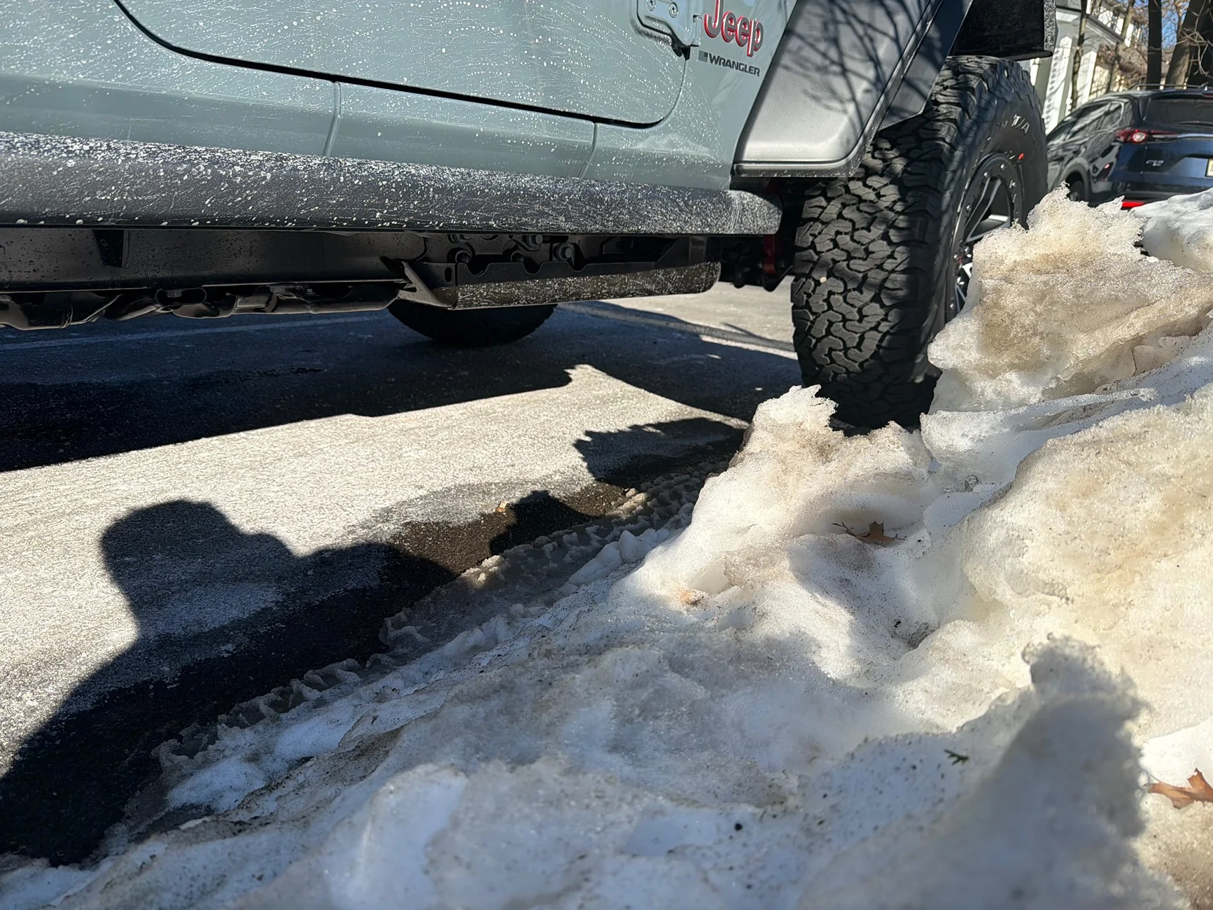

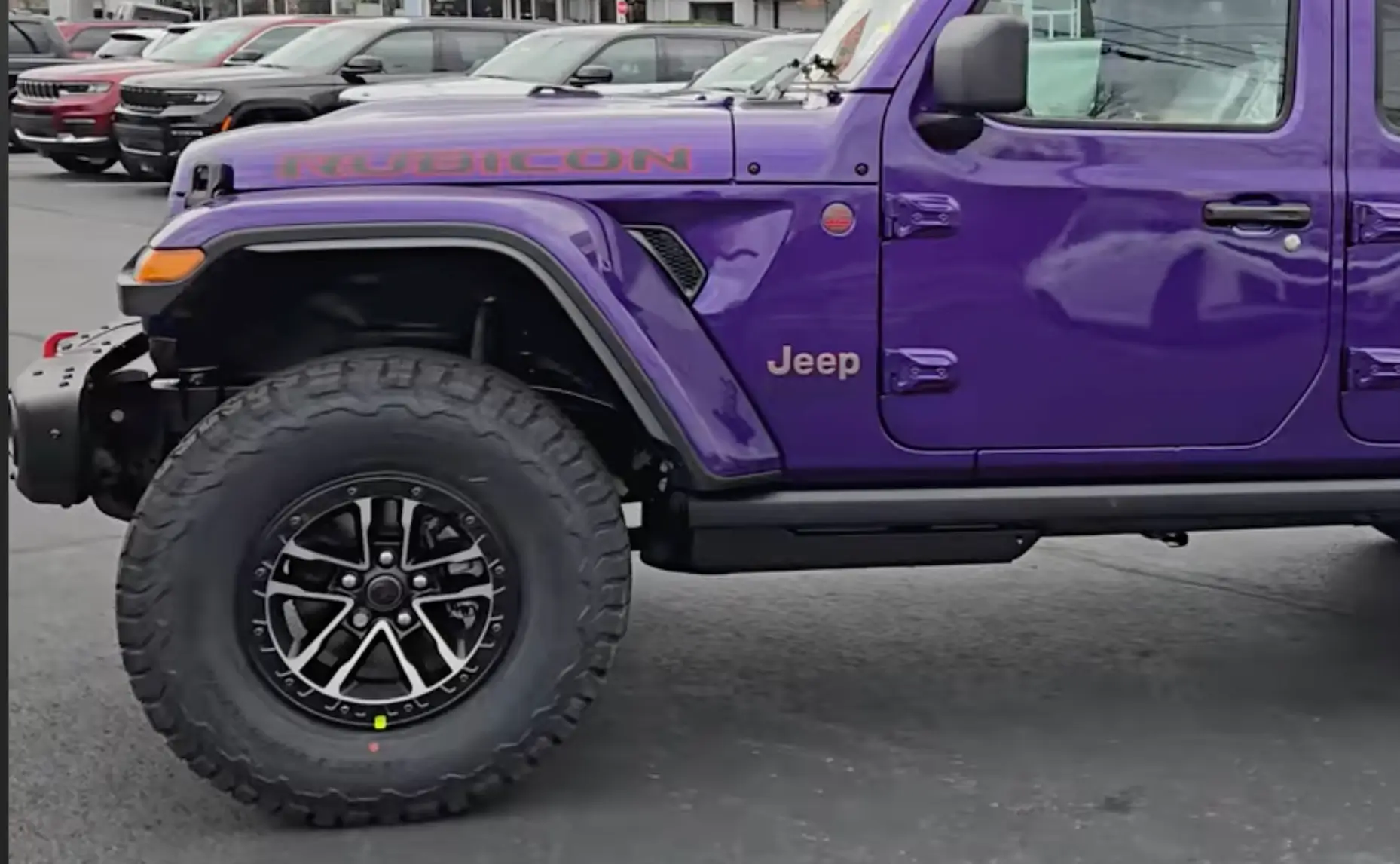

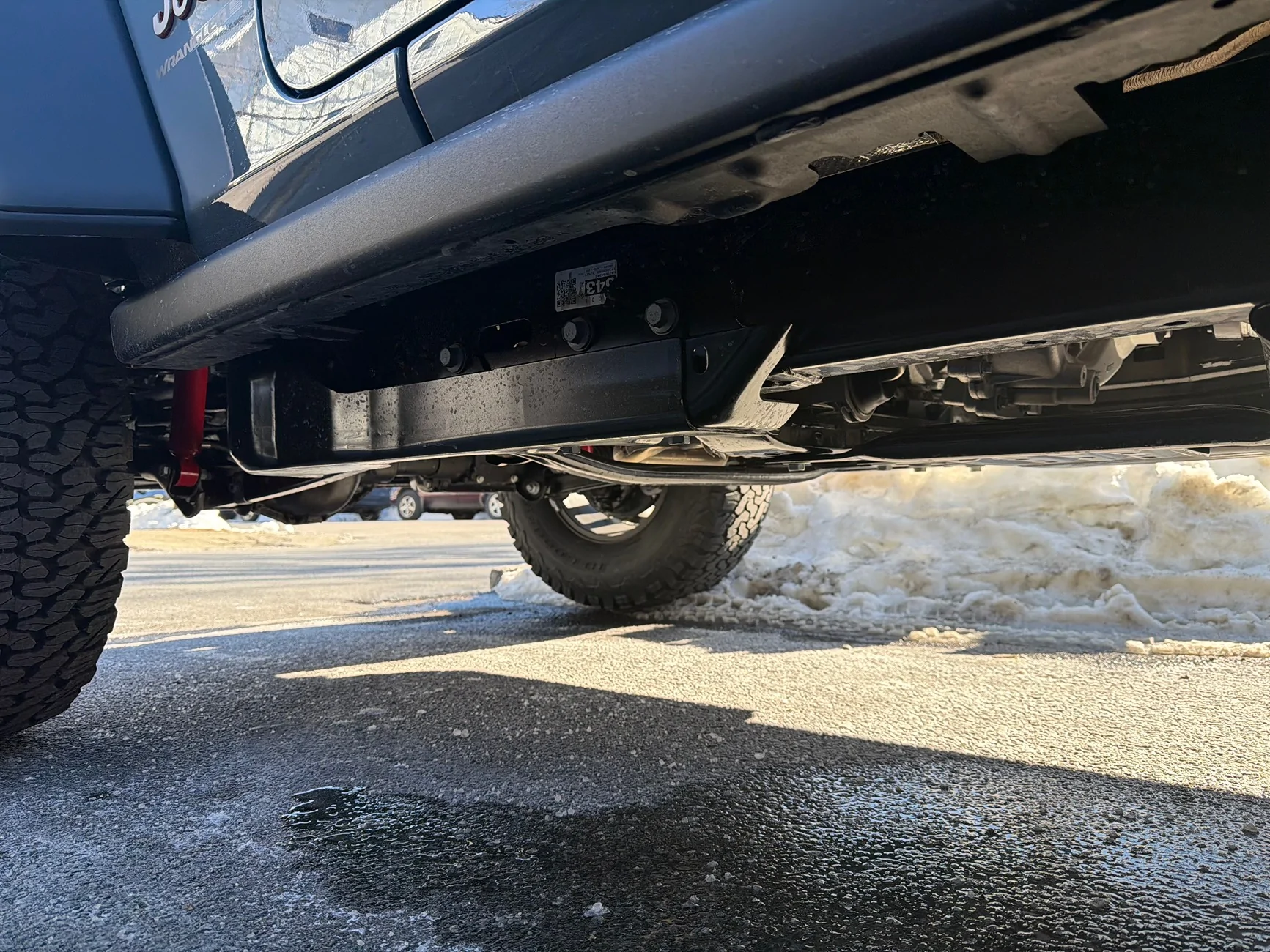

@Artec Is this going to interfere with the aluminum full belly skid installation?
I saw one on the lot yesterday and these things are massive, they extend way back (to almost middle of front door)

I removed mine (to install Artec skid plates) from my 2026 in ˜5 min. 7 bolts per side, can be done easily with Jeep on the ground and tires on. They are incredibly heavy, and the bolts are huge. I may do some cutting on them to see if I can fit them back over the Artec.

As for the '26 Brackets, judging from my bolt on sliders on my 2019 it doesn't look like they interfere too much with basic bolt on sliders. You can still see the frame bolts and body mounts. More integrated stuff it might be harder to clearance, but not attach. Main attachment points of them seem to just wrap the frame and stay behind the body "tub". Can still access the body mounts, just may have to clearance the slider on the inside. Just my guess.
Well, I inquired with LOD Offroad b/c I was going to order their Signature series rock sliders, like I had on my 2018 Wrangler and they told me that those "tire deflectors" will definitely interfere with their rock sliders.
