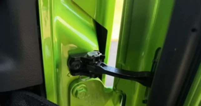

Pics of the 2026 door quick-release from DRC ......

Jeep Wrangler JL 2026 Door Hinges (Quick Release) - photo 1759978371096-a8
Jeep Wrangler JL 2026 Door Hinges (Quick Release) - photo 1759978404154-f

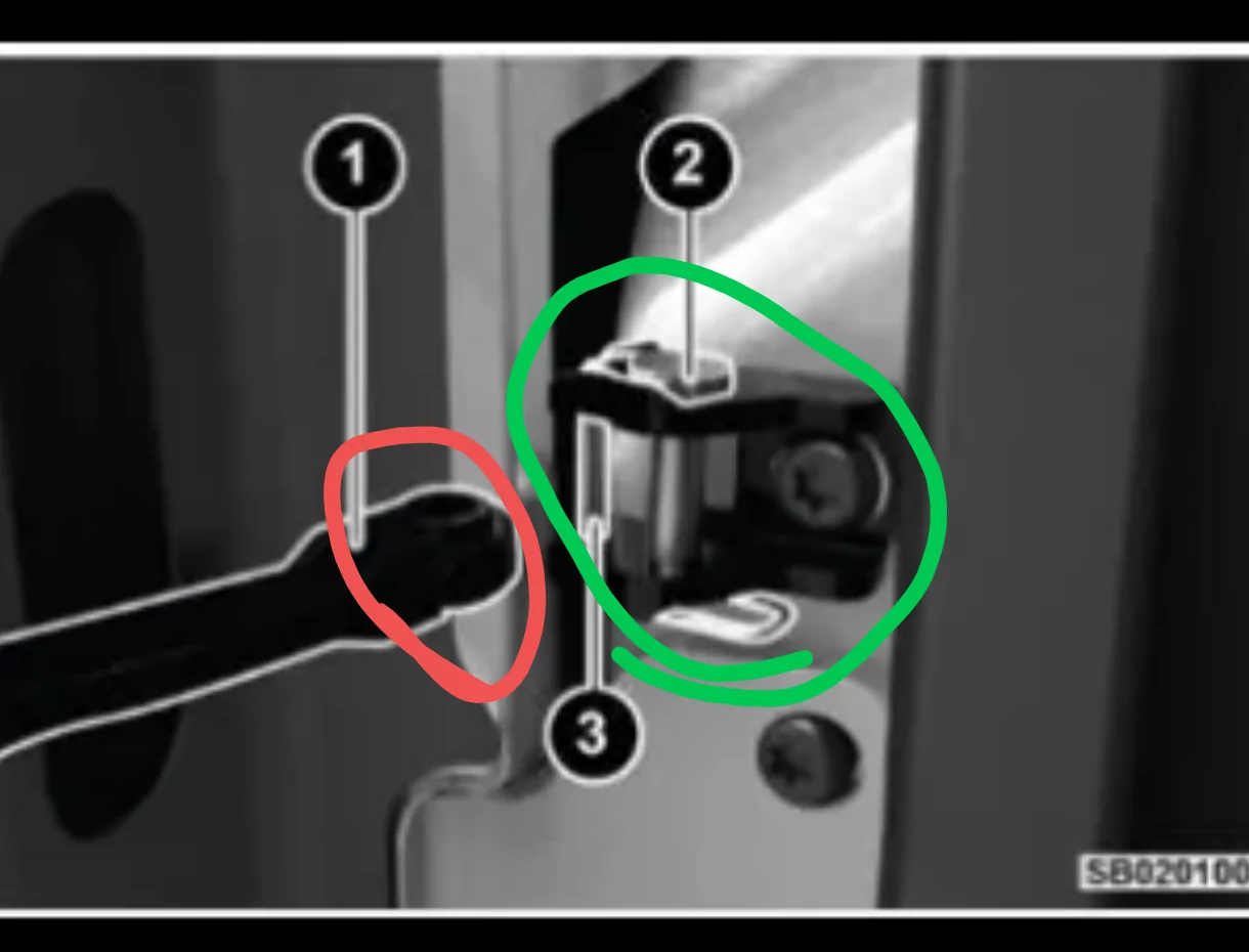

Official diagram of how they work:

You know that's not a bad idea.
If you didn't know any better, those are called Security Pins
I can get those of various sizes at tractor supply for about $5 each.
Not sure what size you need, but varying types for around this price!
You could actually do this for the price of that security pin, and a little bit of time.
Jeep Wrangler JL 2026 Door Hinges (Quick Release) - photo 1000014792
For the rest of us, this arm and mounting bracket are one piece and are mounted vertically on the door frame. Looks like this one they turned that arm sideways and installed the bracket sideways as well. I'm not in my Jeep right now, so I can't really get you a photo of it, but if you can figure out how to remove the connecting pin from the bracket (of your non-quick release door hinge), you can easily mount the bracket, and install the arm with a security pin (like the one linked above). I'm not sure what that connecting pin between the arm and the mount looks like, but worst case scenario, it's nothing a drill can't fix!

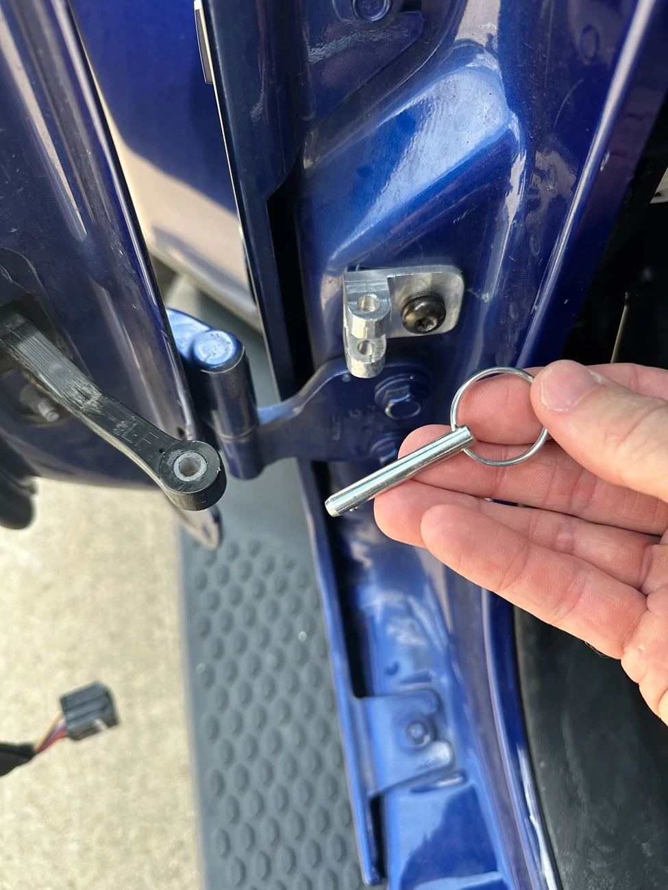

Looks familiar....
Jeep Wrangler JL 2026 Door Hinges (Quick Release) - photo {filename}
Did you make them ? That would be super simple, I never even thought of that. Now I got a new project. Just gotta get the right starting material. I would need a block of aluminum and some machine work. I’m gonna start looking. Thanks for the idea !
Yeah i got some scrap chunks of aluminum at work and used our mill to make it. If you try it, make sure you drill out the door check arm to the right size for your pin. I had to make a little sleeve to press in cause i drilled it too big the first time.
