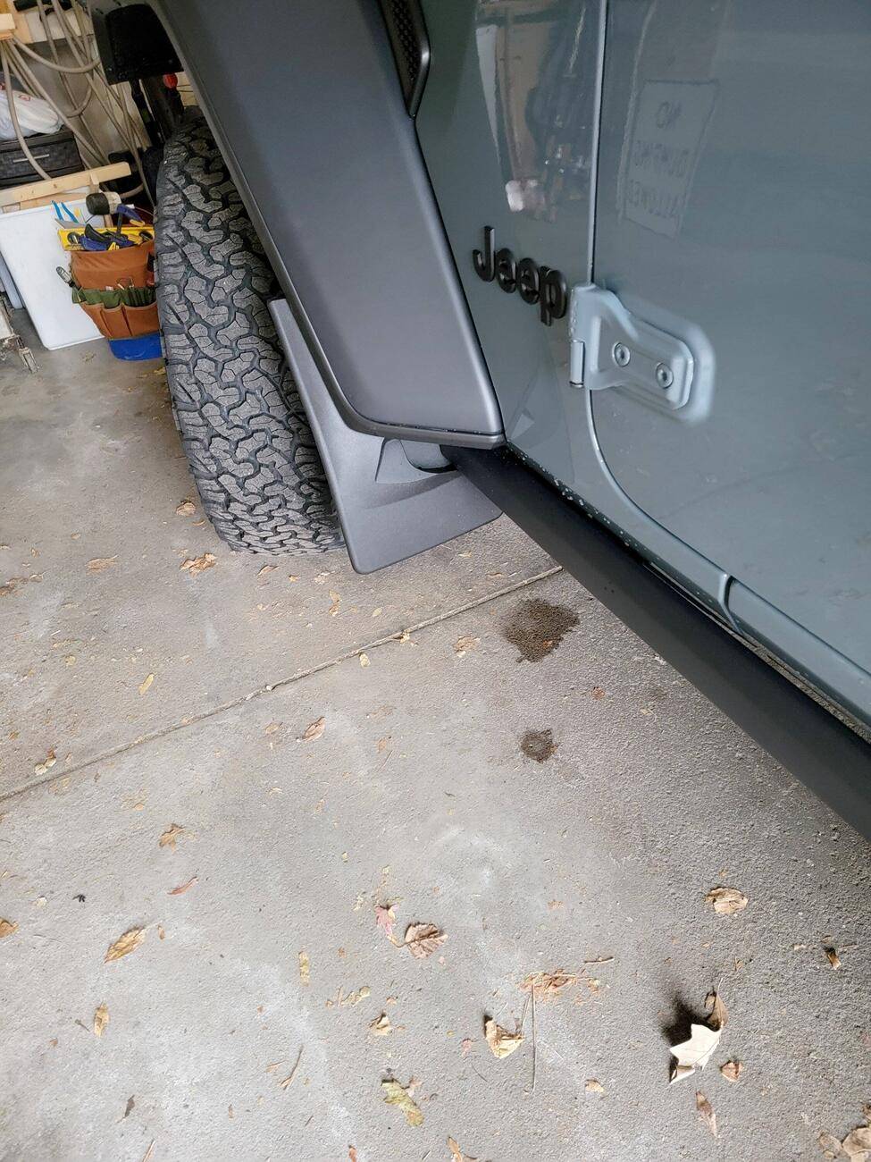

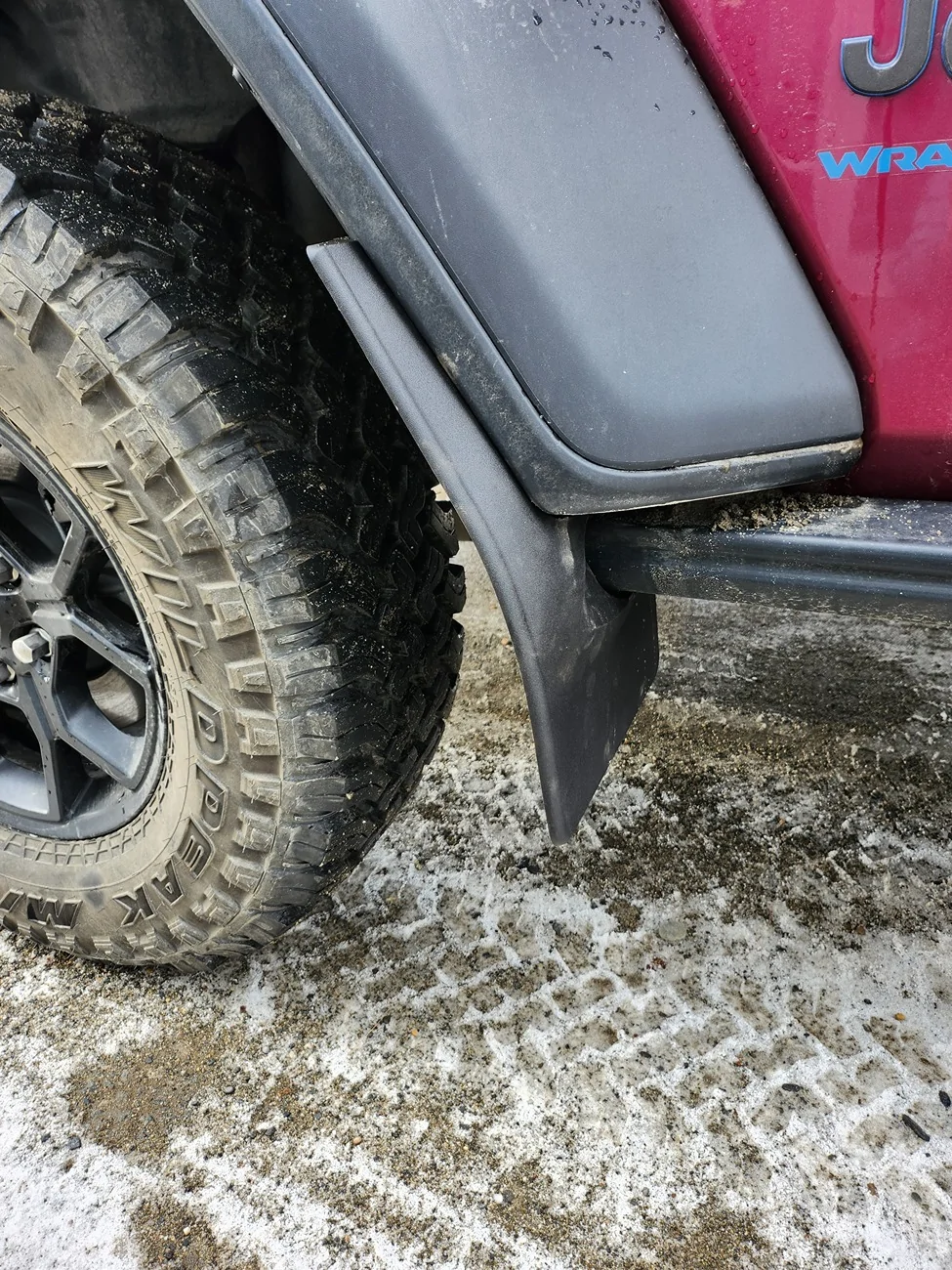

I installed the weathertech for the Rubicon on my 2024 Willy’s 4xe they fit really well.
Can someone point me to the correct part number for these? Above. Not the ones below.

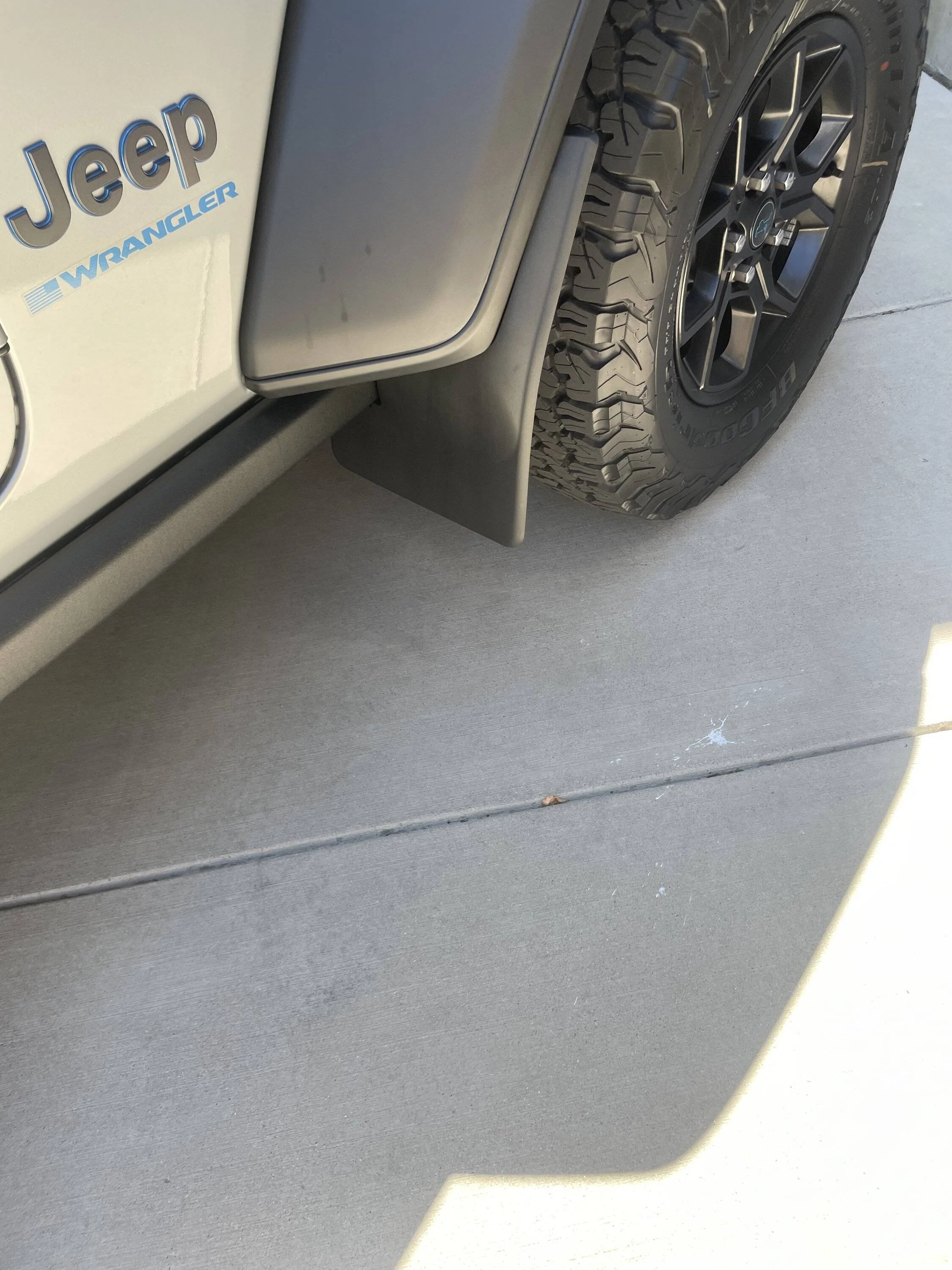

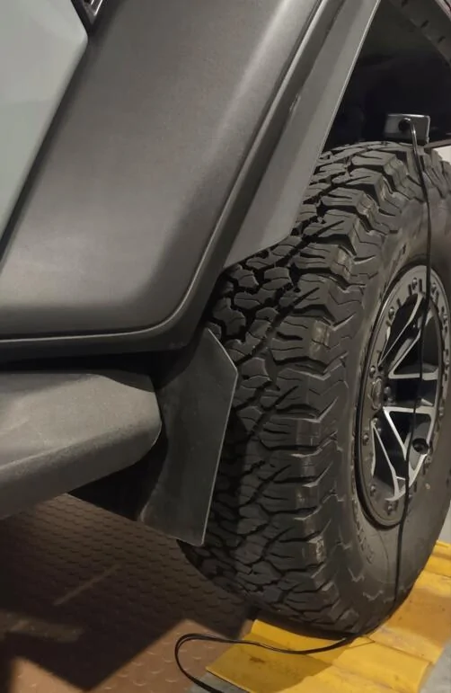

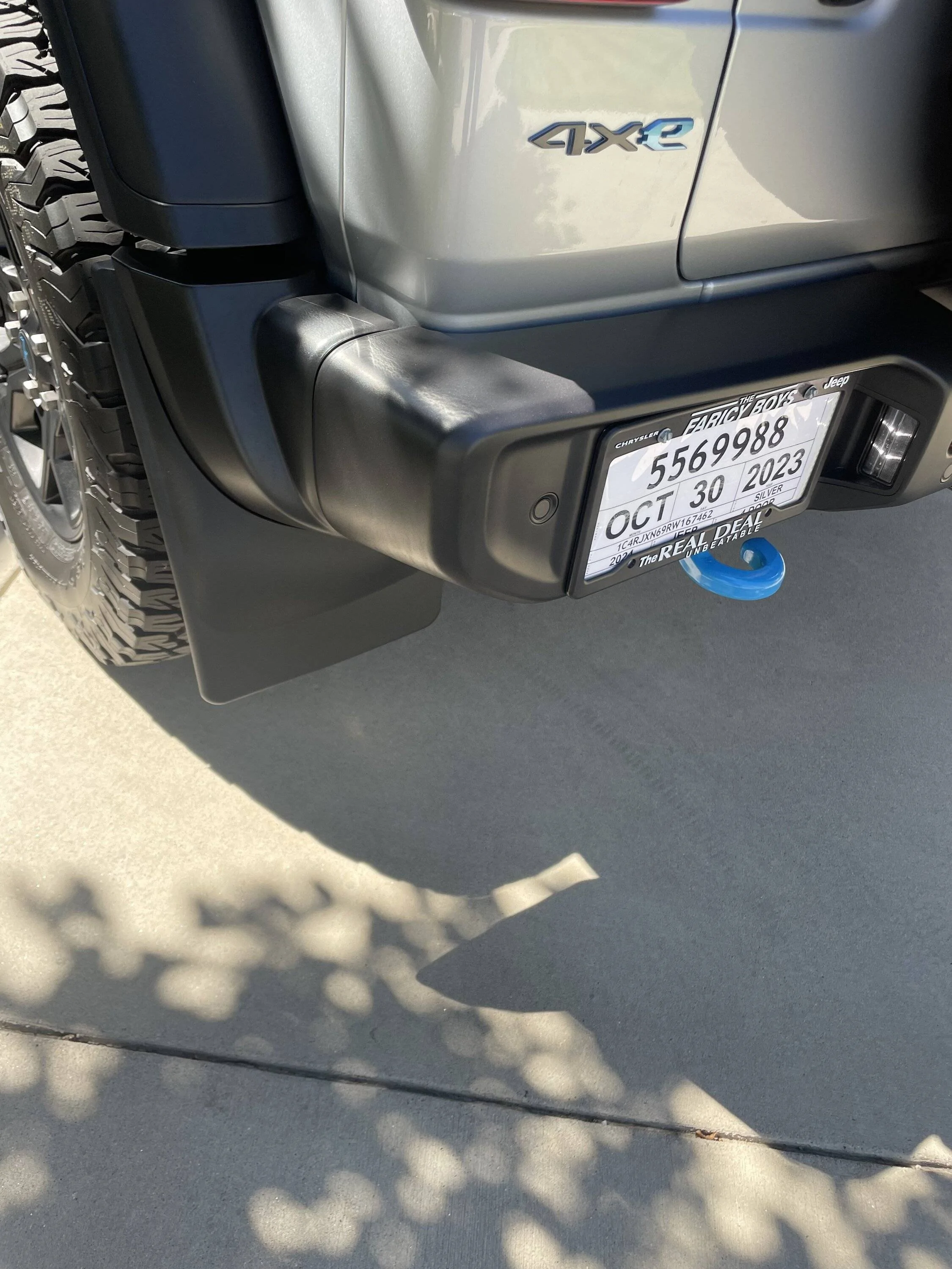

My front mud flaps. Fab'd and installed last summer. Work well enough. No hits when wheeling in Moab and Colorado last September. They can be removed with some thumb screws.

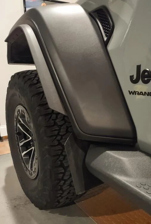

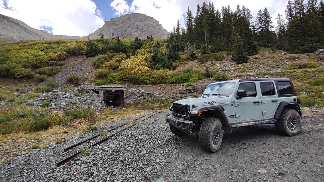

In this photo, you can see the dirt splash pattern. The flaps appear to block for the lower front door hinge. Photo taken near Imogene Pass.
