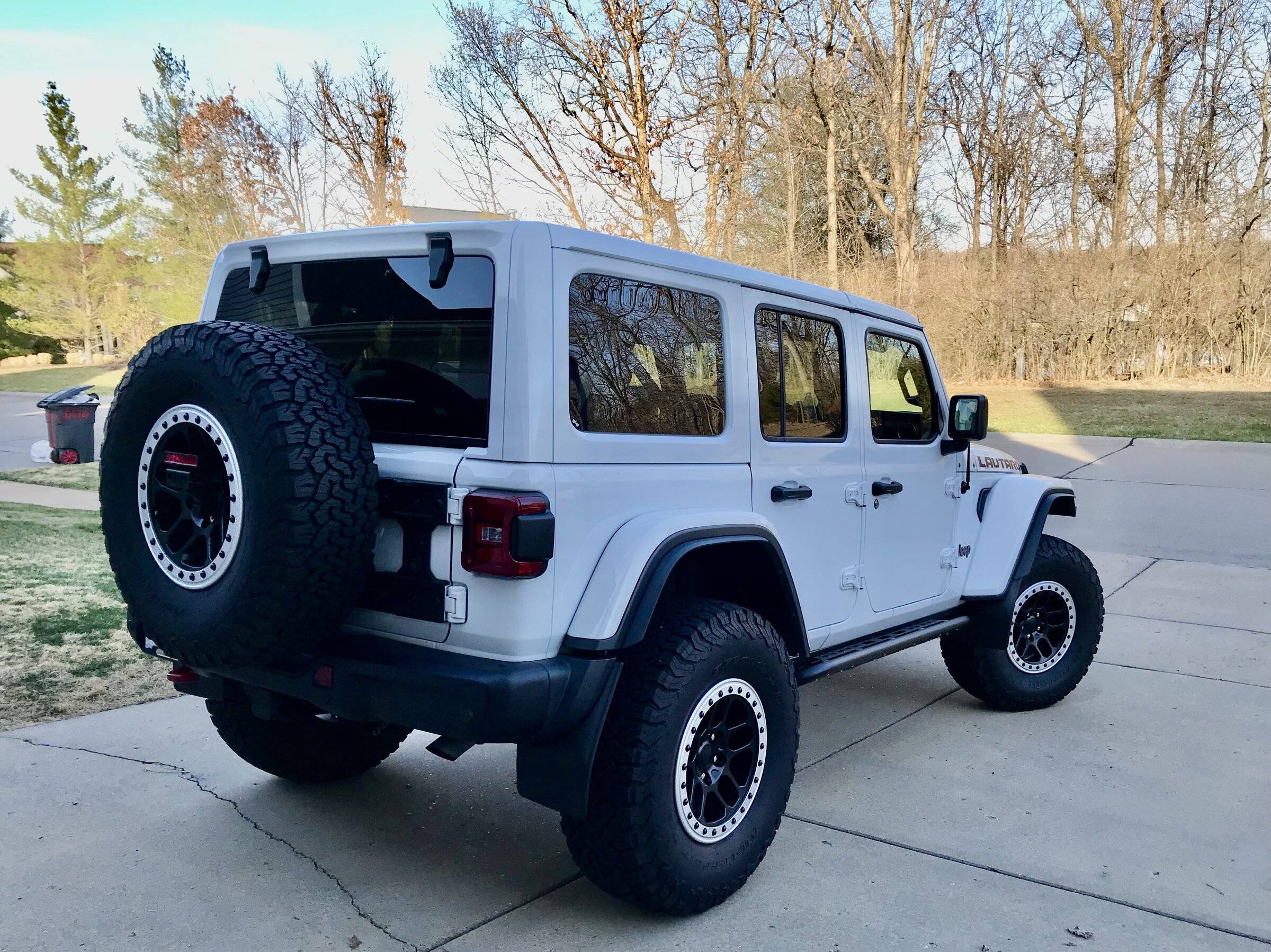

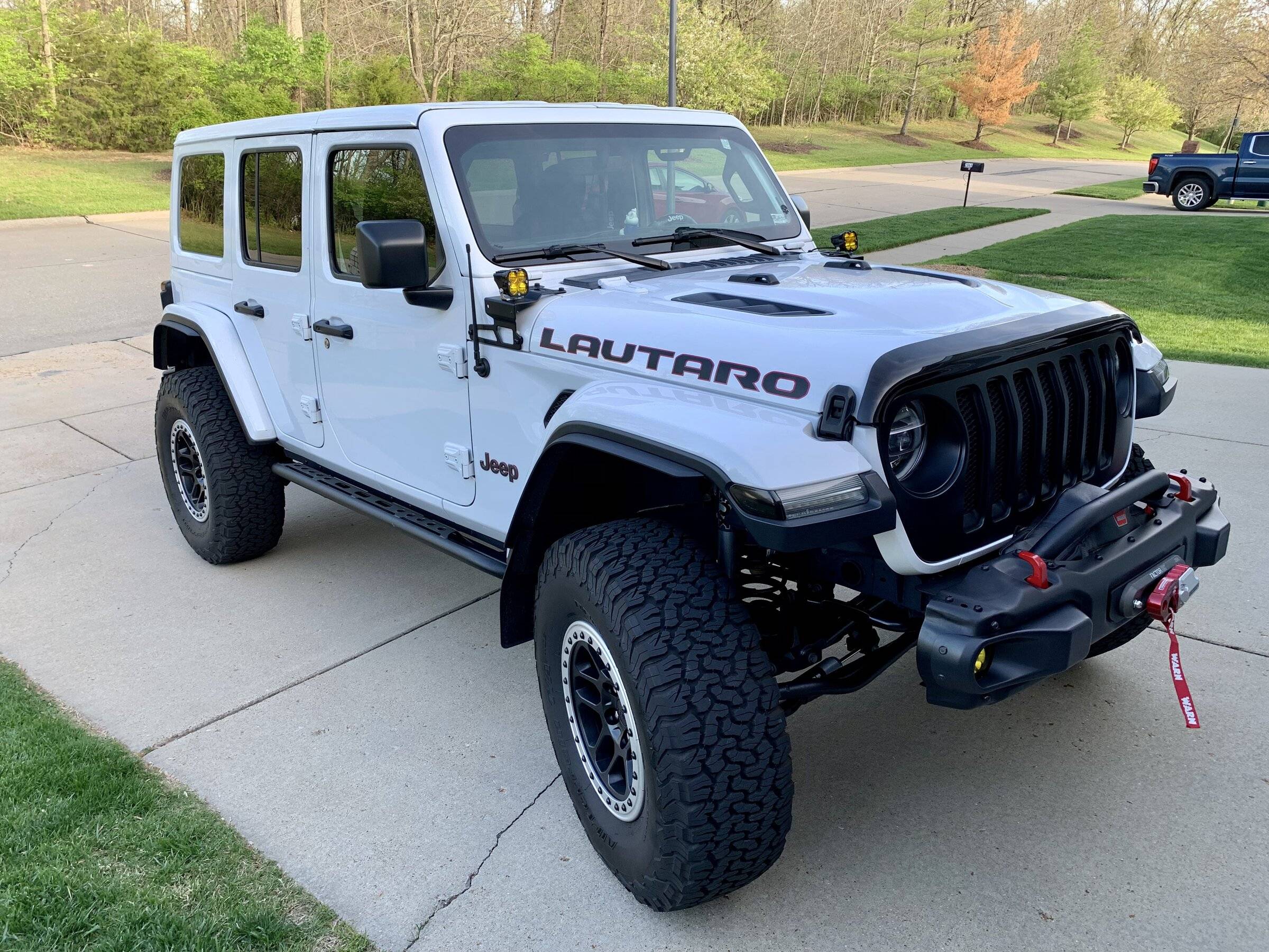

If you are going to add mud flaps to your Rubicon JL, Weathertech is the way to go. They look OEM and integrate seamlessly with the XR fender flares.
They do look good with the XR trim. Your Jeep looks tastefully done. What part number did you order especially since it`s being said it does not fit steel bumpers or the XR package
Thanks in advance

i don't that the part numbers handy but if you read the thread, it's reference in there.

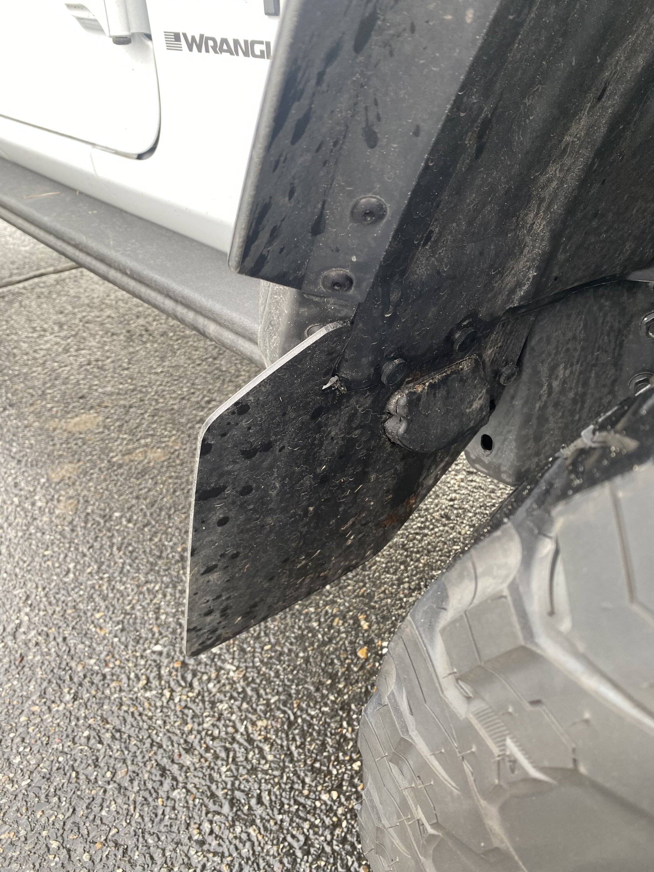

I put the stock MOPAR mudflaps on our 2023 JLU. Granted they are spendy, but I like the way they attach and fit to perfection. Good quality that should last my time with the Jeep. Not off roading, so that won't be an issue for us.

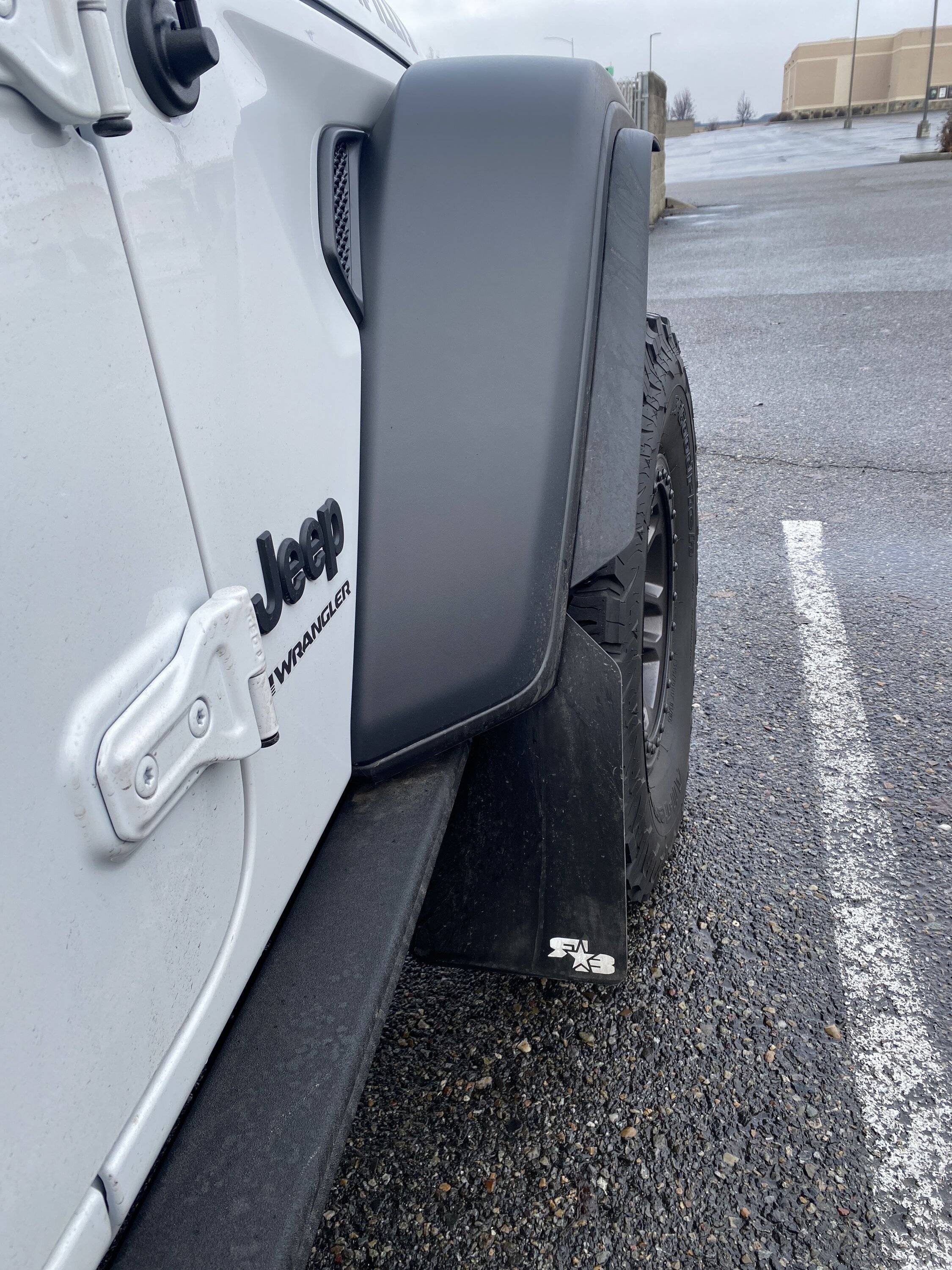

I have the Rokblokz XL and heavy duty sliders with step assist. Just had to router out a bit of material to make it fit. Used the end cap from the sliders as a template and took a die grinder to it. Worked pretty good.

They do look nice. Are the front ones solid without any cutouts for factory rock guards?
I have my rock rails removed and I`m using Rockslider power steps but I do have the XR package and steel bumpers. I guess I can look on Mopar`s site to see what they have, I`m glad that you posted these pictures. Many thanks

The front are solid with no cutouts.

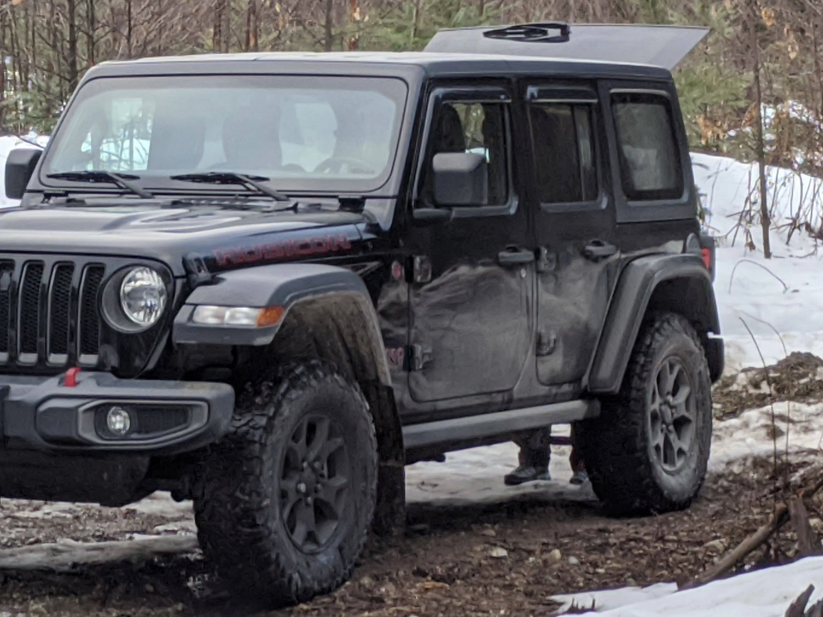

For everyday use on-road and FSRs with ruts and large potholes and puddles - Weathertech with DIY bolt-on extensions. Zero mud - zero slush - zero mud cleaning. For rock crawling and bigger holes - take them off. Without the extensions still got way too much mud caked. Just eyeball the sightline from tire contact to impact point. Zero sight - zero mud. Zero rock chips. See my thread for details.

Looks nice and clean with no overwhelming logos/branding. Question for those with RokBlokz, if you order black on black (logo), is the logo gone or repaint to hide the logo for one less branded item? Hard to tell if its painted and/or etched into the material.
