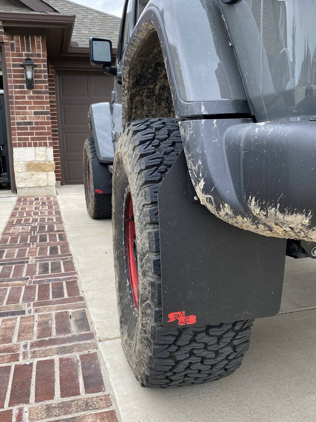

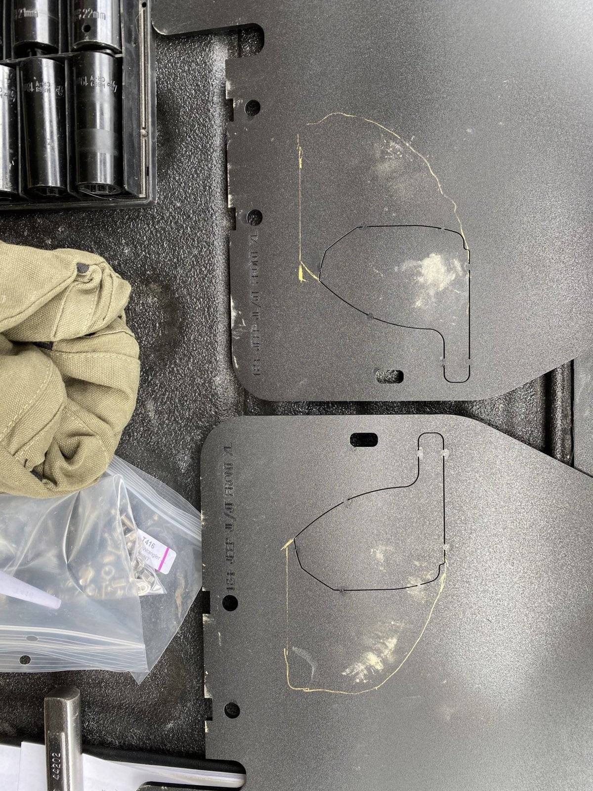

Put the RokBlokz on today. The perforated part for the factory rock rails aren’t big enough so I had to cut the holes larger. Like how they look.

Do the rock blokz work with the mopar heavy duty steps?
looks like the cut out is only for the standard rubicon rails.
You will have to cut the holes larger to fit. I held it next to the end of the step, traced it with a marker, then cut it out with a dremel.
