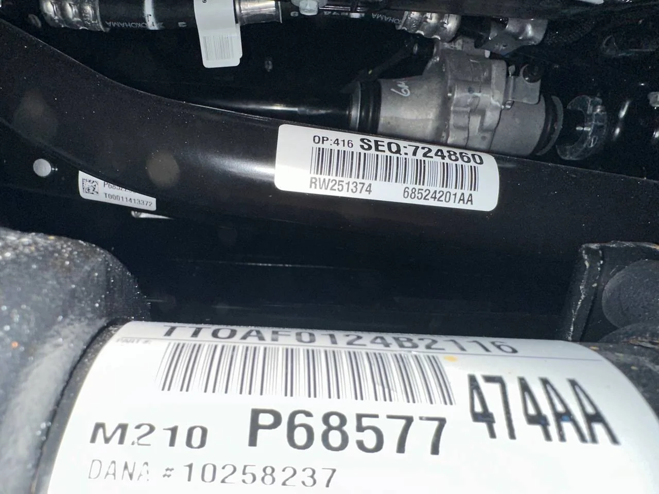

I tried the search option but did not find anything. So I just got a 2024 Rubicon and wondering how it works because it really does not look like there is anything on my axle that would activate it. I guess I was expecting a little electric type motor that operated it. Does it operate by centrifugal force? Maybe they no longer have it. If they don't I guess I saved on a skid plate.

Would love to know what the criteria is on these 24s that decide if a FAD is installed or not.
Maybe none of the rubicons have them. It would make sense. It would be even nicer if they had a one piece axle shaft.

My 24 JLRUX 4XE has no FAD and I believe it's still a two piece collared together. When I replace with RCV I will go single piece

FAD is not included on 392, and others with the automatic transfer case.
Another way is if the joints at the wheel are not U joint but are real CVs
I have not taken one apart but I think those without FAD still have 2 piece axle.

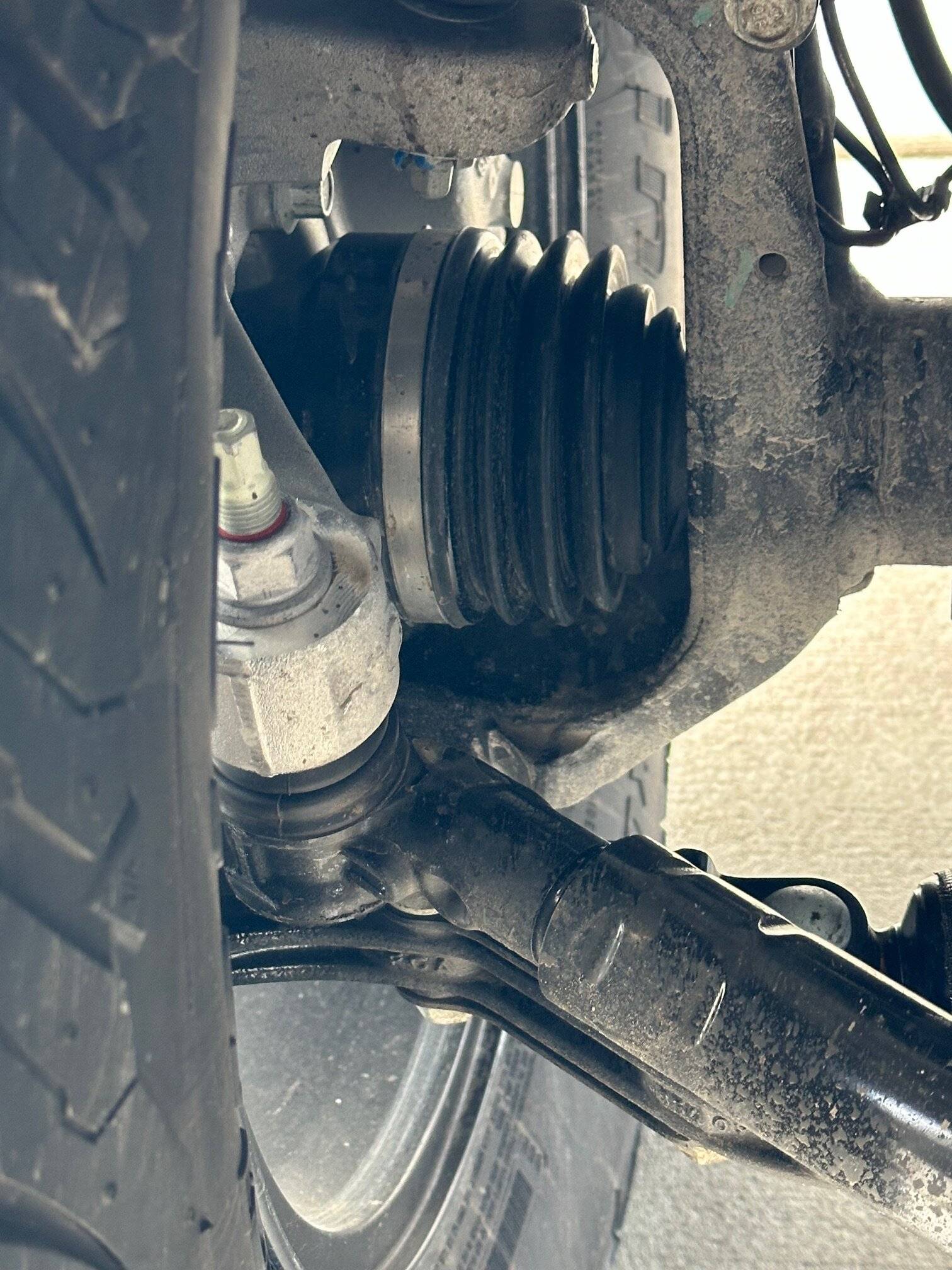

I was crawling around and sure as sheet I have CV 's. good, bad or indifferent?
Way better, stronger, no crow hop on tight turns, smoother, quieter. More expensive to replace and some will fear puncturing the boot but I took my WJ everywhere including through overgrown brush and never tore a boot.

U joints are vastly superior to CV boots.imho Ujoints are fully serviceable. On the jeep if you rip a boot, you have to replace the whole axle. All heavy duty applications use Ujoints. Cv joints started out on front wheel drive cars that have been adapted to 4 x 4 use for smooth operation.
NOTE : This is my opinion no sense quoting me and scolding me. I’m not gonna change my mind. We all have opinions.
